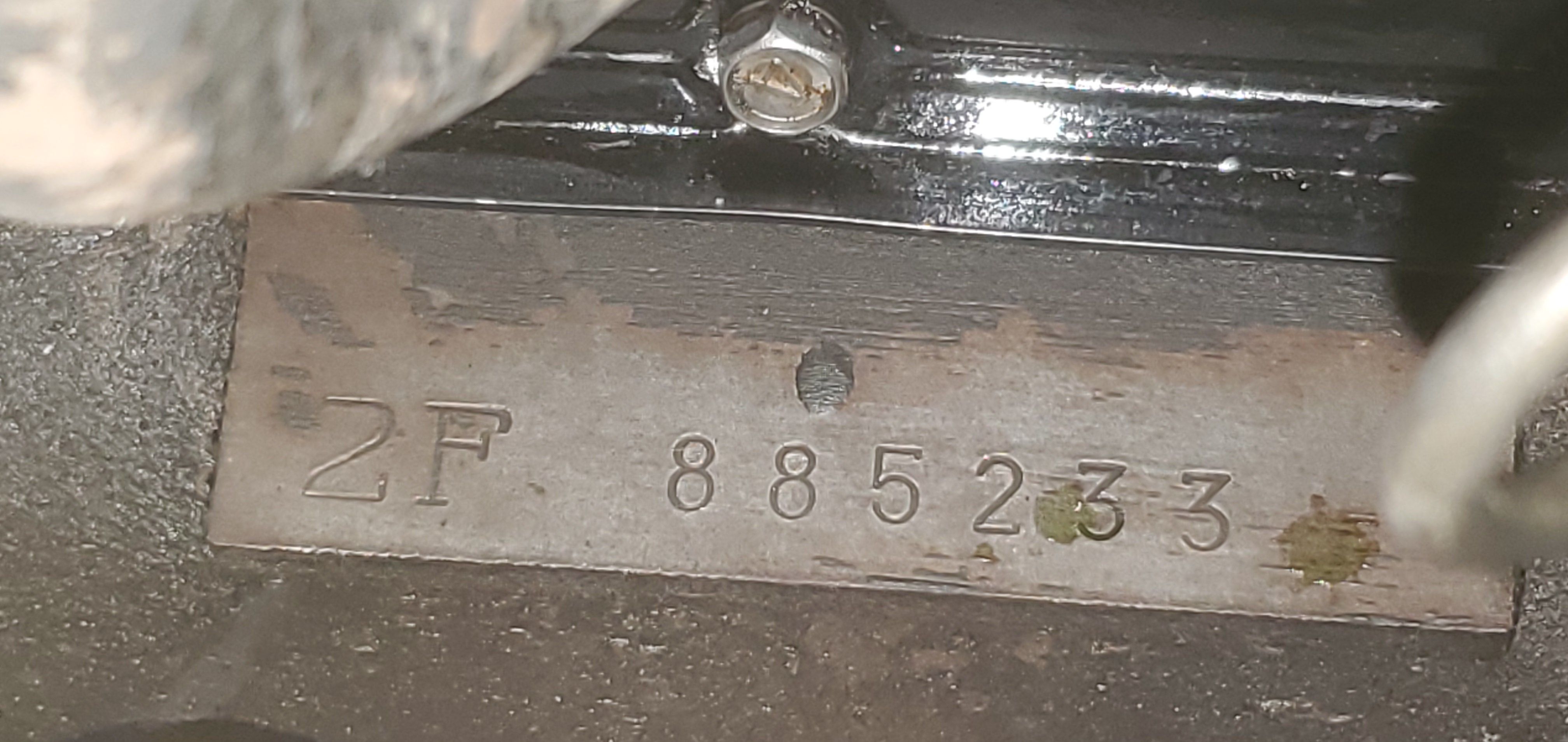

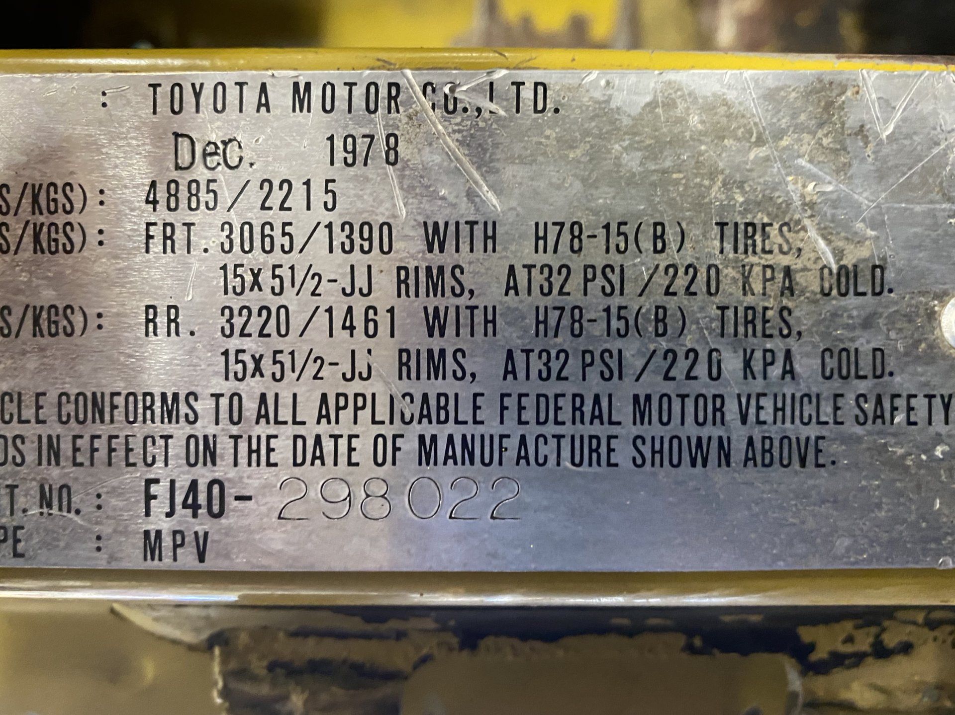

Engine number is
2F-889369. I think that makes mine the youngest? Did I win a prize? Build date is July of 1987. I think I read somewhere that the last FJ60 rolled off the line in August of 1987...
