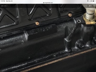

Engine #: 2F 081966

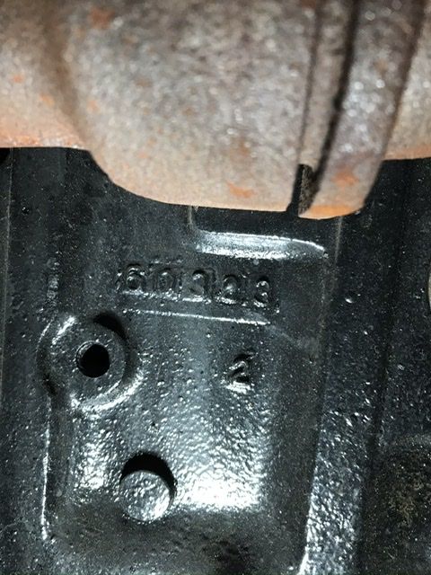

I’m updating this to help with accuracy of the excel doc that’s tracking this. My FJ40 is from Colombia. The numbers on the engine plate are 2F 081966. The block casting date is 60323. Using post #3, as reference, it appears my engine block was cast for the South American market on 3/23/76.
The block numbers are as follow: (image below)

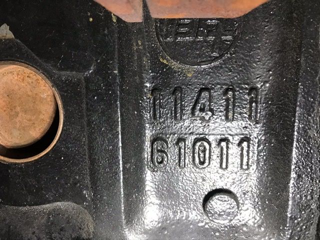

11411-61011 (Image A)
Block 60323 (Image B)

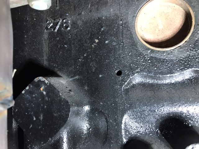

276 (Image C)

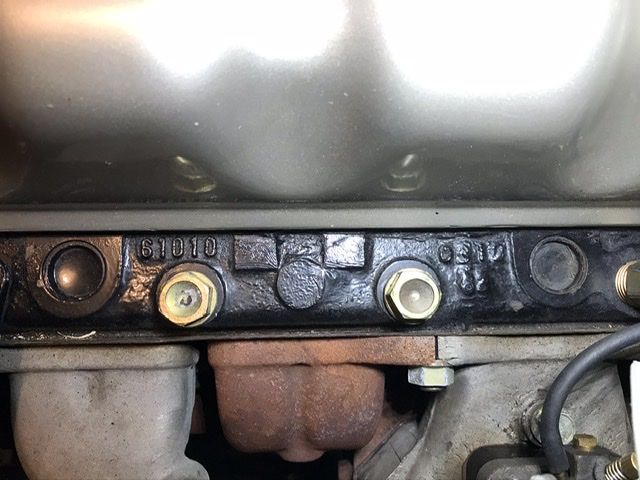

The head has following numbers: 61010 then 031082 (Image D)
SOR said my head 61010 was from an 8/80- 8/87 2F? Can someone verify?
What do these numbers mean? I just cleaned mine up and saw these numbers.
I’m not sure but hope the knowledgeable MUD community can educate us. Anything I share is conjecture. However, after reading a bit more in this thread, I updated my previous post referencing the images now as A,B,C,D).
A - Part number for engine block
B - Casting date of engine block
C - Unknown?
D - Head number part number first stamp (still not clear on what second stamp number sequence are).
