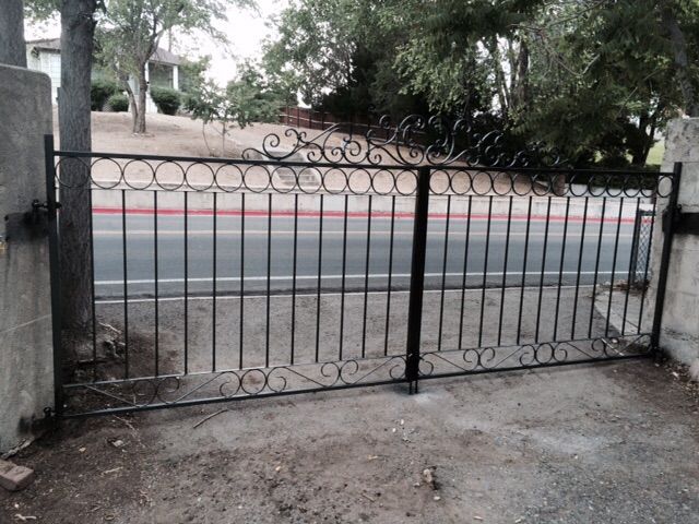

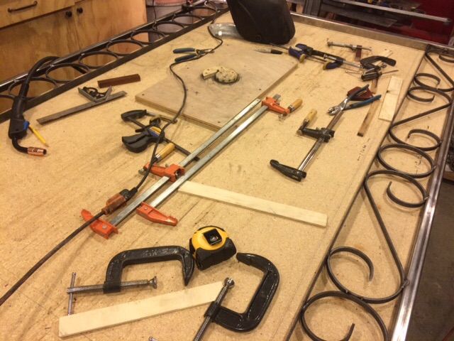

Long story short - I got pulled into a quick, down and dirty home rehab for a family member that I could not avoid. The project has taken nearly every free minute of my time but I won't bore you with the details. However, the one cool thing that came of it was I was forced to build a set of decorative steel gates. I've never done this kind of thing but felt that I was up to the challenge.

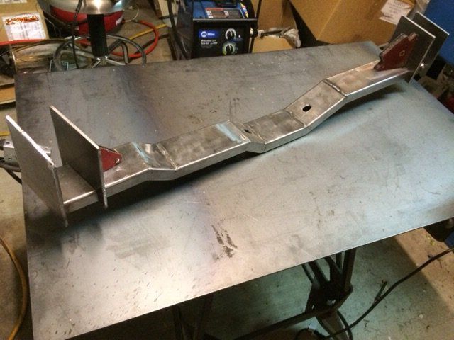

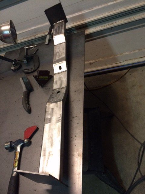

Also made great headway on the crossmember tonight...

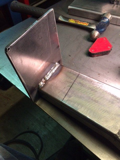

Question for the group - I made a second set of brackets to weld to the crossmember to sandwich the frame (see pic). Figured I'd run three bolts thru the frame and bracket on each side to secure it. Starting to think that the sandwiching brackets are overkill.
Mocked up:
Thoughts?
I'd use two. That second bracket will shorten the span by four inches or so, which will add stiffness to the crossmember. Plus you'll have more weld supporting the weight.
Crossmember Finished!
Welded on the second set of brackets based on Cam's prudent advice. Shot some primer and paint and she's looking pretty good.
Added some spray can bed liner for a little extra protection and because I think it looks cool.
And after drilling a mess of holes got her mounted up with some shiny grade 8's.
For the first time the new drive train rests unassisted in its new home!

The 5.3l combined with 4l60e pushes the TC back about 12" (give or take). Because the frame gets wider as it goes back the stock crossmember will not span between frame rails.
However, if you're considering then same swap for a 62 I believe you can reuse the stock crossmember as documented in MarkN and Daytonadoggie's threads.

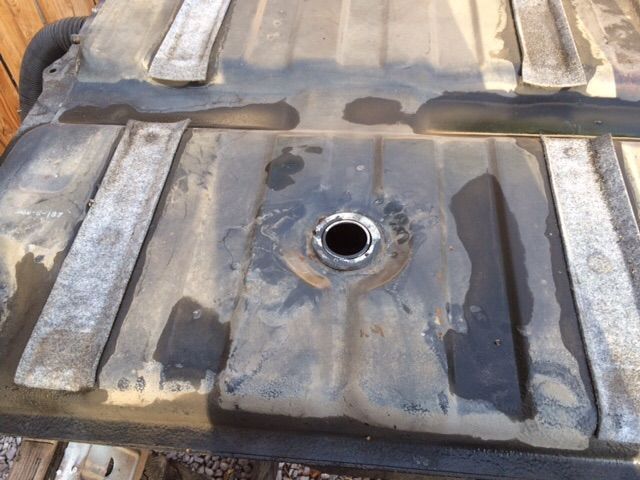

Pulled the gas tank this afternoon in preparation for the in-tank pump installation and new plumbing. Dissappointed to find that my tank does not have the factory depression that I've seen in other threads. Not sure what's up with that? Difference in model years? Oh well...:meh: Guess it will take a little more work with the hammer and dolly.

After several washes and pumping air continuously with a shop vac I felt I was ready to drill the 4.5" hole. No turning back after this:
This handy sump is revealed underneath
