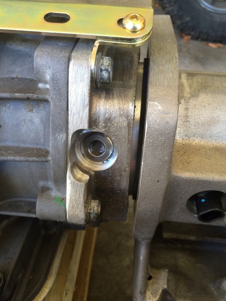

Cam, thanks for the heads up on the bearing and adapter. I wasn't sure it looked right and I'll watch it as I proceed. It is my plan to assemble the entire drive drivetrain on the bench. Got as far as I could without having the old engine pulled yet.

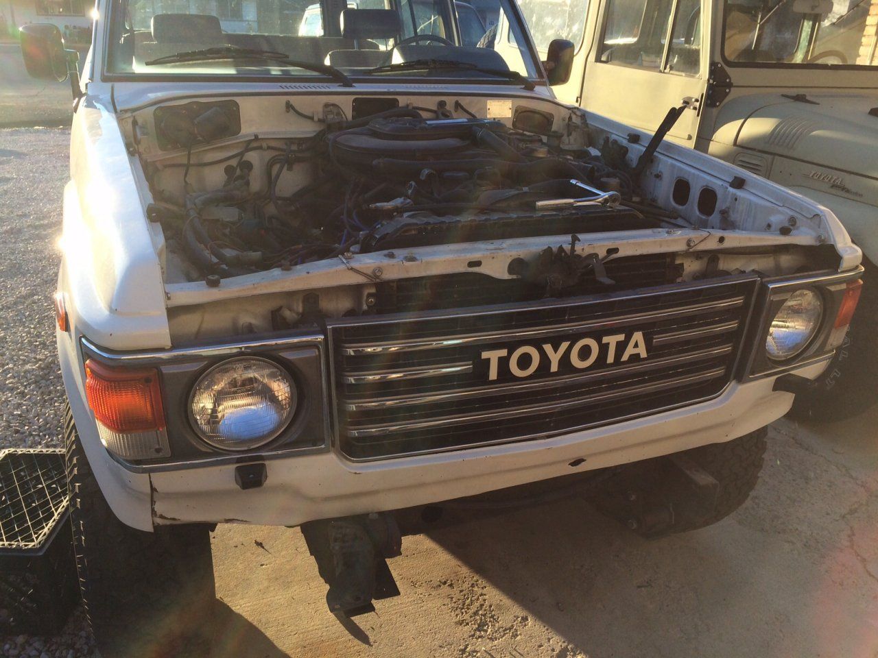

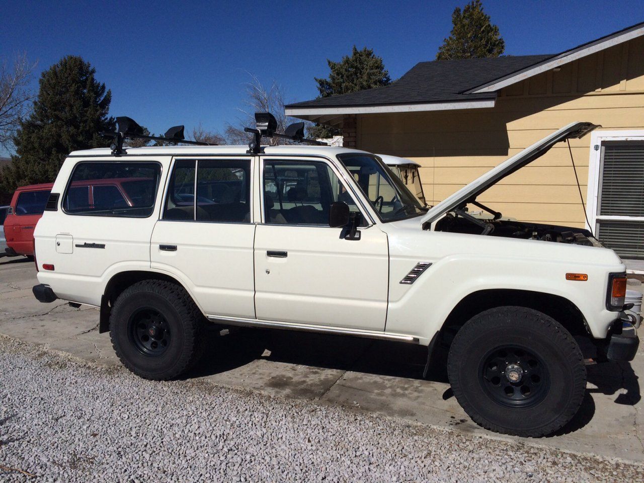

Last time she'll look like this for a while:

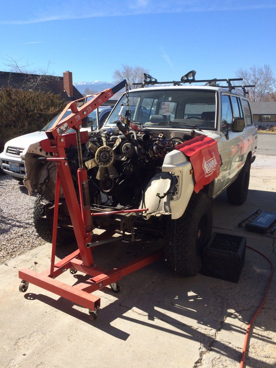

Started tear down
I don't know what the best way to remove the clip is or not but if you undo any of them make some marks so you can align them easier upon re-assembly.
I would honestly try to pull the fenders off along with the core support. Not really sure what needs to be undone to achieve that. But I've seen pictures of it being done.
That's the same one I used. Do yourself a favor, and get it fully assembled and adjusted before the final install. Mark the best location on your test fit and install it out of the truck. You can unscrew the lever and put it in last.
I didn't because it looked like it would go in easily, and I ended up having to tear out the front seats and carpet to get to all the bolts.
Also, don't forget to put the rear shifter bracket on before the adapter. I think the bolts are too long to get out otherwise.

I just left the fenders and front supports on. You don't really need to take them off unless you are doing some serious restoration.
I thought it was easier to get the height and radiator clearance figured out with everything on, too.
If you do pull the whole clip, keep it intact and use your engine puller w/ratchet straps to pick it up.
I removed the hood and the radiator cross member / grill, left the fenders as is. I hope you marked the hinges on the hood ...it can really be aggravating to get lined up on install.

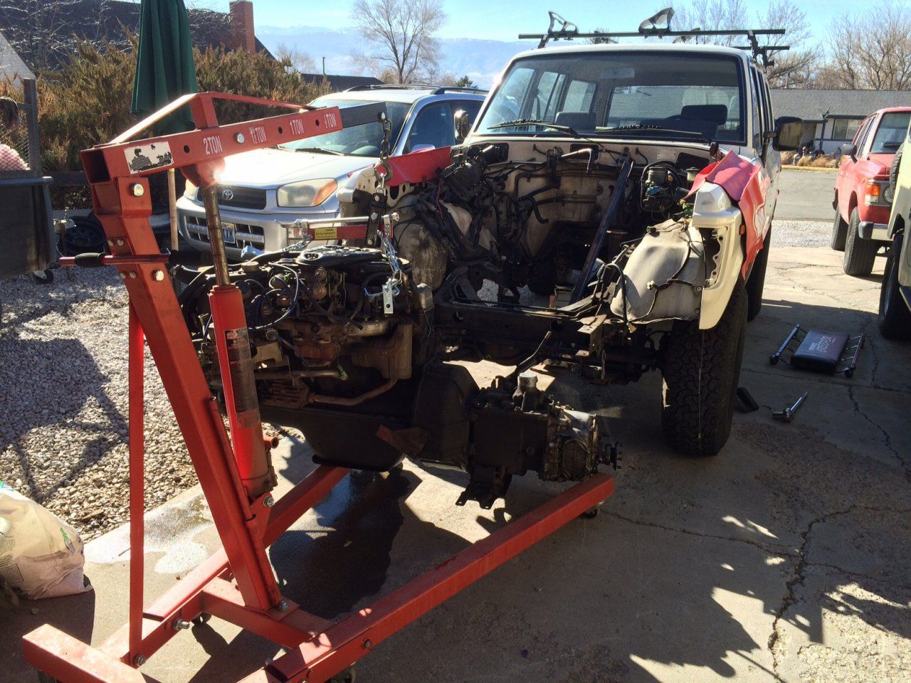

Took the advice of FJ60Cam and others and left the fenders on. Unfortunately as I was pulling things apart I found the body damage I mentioned earlier extended to the core support. I've got a line on a replacement tho. Good news is I believe the radiator must have been replaced recently as it looks like nearly new.
After several hours, much cursing, yanking, etc. I dragged the old lump out. Felt like I had wrestled a grizzly when it was done.
Goodbye spaghetti, I'll miss you least of all...
Phew!

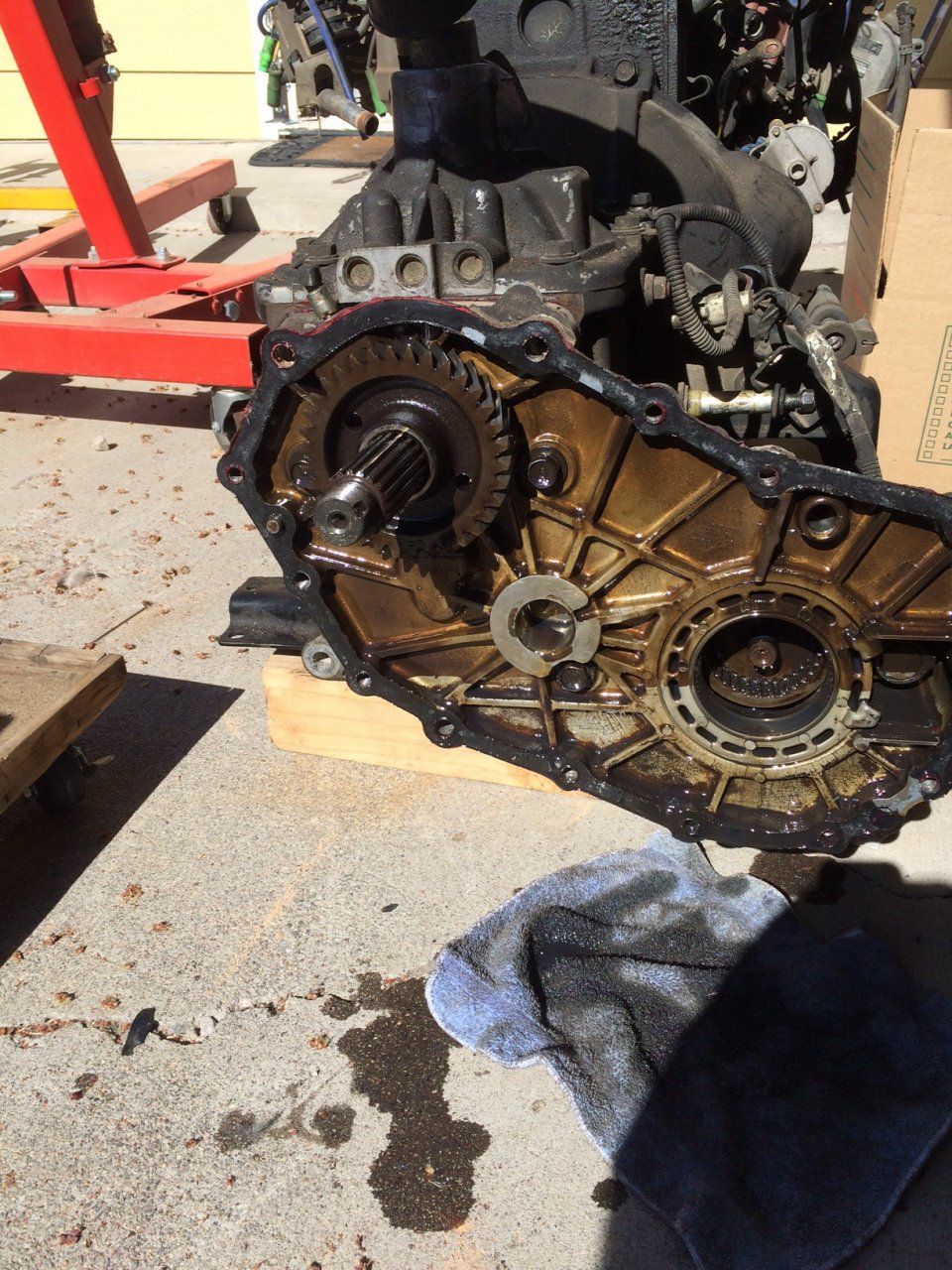

I tore into the transfer case several nights ago. I did a full rebuild on it a little over 1 year ago so I figured this would be an easy part of the build.
Naturally it turned into a larger project than I anticipated. Some of the gaskets that I thought would be fine to reuse have to be replaced. And frankly, the rest of the drive train is looking so new and spiffy the transfer case kind of lets it down.

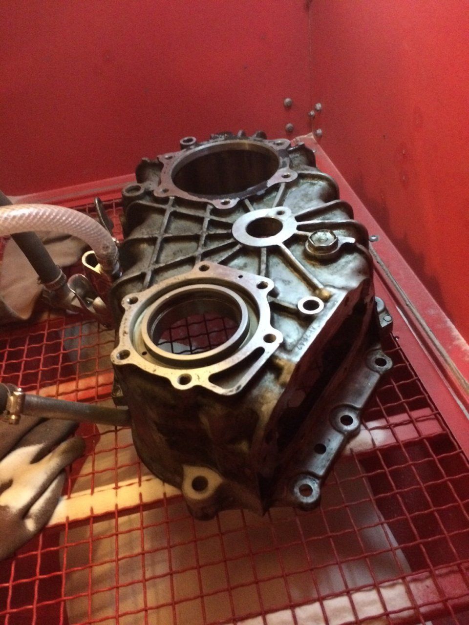

Then into the blast cabinet
Now the case is looking good!

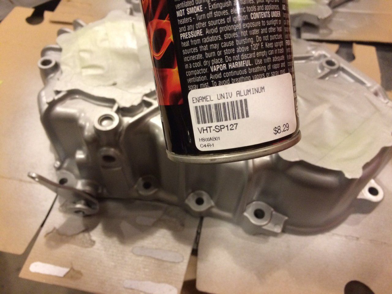

Added some VHT engine paint, aluminum color
In hind sight blasting the case was a lot of work and required pretty extensive cleaning to ensure all traces of the glass bead media were removed. It looks good now but not sure I would do it again.

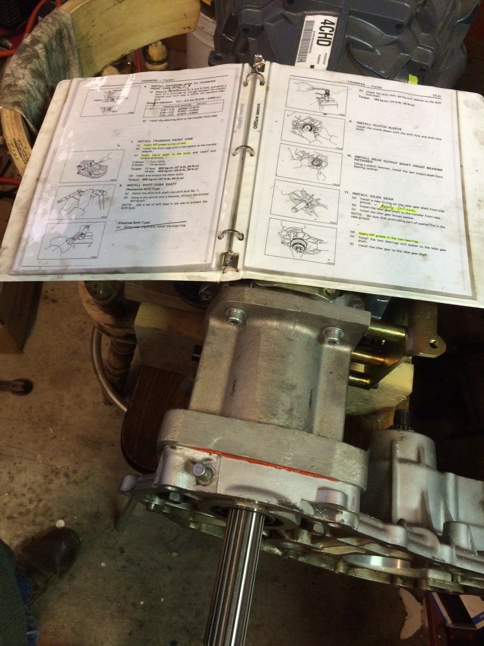

Started reassembling the TC. Waiting on the new gaskets but got as far as I could.
These two threads from MarkN and M1A1Cruiser made for excellent reference in addition to the FSM.
You guys tell me if something looks amiss ok?
