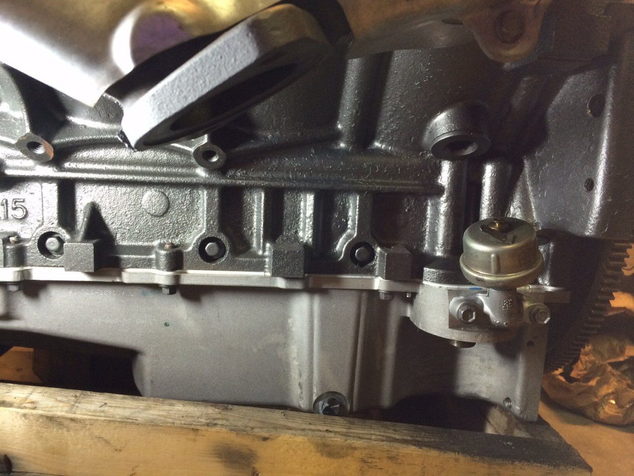

Oil Sender
I'm going to run the Toyota factory gauges. The vortec motor makes it easy to adopt the Toyota oil sender in this spot above the filter. Found this tap on Amazon for 8 bucks.
Tapping this thing was a piece of cake :cool:.

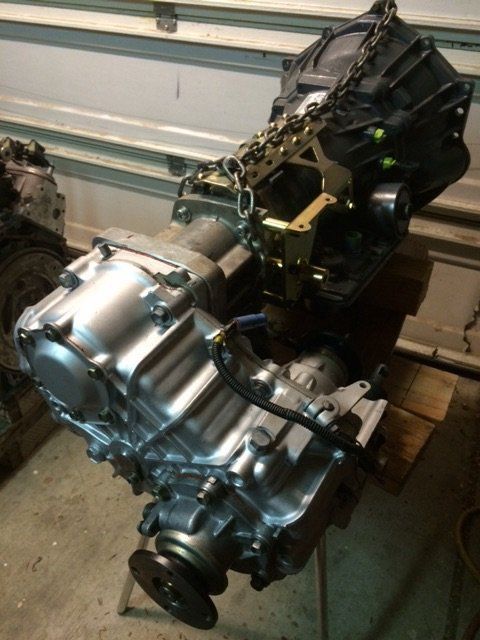

Reassembled the transfer case (this is only my second time doing this) and seem to be having trouble with the high low lever. I know its tricky, but I really thought I had it right. There is some movement with the lever but it seems to be stuck. The TC is almost completely finished. I don't want to tear it apart! :censor::censor::censor:
Can you guys check out the video and confirm that it is not shifting correctly. If it is 'F-d' up do I have to disassemble to correct? Any clever fixes? I may post up a separate thread if needed.
Thanks in advance!
Ed
Yeah that's not going through the range of motion. Can you spin the flanges and get it to slip in? Maybe try in 2 & 4wd?
Yeah, tried that with no joy.
I really don't see anything for it but to open it up and do over. Live and learn, eh? Hope I can reuse the gaskets.
It took me 2 tries to get it right too. I can't remember exactly what I did wrong, but I ended up breaking the case apart to correct it. It did go back together easier the second time though.
Since you have the stock high/low lever attached, does that mean you are using the stock shifter?
If you are going with twin sticks, the time to put the new lever on is when you have the case apart, or you risk dropping the shifter into the case doing it after it's all assembled.
Finally got the TC back together!
It seems to shift correctly now. Not sure exactly what went wrong the first time that prevented it from shifting :shrug:. The upside is I feel like now I could almost assemble one of these from memory alone.
One question, should I be concerned that the new AA shaft does not have a notch that allows me to stake this nut?
Mine didn't either, and I don't think the nut went down far enough to stake or I would have cut a notch.
AA gives a lower torque # on the nut, too, so I guess they feel good about it. I went with the higher number in the FSM.
