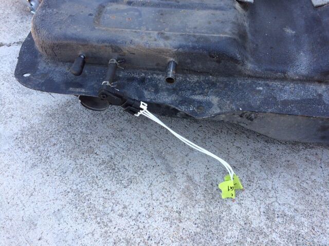

One last shot of the fuel tank before she goes under. Picked up a couple weather pack connectors for the fuel pump and GM sender.
Put the fuel tank pressure sender here based on advice I got from Georg.

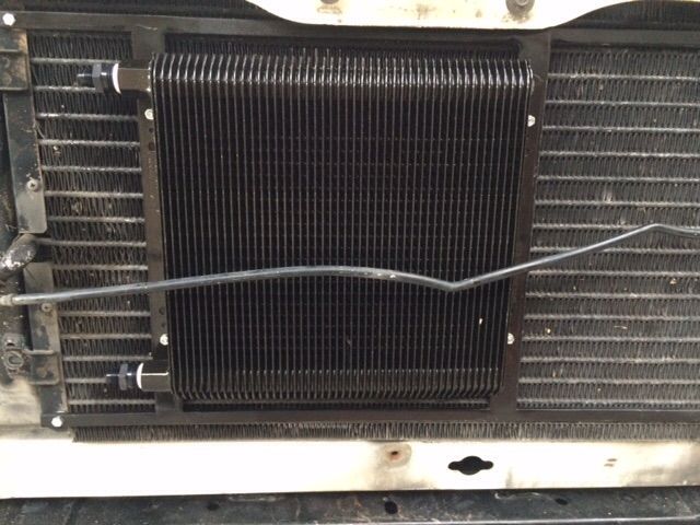

Transmission oil cooler
Got started on this today. Made up a bracket to mount to the front of the AC condenser.
And after a bit of paint its attached to the condenser. There's a couple nylon spacers the to keep the oil cooler clear.
Question for the group: where do the tranny supply/ return lines go in this picture? Top or bottom? The oil cooler instructions did not give any direction so I'm wondering if it matters? If that's true then supply line from tranny into the top seems to make sense to me.

It doesn't matter. Hook it up which ever way is easiest. Looks like you're making great progress!
I'm probably going to switch to that one. I'm using the 70264, which is half the size & btu rating.
My only concern is that the smaller one has a low temp bypass. I'm not sure the bigger one would ever let the trans warm up in the 20s/30s/40s without running it through the radiator.
Just a concern though. And only one way to find out.
That's a valid point. It's not uncommon to see teens and single digit temperatures in the winter time here. I want my truck to be ready to kick ass in any condition, especially in the winter.
My stock rad has no provision for cooling transmission oil. I assume 62 radiators do - maybe I should be shopping for one.

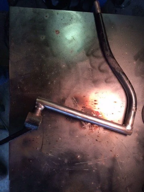

Finished the install of the Lokar shifter. Only have a pic of the linkage underneath for now (more pics of the shifter to come)
Was struggling with the TC shifter install until I actually read the complete instructions that came with the AA adapter. Turns out I should not have installed the spacers in this pic:
And needed to notch the adapter plate something like this:
And furthermore I modified the TC shifter lever as shown (another idea borrowed straight out of Cam's thread)
