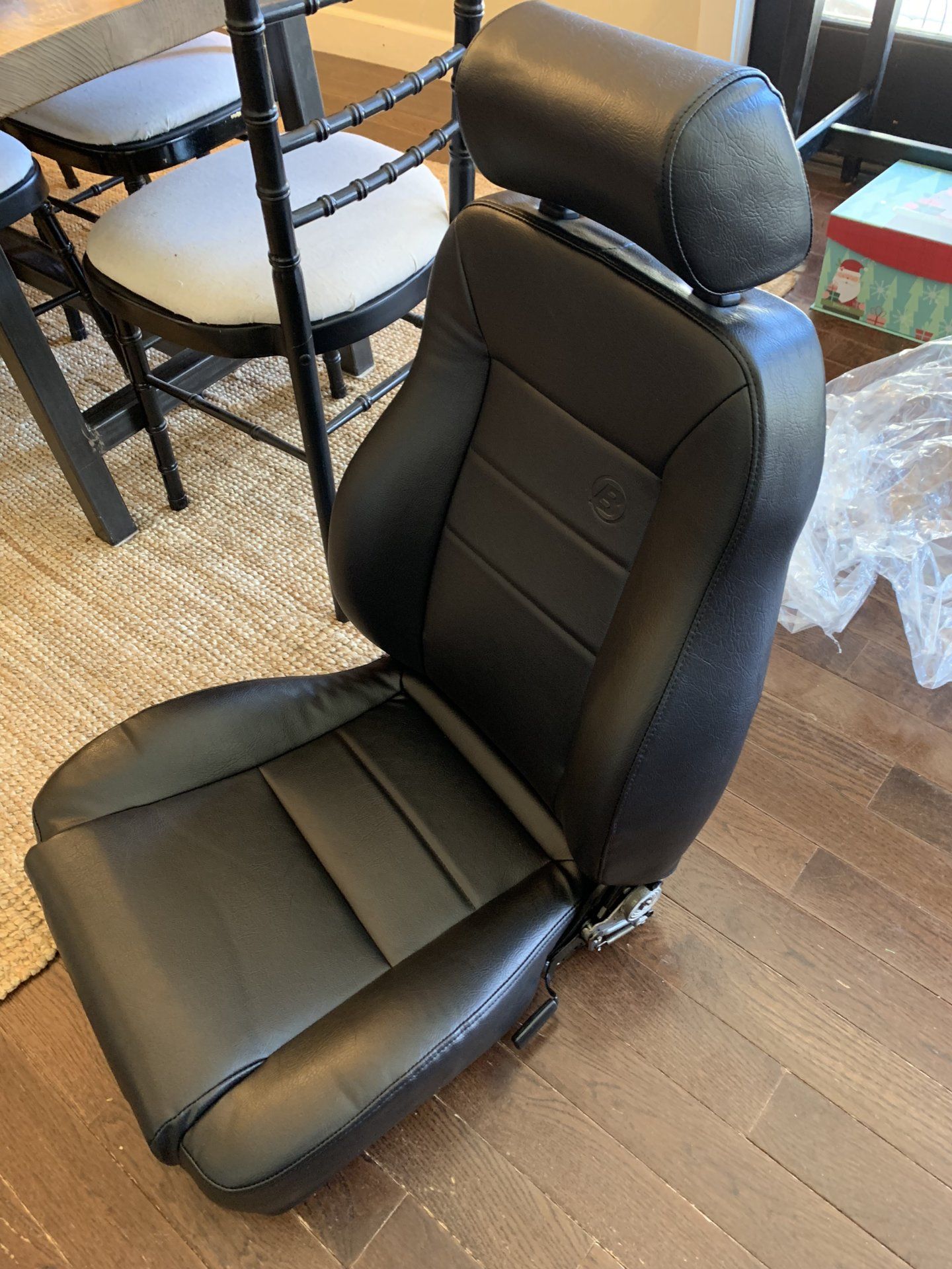

Time for some new seats! As mentioned earlier in the thread the BMW seats just sat too high in the cabin. It was not a natural or comfortable position. I think this is not a problem if you have an ‘85 or later as the floor mounts are different and lower.

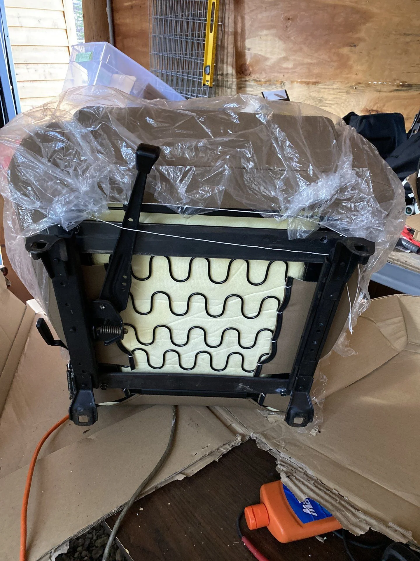

I shopped around a lot and finally settled on the Bestop Trailmax II seats. I like these a lot, they have decent bolsters without being overdone, nice lumbar support and the size is perfect for the cabin of a 60 IMHO. They’re Designed to bolt up to CJ Jeeps but I figured I could come up with something to fit them into my truck.

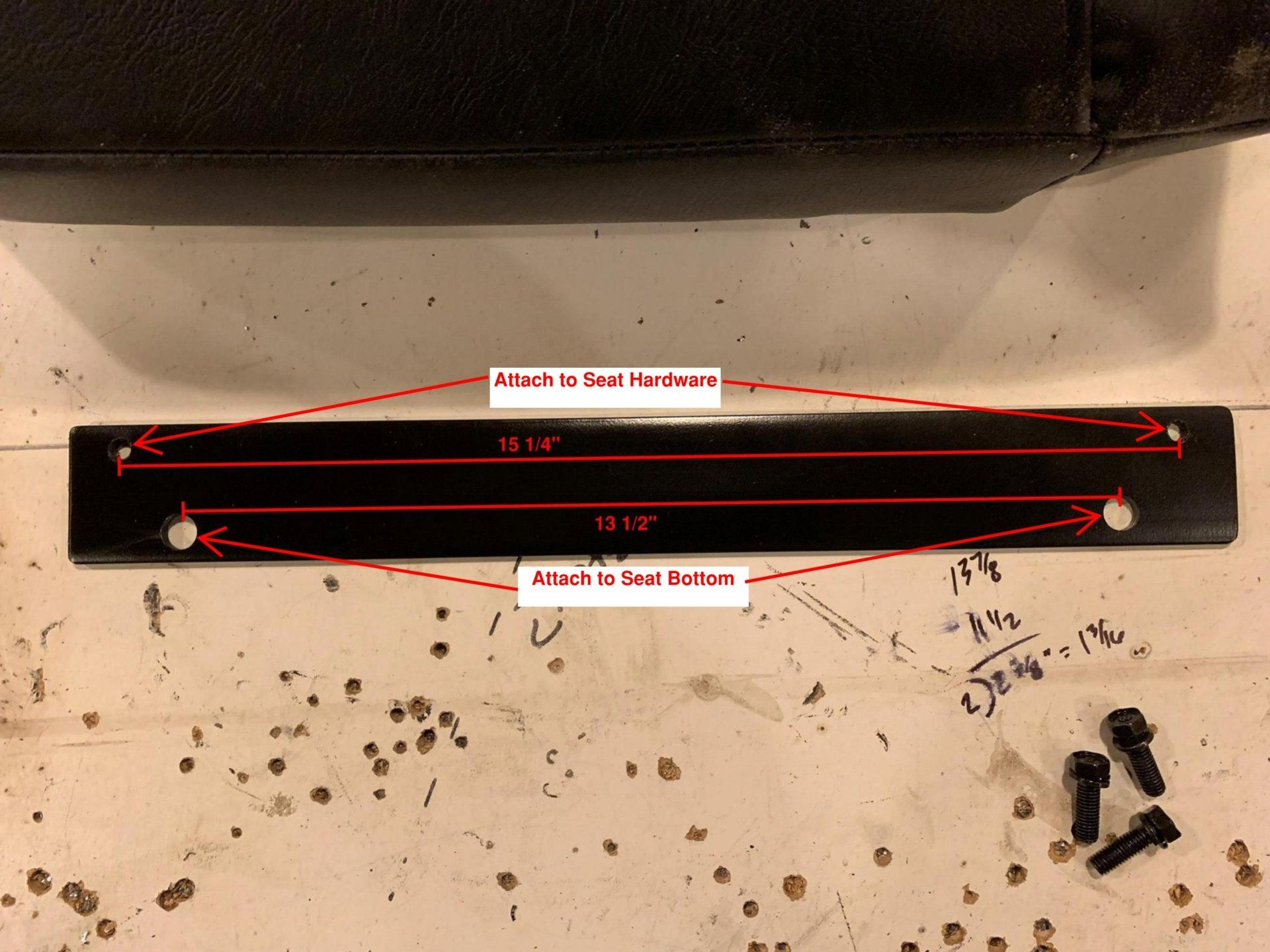

Fitting them into the cruiser was pretty straight forward. For anyone interested here’s a shot of one of the brackets I made with some dimensions:
You’ll need four of these brackets that are made of 2” flat bar that are 3/16” thick. I drilled and tapped the flat bar to take the stock seat hardware (8mm x 1.25).

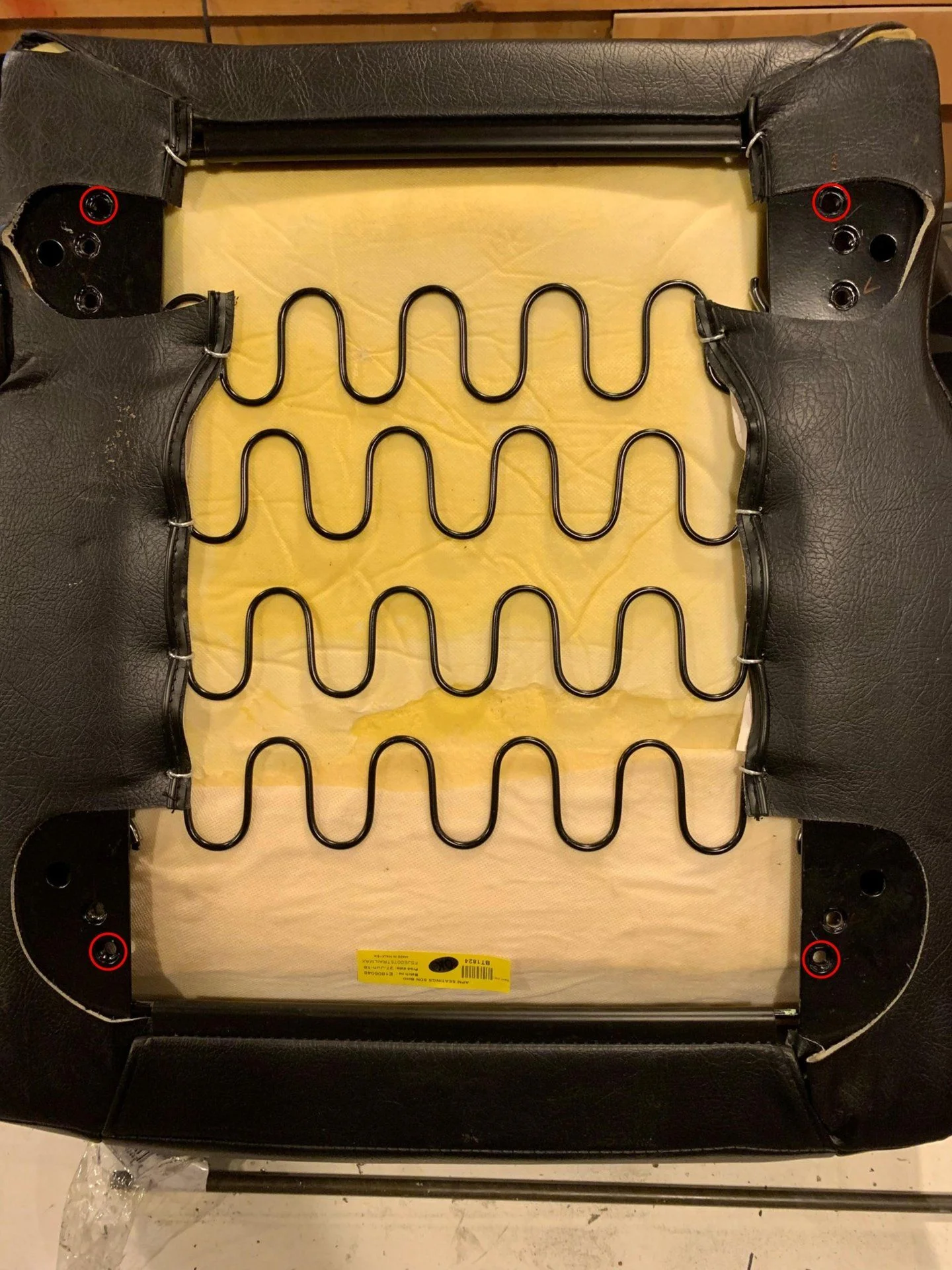

The brackets attach horizontally to these holes in the seat bottoms:

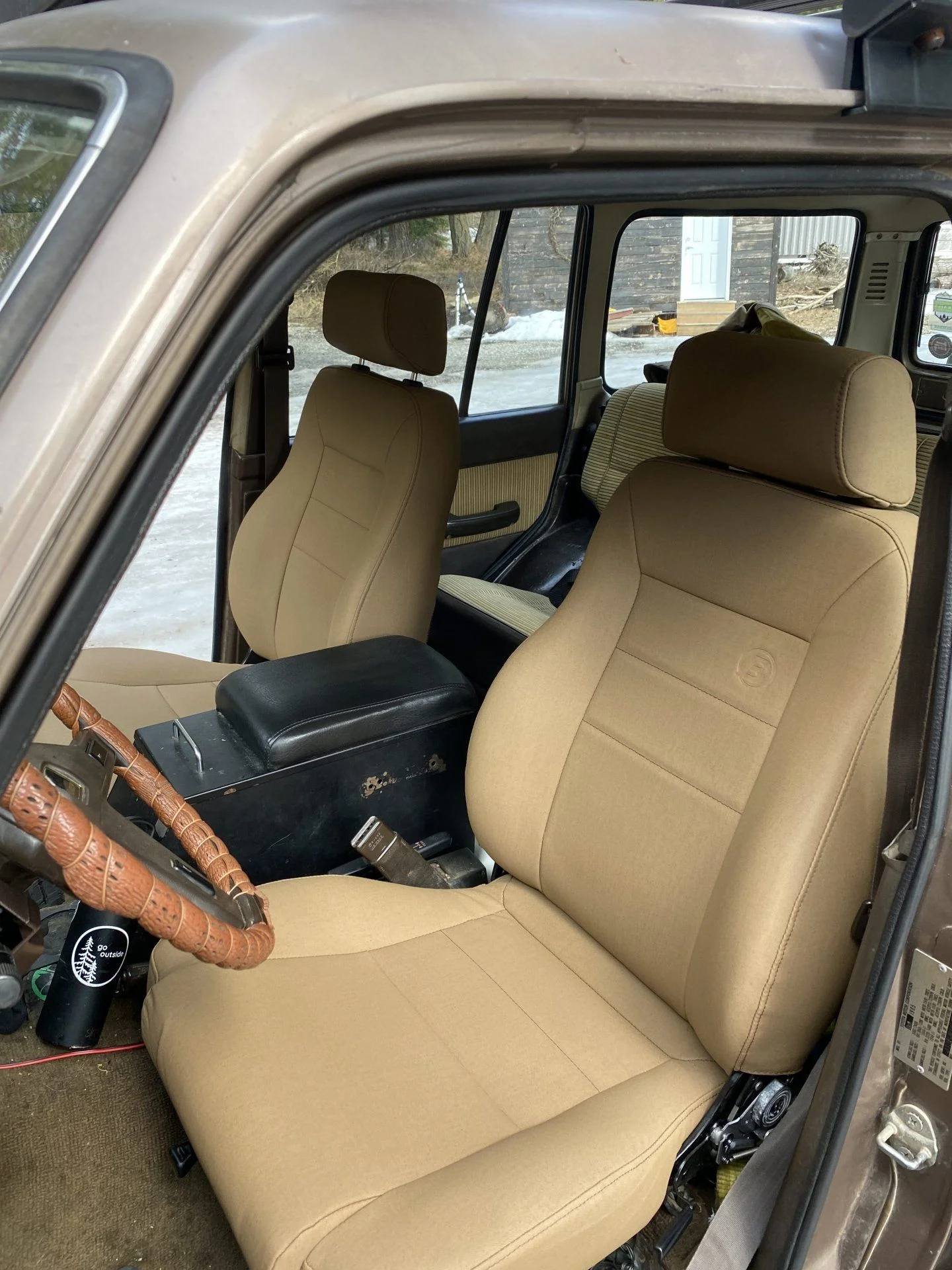

Nice job paving the way @cruiser enthuiser! Just finished my install. :)
Do those bestop seats have adjustable lumbar? They look nice! 🍻
Nope, not adjustable. Fit me really nicely, been rocking them for 2 years and no complaints. For the money I think they’re tough to beat.

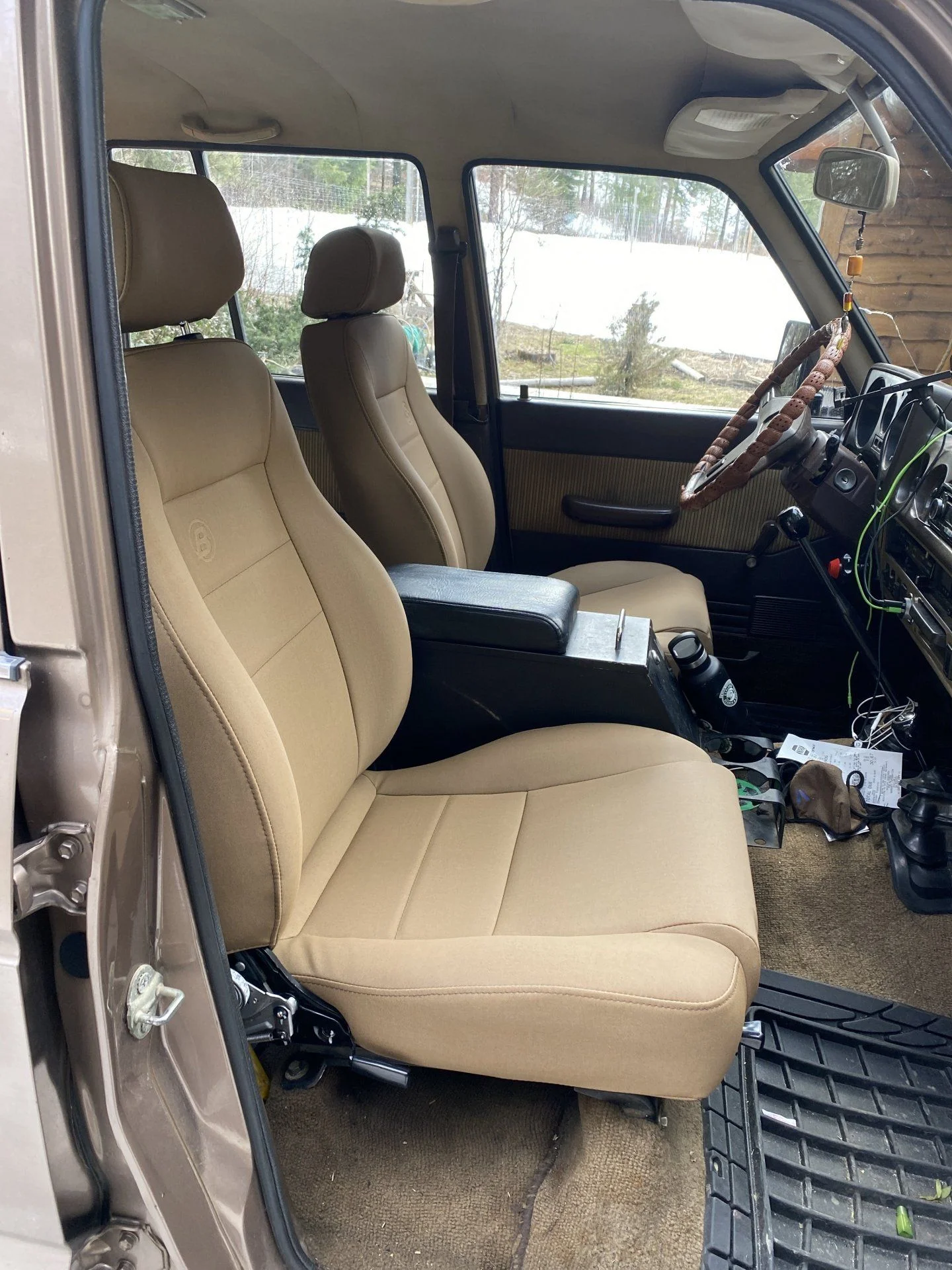

How do these seats fit compared to the original ones height wise? I'm 6'3" and I'm worried my head might hit the ceiling, these are the best matching seats to the original interior that I've seen, theyve gone up in price a bit
When I installed mine I recall that they were damn close to the original seat height. Maybe 1/2” to 3/4” higher or so.
I'm only 5’8” and they're great for me. Maybe someone taller than me whose done this swap can chime in on their experience.

These came out nice. I didn't see any mention of the difficulty of making the bracket. Can a newbee make these?
I don’t think it could get much easier. Buy some 2” flat stock, cut to length and drill and tap some holes. I posted the measurements earlier in this thread.
