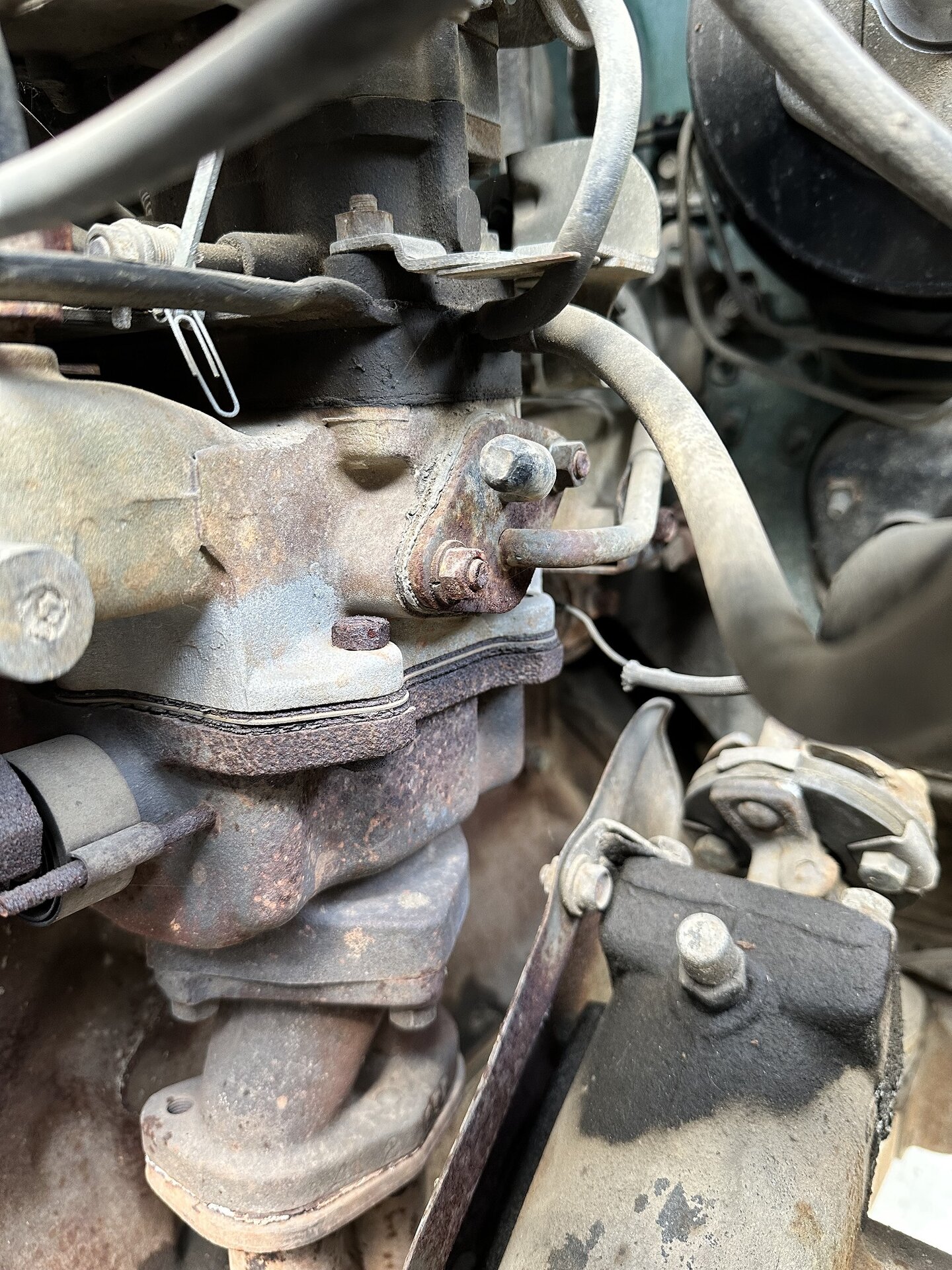

Hello I have 2F. I need to know what is this part in the image. It leaks some gung, but that's it.

What year are you working with as different years have different configurations.
Good point; what I posted is from the 1981 factory emissions manual.
Mine is 1983.
Then the 1981 emissions manual pages I posted are the right ones for a U.S.A.-spec 2F; yours may be different. On mine, there is a hose that goes from the PCV valve, around the back of the air cleaner, that connects to a metal tube on the driver's side of the engine. This metal tube bolts on to a fitting on the intake manifold.

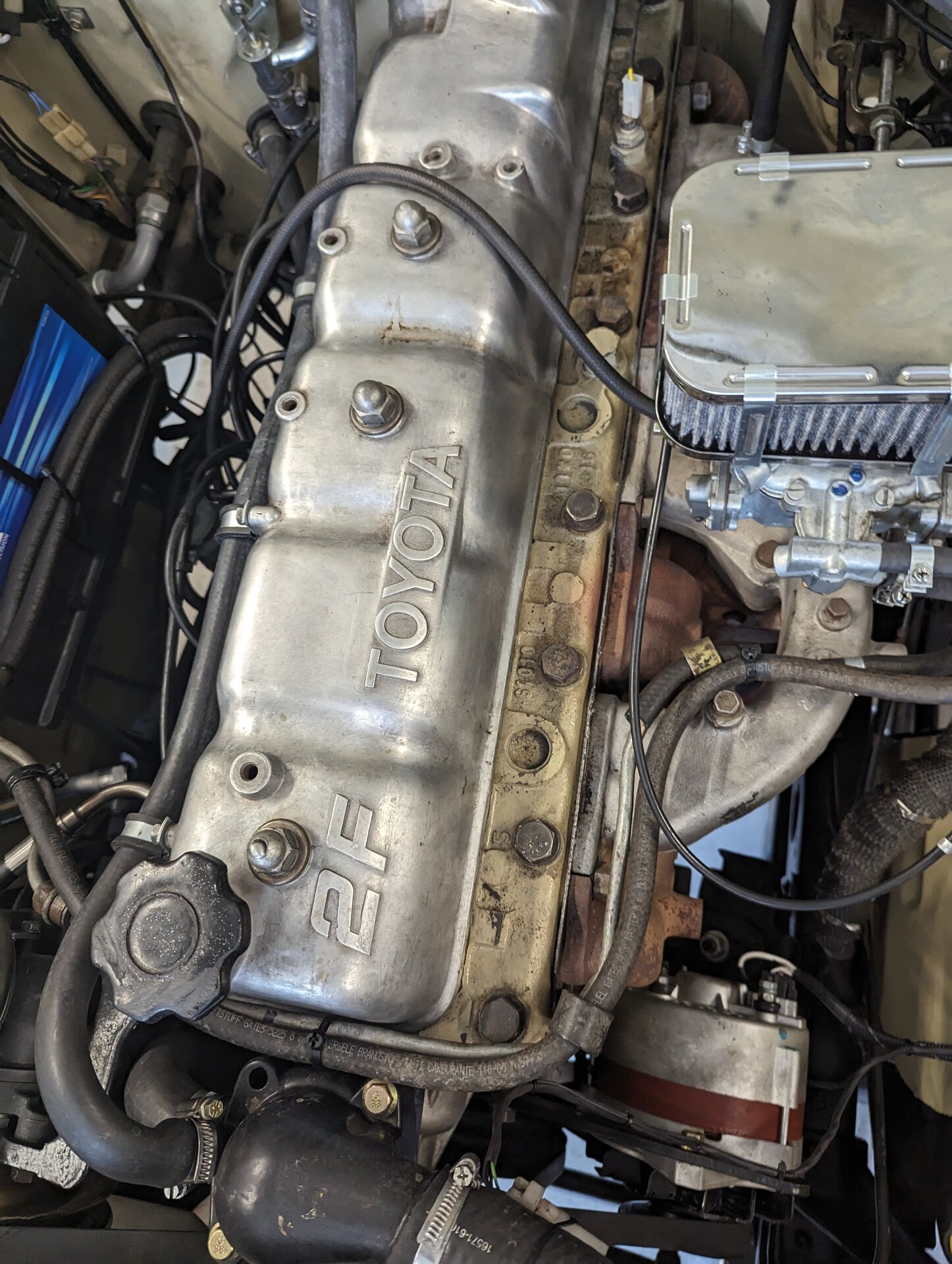

Photos of mine:
Photos of mine:
View attachment 3386678View attachment 3386691
Hi Lee, ok that makes sense, I will send some photos of it for you., Cheers Julian
Since you don't have the stock carb or air cleaner, I would put a T-fitting in the line going from the back of your valve cover and the bottom of the air cleaner. Then run a hose up from the PCV valve to the T-fitting.
You mean put a T-junction on this hose.
