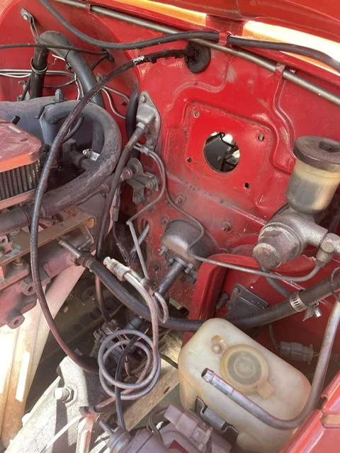

is this brake booster an appropriate upgrade for the 1977 2F original?
Thanks for any help.

My 2 cents.... it is too cheap to be good .. but I am sure some people use it without problem... for the first year...
I am also very happy with my city racer booster!!
I have NEVER been happy with any eBay purchase. Too easy to scam with no recourse. Not as described and missing items 100% of the time.
I have a74 with 83 front disc brakes.
Got the 93 MC/booster/ proportioning valve set up to keep rear drums. I didn't even have to adjust the booster length.

I installed a tandem booster from City Racer on my ‘74 and found it to be an increase in brake assist. I have large heavy tires and needed more braking force.
My experience also.

Don't know, but the one I bought from him is a heavy-duty, quality unit that has served me well for years now.
I bought mine from City Racer, it has a spacer of about 20mm or so, as the 76 FJ40 original was much bigger, larger diameter and deeper.
The little rod that drives the master cylinder piston needs to be adjusted - mine was too long and it was putting the brakes on all the time... they locked up on me a couple of times until I adjusted it.
