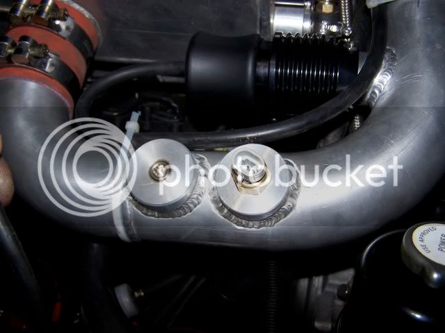

Popped down to Awill4x4 today for a little Tig time.
Tks Andrew and hope you Enjoyed the ride :hillbilly:
Now I can measure pre and post intercooler, once connected up.. Also braced the rear intercooler radiator.

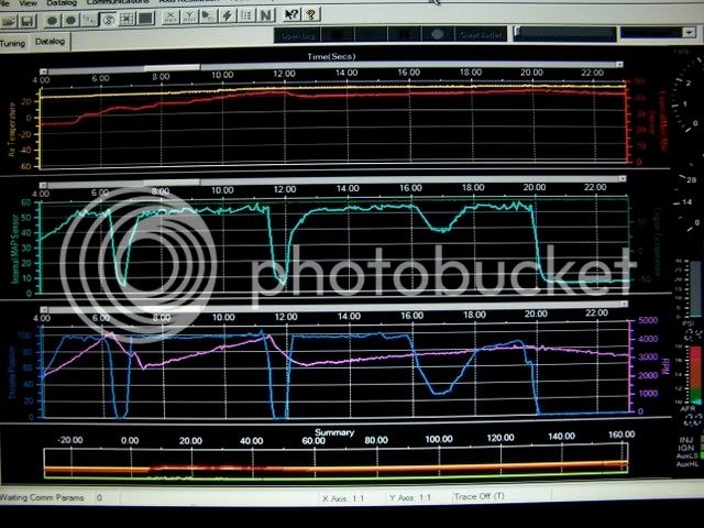

I've been testing NOT Hooning :D
Pre inter cooler cruising temp is 50C/122F
Full boost rises to 82C/180F
Post inter cooler cruising temp is 25C/77F
Full boost rises to 31C/87F
Note the heat rise was only on the second run first run showed a 1C drop post intercooler. After 5 runs no post intercooler temp over 31C/87F
Ambient 12C/53.5F
Calculated Temps are spot on too :eek:
Spent the evening calculating Turbo outlet temps for the Garrett GT3082R @ 70F/21C ambient and from what I can work out at 9psi the outlet temp should be around 180F/82C at 15psi the outlet temp rises to 227F/108C.
The photo of the graph below shows 2nd to 3rd to 4th
The Red line in the top graph is Pre intercooler temp, I am using the external map sensor input to read it so the scale is wrong, you have to multiply it by 1.82 Right side
Yellow is correct. hope that makes sense. Left side
