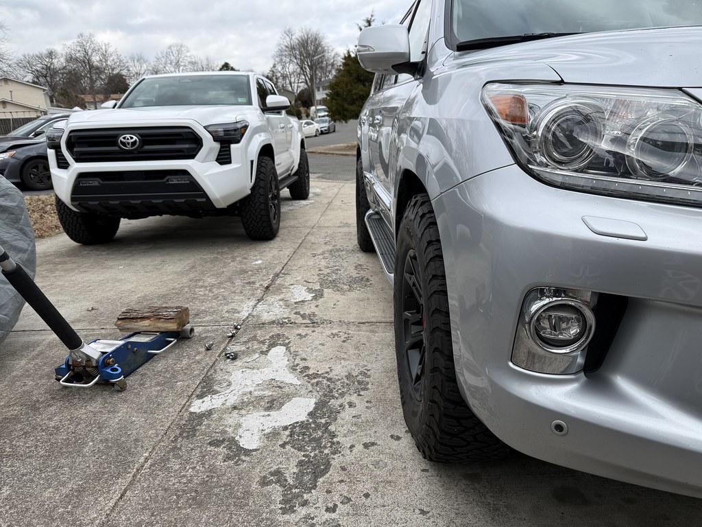

Here's mine after the install today.
First impressions are they feel much firmer than the tires previously on the car. Steering also feels a touch heavier, but that could be due to the spacers. I don’t quite notice an any difference in acceleration in city driving, but braking does feel like it needs more force. There is still some rubbing at full lock in reverse and under brake dive. Looks great, obviously.

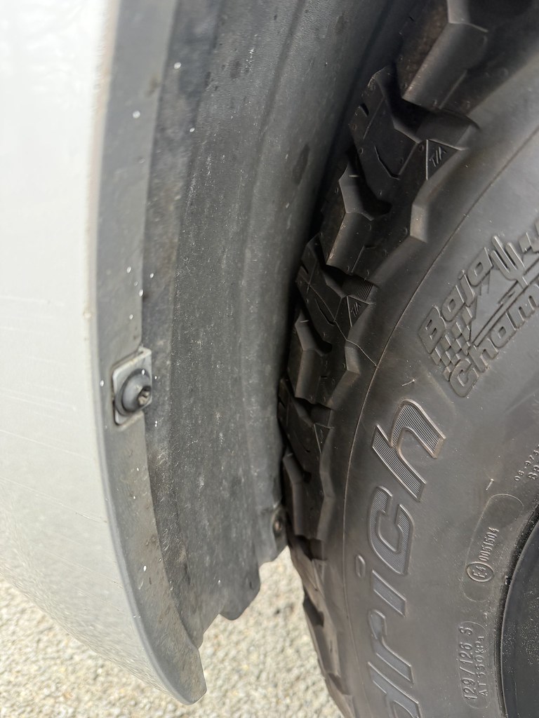

For rubbing, it's likely the forward part of the wheel well liner. Super easy to pin forward, and this strategy is adaptable all the way into 37s.

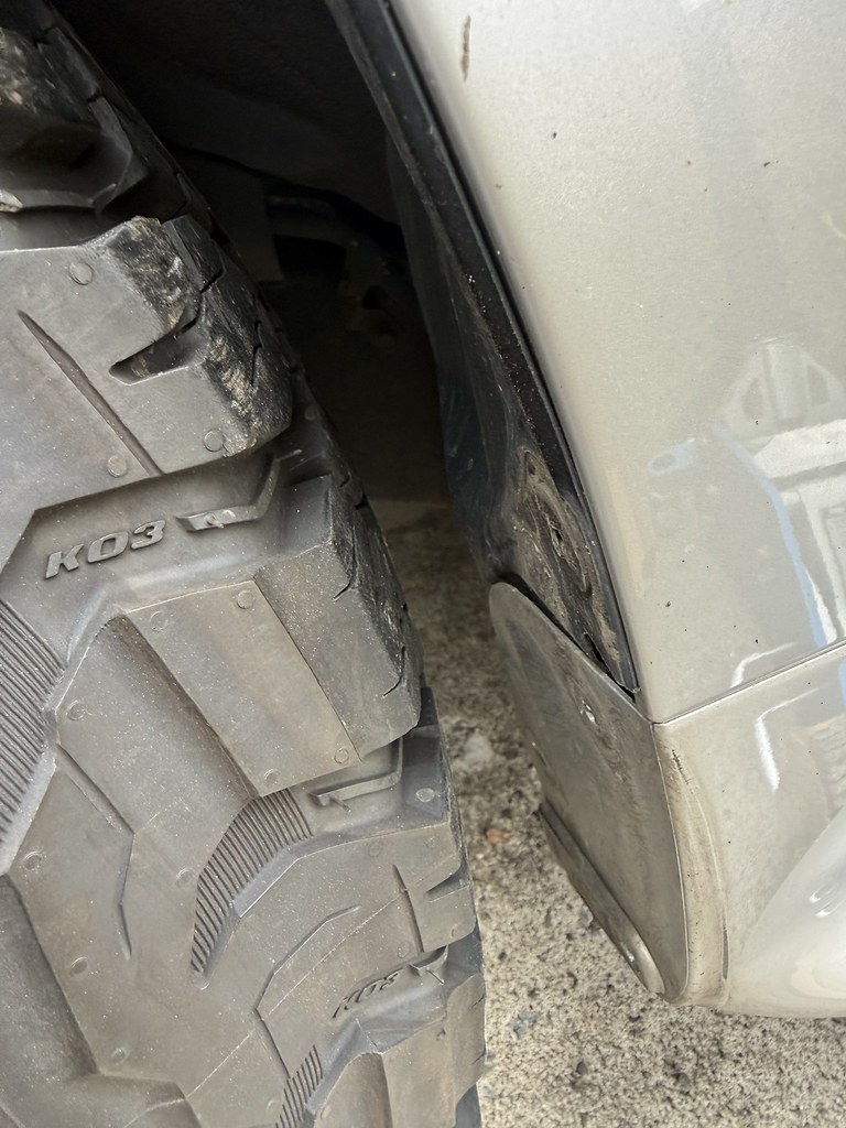

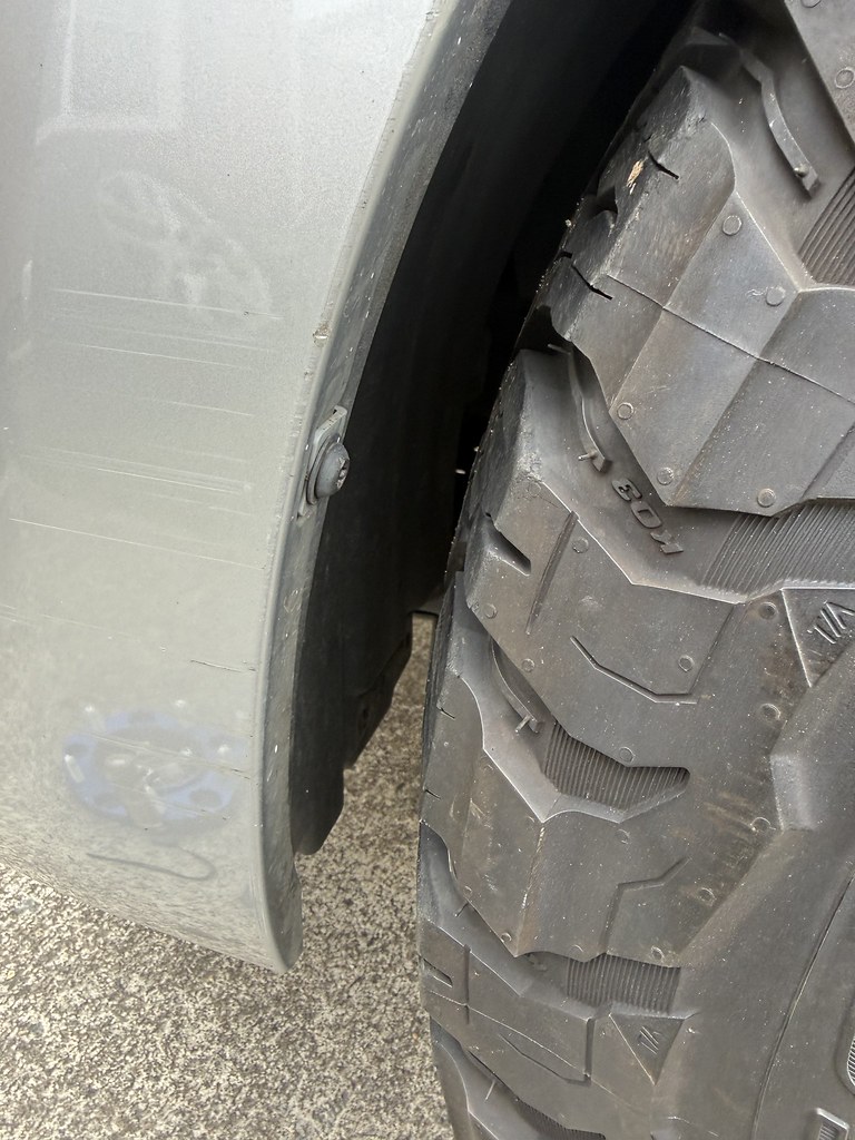

Mannn I hate you guys, should've never read this thread lol...but here we are, the wheels and tires are on and boy do they look sick. I didn't notice any loss in power nor does the truck struggle going up an incline. The only thing that took a hit was MPG, and it's big, like 2mpg but it is what it is. Braking takes a little bit more effort but it's not drastic, overall, definitely worth it. I clear the mudflap area and body mount by an inch or more so that's not a concern, the front fender liner will need to be moved forward a little more as i get a little rub there when in low mode and doing a U-turn. Normal driving there's no rub.. i think +30 is a great offset to run these tires, maybe +35 but it's hard to find. Anything less and you'll have more problems with rubbing
Wheels are 18x9 et +30mm
295/70/18 BFG KO3
Suspension (stock) not even sensor lifted
Wheels and tires together weigh 90 lbs on my bathroom scale, not that bad !
Sitting flush
Mud flap area in low mode
Front of whell well area in low mode
And this is where it rubs in low when turning wheel all the way, i'll just need to push this liner forward 1/2" and should be good..

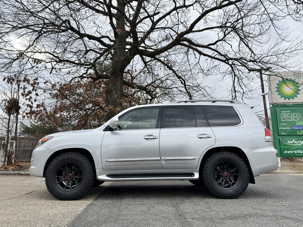

Back in action with stock wheels and 295/70/18. I’m not getting any rub, and I have a 1.25 inch wheel spacer.
I got a very good deal on a set of recon grappler. Very happy with this set up so far.
You don’t rub because you got that bumper, hehe. I had to push my fender liner forward at least an inch to clear the front of the tire
