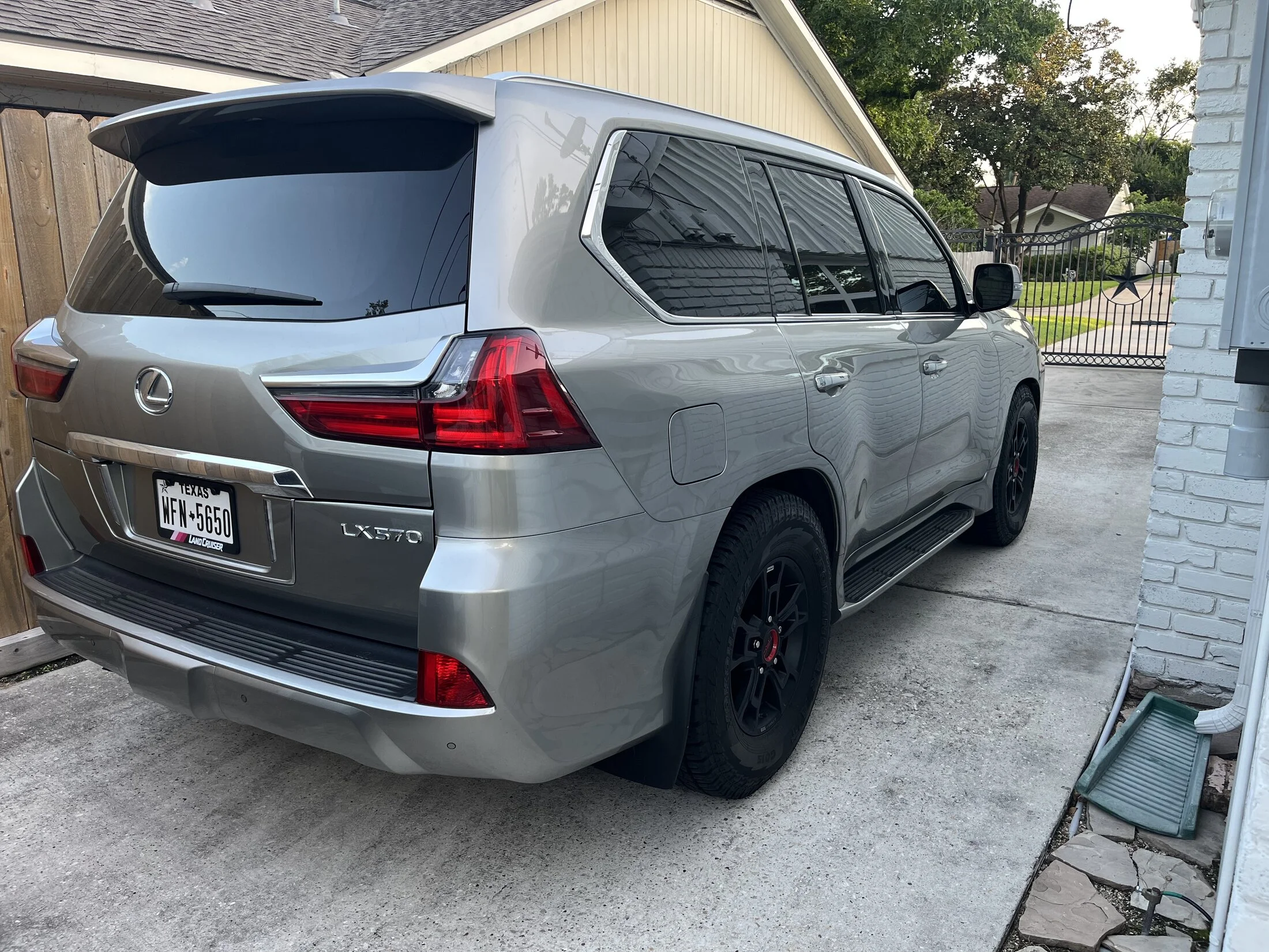

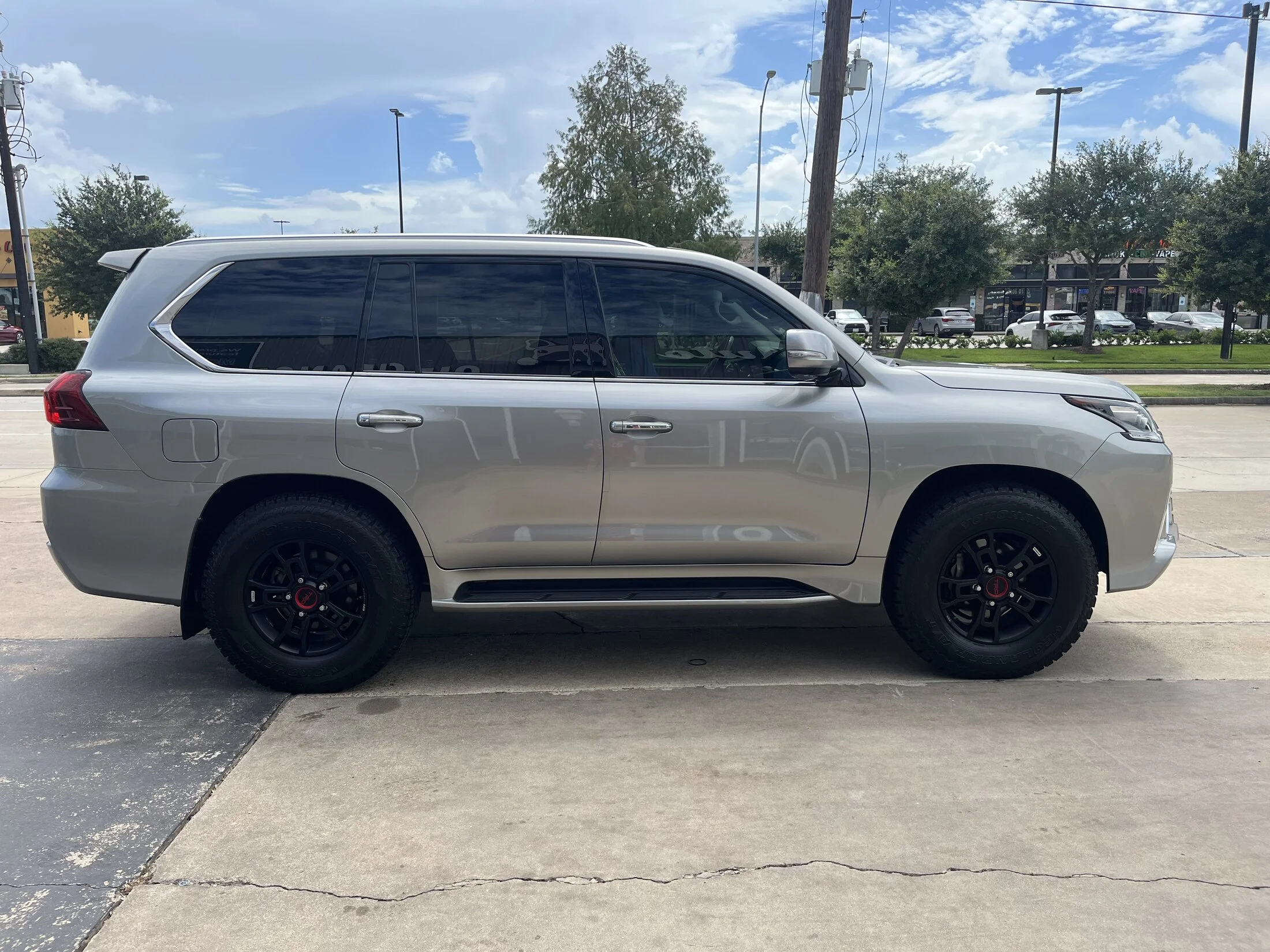

295/70R18 Geolandars and TRD Pro wheels. This was the set up I had on my Tundra. Look and ride great on the LX, but I need to trim the pinch weld on the driver’s side.

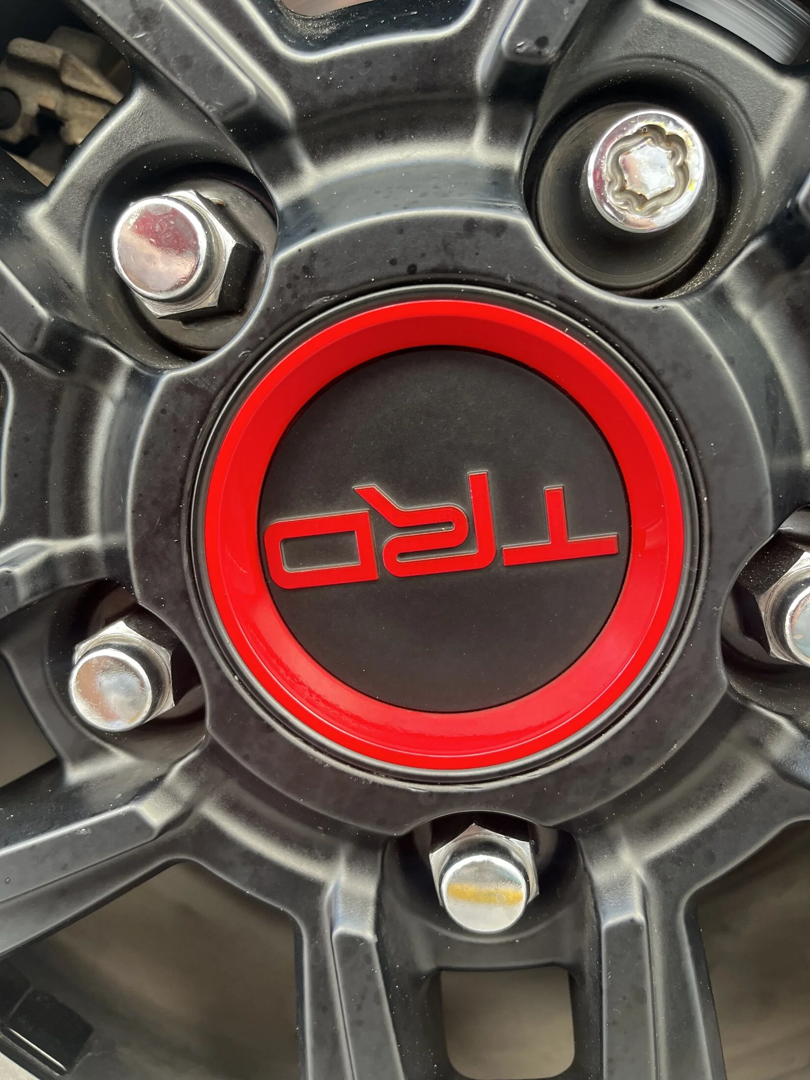

Anyone know a solution for the red hub caps on the Pro wheels? They bug me (and more importantly, my wife).
I think it’d be rad to put some Lexus caps on.
I’d be curious if anyone else has done it.
I’ll take better pics later.
This is the cap I’d like to replace. I’m gonna dig into whether that’s a possibility or not this week. If anyone else has tried it already, please chime in.
It’s ~3.75” or 9.5CM from flange to flange FWIW.
One option is the bronze version from the Heritage 200s. I think they are a little difficult to get. But they definitely aren't as blingy
