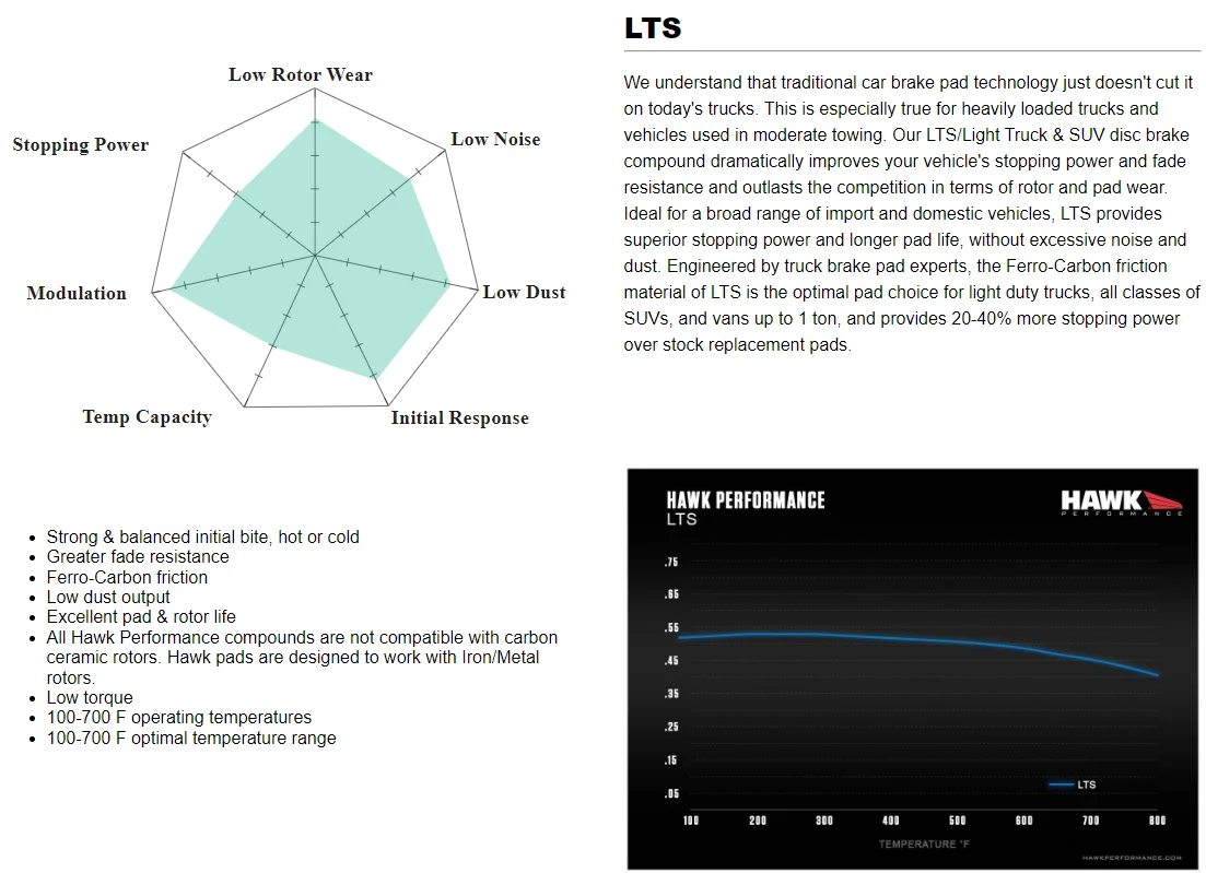

I wouldn't go so far as to say great pads for track use are desirable for street use. Just that the LTS pads really expands the envelope of friction and high temp capacity/performance while keeping still great street qualities.
Here's how Hawk characterizes the LTS. For comparison, the HPS pads I used previously showed a ~.38 friction coefficient, which were already stronger than stock. These LTS are closer to ~.52. I thought that would be overstating it. But the difference in friction is that remarkable. Dust is indeed that much better too.

Im surprised they rank stopping power medium not high.

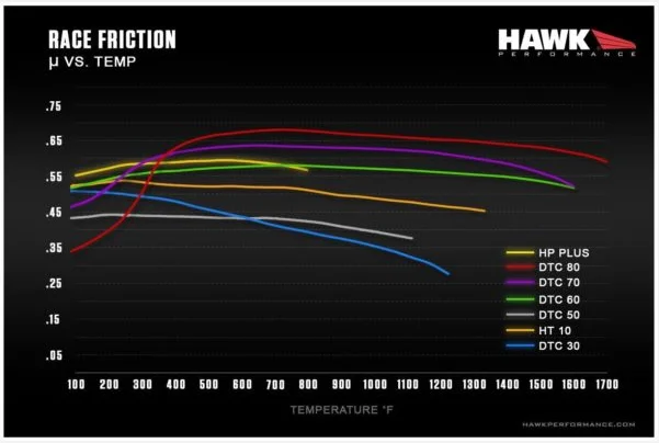

It's relative to their other race products. That have even higher rotor wearing levels of friction up through race level temps.
For a street pad, the stopping power provided by the LTS is up there. I would say 20-40% over stock (feels like it could possibly do 35s without BBKs). To the degree that I though it would be too much from specs. Because for street, too much bite and too little modulation can be a bad thing where it's harder to come to a smooth stop, or modulate braking in off-road. Fortunately, the LTSs modulate very nicely.
