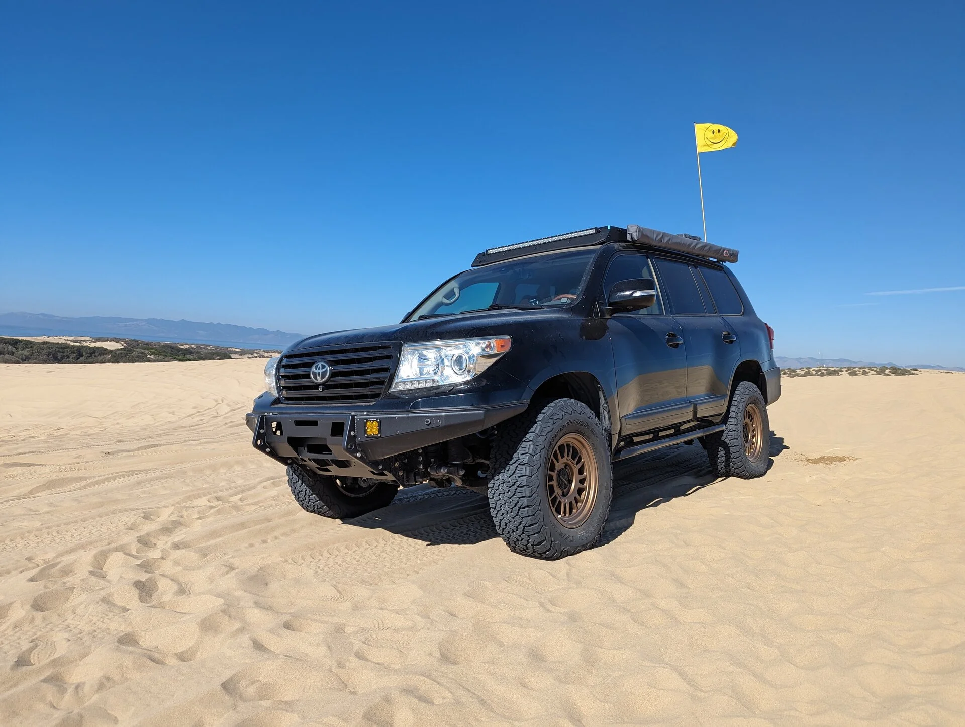

I ended up going with the third option AKA do nothing!
In the back of the front wheels I have the rocker panel corner cut and pushed back the pinch weld and the liner. So no rubbing in the back at all and managed to keep my body mount intact. In the front I only rub against the KDSS arm at full lock and I have learned to just not go that far. Yes I could do a KDSS relocation and maybe I will at some point but there are well documented drawbacks to that route. If someday I find a nice set of end links that work with that angle, I will do it in a heart beat.
I even took it on the dunes this weekend and didn't hit anything!
Overall very happy with the tire and wheel size.

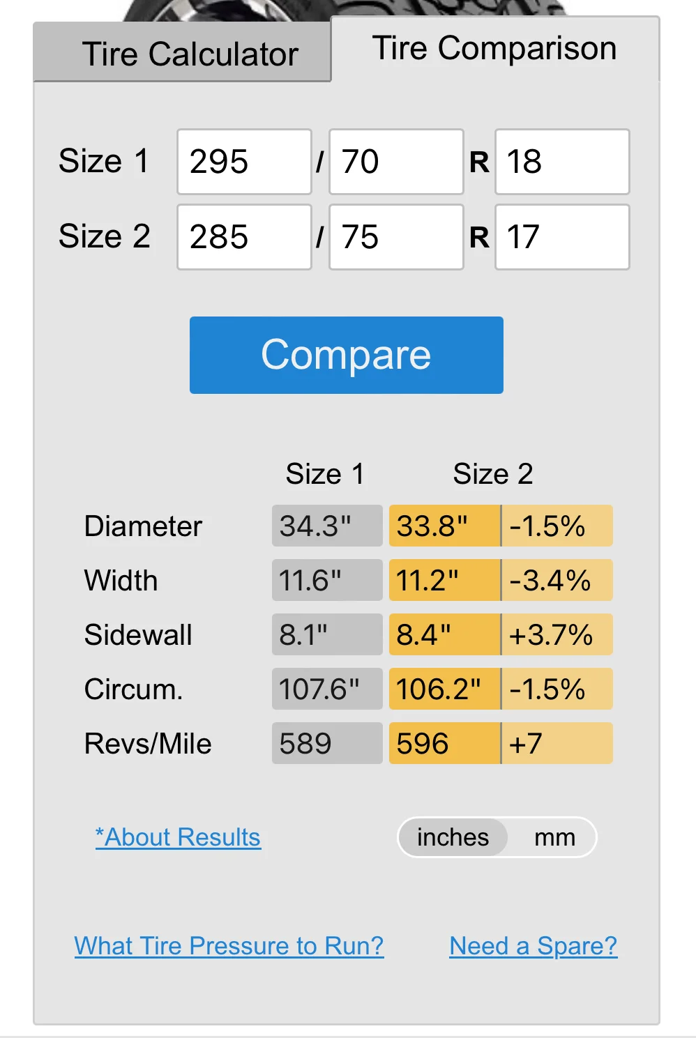

I like the look of the 295-70-18's in this thread, I already have a set of 285/70/17 KO3's and didn't want to spend the money on 285/75/17's. Seems to be such a slight increase in size.
the gap in true diameter and width between 295/70r18 and a BFG KOx 35x12.5r17 probably isn't that large.
