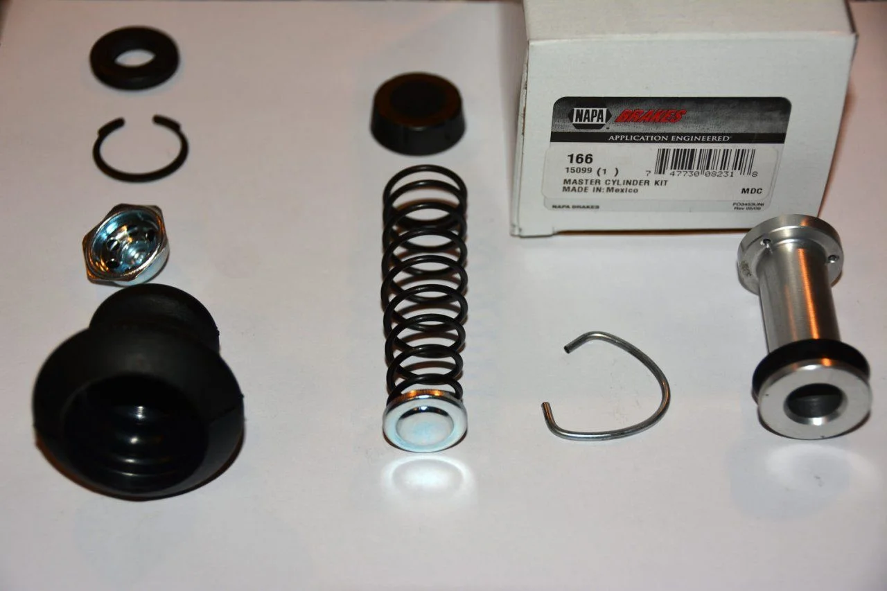

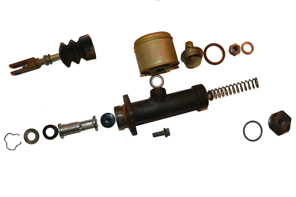

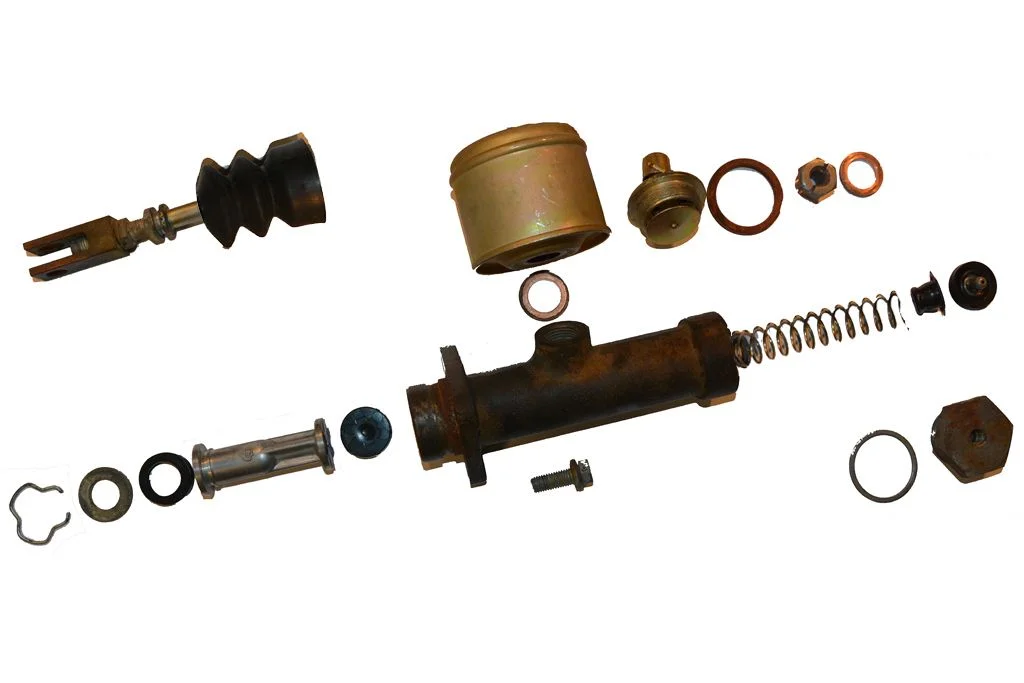

Pulled the Tin Can clutch and master cylinders on the '64 FJ40 and took some pictures of the rebuild. The early 40 is the same 1" bore as the 20 and can use the same rebuild parts. I also found a new part number for the same kit as above.
All the same:
Napa - 166
Raybestos - MK166
AC Delco - 18G1226
I only use the two rubber pieces from the kit and reuse all the Toyota innards.

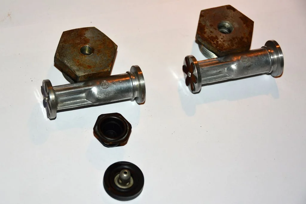

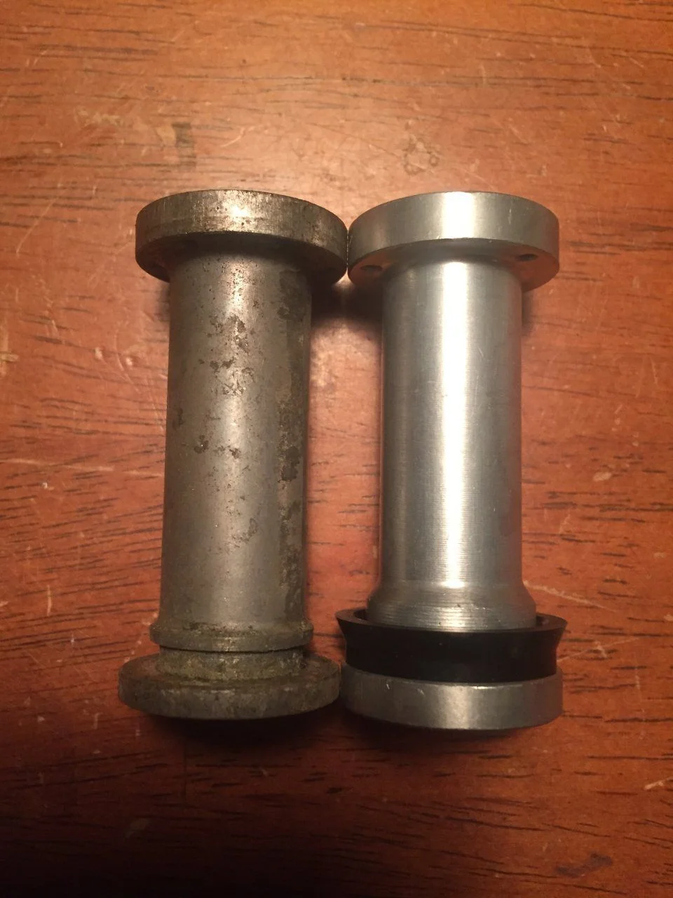

Brake:
Clutch:

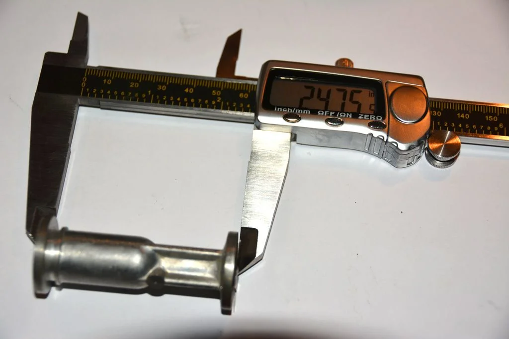

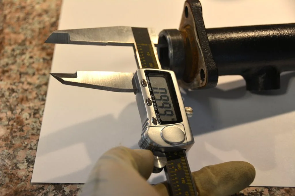

The only parts that are different. Even though the brake piston is stamped 2-5 and the clutch piston is stamped 2-4, they appear to be the same
Bore is .999 inches

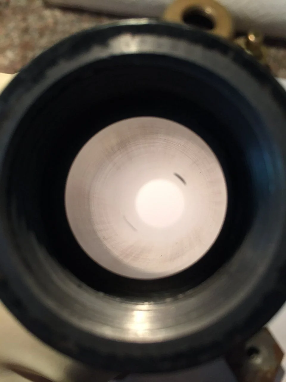

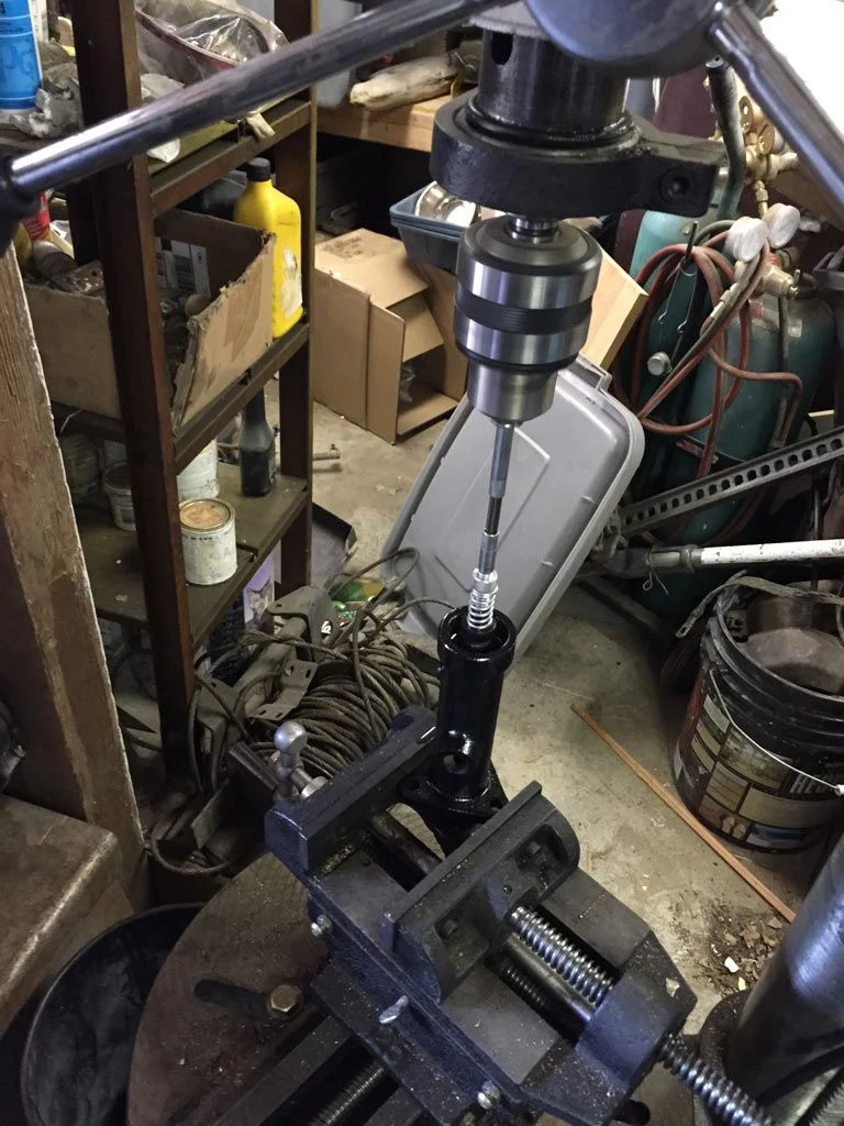

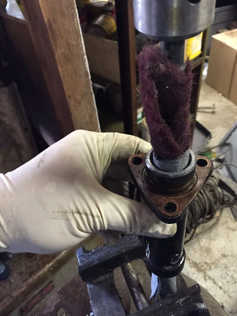

Honed then 600 grit followed by 1200, 2000, 3000, then metal metal polish
It is hard to take a pic but the inside is a mirror finish

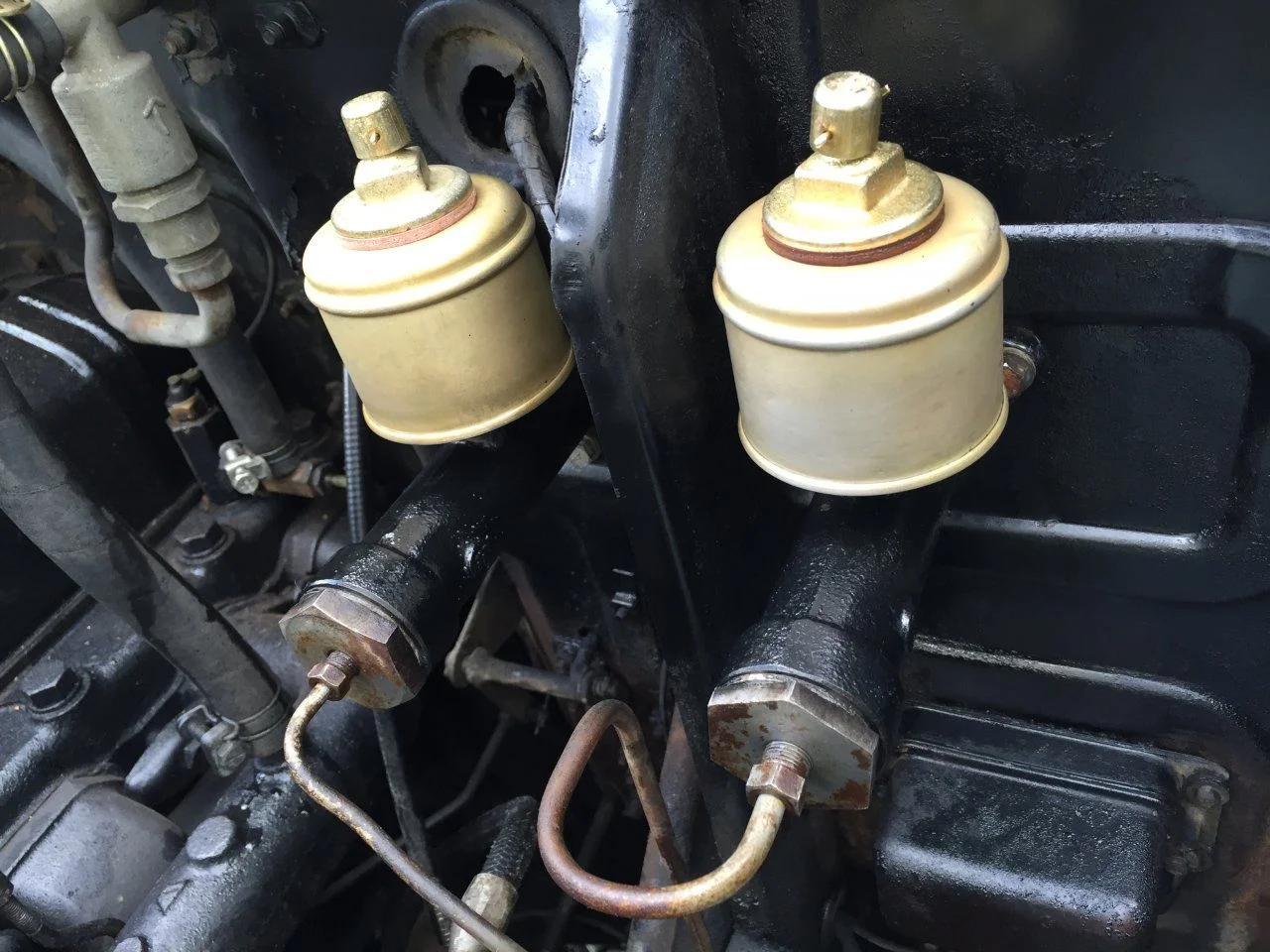

I tried the old(but not tin cup style) brake master from the 45LV in the empty hole(s) for the clutch master in the(now) parts 65 fj40, the bolt pattern is the same.

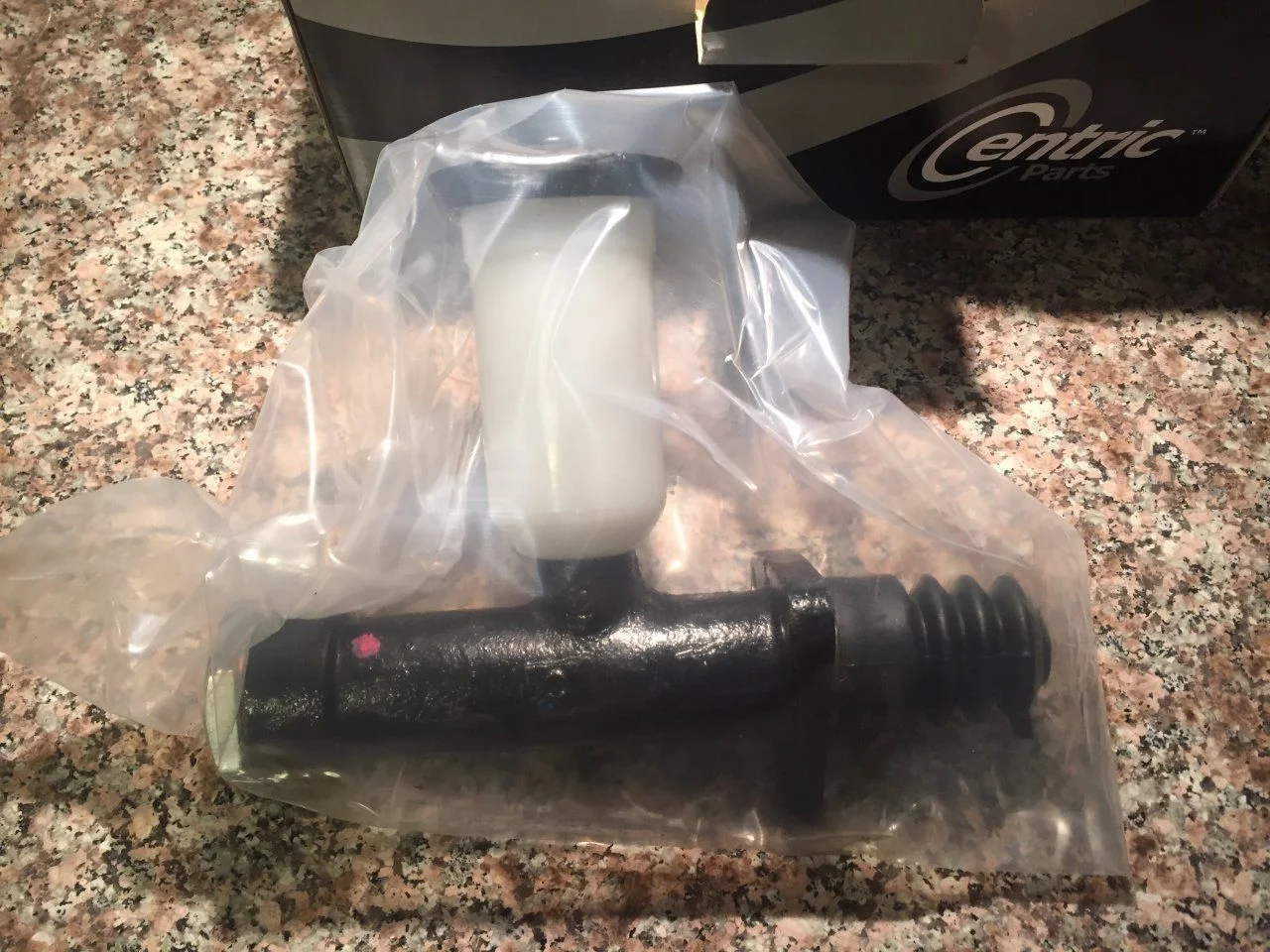

this is the 45LV, brand new(1 week ago) brake master from Toyota and old(12 years old from Toyota) tin cup clutch master, Unless there is something inside of one or the other that is different.....I think it would work. I don't think the old single line brake system used a residual valve in the master but I may be wrong. And unless those pics Treeroot show are the same part(and I think they are 2 different pics) then it should work?
thoughts?
thoughts?
Buy this part from RockAuto (here is a discount code 5078828845496240).
The tin cup swaps over. Take out the residual valve and you are good to go for a clutch.

Still need to change the end cap fitting over right ? one is 9mm and other 11mm.
Fantastic !
That is correct. Last pic in post 225 above shows the different bits.
