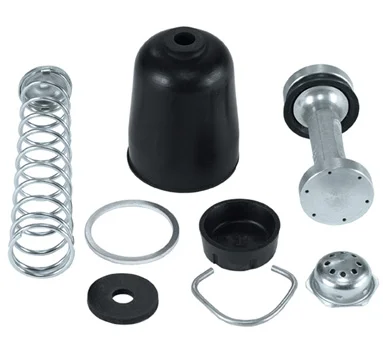

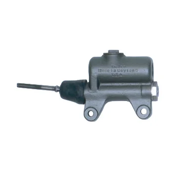

they do look alot alike...except for how they mount...kits are cheap $35:
Kanter Auto - Product Detail

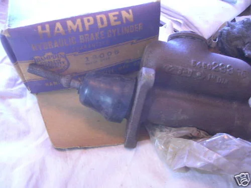

heres also one i found on ebay ...that looks like the right bolt hole pattern right?
