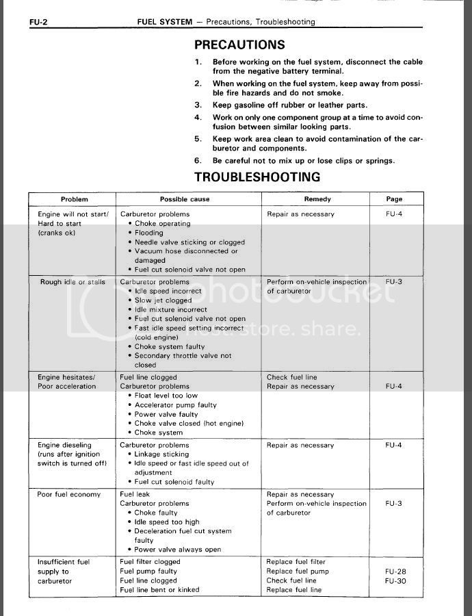

Here's a good start.

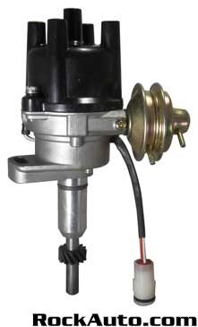

I would spend a few minutes and rule out the vacuum advance diaphragms at the distributor.
When they do not hold vacuum the motor will lose power. I just replaced mine after 30 years and wow what a difference.
Good luck
Where did you get these?
LC Engineering Part Number: 1081123 has the Distributor Vacuum Advance Unit for $59.95
I bought a whole new distributor at RockAuto WPS / POWER SELECT DST731 $71.79
It was a 15 minute plug and play.
