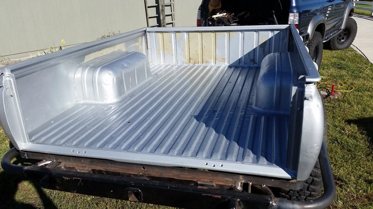

Primer and inside layer complete. Was going to get it off the frame but thinking a was going to get to it this weekend to finish up paint. But turbophil talked me into going to krocks this weekend

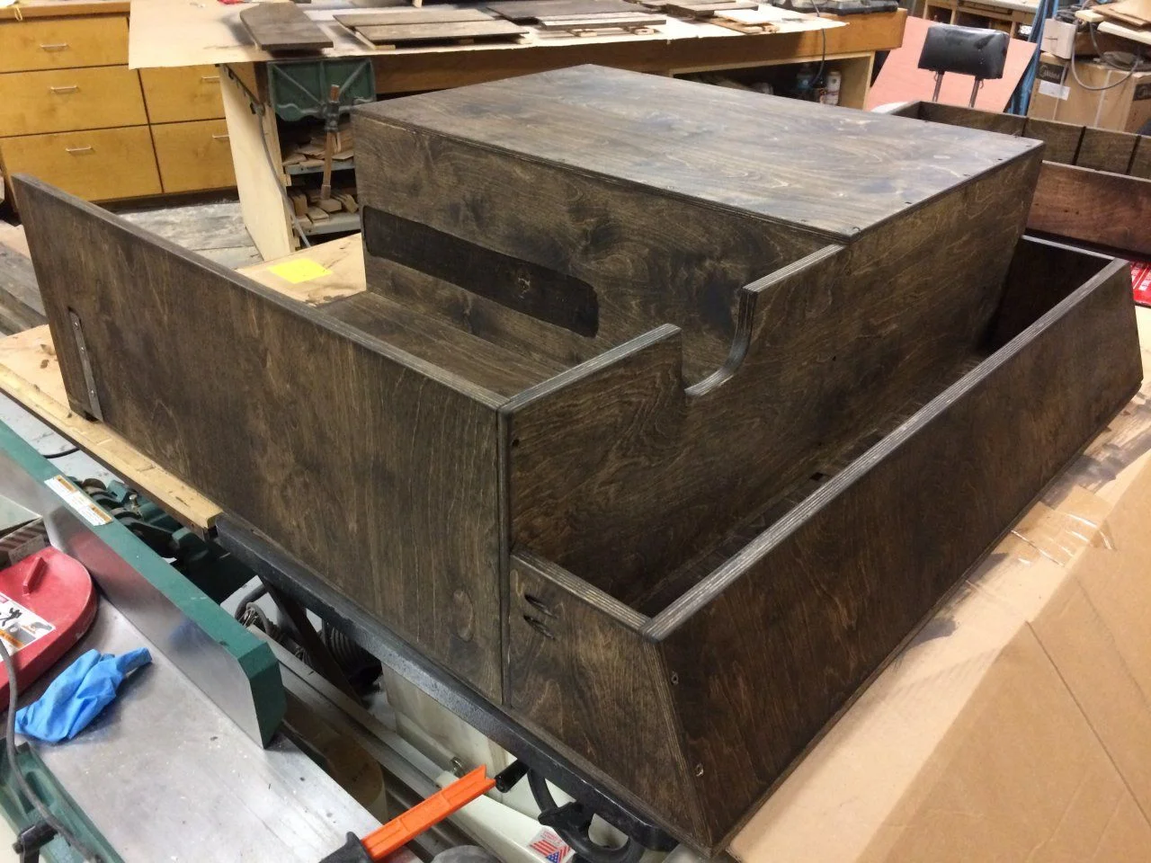

I have been staining and polyurethane the rear storage area in the wee hours of the morning

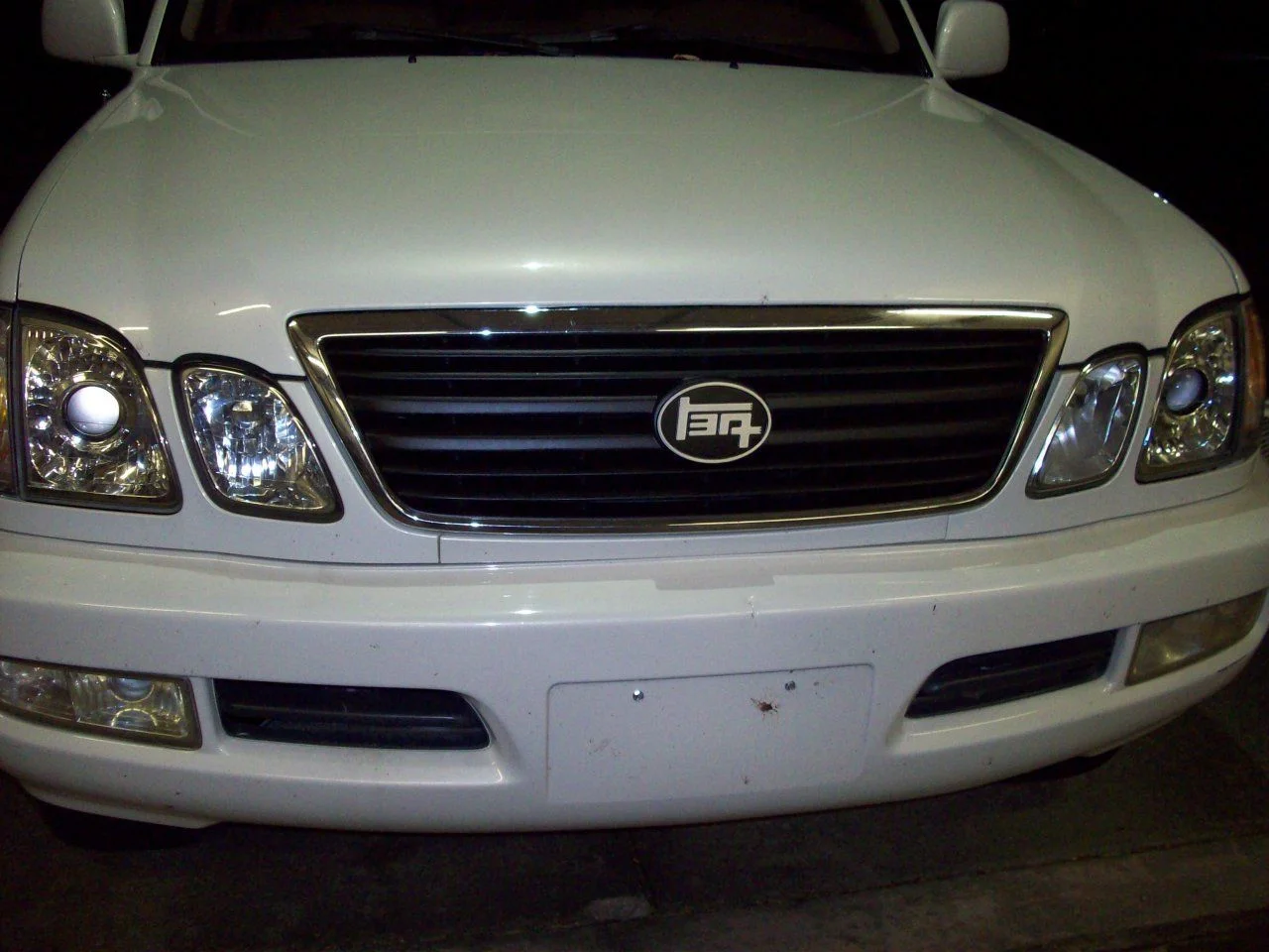

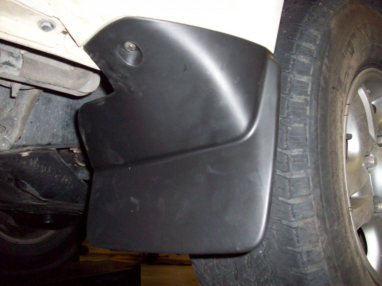

Basic maintenance and simple stuff over the last couple months. Put my TEQ badges on, took the running boards off, added front mudflaps, and exchanged the AHC fluid.

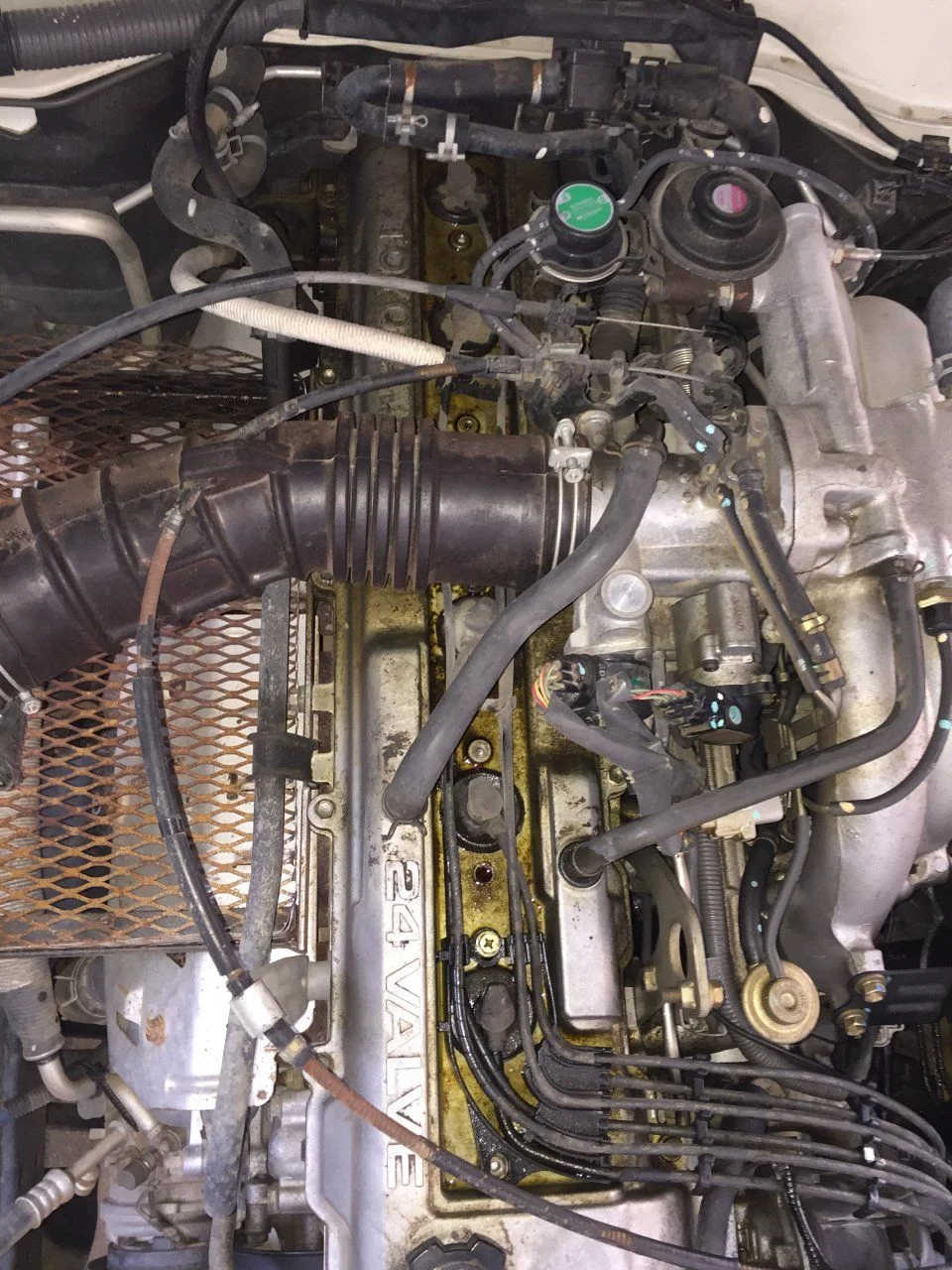

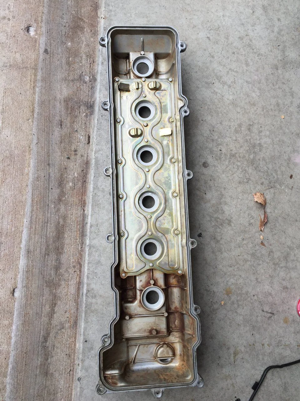

The LX450 is a solid vehicle and has performed very well off-road. There were a couple of minor annoyances that really took the pleasure out of highway driving, so I jumped on them today.
Passenger front door whistles at highway speed and door ajar light comes on at times- adjusted the catch to pull it in tighter at the bottom=fixed.
Hood lifts a little at speed- adjusted hood latch and rubber bumpers under hood=fixed.
Shaky mirror on driver side-fixed with double-sided tape since only one tab was broken.
Finally, replaced distributor O-ring in hopes of stopping oil leak--failed. I still have a leak that upon further inspection appears to be coming from under the plastic pieces on top of the valve cover.
Ideas? Suggestions?
Ideas? Suggestions?
Spark plug tube gaskets? I had that problem around the beginning of the year. Mine leaked real bad though. One of those fix it before you drive it anymore problems.
See the first post in this thread.

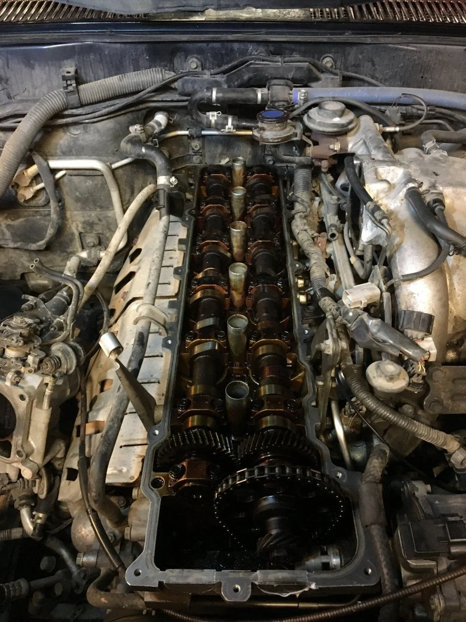

The gaskets ride on the 6 tubes for the spark plugs and butt up to the valve cover. Not a hard fix, was just time consuming getting the valve cover off (and powder coating the cover).
Must be the spark plug tube gaskets. The leak is pretty bad, I thought at first it was coming from around the oil filter so I pulled that off and replaced it. Then the distributor O-ring since that's such a common site for leaks.
@1MAC If you want to pretty up things without much downtime, I have an extra valve cover that has been passed around a few times. Basicallly the deal is you take my extra cover, clean it up, powdercoat or paint it up and then swap it onto your rig and send me back your old one.

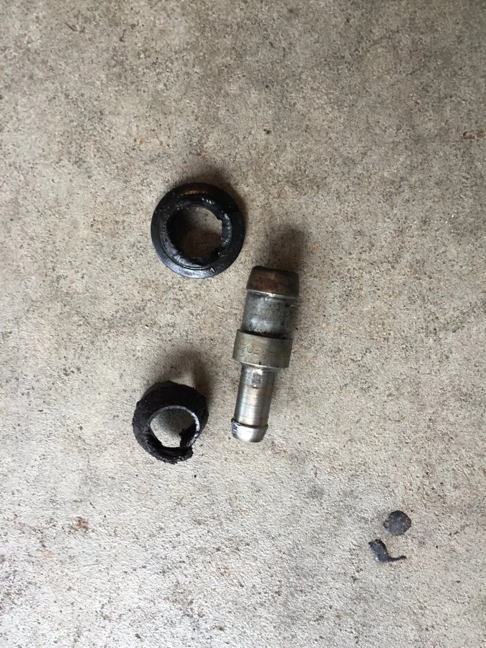

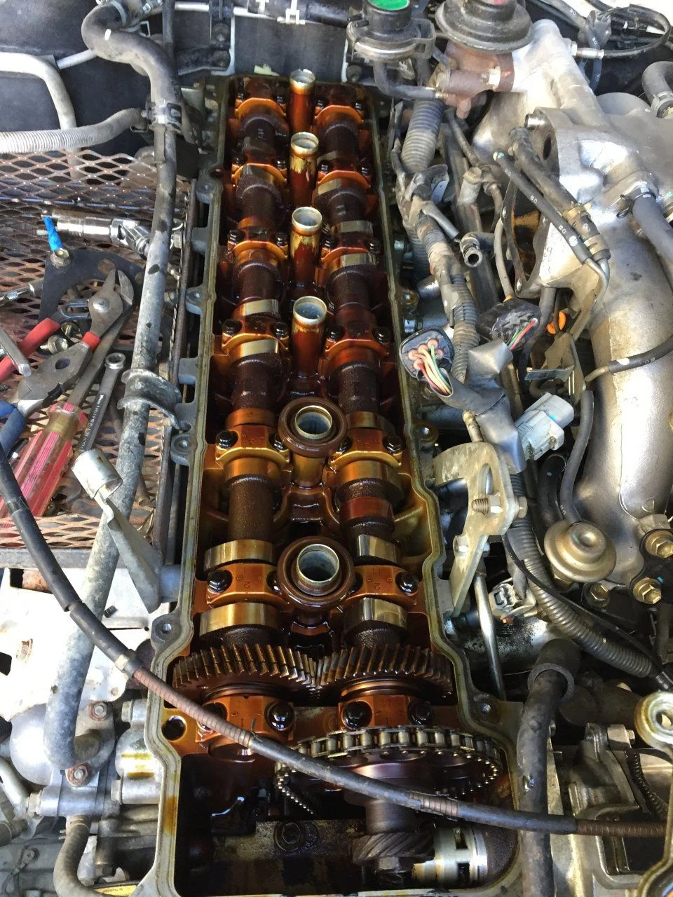

Did the spark plug tube seals today, complete with new PCV valve, grommet and hose as well as the valve cover gasket. Two of the seals stayed on the tubes when I pulled the valve cover-# 1 and 2. Leak looked like it was coming from around #1. Slowest part was pulling the other four seals out and cleaning the inside of the valve cover. Thanks to Malcom for the idea of removing the air cleaner. Made it much easier to sit in the engine compartment and work on everything.
