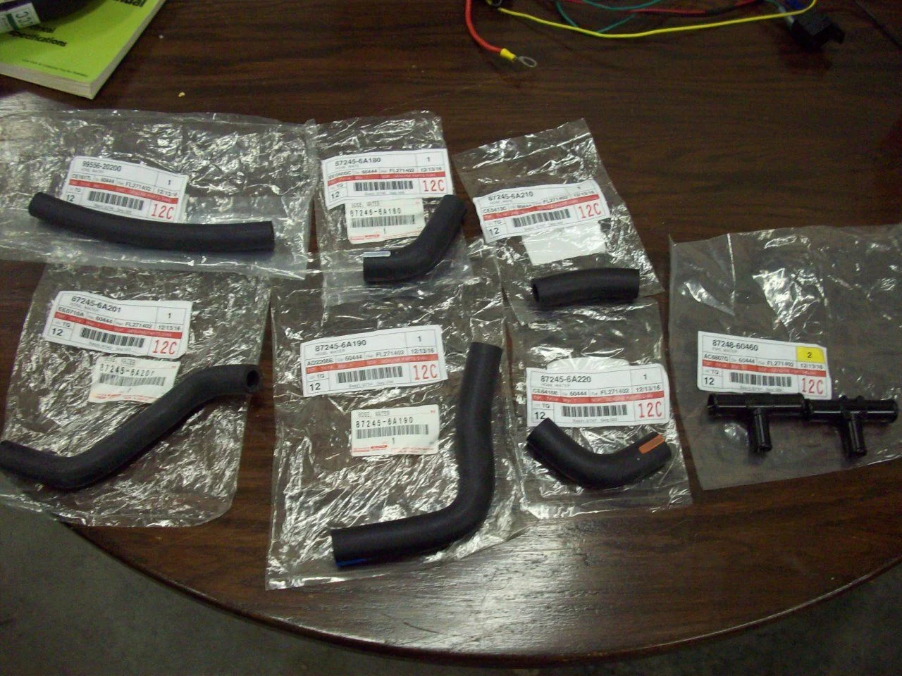

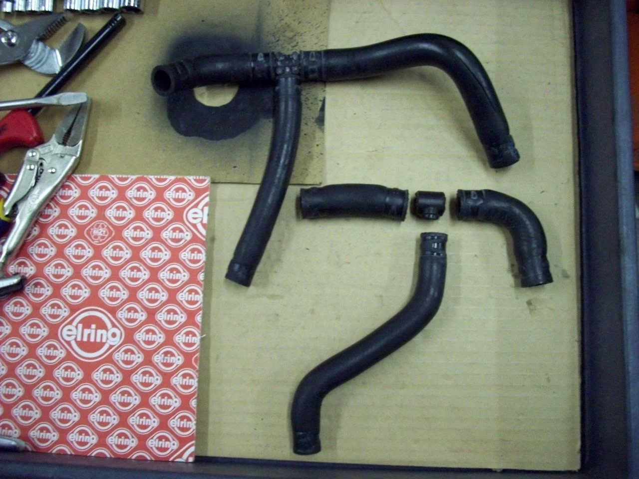

Replaced heater hose T's in the LX470. The girl at Chick fil a sounded so sweet. "Um sir, is everything okay? Is there something wrong with your car?" I had just ordered at the drive thru when "POOF" there was a dull thud and sweet steam began pouring out from under the hood. It's quite an impressive sight. I didn't have the foresight to take a picture.

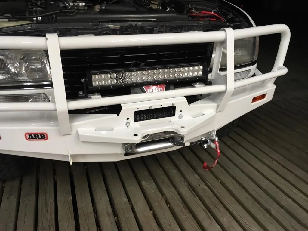

Since I've been on a parts ordering stall locating everything. I have to get me diesel and cruiser fix hanging out with turbophil. Help install his new winch warn zeon.
Wow! That is a bright bumper!

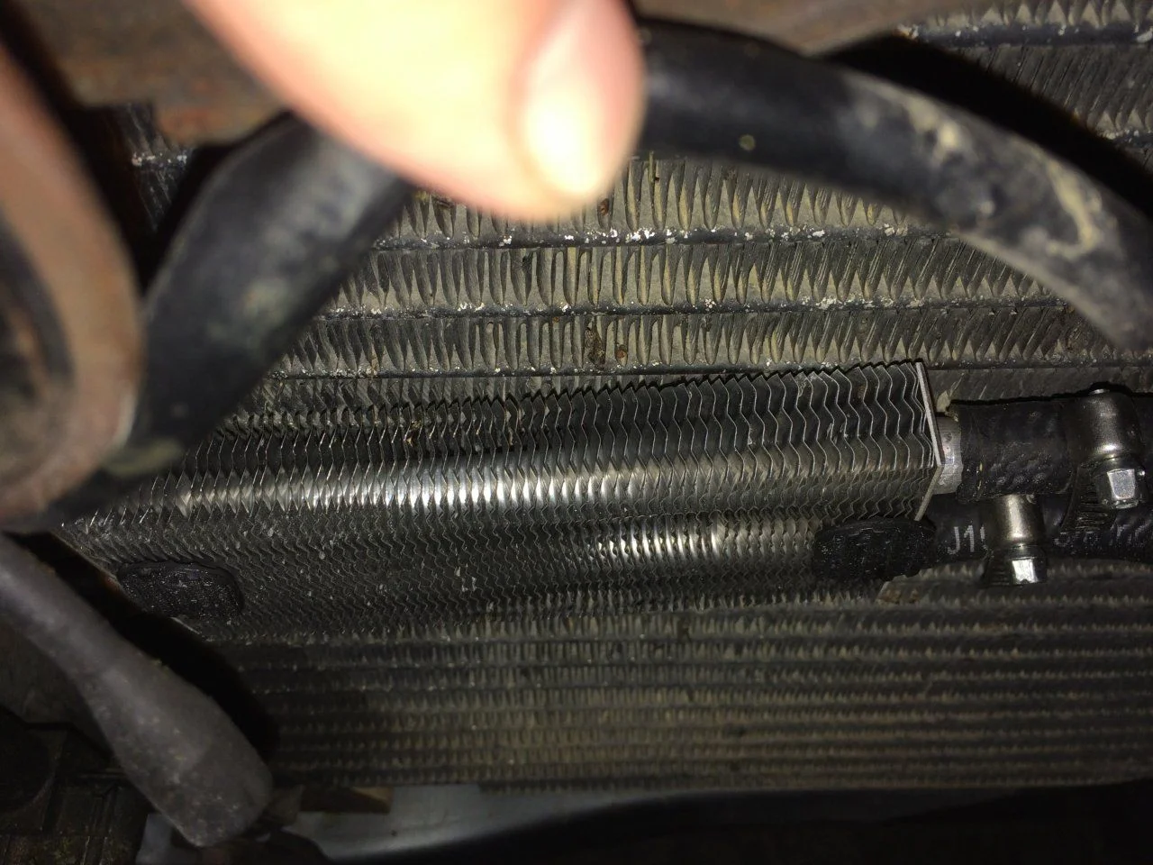

New after market power steering cooler mounted on passenger side radiator to replace leaking paperclip, new belts, hoses, thermostat, synthetic Dex IV PS fluid. My belts were in sad shape! And PS fluid leak was getting bad. All good to go now. Happy New Year to you all.
I would be interested in seeing pics of your setup, maybe some part number too ? I need to do my low pressure PS lines and I've always thought the factory paperclip cooler was inadequate for 35's.
I did a 2-pass cooler, but they make 4-pass which are just larger/square and the tube passes through the fins 4 times. Either will fit and if I did it over would do the 4-pass. I used NAPA part number 14866 ATP. ATP is their Mfg. code. I don't have the box anymore since recycle went out yesterday. An on-line place called Jegs has 3-4 different versions for around $30-$35. I got mine from NAPA since I get like 55% off because my son works there. I used Gates SAE J1019 3/8 inch 400 PSI WP transmission hose which is able to take the high temp fluid. Still bends pretty easily too. I ran the hoses in front of radiator since they are out of the way and will also get some air flow. Hose is NAPA part number H1937 list price $4.88/foot but I got it for $2.55. All belts were from Molle with discount and now I wish I had just ordered a OEM water pump from them also because it would have fit properly. (Live and learn) I went after-market since it was $65 for a heavy duty versus $179 OEM. But here I am using my old pump. It did seem to be in great condition. Must have been replaced once before I owned it? I'm hoping so anyway. Toyota thermostat. It's mounted on the passenger side below factory horns. See next post for photo. Remove the horn unit and you can easily mount any of these coolers on the passenger side of radiator. Just imagine a small 12" x 5" radiator on the giant factory radiator. Heck an 8 pass would fit easily so go bigger!!! I need to test fluid temp when hot but since this mount gets constant air flow from the fan and from airflow when moving I think it will be as good as the factory paperclip which doesn't get fan flow and also has the skid plate underneath it boxing it in. If mines seems to get too hot I will add a second 4-pass unit with a short jumper piece of hose. They mount with straight zip ties and foam pads. The cooler was the easiest part of the job overall. Good to here from you. DLP.
Loaded from phone. And yes it could have been mounted a bit more level. Oh well. I can easily correct, but probably won't unless I add another cooler unit.
