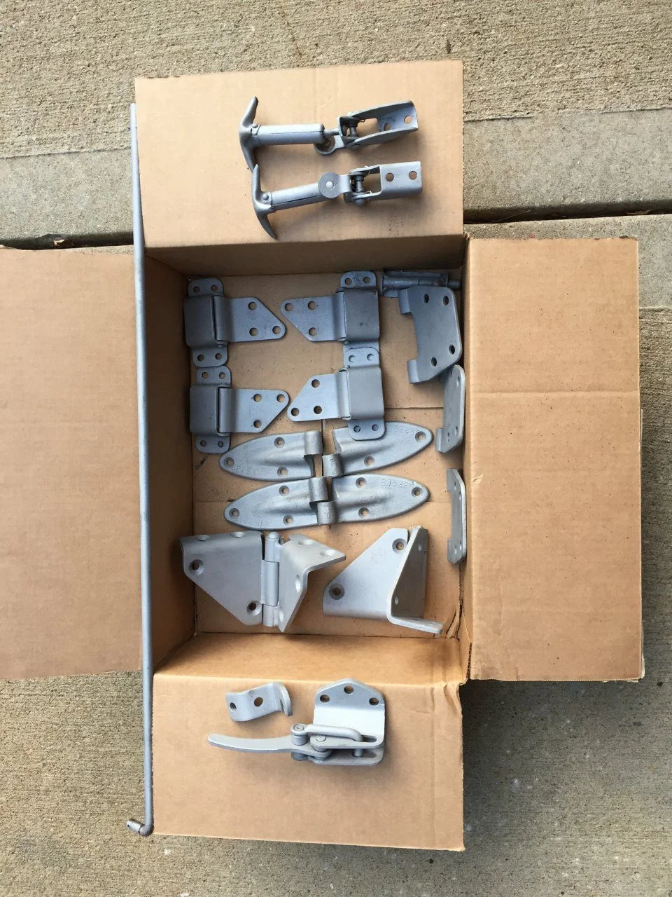

Got a bunch of small
Parts blasted and degreased, ready to prime.
Do those hood hinges have fj25 stamped on them?
It's hard to read, but I think they say BJ5825 and the B kind of looks like an overstrike on an F. They're off my early '65 FJ40. Anybody want to help me figure out how to re-install the bifold "guillotine" rear door?

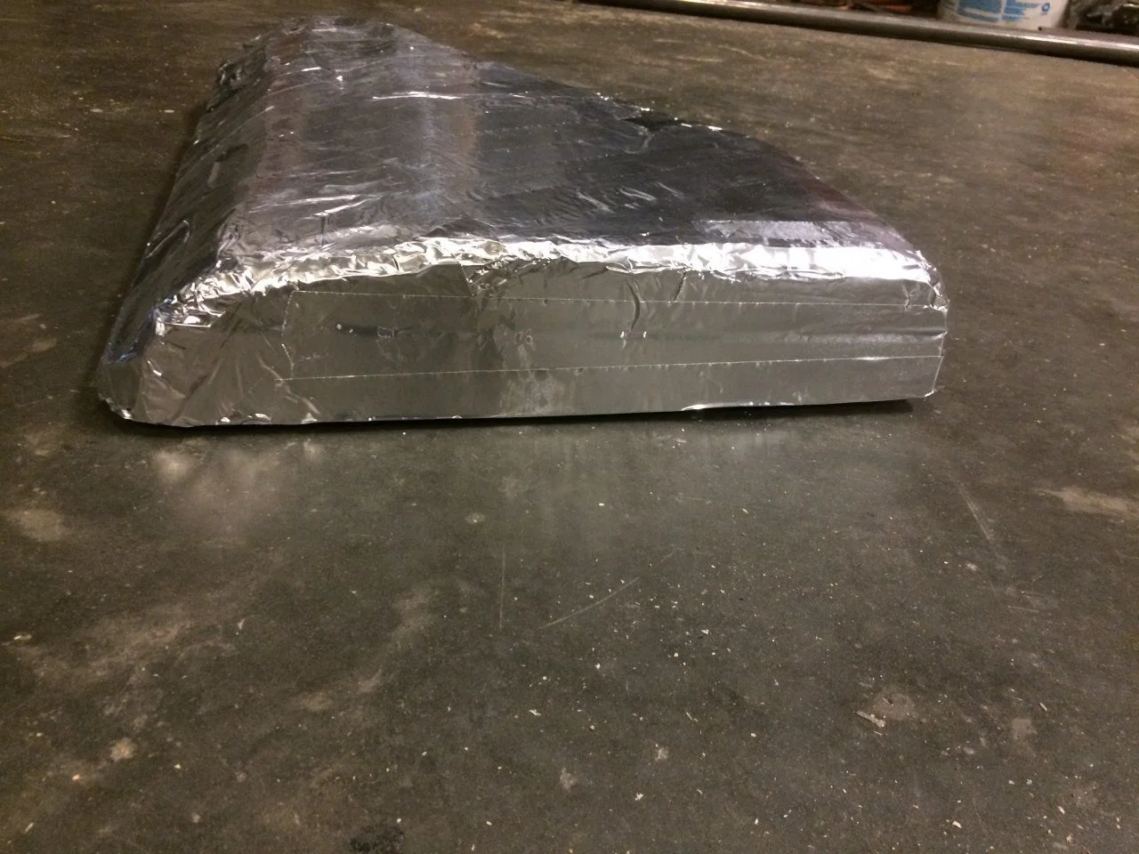

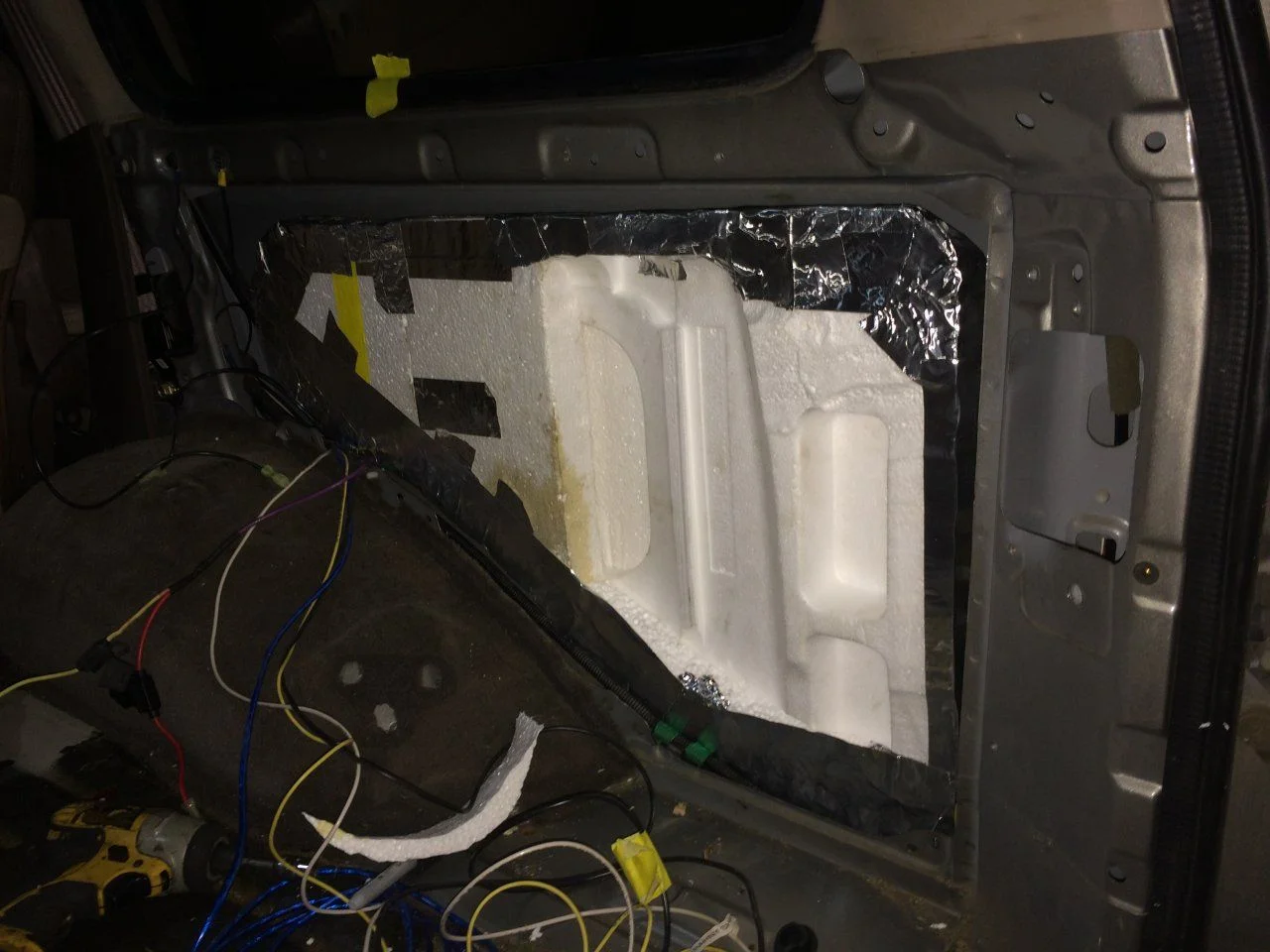

Decided to make a fiberglass enclosure in the rear quarter for a sub. Started with a foam mold, then wrapped it in HVAC tape
Flying blind here. Not very much exposure to sub enclosures or fiberglass molds.
Plan is to wrap this in three or four layers of fiberglass and resin, scrape out the foam, put a MDF front on it for the speaker.

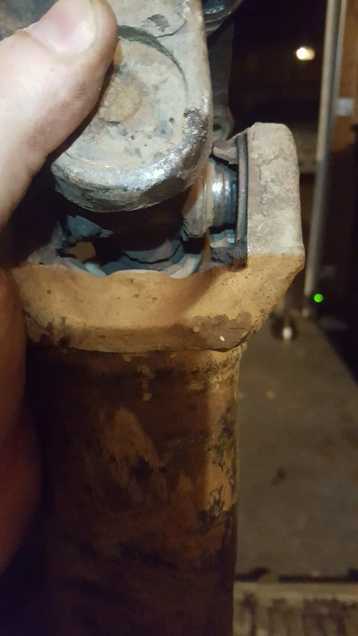

So, what started out as thinking I need to swap out my rear 4:10 3rd member, may just be a u-joint after all. As a few of you know, before AR, I started hearing a non consistent tinging in my rear. Felt and sounded like it was to the rear of the truck away from the t-case, so we pulled my rear driveshaft (which I just did u-joints in late last year). When we pulled mine, it definitely has a hard kink limiting free motion, so I thought great, jst the u-joint. But then we threw in Foo's spare which seemed good at the time, and of course the noise continued.
Then after the AR, trip, my rear pinion started weeping, and then pretty much puking diff fluid, along with the noise getting way worse.
So last night I went to pull the rear driveshaft to start dismantling the rear diff, and the u-joint at the axle had disintegrated (it was actually sheared off of one side).
So this week I'll replace the pinion seal, and swap in new u-joints, and hopefully find that was the whole issue the whole time.

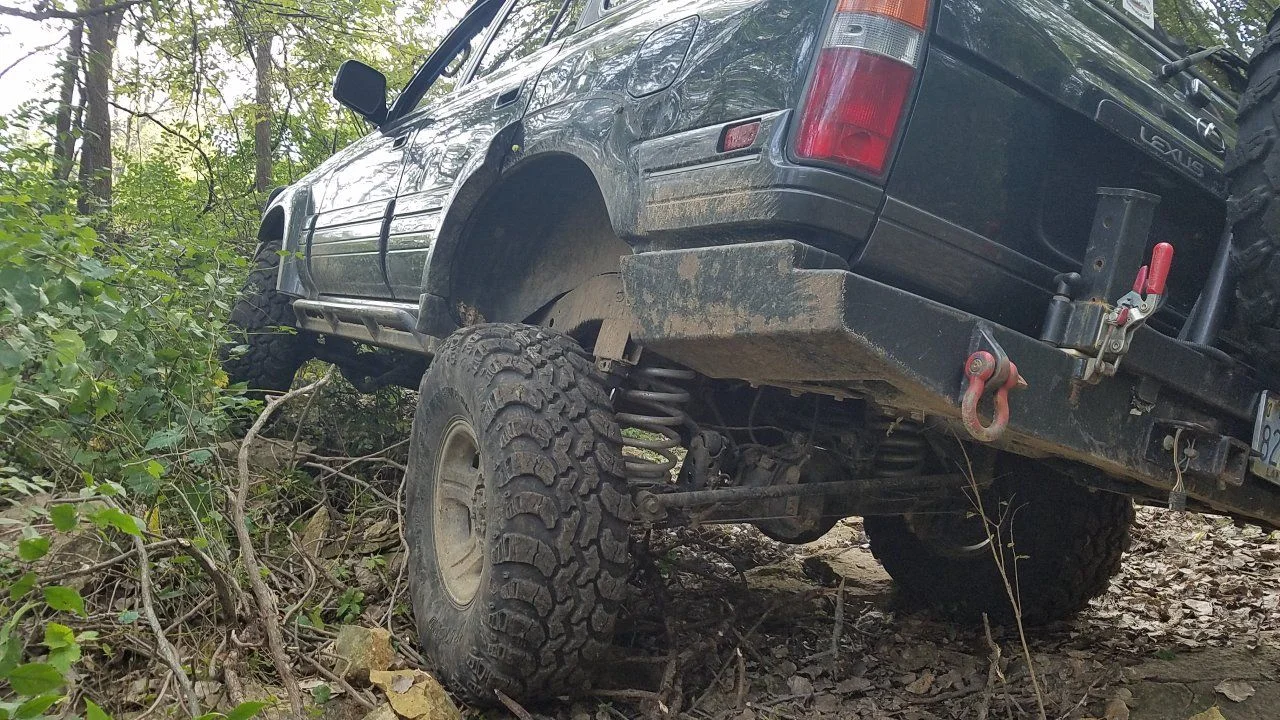

Here is a flex and stuff shot for you @2fpower
Still looking for a rig in that photo... Where's waldo?
