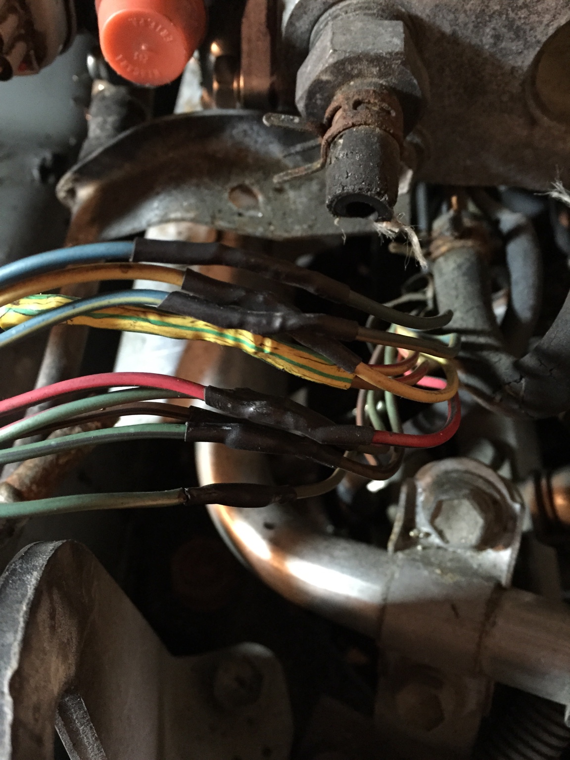

A little fire resto to make sure it runs before getting serious. One owner 88 62 bought super cheap and looks to have a fairly fresh "gray" long block, thrans and transfer is bright and shiny everything from rear diff to radiator has been maintenanced well.
Much of the wire harness that lays high had to be replaced, all cut solder and shrink tube spliced with donor harness connectors, installed a new battery and built a fuse panel for fused link system, replaced throttle body including TPS, idle controller and mass air meter, broke down air pump and serviced bearings, all melted plumbing replaced with new and used parts.
After draining the tank of 13 gallons of 5 year old gas, a added 10 gallons of fresh fuel and 8 oz's of 44K... three or four turns of the crank and the ole girl fired right up and idles perfect. The throttle cable was destroyed and I have an NOS just in, I will install that and test drive tomorrow.
