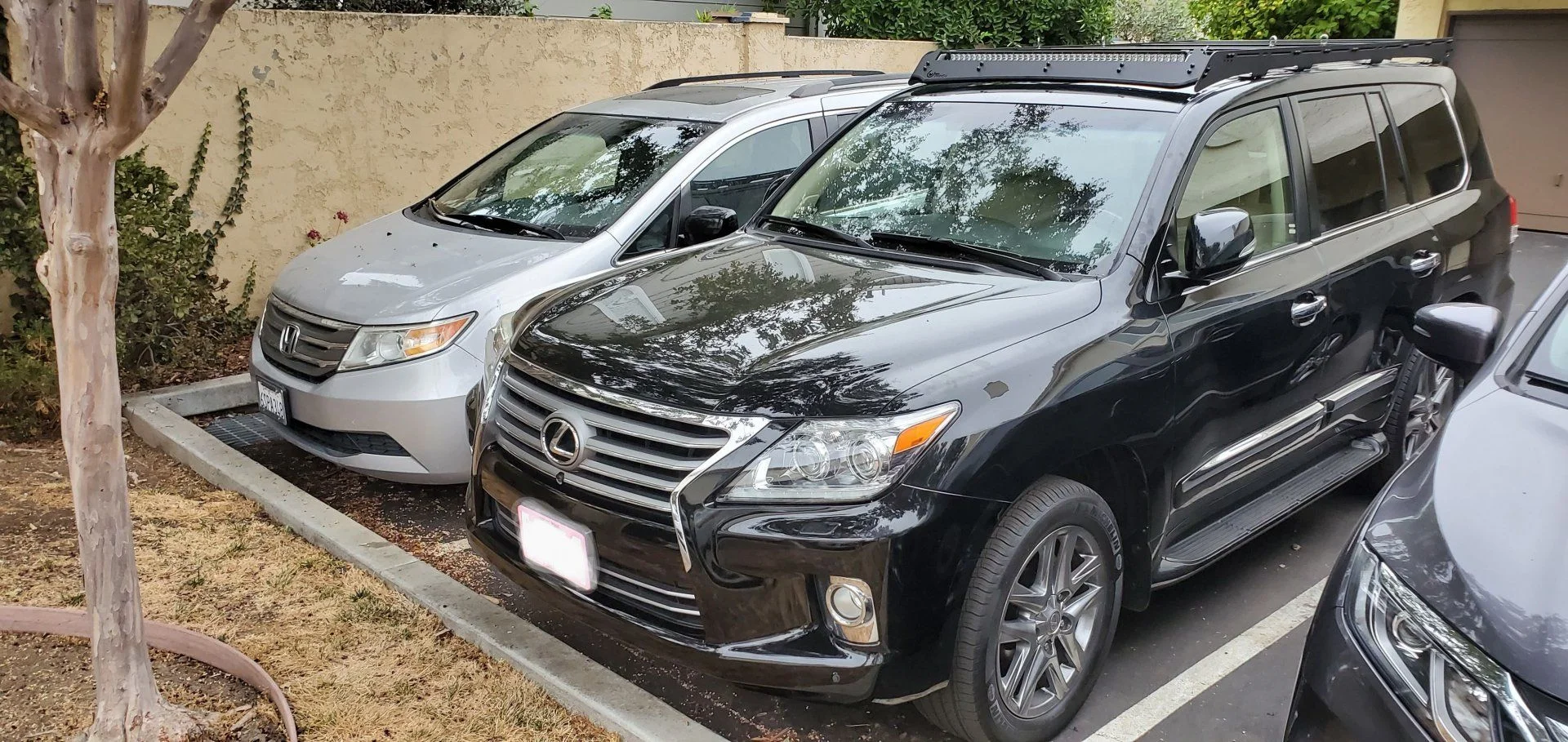

Step one of the build was...not wheels or tires...but to solve the problem of where are we going to put all our stuff? Our prior adventure mobile was a Honda Odyssey, which has seemingly neverending storage space. If we were going to go anywhere beyond the mall with this thing, we needed more space. I looked at the Prinsu, Front Runner, and Gamiviti racks closely and ultimately, chose Prinsu because it was considerably cheaper, provided all the functionality I needed, was lighter, and looked much better (some helpful comparison from @radman here).
The install went ok especially thanks to this thread (required reading if you are removing the roof rails on an LX or LC). Despite preparation, we still had a problem with one of the dreaded brackets. I documented the problem here and @grinchy @livebetter36 @CharlieS and @BluffCruiserDC came to the rescue with a solution. I ordered a new bracket, dropped the back right headliner (easy), and replaced it from the bottom.
Call me cheap but I wasn't about to drop a load on high-end lighting that I rarely use so I went value on the light bar and the side camping lights. I got a referral to Code 4 LED from a buddy and the owner, Dean Hamilton was super helpful with helping me select the light bar and wiring harness. The light bar is super bright and looks great. I also went with a wiring harness with a wireless control so that I didn't have to run a wire through the firewall. As a bonus, it gives me this cool control to impress my friends with. For the side camping lights, I bought 2 of these bad boys on Amazon, which despite their cheap price, are surprisingly perfect for the use case. They sit flush on the rack and provide adequate light to set up camp in the dark without bothering your neighbors.
Here's the Wanderer after step 1.

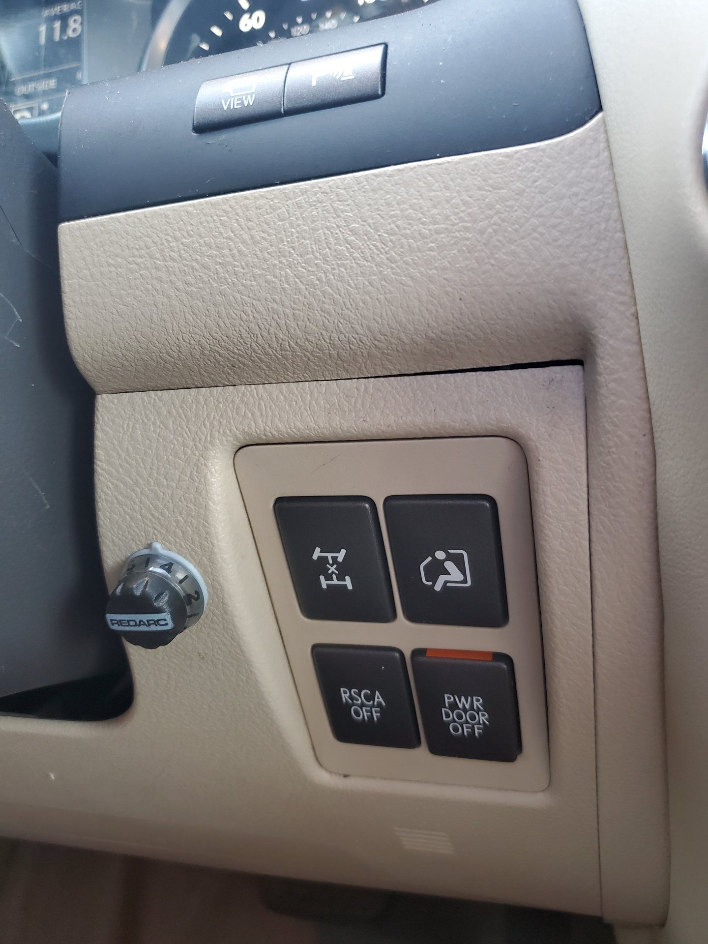

Installed a Redarc Tow-Pro Elite today.
How can I be sure it's functioning properly without actually pulling a trailer? What do units do when they are not pulling a trailer? When I press the brake, it flashes blue once. That's the only light it shows. No other colors than that. The Redarc website doesn't seem to be any help. I don't have a trailer to test the system on.
Mine never did anything or does anything until I hook up a trailer. That's when it does its initial calibration
Yeah, mine is off until it senses a plug in on the trailer harness. The for the first 5 minutes or so, it flashes the calibrating signature, blue and green I think, until it's calibrated then solid blue and then purple when you brake. It's slick and easy to use, just have to remember what all the flashing means.

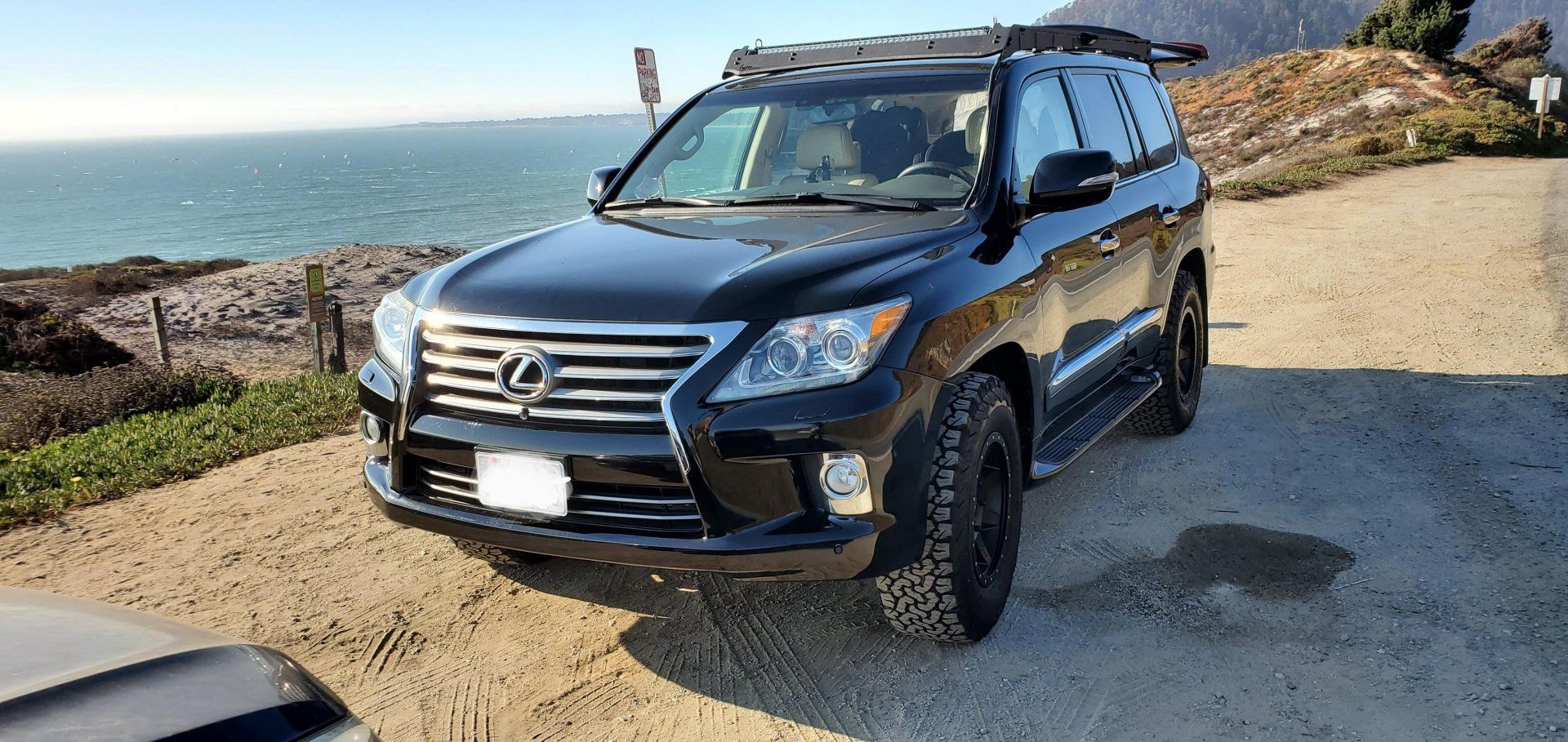

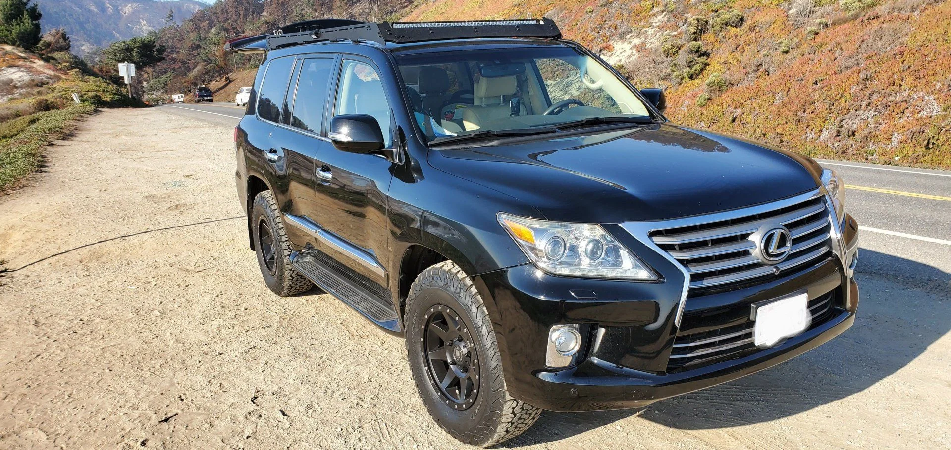

I wanted more rubber and less chrome under me so I went with 285/70/R17 KO2 with Icon Rebounds.
I bought from 4WP because they didn't charge shipping, and gave me $100 off the wheels. However, the customer service has been dreadful - they mistakenly installed one C load tire among the four E load tires. I'm still waiting for the replacement 3 weeks later and they still owe me $100.
There was quite a bit of rub on the front leading and trailing edge. For the trailing edge, I simply took off the mud flaps. For the leading edge, I followed @TeCKis300's advice here and it worked magically. I now have 0 rub.
One issue that I didn't expect was that the spare holder/bracket didn't fit the rebound wheels. A corner of the bracket would dig into an uneven surface on the wheel. We cut the offending corner off with a grinder. This is what it looks like now:
Very happy with how this wheel/tire combo turned out - especially since this LX no longer looks like a lux mall crawler.
