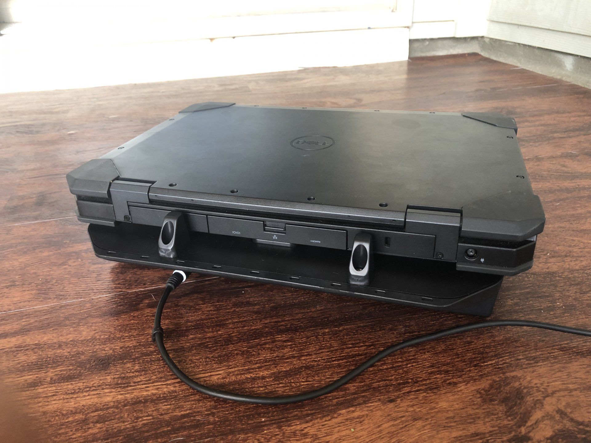

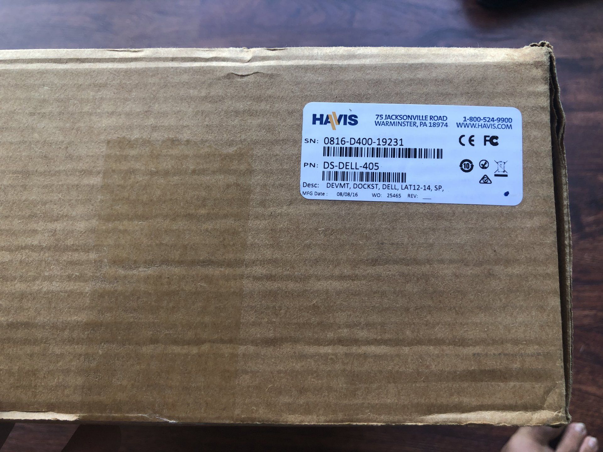

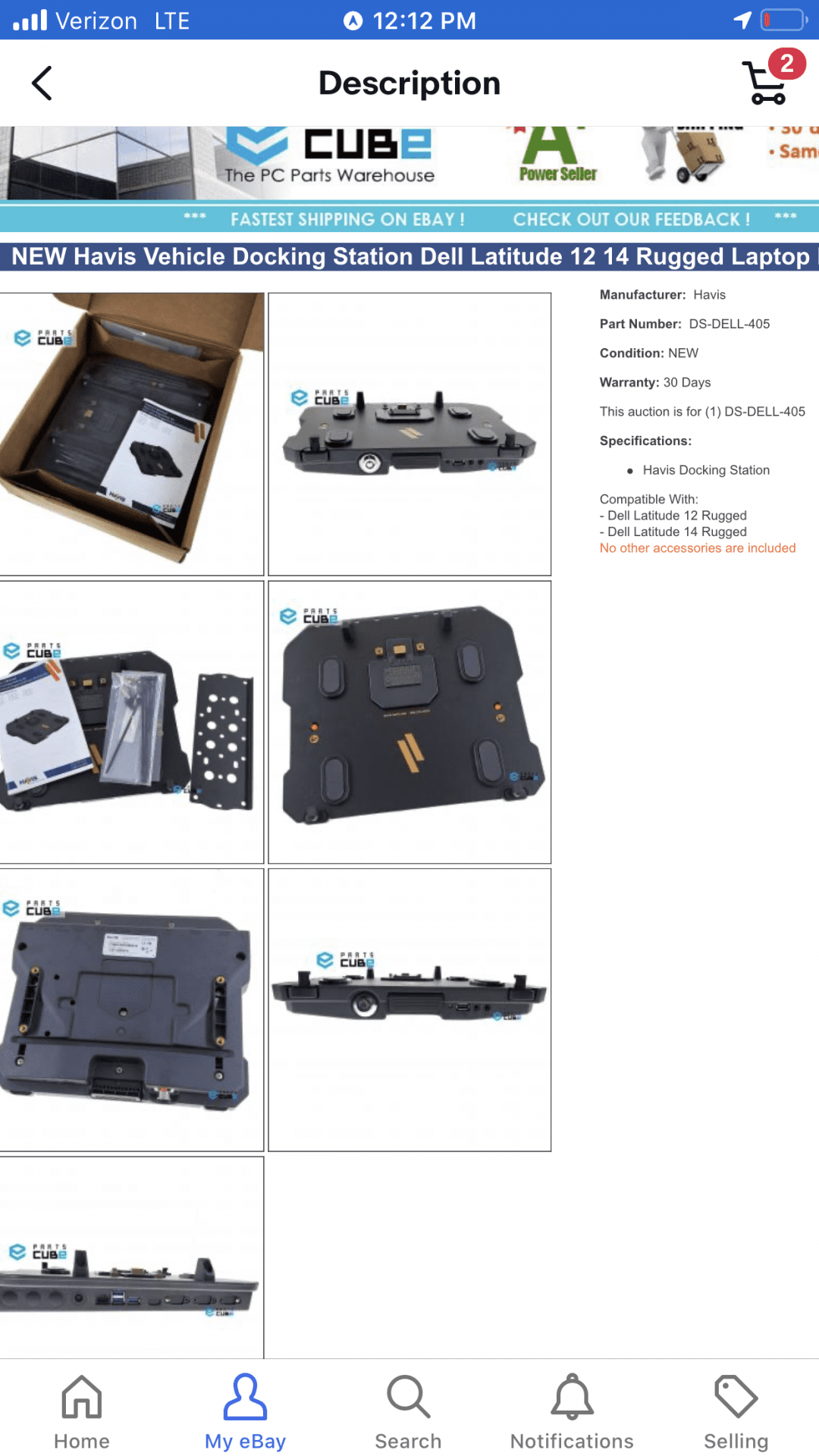

Going to try this dock and mount. $140 total for both plus shipping. I love eBay for giving the option of buying used and saving a bunch of money! Hopefully the RAM tough tray can hold the Havis Docking station. If not there is an adapter out there somewhere to mount it to the Havis dock instead of the RAM tray.
It’s going to be bulky with me trying to use both the tray and docking station, but as long as it is secure while still fitting in a passenger then I’ll be happy! Going to need those extra inputs on the dock!
Will update next week when it gets here!

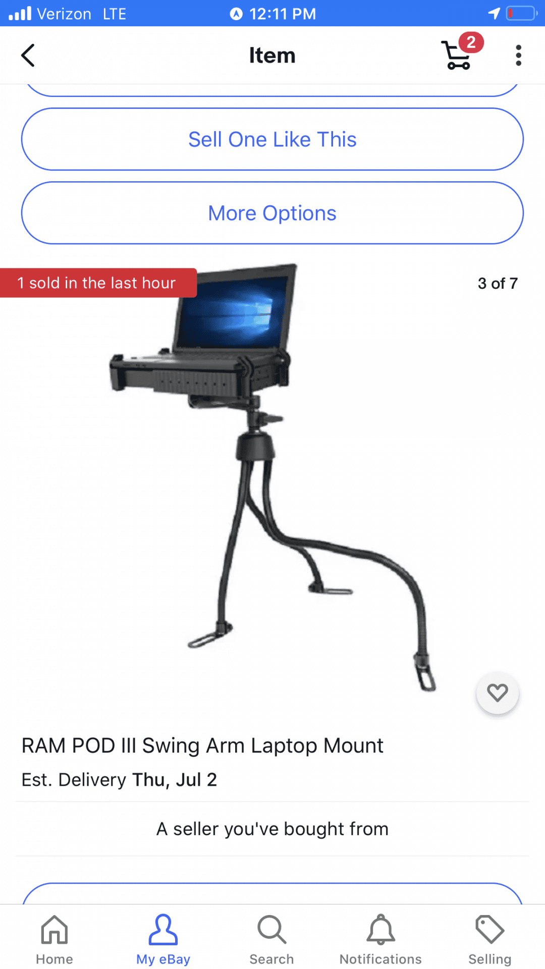

Very sturdy docking station. These things were $1000 retail when first released and were mostly catered to police vehicles, but old models will end up for eBay for 100 or less in many cases. Now I can hook the computer up to the multiple hardwired Inside cameras, the wired Ethernet cord, the wired microphone, power cord and etc, just by docking it. I plan on getting an external graphics card housing as well, so the idea is to dock the laptop and essentially turn it into a desktop with more capability (video games/intensive video editing applications).
It also gives me the extra USB ports I need to run all the cameras simultaneously (can toggle between them in OBS). I’m basically going to have a really comprehensive view of the interior and surroundings, even undercarriage, and be able to broadcast the live feed to almost any platform that allows live streams (even multiple platforms at same time).
The ram Pod iii with the tough tray will be here next week, and I’m hoping it will have enough vertical adjustability on the clamps to account for the thick dock, as well as hoping for a secure fit to the passenger seat rail.

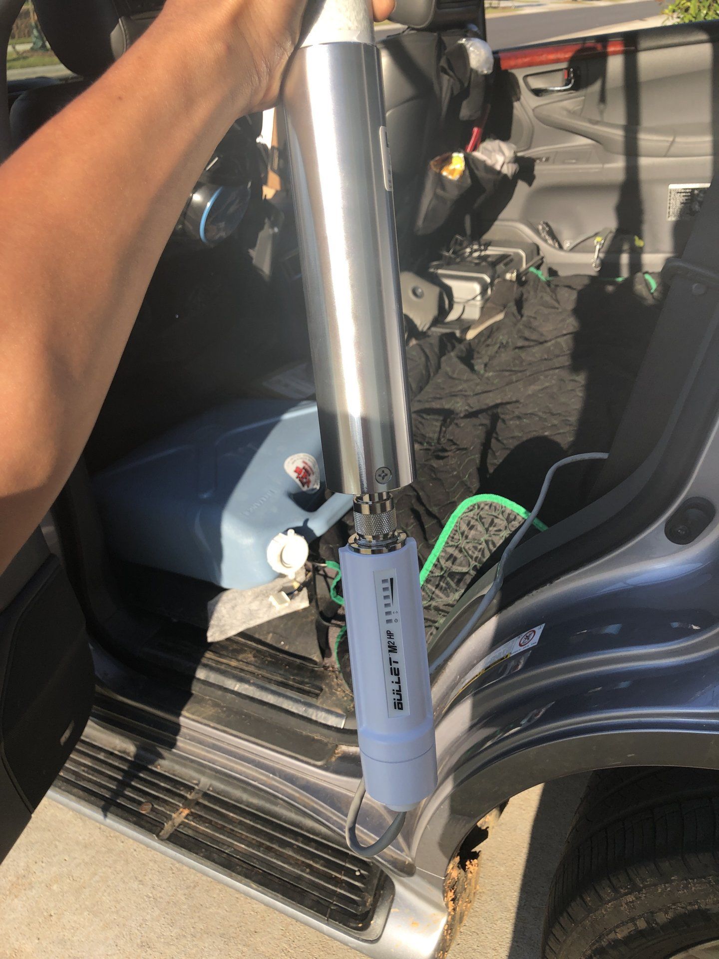

I also figured out quite a bit/did some testing off stream, in terms of making the stream setup wireless (mainly cameras) and setting up the Ubiquiti Bullet and antenna. Will do an update soon on that and eventually do a stream to show the setup process. It took me an entire day to get it right because of how customizable everything is and because the Bullet is a little unique, but now its simple once I figured it out. Next step is to Mount and test the range on the antenna.

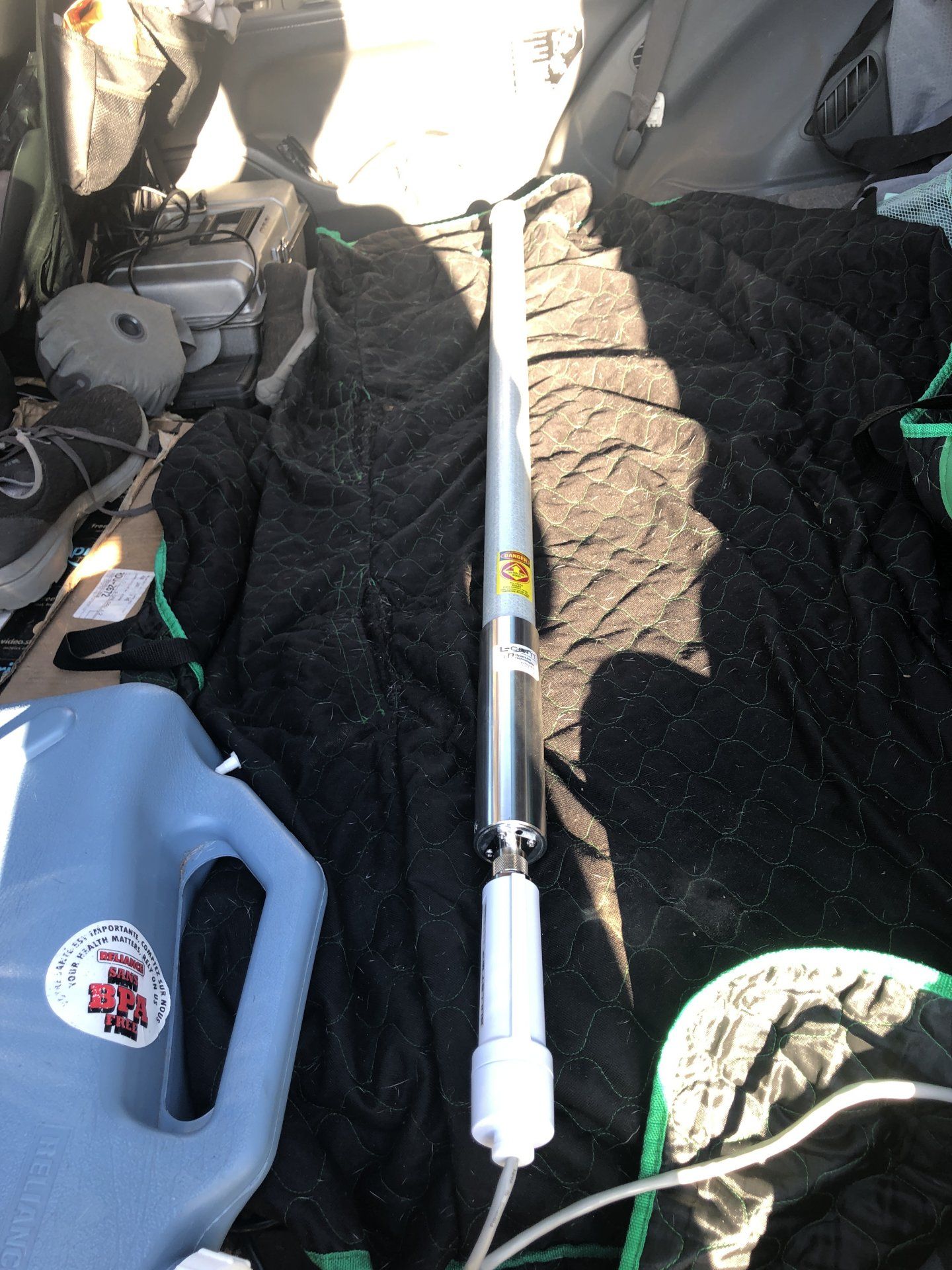

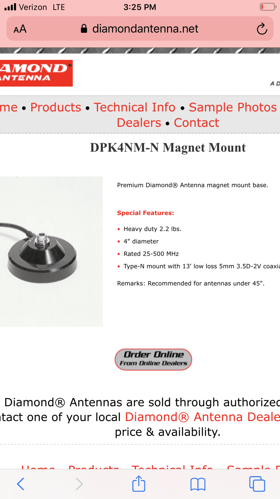

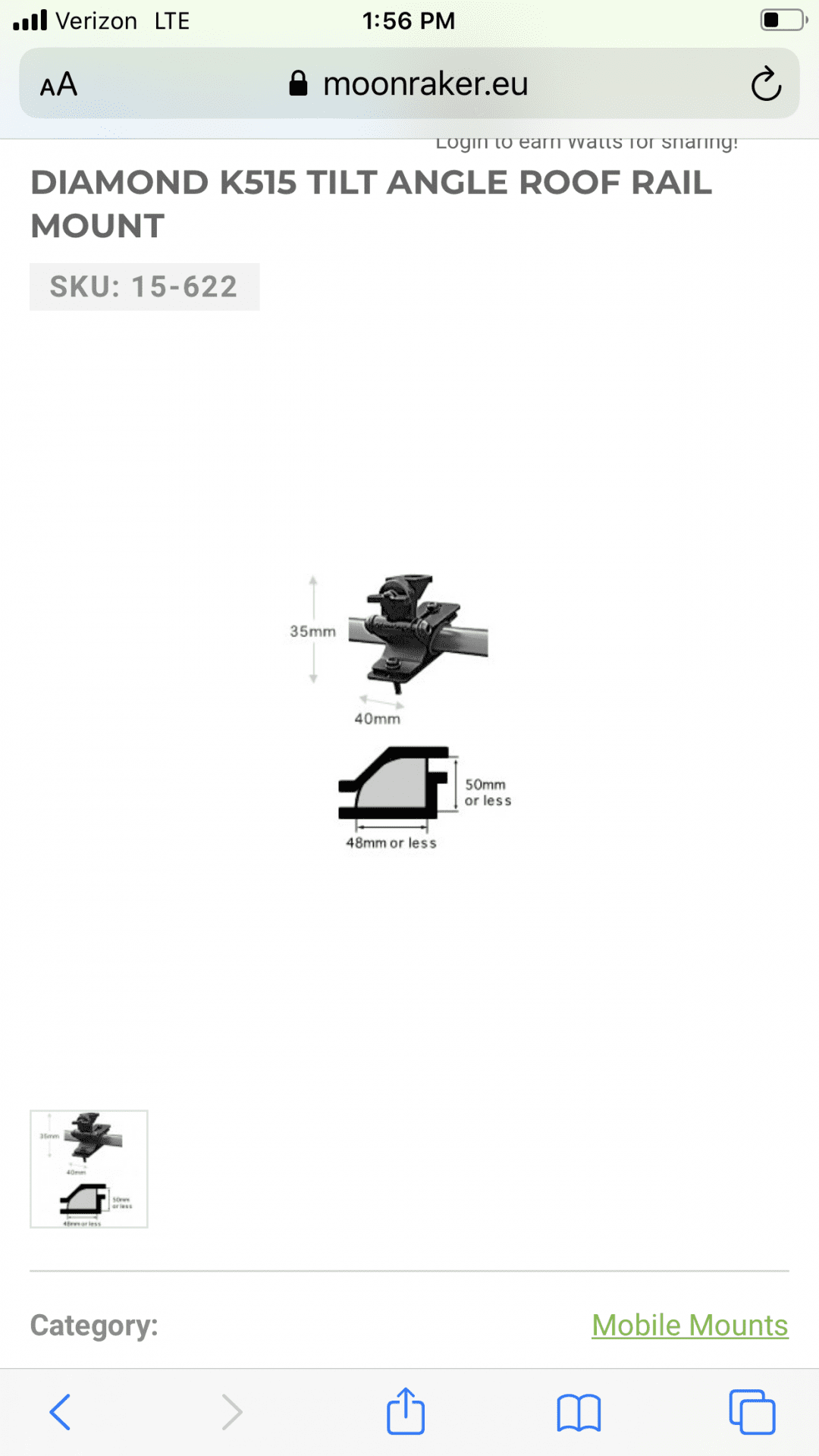

Anyone have any idea on how I could mount the antenna in a high location, but be able to fold it down when I’m not using it? I like to keep it a little discreet if possible.
Thank you. I added hinged to my searched and it helped a lot.
What i want:
- no drilling required
- folds from front to back, in case i hit something after forgetting to fold it down, and because the antenna + bullet is long.
- does not require aftermarket roof rack
So far i have only found this:
So the motorized one will not work for my antenna, and the rep suggested I go with one of the two options below.
Decided to go with this guy for the simplicity. I can just unscrew the antenna and throw it in the car instead of trying to find a rotating solution with the right connectors (which I couldn’t find), or trying to make the wrong connectors work for the rotating mounts. My antenna is N female (most aren’t), so I am picking up an N male to N male adapter as well. Total was $55 (including tax and shipping) for both from Ham Radio Outlet.

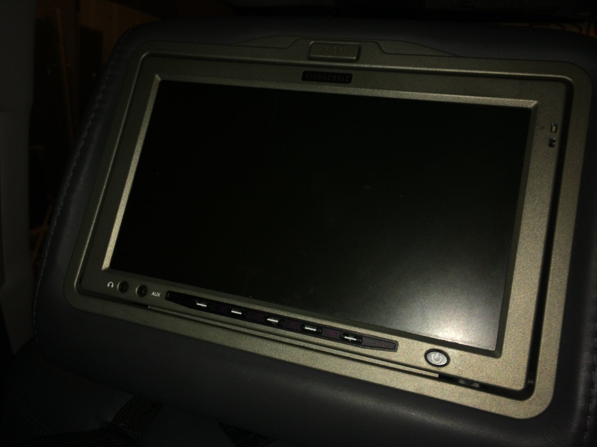

What powers these things anyways? I don’t see any wires running into the headrests??
do you still have these screens? i'd be interested in purchasing if you have all the parts.
Unfortunately, I only have 2 of them working. I was a little reckless and somewhere between laying on one and storing stuff by the other, I managed to crack the screens in the rear ones. I have been looking for someone to donate them to before I ruin the other 2 that still works. It is aftermarket so I have to cut the 2 wires to get it out, since I don’t know where the connection plugs into. The replacement wires were only 20 per seat when I checked.
Let me know if 2 out of 4 screens is good enough for you, and I will look into ways to take them out and do something else with that space. You can just pay shipping and if it helps you sleep at night, I will accept a little donation for them. Not necessary though as I’m just glad someone can use them, as I sure as heck don’t. Ideally I want to replace that area with a tiny screen that has an input that my laptop can accept, and then use it as a second and third monitor/live monitor/chat monitor for when I am live streaming.
I only need the 3rd row screens (the second row headrests). Did you have any stock screens or they were all after market?
I thought they were stock but judging by the cables they are aftermarket. These were the only ones that came with the car, and I was actually thinking of taking it out of the headrest. The headrests may not be interchangeable from 2nd to 1st row, but the DVD players/screens are all the same size? Let me know if it’s viable, if not then darn, least we tried.

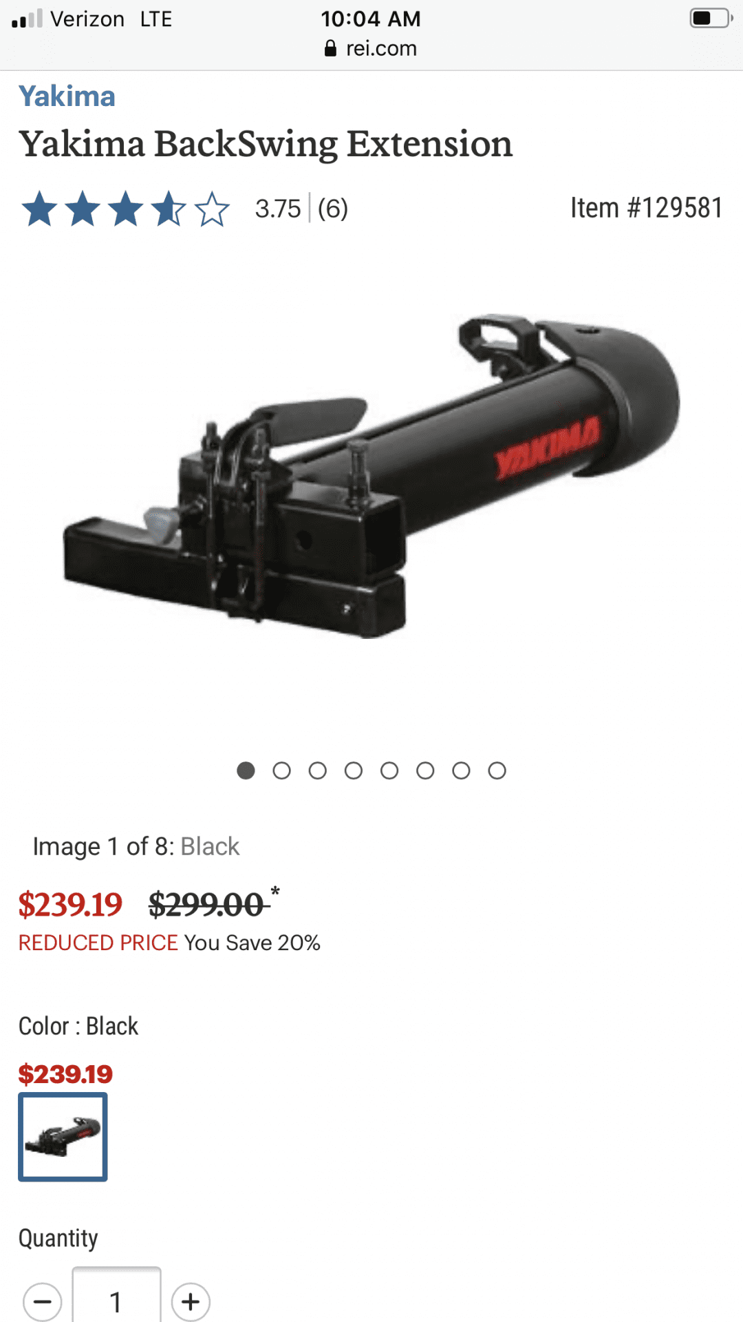

I had pushed the idea of a swing-away bike rack for the Ruckus aside, since I wasn’t bothered enough about lack of rear access to dish out $300.
Well, REI finally processed my Exped return from months ago (had a leak, bought another while sending leaked one back), and they credited it to a gift card instead of my original payment. They are that swamped that it takes months to process returns.
And on top of that the Yakima Backswing is 20% off for 4th of July sale for $240.
I did some research and although it is designed for bicycles, Humble Steve (my Ruckus), is still within the weight capacity (245 out of 250 lbs!) of the Yakima BackSwing. Thanks James from amazon review, how convenient for me that you run the same bike and carrier combination and answered my question before I asked it!
I am going for it unless someone knows a better way to spend my REI gift card. No more having to unload the Ruckus in order to open the hatch!
