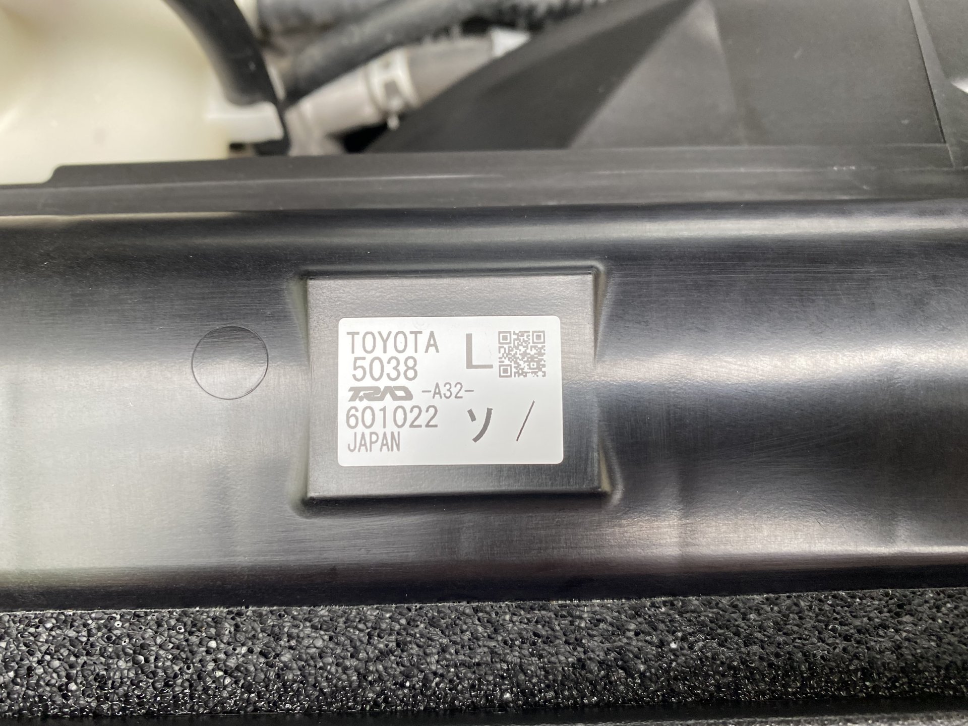

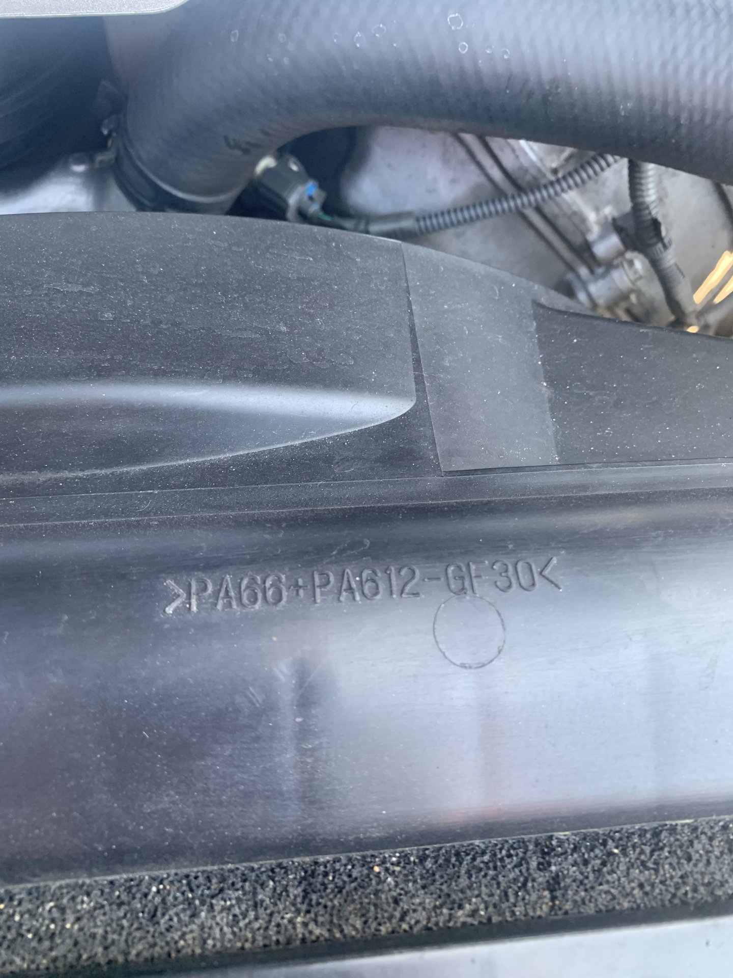

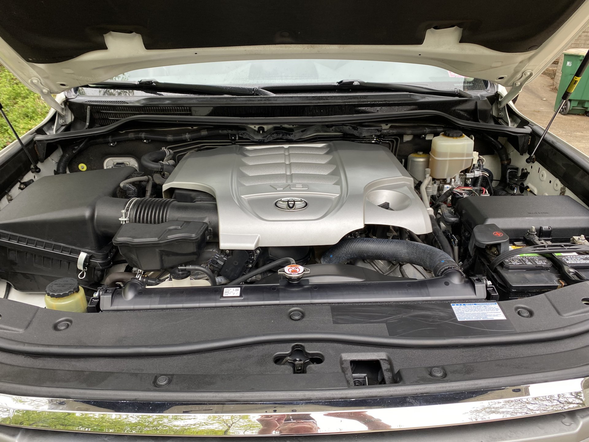

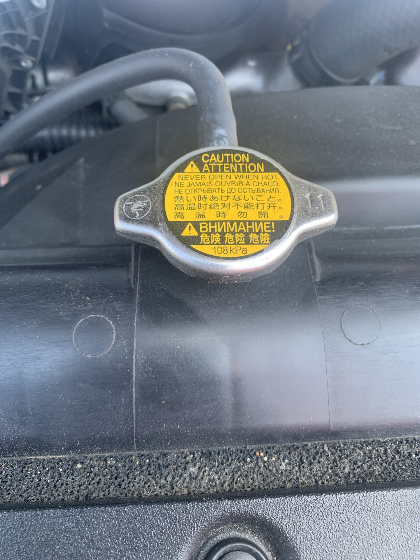

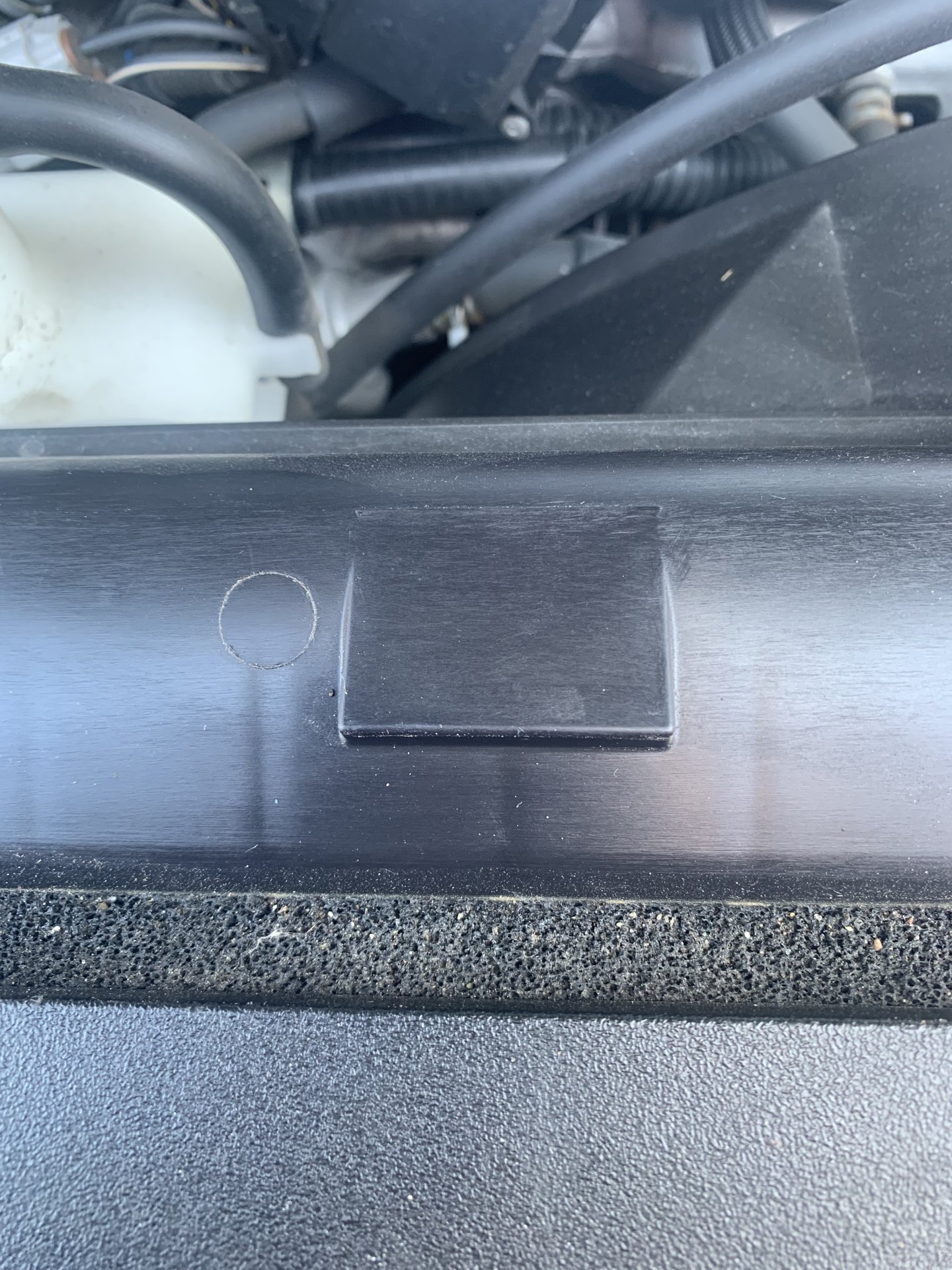

Pics as requested of radiator in 2013 LC
Middle
Left
Right
Let me know if you guys see anything. Looks normal to my untrained eye
Looks good with regard to the crack. It has definitely been replaced.
There is supposed to be a sticker on the flat area though.. are the bolts at the ends of the tank into the plastic mounting brackets 12mm or 13?
