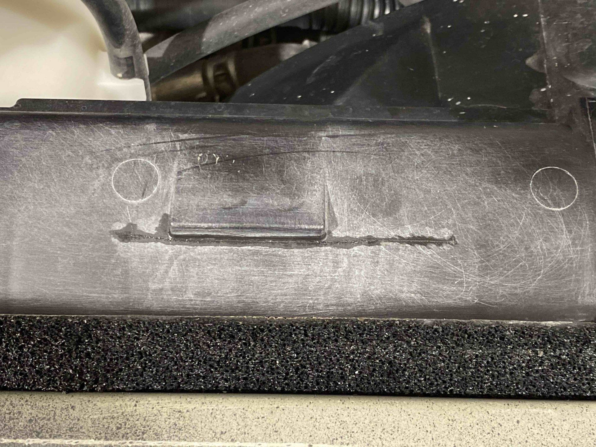

On a side note, my research revealed that plastic radiators are usually made from high-temperature, glass-reinforced NYLON. I'm not a materials expert, and I don't know exactly what kind of nylon, but from this resource Material Selection Guide | Endura Plastics I'd surmise nylon 6 or 6-6 (Identify Plastics). If you had the right prep and materials, you could probably perform a decent plastic weld. This Plastic Radiator Tank Repair Kit | Airless Welders is the only true weld kit I've seen, but to my knowledge no one on the forum has yet tried it. It's a quarter cost of a new radiator, so personally I'd rather spend my money on a replacement.
After Cleaning
UPDATE 9/10/20:
I tried hotwelding 6-6 nylon into the crack and it didn't work. Still had a pinhole leak after the (very crude) attempt. Lesson's learned—1) a heat gun (what I tried to use) is not a suitable substitute for a plastic soldering iron. It scorches and separates the plastic rather than melting. 2) the plastic on top of the radiator is surprisingly thin.
I followed with a JB Weld Kwikweld patch. That held just fine and I drove several hundred miles while waiting for parts.

On a side note, my research revealed that plastic radiators are usually made from high-temperature, glass-reinforced NYLON. I'm not a materials expert, and I don't know exactly what kind of nylon, but from this resource Material Selection Guide | Endura Plastics I'd surmise nylon 6 or 6-6 (Identify Plastics). If you had the right prep and materials, you could probably perform a decent plastic weld. This Plastic Radiator Tank Repair Kit | Airless Welders is the only true weld kit I've seen, and to my knowledge no one on the forum has yet tried it. It's a quarter cost of a new radiator, so personally I'd rather spend my money on a replacement.
View attachment 2412849View attachment 2412850
After Cleaning

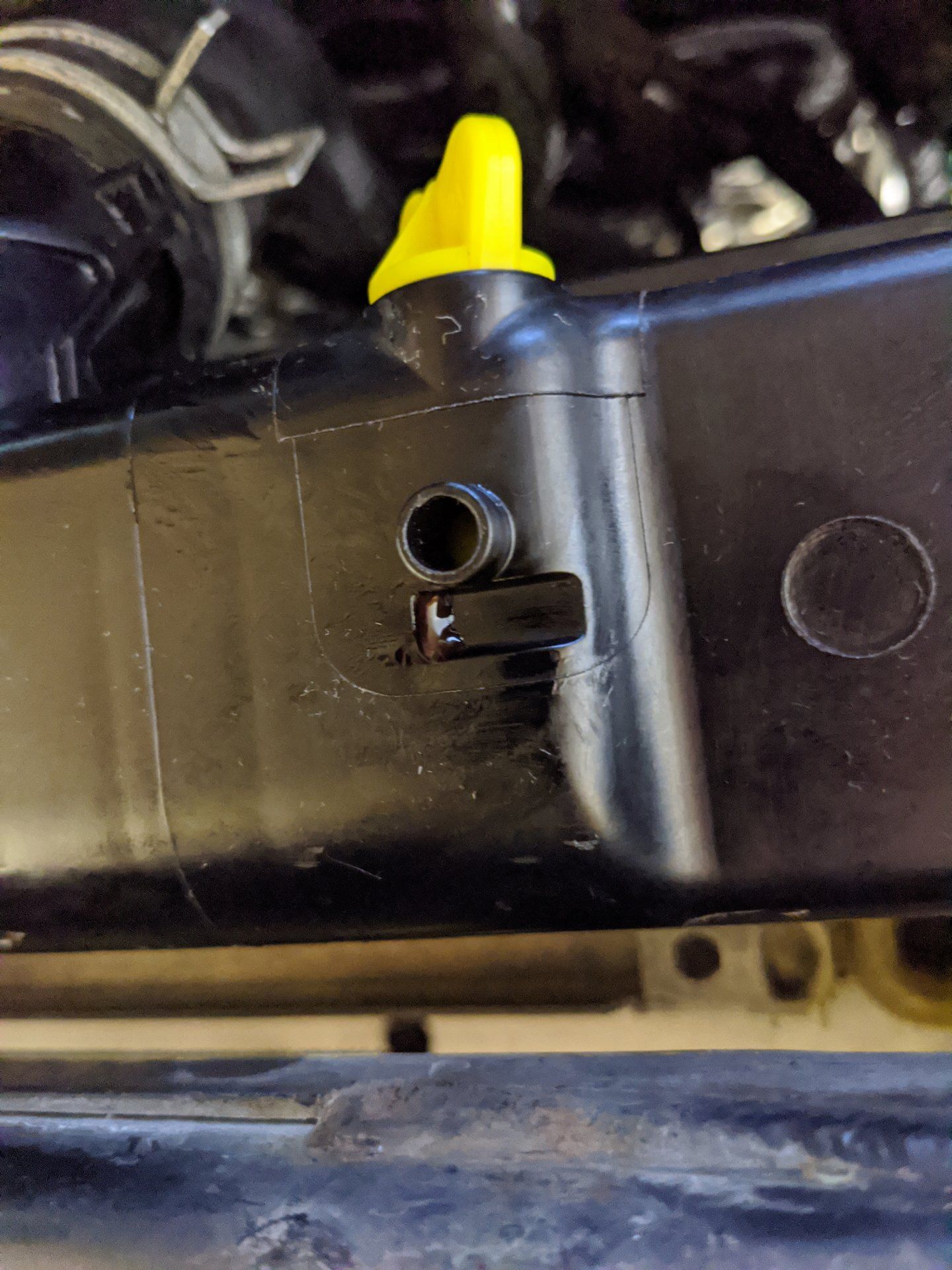

As of tonight, I joined the club. Heard some plastic cracking/ popping under the hood when I walked to the house after parking in the driveway. Not a normal sound IMO and took a light out to inspect at 10pm. Didn’t lose a significant amount of fluid
2008 169k original radiator
EDIT: Crack has been visible for months/ thousands of miles. Has been routinely monitored since I noticed it.
