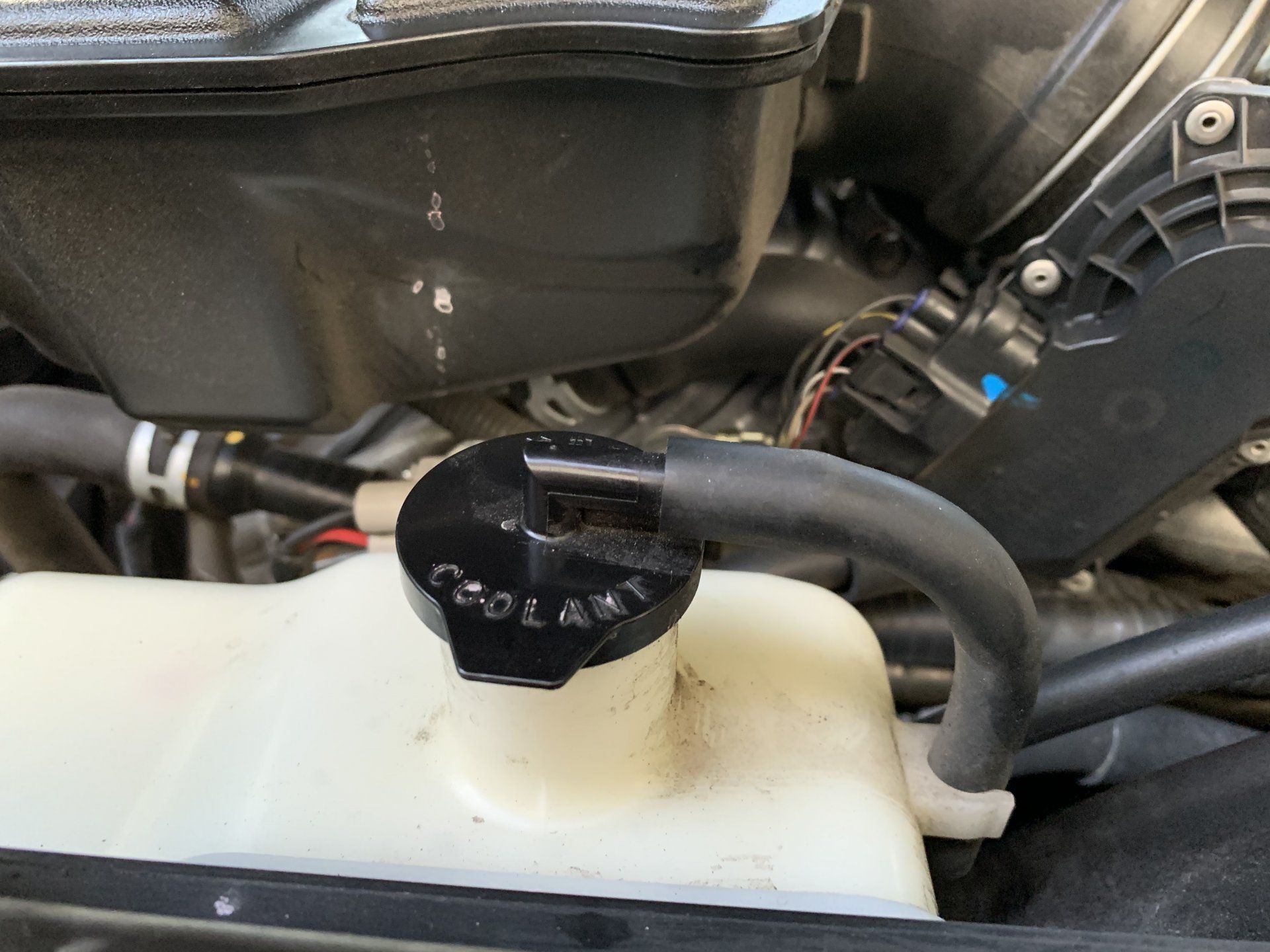

I’m having the symptoms in my 2011 LX:
-low reservoir
-hairline crack at the square protrusion on top of the radiator
-small signs of coolant splatter near reservoir and under some of those upper hoses
-as best as I can see, no signs of leakage near the water pump
-as best as I can see, no signs of coolant under the intake, though I’m not sure how obvious it is without removing lots of parts.

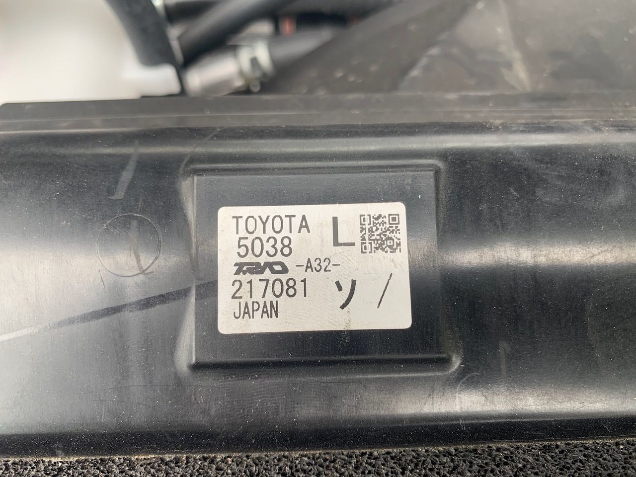

Is there any way to make sure you get the updated design with the nice filleted corners, is there a part number specific to that upgraded part?
like this:

Not sure - I ordered this part from Olathe parts and got the new version "with filleted corners":
16400-50384Radiator

thanks, that’s the part number I am indeed searching for. Did your radiator come with the foam strip that goes along the top or is that a separate part you have to order? I looked at the diagram in the link you posted and it seems to be part of the assembly according to the exploded diagram.

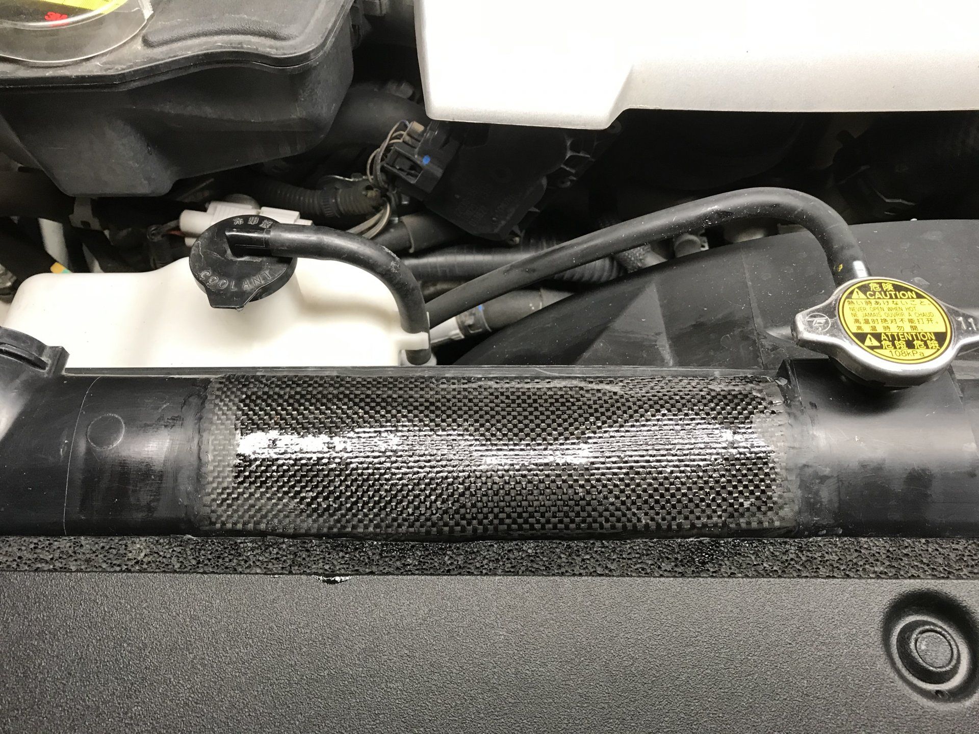

My radiator started to crack at 50k miles and would most likely fail in the next couple of years. So I saw this as a project and do some recurrent training with skills I haven't used for a long while. I will have no trouble installing a new radiator some time latter but not now at 70k miles.
I put down 1 layer of 4oz fiber glass and 8 more layers of carbon fiber to round off the fail point and one more layer to cover all of that. The epoxy was then raised to 225 deg f for a few hours for tempering and and then 180 for a while longer, blah blah blah, enough details.
The radiator may fail some were else at any time, but I had fun.

That looks really nicely done. How did you remove the raised part, did you just file it away?
No, the raised portion is hollow. I cut heavy pieces of CF in a U shape each one smaller than the last to gradually fill the void. I did not use any peel sheets to make it smooth because is is just a radiator and the tempering process would have altered that material.
Don't tell any one, but I did sand off the corner with a power sander when I was prepping the surface.
Gerald, at Polymer Composites, The Epoxy Experts is the guy to talk to about specialized applications with epoxy. He is the chemist who designed this high temp MAX HTE. Watch a couple of his you tube videos, the back ground music great.
