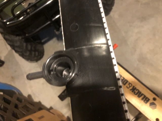

Here's some pics of the Denso rad I bought and had shipped from Rockauto.com in March. I opened the box after reading about the problems with cracking during shipping. It Looks OEM old style, which I don't believe is a big deal.,IMO. The current oem radiator has 130k total miles so far with one antifreeze flush on record and no signs of problems in the filler area. Hoping the one I have now holds up through winter but if it doesn't I'm ready to replace it. Along with the rest of the cooling system.
