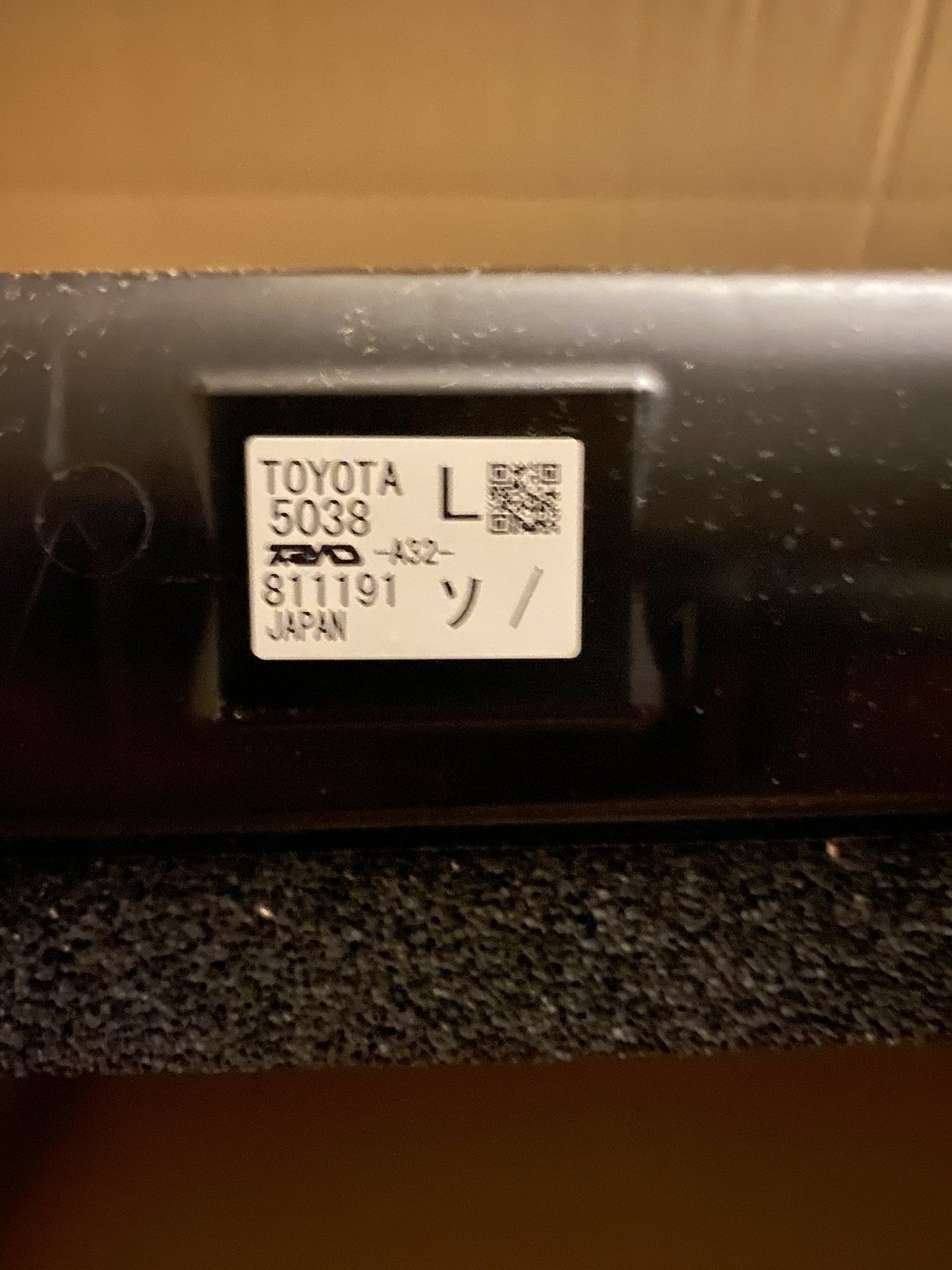

Got my new radiator. Hope this is the newest design. $288 plus $50 shipping. From a Toyota dealer that does a lot of online sales.local dealer in CHS wanted almost $500 and didn’t have it in stock . Said it would take at least a week to 10 days to get. This showed up from Kansas in 3 days

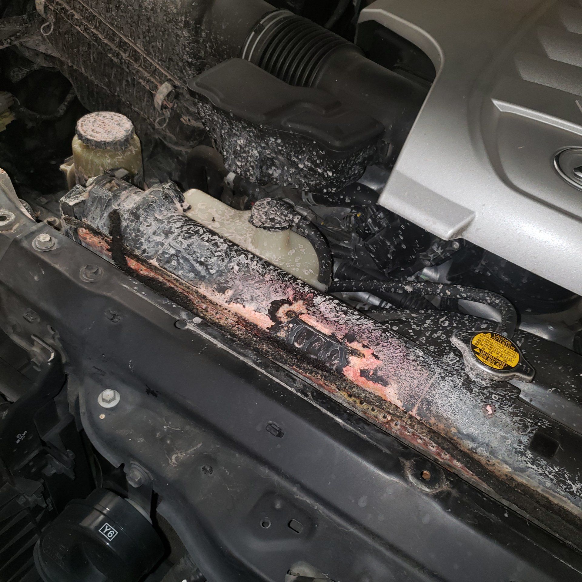

I changed what appeared to be the original radiator on my friend's new-to-them 2013 LX with ~110k on it, then put the old one behind the garage to wait on me collecting enough aluminum to bring it down to the scrap place.
After a few weeks of sitting outside, the upper spout turned an interesting color. The lower (which is the cooler side in operation) looked factory-new. The rest of the upper tank looked pretty good.. very dark brown color, as opposed to the solid black of a new one. But this upper inlet has clearly seen some heat. This was a Dallas TX vehicle as far as we could tell.
Well had the dreaded radiator crack on my 2011 LX. It also didn't seem like the radiator cap was holding. I'm at just over 140k miles. Went ahead and had the radiator, hoses, clamps, thermostat, water pump, serpentine belt, idler pulley, and belt tensioner replaced at the same time. Bought the parts online through the local Toyota dealer and had them installed at a local shop.
2011 w/90,000 miles. I put paint pen marks at the ends of the crack when it was noticed and then monitored it for 6 months until it started to weep. There was only a small amount of lateral growth during that period.

Working with our local dealer they covered the new rad. We just paid a portion of labor. I’ll have to say the dealer helped negotiating with Toyota. My call with Toyota was nothing less than frustrating...
