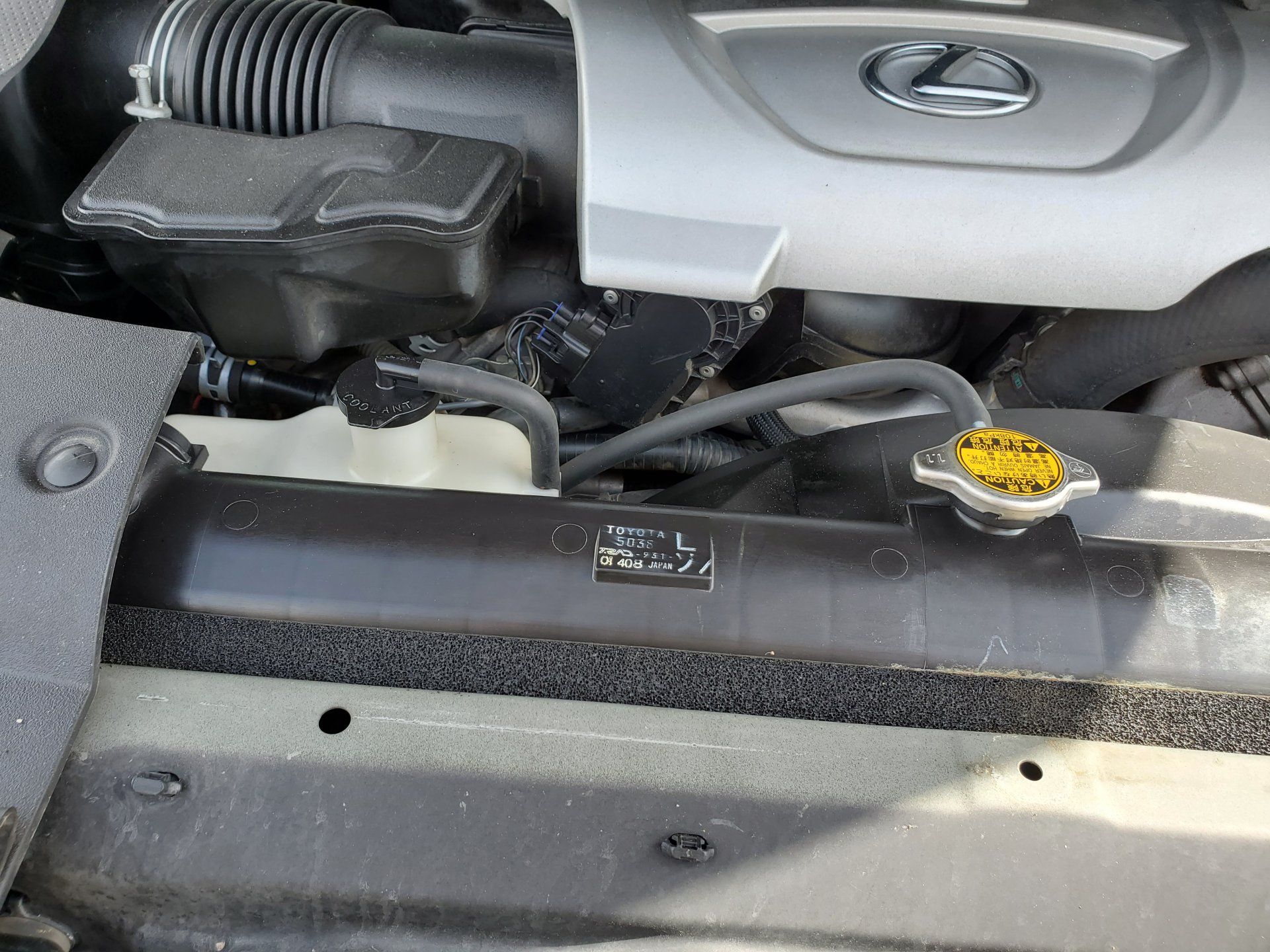

went out to inspect my radiator for piece of mind and found what seems to be a very new unit! Pleasantly surprised in a 2008 w/108K on the clock
went out to inspect my radiator for piece of mind and found what seems to be a very new unit! Pleasantly surprised in a 2008 w/108K on the clockView attachment 2377873

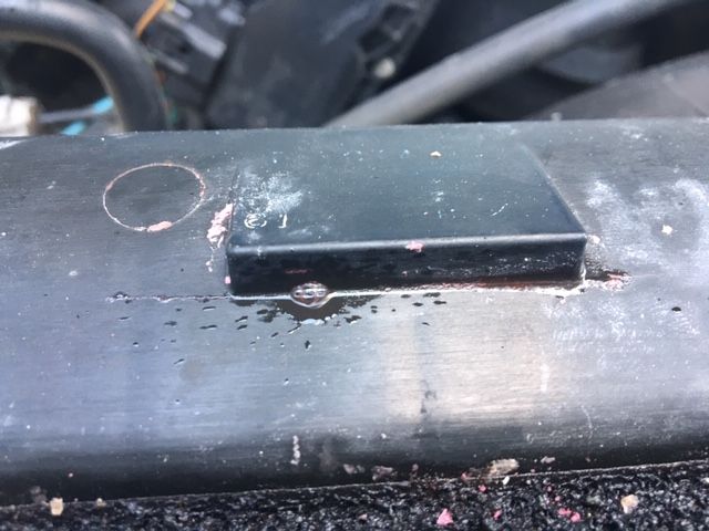

I could be wrong, but from the pictures, it does seem stress risers are present. Not at the typical front location. But along the two sides.
Your mileage may vary, but one strategy to prolong the viability of the part is to proactively repair and support the stress risers via radiator specific patch kits.

Find out if it's been replaced. If it hasn't, replace it. If it has, mean time to failure is around 100k miles, so I'd replace it after 75k miles just to be safe.

The issue with most of the methods to beef up the area is IF the crack still manages to grow you won’t know it’s happening... until it starts leaking.

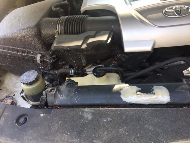

another one bites the dust...saw a crack yesterday in the wife's 08 LC 200, this will be the second time Ive had to replace the damn thing. replaced the original a few years ago when i did the water pump, it also had a crack. i put some JD weld plastic bond on it just to see if it would hold, verdict is still out.
Sure View attachment 2384375View attachment 2384376wish there was a way to use a Tundra radiator, the one in mine looks to be bullet proof and has been since 2008.
To be fair the new 200 radiator design does seem to address the single thing that keeps it from being absolutely bulletproof. Plus the tundra radiator is single row, ours are dual.
It may hold. I'm 6 months out from a patch and doing fine.
