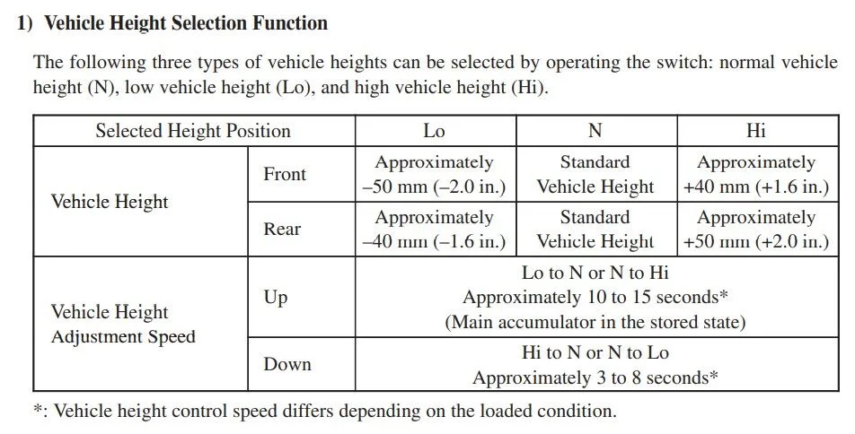

  • whether the raise from “LO” to “N” finishes with substantially lower than zero Height Control Sensor readings on Techstream (and/or readings substantially different from each other causing a ‘fail safe condition’ in which AHC/TEMS is non-functional), and,
  • whether the height increase “LO” to “N” is significantly less than FSM indications, and,
  • whether the raise time “LO” to “N” is substantially slower than FSM indications.

If very different from standard, then taken together these latter observations would suggest that either:
  • the system still contains significant air and the AHC Pump is spending time and effort compressing air before its energy is applied to raising the vehicle, OR,
  • the AHC Pump is unable to develop sufficient flow volume to fully raise the vehicle from “LO to “N” as expected due to:
  • internal wear or internal damage to the pump or failed internal seals, OR,
  • partial blockage in the AHC system, which is impeding flow of AHC fluid,

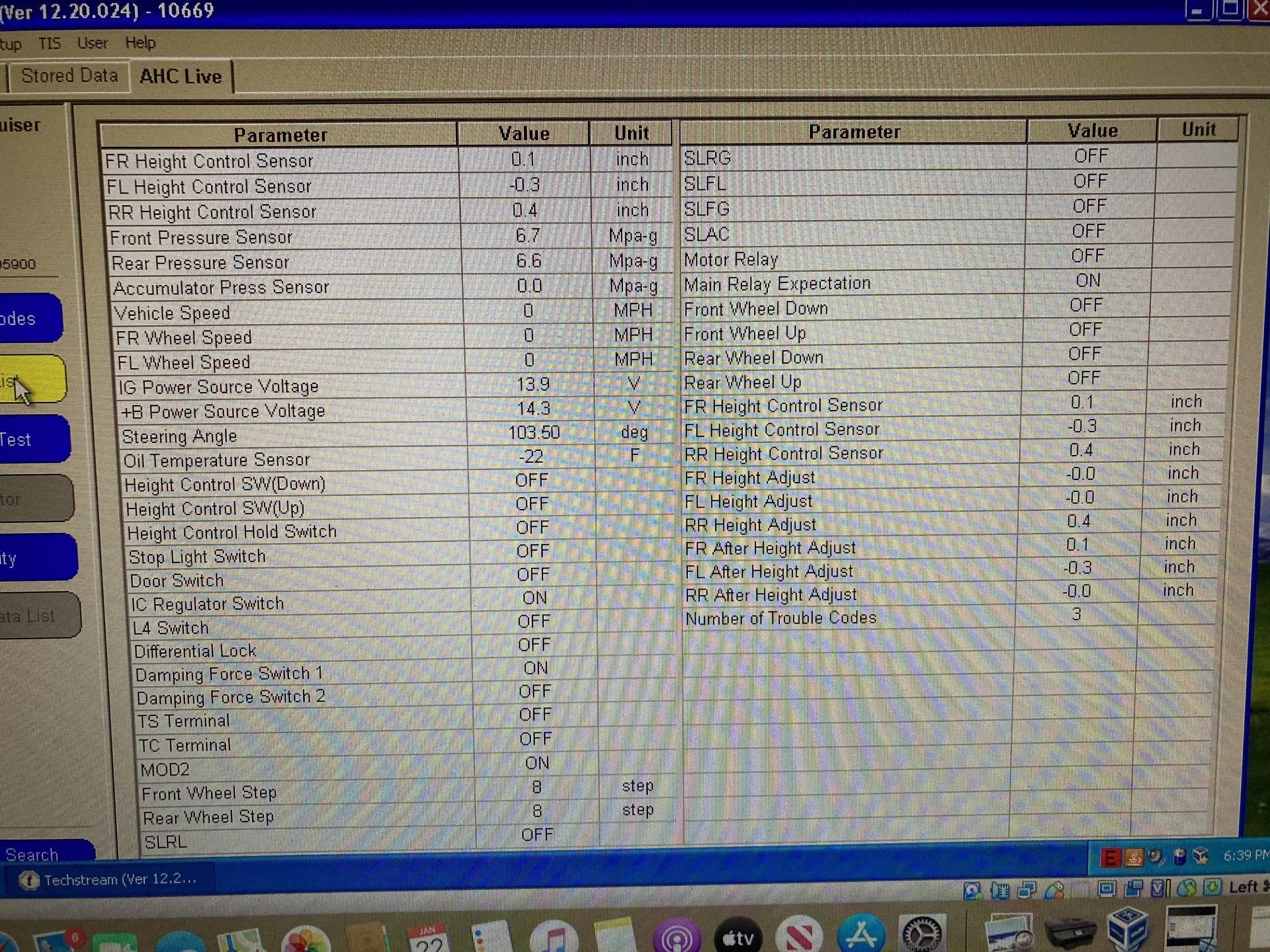

Ok, just starting to get my feet wet here. Let’s throw out the previous height measurements, I’m measuring more accurately, consistently, and from L to N (instead of H to N as I was previously). Here’s where I started today:
LF RF
490 489
LR RR
515 524
Techstream neutral data, coming up from low.
To summarize a few hours of “work”, I gave the torsions a few turns to get the pressures down, moved the height sensors up to the center on the slots (they were at the bottom) and this is where I’m sitting now.
My front end height is up to 502mm (factory perfect!) on each side, rear is roughly unchanged. Tomorrow I hope to fine tune the sensors to get them to zero. The rear coils currently have 15mm of spacers (10+5), I have some 30mm spacers to swap in and get the pressure down a small amount back there. I may stack one of the 5's or 10's on to level it out.
Since I posted the video on Sunday the weird noise happened once on Monday (or was it Tuesday?) morning and then it surprised me again this morning. Never heard it once during all of my work today.

Starting point is always front ‘cross level’ as the vital first step – and this looks good on your numbers -- worth checking again after any torsion bar adjustments and after suspension has settled after an around-the-block drive. (Note that Height Control Sensor adjusters cannot and should not be used for front cross-levelling).
Then heights – your hub-to-fender tape measurements at “N” look good -- near enough to IH8MUD recommendations. (By the way, the Factory Service Manual prescribes a different, very fiddly but technically correct method of measuring heights. The IH8MUD hub-to-fender approximations are not factory-approved but are good enough for most purposes).
Then AHC neutral pressures – your Front pressure looks good, Rear pressure looks good although at the high end of the range as you mention. Some correction with spacers seems worthwhile to give a some load flexibility while keeping pressures in range. Given their age, rear spring replacement is in the cards at some point. If the goal is vehicle in near-stock condition, then best to stay with new OEM AHC springs, spacers if desired/needed, plus airbags if more load flexibility is required. For additional load, heavy accessories etc, next step up is KING KTRS-79 replacement springs (spring rate 130 pounds per inch of deflection compared to 95 pounds per inch for new OEM AHC springs). I have KTRS-79, as expected they certainly give a firmer ride, not unacceptable, when the vehicle is empty, but give an excellent ride and good adaptive damping when the vehicle is loaded for touring.
Previously, 12 graduations were reported at AHC Tank between “HI” and “LO”, so it seems reasonable to assume your ‘globes’ are in good condition.
Height Control Accumulator pressure is showing zero in both screenshots rather than around 10.5 Mpa which is more usual. The zero Accumulator pressure is surprising given the previous Youtube indication that the raise-from-“LO”-to-“N”-cycle took 16 seconds – which is reasonably normal – and the AHC Pump running for another 15 seconds (or more) to re-charge the Accumulator also would be normal. Maybe this means that the readings were too quick, taken before the AHC Pump had stopped and before the Accumulator had re-charged??? Otherwise, this may indicate some problem with the solenoid valve at the front end of the Accumulator – which is a possible cause of the strange end-of-cycle noise. If there are suspicions about this, then observing this valve open and close by touch/sound during a raise, or, by watching “SLAC” turn “ON” and “OFF” on Techstream during a raise, may give an indication (see my previous post).
The point is that if a fault arises in this circuit, the ECU prohibits the control of accumulating and releasing of the pressure of the height control accumulator and may cause strange sounds. Actual timings of valve and pump operation are a useful indicator.
Your Height Control Sensor readings are close to zero
and within the FSM-suggested tolerance of +/- 5 millimetres. Maybe they can be tweaked a bit for fine-tuning but the differences are not large enough to warrant much, if any, attention. Note that adjusting the positions of the Height Control Sensor adjusters in pursuit of the perfect zero will be accompanied by height changes of the vehicle – a small movement of the adjusters results in a significant movement in height. In a healthy fault-free system operating within its load limits, the ECU always will cause the AHC to self-adjust to the “null point” (meaning close to zero, within tolerance) as determined by the Height Control Sensors – that is the purpose of Active Height Control.
Fluid Temperature shows as -22degF which suggests that Temperature Sensor was disconnected for testing – if so, seems normal.
Steering angle appears large in both screenshots – seems unusual but maybe this just reflect the steering position at the time of testing??? Otherwise, the steering angle input (from the sensor in the steering wheel) will affect the performance of the Gate Valves (in the Control Valve Assembly) which allow or disallow connection between Right and Left sides of the vehicle at road speeds. The Gate Valves are normally open when the vehicle is stationary, so the Steering Angle should not affect pressure tests etc.
What’s next???
The only significant adverse ‘vital signs’ coming from the AHC/TEMS system appear to be
  • reported harsher than expected ride, and,
  • zero Height Control Accumulator pressure reading, and,
  • sometimes noisy end of “LO” to “N” raise cycle,
  • three DTC's picked up and noted by Techstream.
These ‘signs’ may be related.
Reported harsher than expected ride:
Suggest check for ‘fail safe conditions’ which lock AHC/TEMS into Damping Step 8 or Sport Mode 2 and disallow adaptive damping or prevent valve operation, as mentioned in my previous post. Way back at Post #45 at Page 3 of this thread I attached the AHC Diagnostic section of the Factory Service Manual. This is a boring read – but it is worth looking through those pages to see how the Diagnostic Process is meant to work and to identify various ‘fail safe conditions’ which can arise and the associated symptoms which can and do help to diagnose problems.
To summarise, a ‘fail safe condition’ in which some or all of the AHC/TEMS functions may be prohibited by the Electronic Control Unit may arise from various faults including those in the following list. As explained in the FSM, a Diagnostic Trouble Code (DTC) may (or may not) be shown when these faults occur. Absence of a DTC does not mean that there is no fault. It is better to use the Problem Symptom Table as a starting point.
C1711 Height Control Sensor Circuit – you have experienced this previously,
C1718 Pressure Sensor Circuit – seems unlikely, AHC neutral pressure readings were obtained,
C1721 and C1723 Damping Force Control Actuator Circuits – seems less likely without related symptoms,
C1731 to C1736 Control Valve Solenoid and Accumulator Solenoid Circuit – possible!
C1751 AHC Pump and Motor Circuit – seems unlikely, motor and pump are operational,
C1762 to C1764 Fluid Pressure Abnormality Circuit – possible!
NB: If the DTC C1764 is detected, the ECU prohibits the control of accumulating and releasing of the pressure of the height control accumulator
C1781 Steering Angle Sensor Circuit – possible, consider later.
Can you identify the three (3) Diagnostic Trouble Codes (DTC's) picked up by Techstream and indicated on both screenshots? Should be revealed by hitting the blue Trouble Codes button.
It is also suggested that some obvious but sometimes overlooked effects are reviewed. For example, the AHC/TEMS system is designed to run on Toyota settings and assumptions. This includes OEM wheels and “P” rated Passenger tyres running at 32 psi !!! Very few of us follow this prescription. In my case I run BFG 275/65R17 KO2 Light Truck “E” rated tyres on OEM wheels at 40psi on sealed roads – and there is a ride quality penalty for my choice.
Sometimes noisy end of “LO” to “N” raise cycle:
If this were my vehicle, I would proceed as follows – you may wish to consider some or all of these steps or see what others may have to say -- there is plenty of wisdom in IH8MUD:
  • Carefully re-bleed the whole AHC system several more times until very sure that air has been purged – ‘several times’ as part of the effort to eliminate as much fluid as possible containing dissolved air as well as entrained air,
  • Given that the system will be opened for re-bleeding, take the opportunity to pull the AHC pump, dismantle and clean it, as well as clean the internal strainers by backwashing. As shown at the links in previous posts, this is not a difficult job. It is also a good way of getting a ‘feel’ for how much debris and jelly-like ‘gloop’ may be in the system, impairing fluid flow as well as impairing valve operation and pump operation,
  • Similarly, take the opportunity to open the AHC line at the Attenuator and release any entrapped air – not really sure that this will make a difference but it cannot do any harm,
  • Test and resolve any faults which may be forcing the system into a ‘fail safe mode’ as listed above and also resolve the three Diagnostic Trouble Codes (DTC's) picked up by Techstream,
  • Re-assemble and re-pressurise the system – if necessary use the “active test” procedure to re-start the AHC Pump with a AHC Fluid in the tank.
Current plan is to remove the 15mm of spacers and put 30mm on the left and 35mm on the right to compensate for the lean and slightly reduce pressure. Then adjust the rear sensor to get closer to zero (correcting the spacer lift and also slightly reducing pressure even more). My immediate goal is to get my height, pressures, and sensors all as close to factory perfect specifications as possible. Once those variables are perfect I'll feel like I can confidently proceed.
I'm not sure why the accumulator pressure was reading low there, I've looked again at more recent data and it shows 10.6 Mpa. Maybe I snapped the picture before the readings came up.
I have tried putting my hand on the pump and I've felt the noise twice, I could feel vibrations in the metal hardline. I'll check and see if there is a correlation between the accumulator pressure, SLAC and the noise. About the noise, I'd guess on average it's happening about 40% of the time.
Your Height Control Sensor readings are close to zero and within the FSM-suggested tolerance of +/- 5 millimetres. Maybe they can be tweaked a bit for fine-tuning but the differences are not large enough to warrant much, if any, attention. Note that adjusting the positions of the Height Control Sensor adjusters in pursuit of the perfect zero will be accompanied by height changes of the vehicle – a small movement of the adjusters results in a significant movement in height. In a healthy fault-free system operating within its load limits, the ECU always will cause the AHC to self-adjust to the “null point” (meaning close to zero, within tolerance) as determined by the Height Control Sensors – that is the purpose of Active Height Control.
Do you mean +/-.5 inches? My data is given in inches (unfortunately). Lately I've been messing with the left front sensor to get it closer to zero and measuring exactly what that does to front end height. That hasn't been as straightforward as expected and I'm starting to theorize why (more on that later).
Correct, temp sensor was disconnected.
I thought the steering angle number looked off as well. However in more recent data I've taken it seems normal.
The three DTC's. One was for the temp sensor (as mentioned was disconnected) and the other two are for the right and left height sensors. At the time I took the data I was assuming these were left over from when I replaced the sensors and the faults from the old sensors were still in the memory (I understand now that's not how it works). Now as I'm having issues getting that left front sensor closer to spec I believe these old sensors I swapped in are better than what I had but still not in the best of health.
Man, my brain just fries thinking about all the possible culprits!
My suggestion about tolerances on Height Control Sensor readings comes from the second page of the attached FSM extract (+/- 5 millimetres or 0.20 inches) but I am now wondering if I have misinterpreted this? Let's see what others say. Many IH8MUD members have posted Techstream screenshots where 'good' sensor readings are different by only 2 or 3 of millimetres, say about one-eighth inch.
I am not sure -- and have never seen a quote -- on how much actual 'difference' at the Height Control Sensors is needed to trigger a 'fail safe mode' -- but there are other indicators of this condition as discussed previously. These sensors and/or their connectors and/or harness do seem to be the cause of much AHC grief, especially as they age and deteriorate in their environment.
It seems that the cause of your "noise" at the end of the raise cycle remains elusive and inconsistent. My recommendations remain as expressed above at the end of Post #150 -- but you are following a methodical approach and hopefully that brings satisfaction -- even if not 'love' of AHC .....
Based on scattered reading (with no one definitive source), I put in my AHC tutorial +/- 10mm for sensor tolerance between the two most discrepant of the three sensors. Obviously as close to 0 as possible or all three sensors is best. You can ask Techstream to give you readings in metric or imperial units, metric feels more accurate in this case given that it uses mm. 0.5 inches is a bit outside a good tolerance window, but not terribly far off. It probably won't cause any problems, but if you can keep tweaking to get closer to zero, it would help me sleep better at night knowing one more AHC rig is closer to perfect.
Metric is more accurate in any case :) How do you change the readings from freedom units to metric?
I’ve played around with the left front sensor enough to know that it’s not in good health. Big movements on the slide make little change according to TS (it even went the opposite way it should have). So I’m on the lookout for another pair of used sensors and a motor/pump that I can rebuild and try out to get rid of the kazoo.
I still can’t wrap my head around why either one of those issues would have any effect on ride quality.
I think the height sensor inputs are used to determine road quality and therefore adjust damping settings. If a height sensor is on the fritz that input to the AHC ecu may not show the right "roughness" and therefore set dampers to odd values.

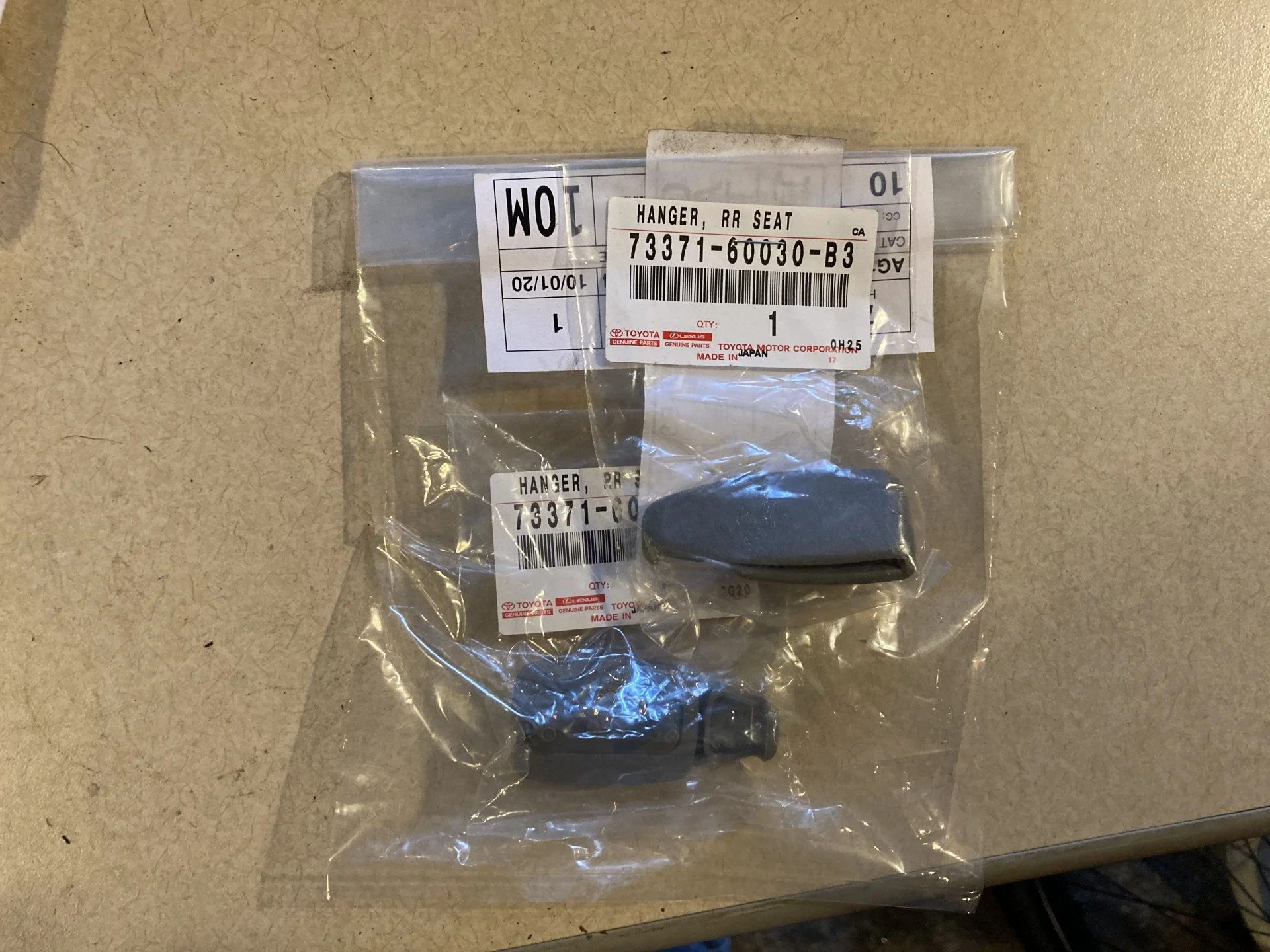

Broken seat belt clips replaced.
