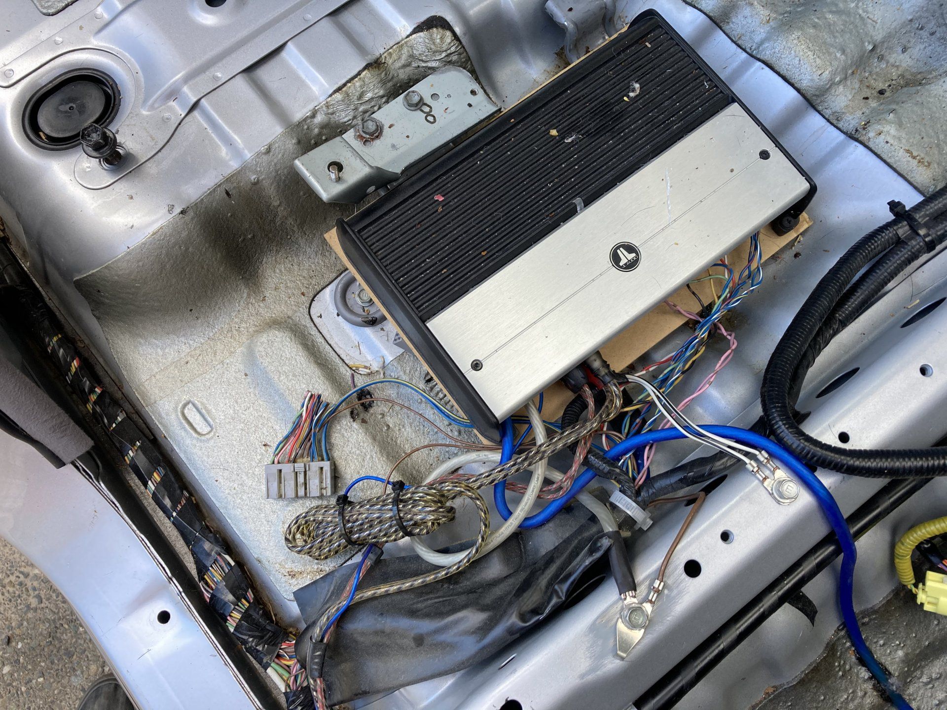

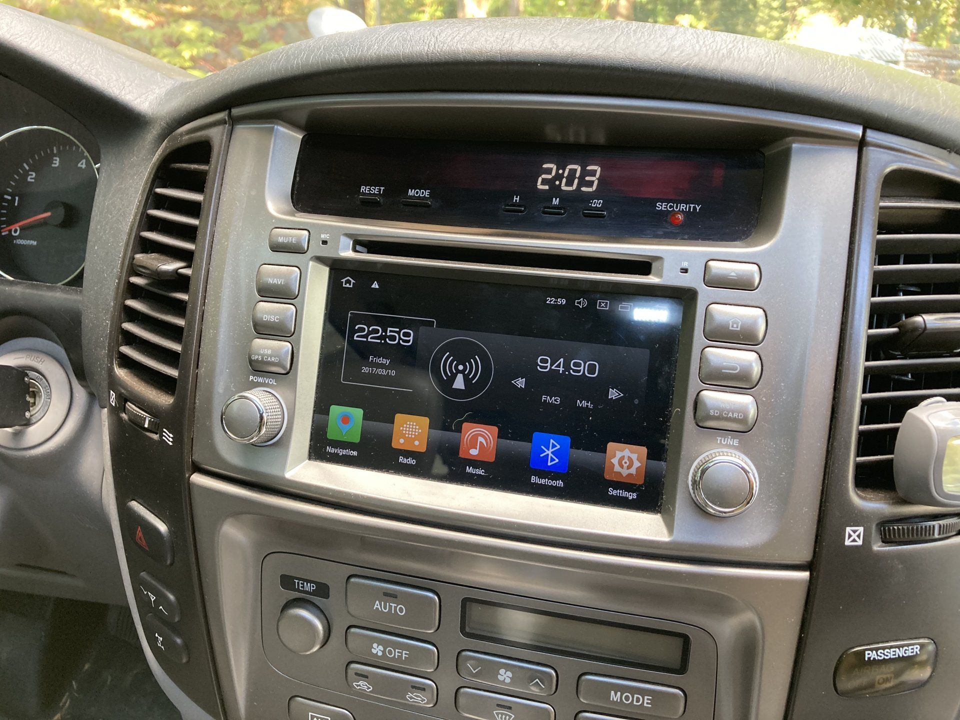

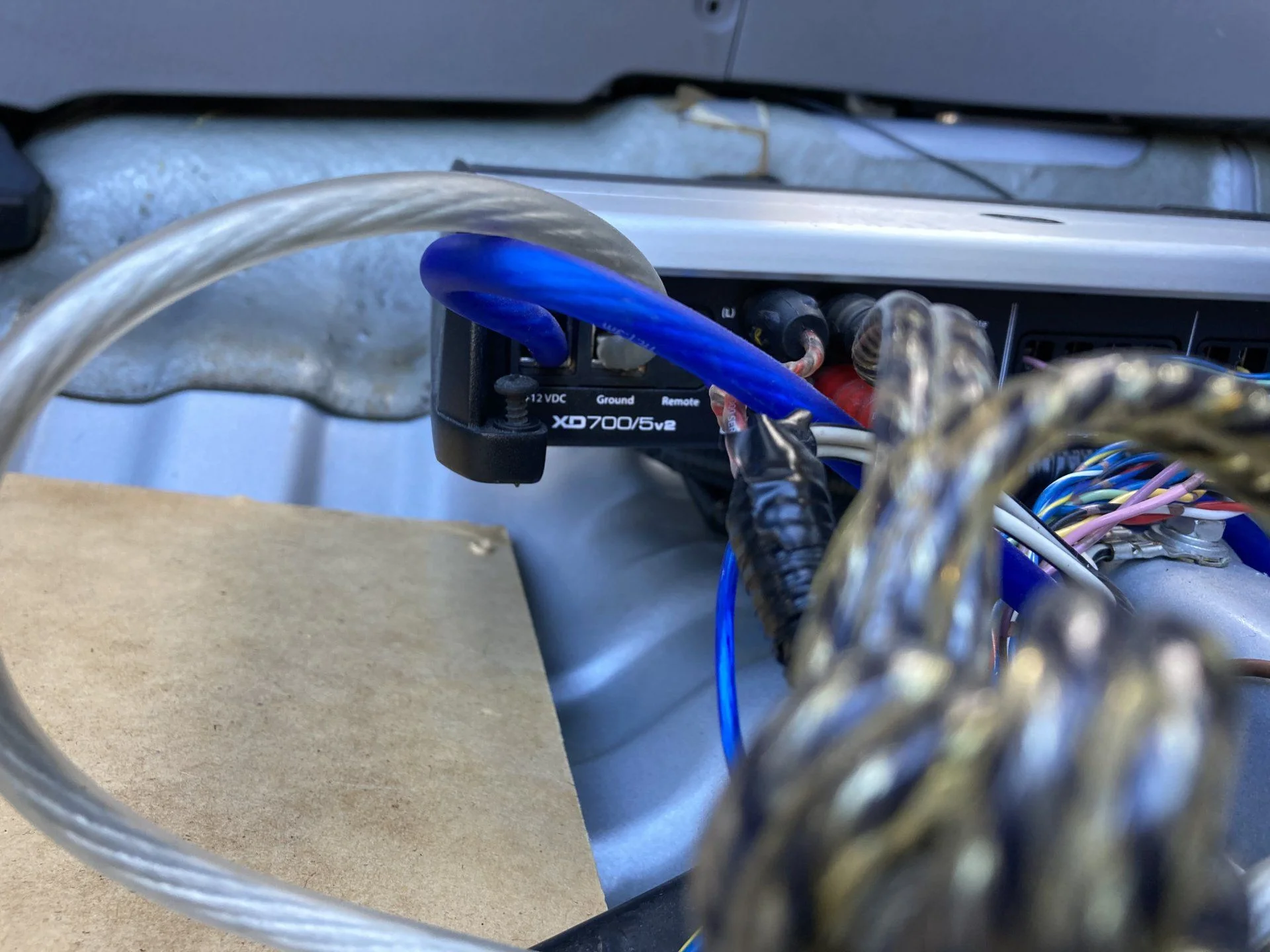

Yep, no nav ‘07. Details are in my sig. I have no idea who manufactured the head unit, there’s no brand name I’ve ever seen come up other than Android. For now it works, I’m not quite ready ($$$$) to replace it yet.
JL amp under the passenger seat (unmounted for cleaning).
Other than that it’s all standard ‘07 LC inside.

Very solid amp to use.

That’s a slick set up. That android head unit probably isn’t putting out a great audio signal, but like you said, will suffice for now as you will need to order a new fascia plate to replace it. The amp is using the factory speaker wires, which is fine. It’s also using the factory body ground point, which isn’t great, but it’s probably not a power hungry set up. What’s your budget for speakers look like?

Well, it's not ideal because it adds a bit of resistance and hence voltage drop on the power run to the amp. A better solution would be a ground from frame to amp and adding a ground from the battery to the frame at the battery. Even better is running a ground wire from battery to the amp. But as I say that's really not that necessary unless your amp draws alot. Probably never going to be a bottle neck.

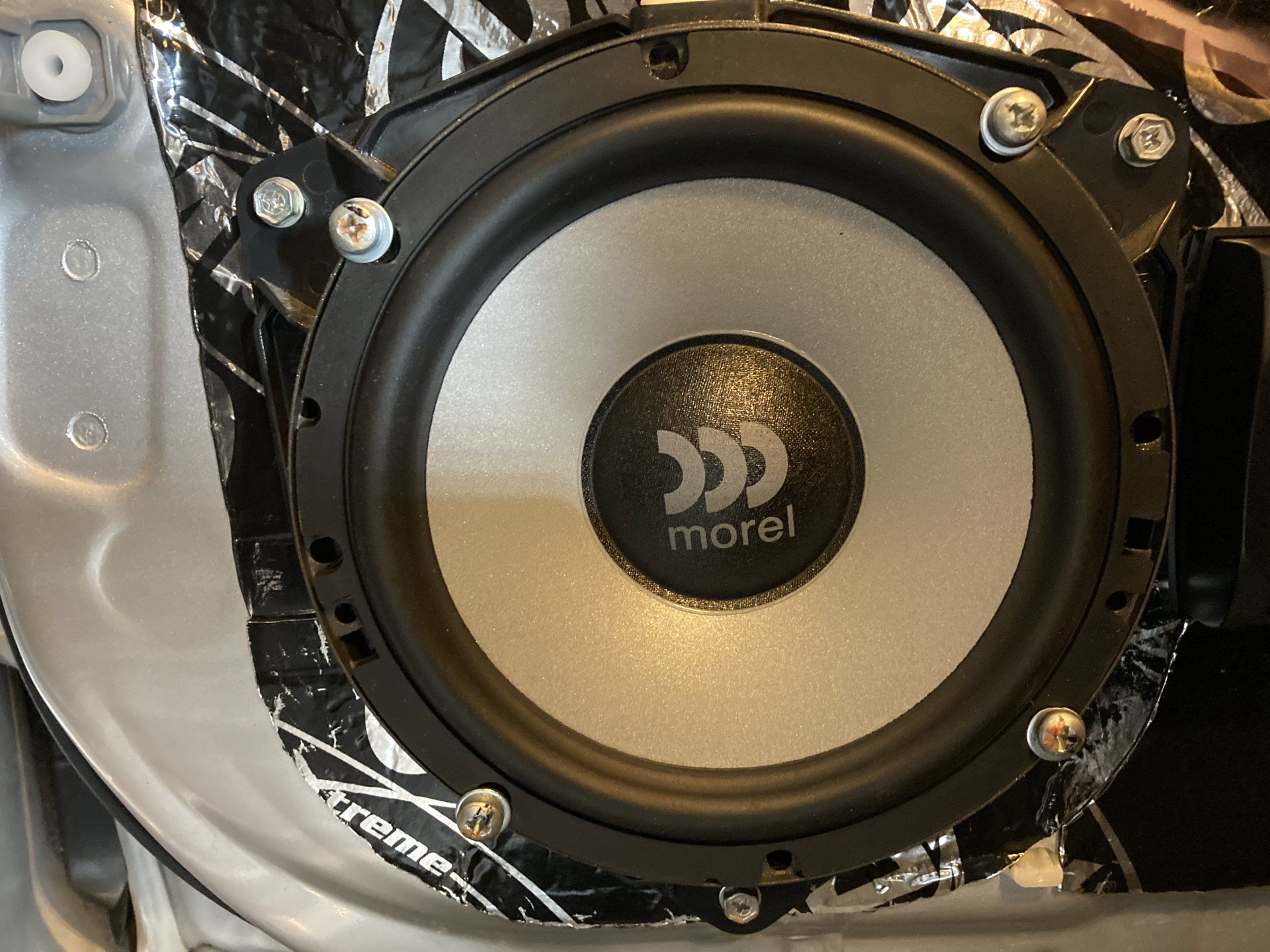

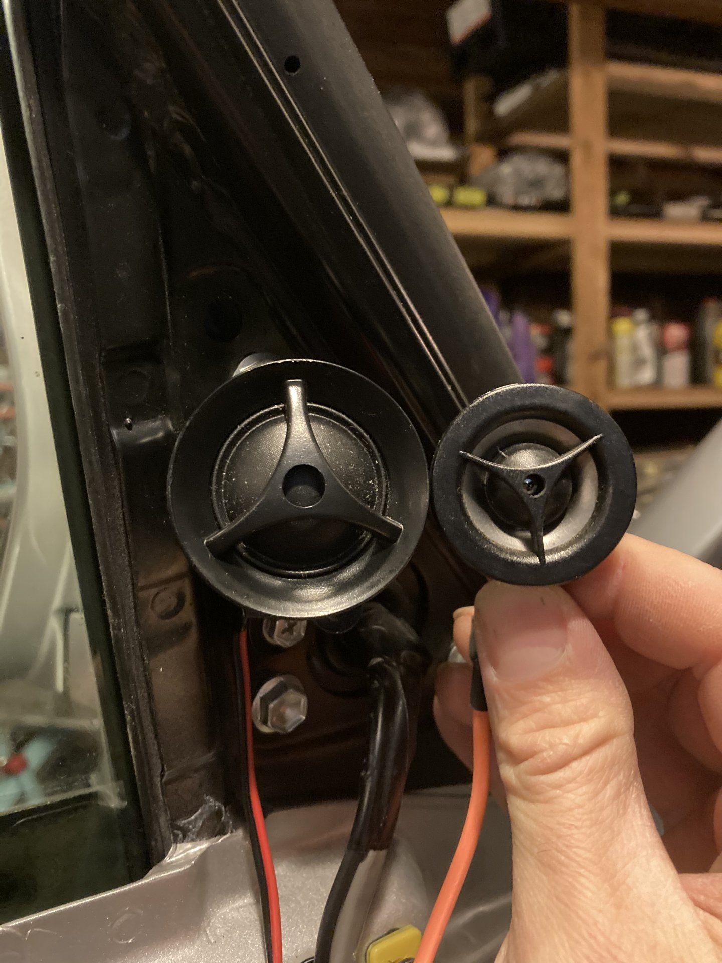

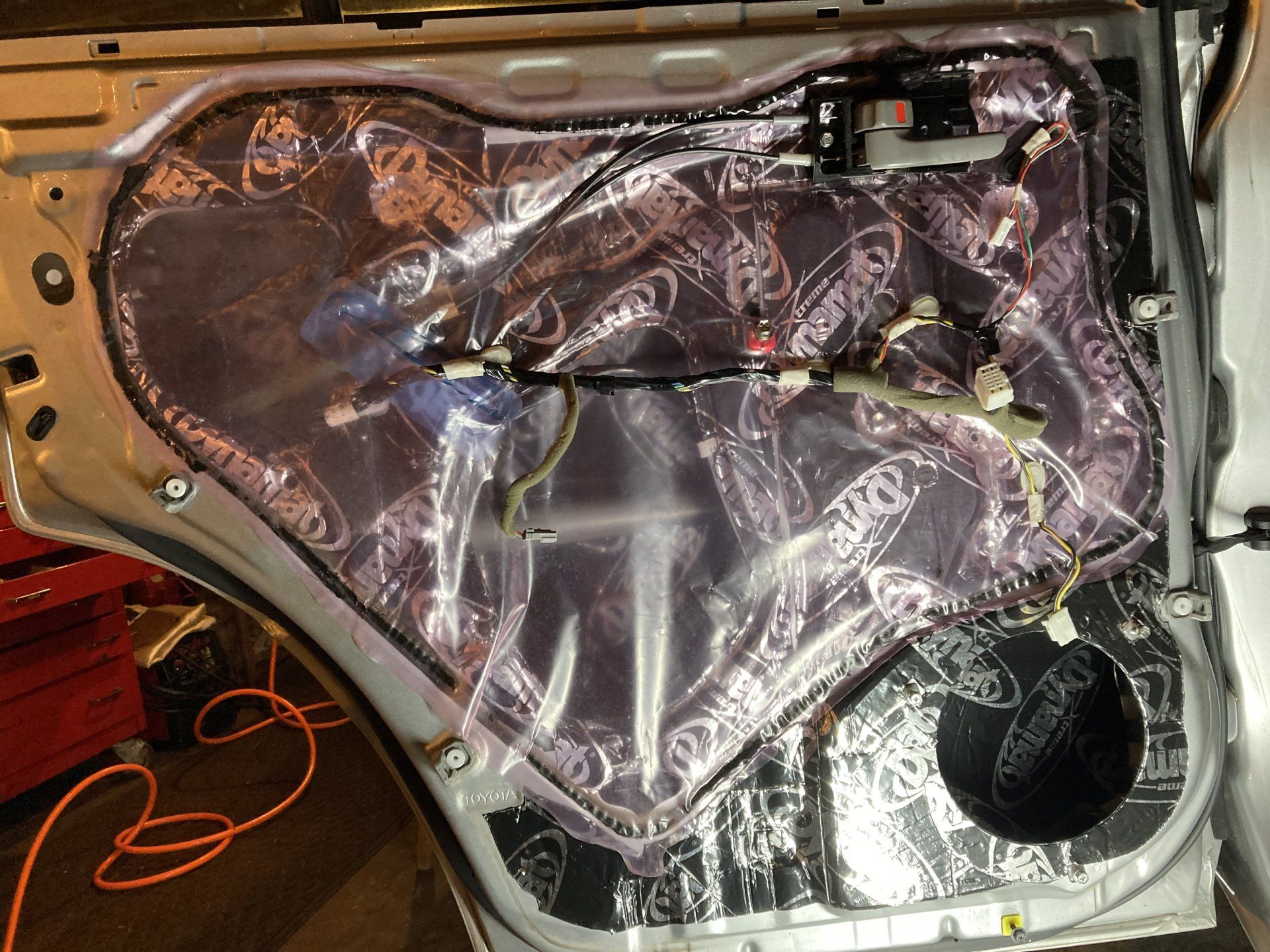

Thank you @Pucker5 and @Njck22 for the help. So far I’ve got the front doors sound deadened inside & out and the Morel Maximo Ultra 602 component speakers installed.

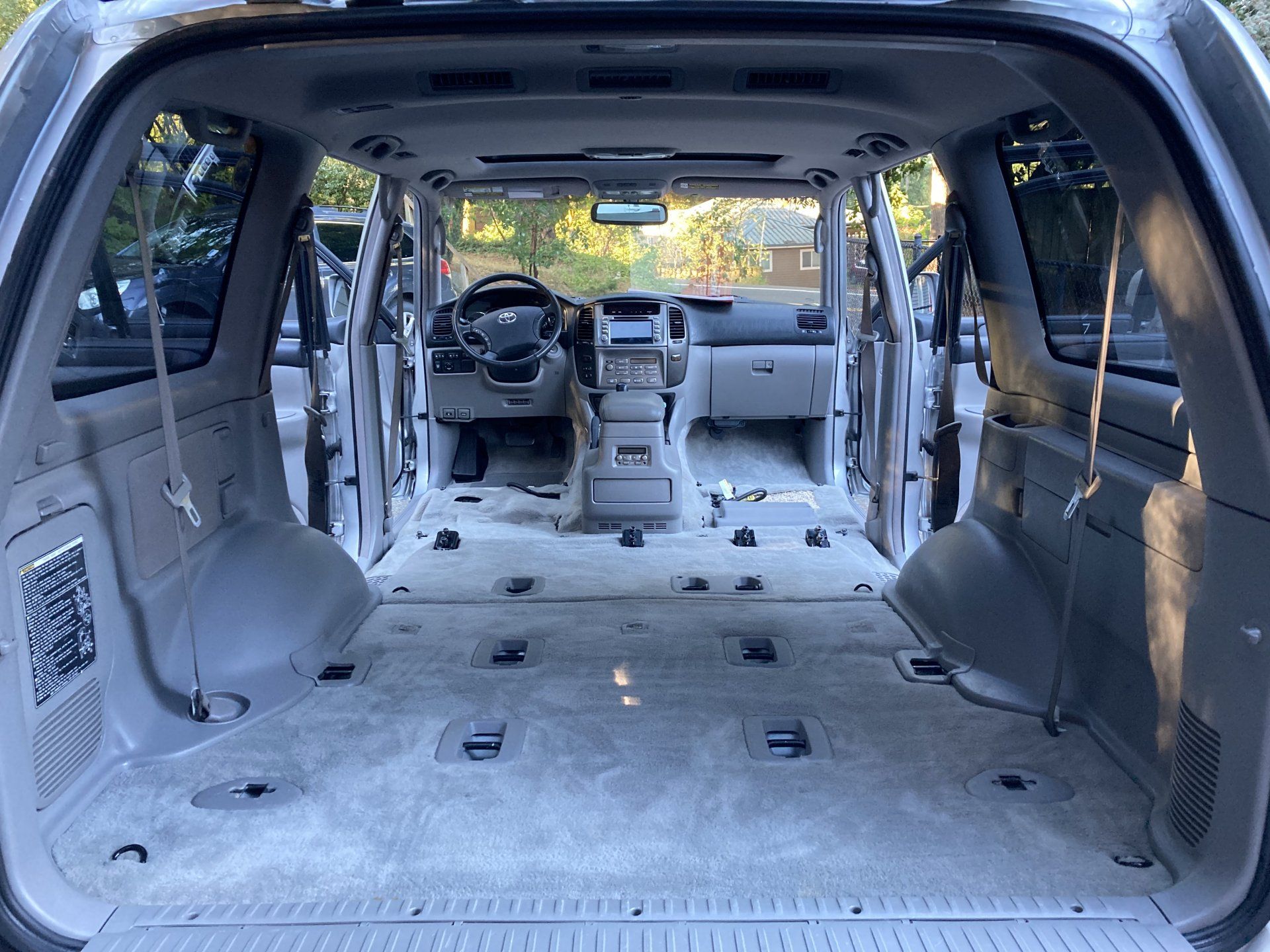

Working on the rear coaxial’s right now. I went with Dynamat because I’ve used other sound deadeners in the past and they didn’t have as good of adhesion and stretch that I’ve experienced with Dynamat.
