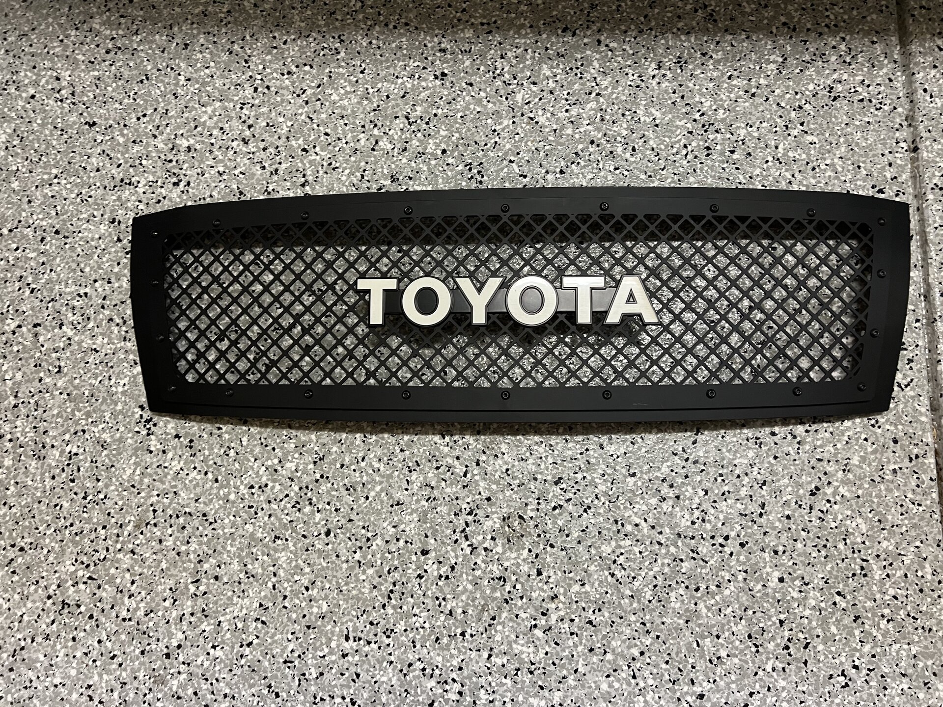

Will any other LC models and years front grill replacements fit? including this one FRONT GRILLE FOR TOYOTA PRADO J120 2003-2009? or do I have to go with an LC100 OEM and powder coat it black? TY
The 100 series front grill is not the same as a Prado 120 series, negative sir it will not fit.
If you powder coat the plastic grill, it will deform/melt when subjected to high oven temperatures when the powder is cured. Best alternative is use spray paint - rattle can or spray gun with air compressor.
