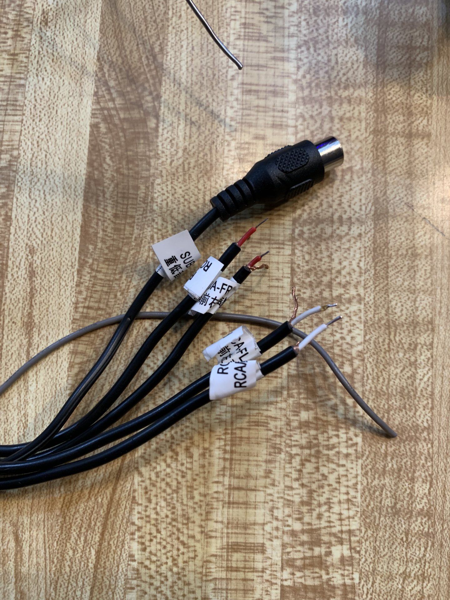

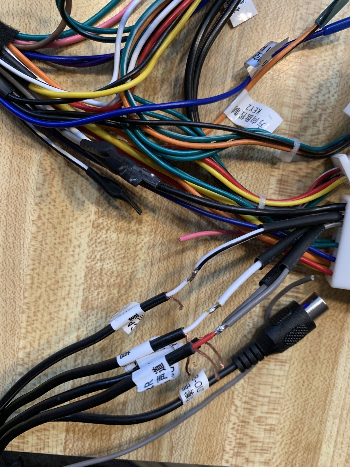

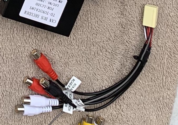

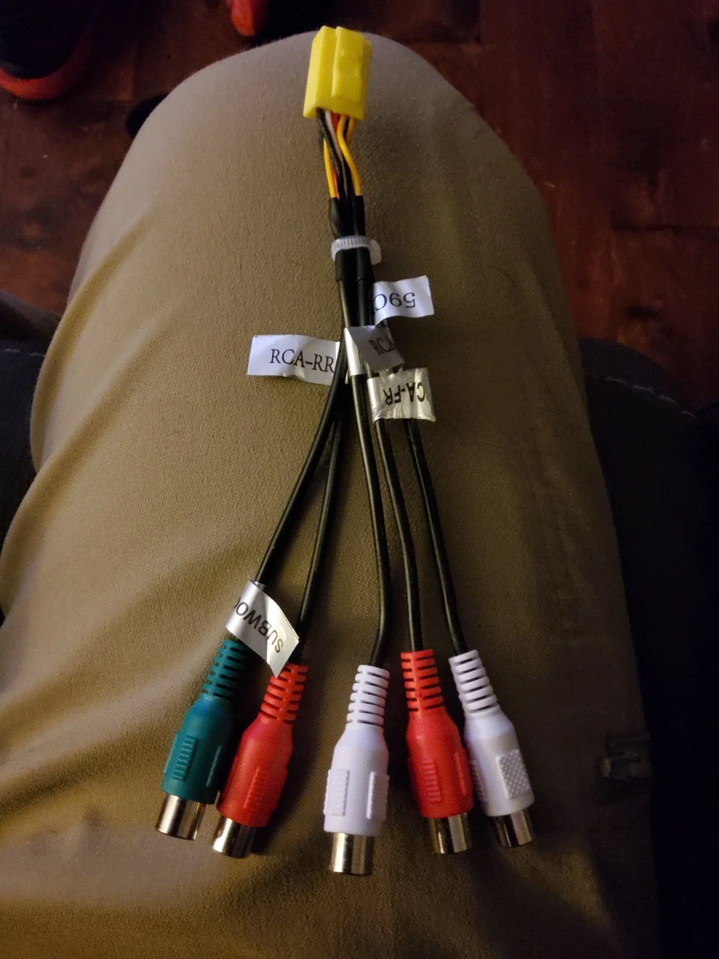

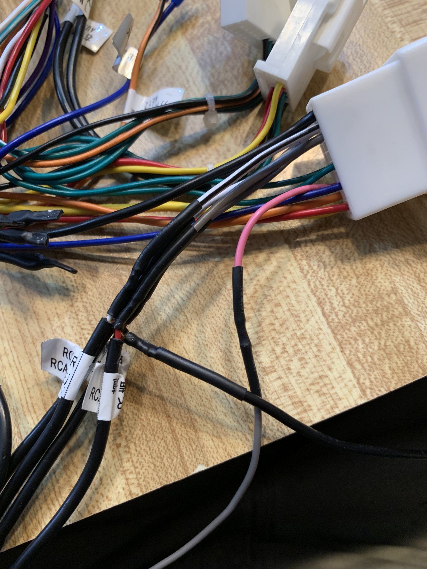

Get your soldering iron and heat shrink out (or butt connectors if they're your thing). This is how to fix the audio portion to work with a factory amplifier.
I cannibalized this harness to make this work. First step is to cut off the red and white RCA connectors.
Then, prepare the wires for solder. Take note that this is shielded, single-conductor wire. So strip it once, pull the shielding aside and then you'll need to strip it again to get to the center conductor.
Then cut these four wires (gray, gray/black, white & white/black) that run between the black connector that connects to the new headunit and the white connector that connects to the vehicle.
The center conductor in each of the wires is the positive lead. Solder or crimp the wires together using the following "key":
FL - White
FR - Gray
RL - White/Black
RR - Gray/Black
Then twist all four of your grounds together and solder them to a piece of extra black wire (18-20awg is fine). In the newest harness that was sent to me, there was a pink wire connected to the white connector for power to the external amp. If you don't have this wire, you'll also need to solder a wire on to the gray wire in this "low-voltage" harness.
NEXT POST

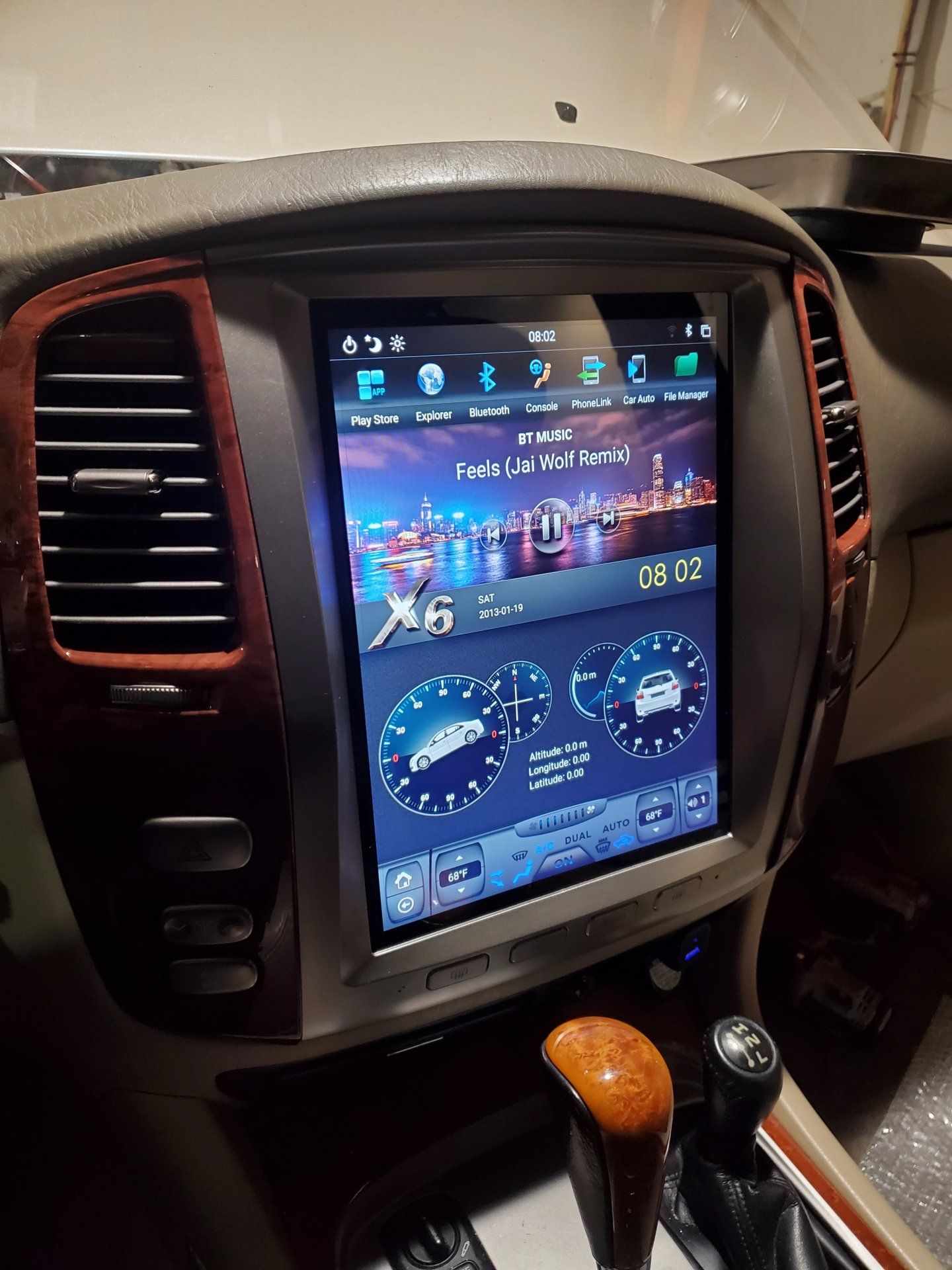

It was completely plug and play. I didnt need to do any splicing. HVAC and steering wheel controls work. I have a 2003 LX 470 with Mark Levinson system and factory Nav. I am not sure if I have a different type of factory stereo harness as it didn't look 100% the same with the OP's factory harness. I also followed @Try2Bfast suggestion to leave that one connector unplugged for the dimmer to work.
4 physical buttons don't work but I can live with that. It is very responsive.
Sound quality is good once you get the settings dialed up.
Picture above is right after installing it. I have now since updated the Boot logo and wallpaper to the proper LX470 pictures.

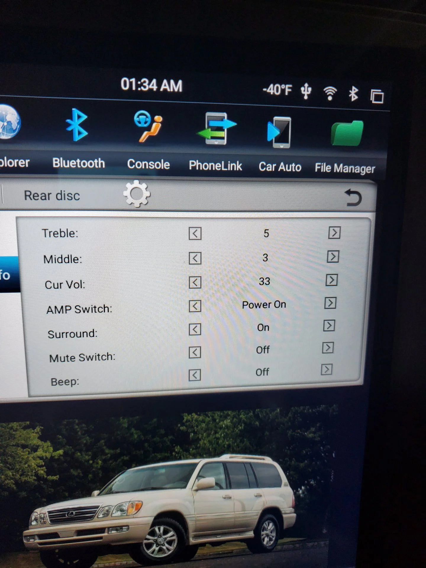

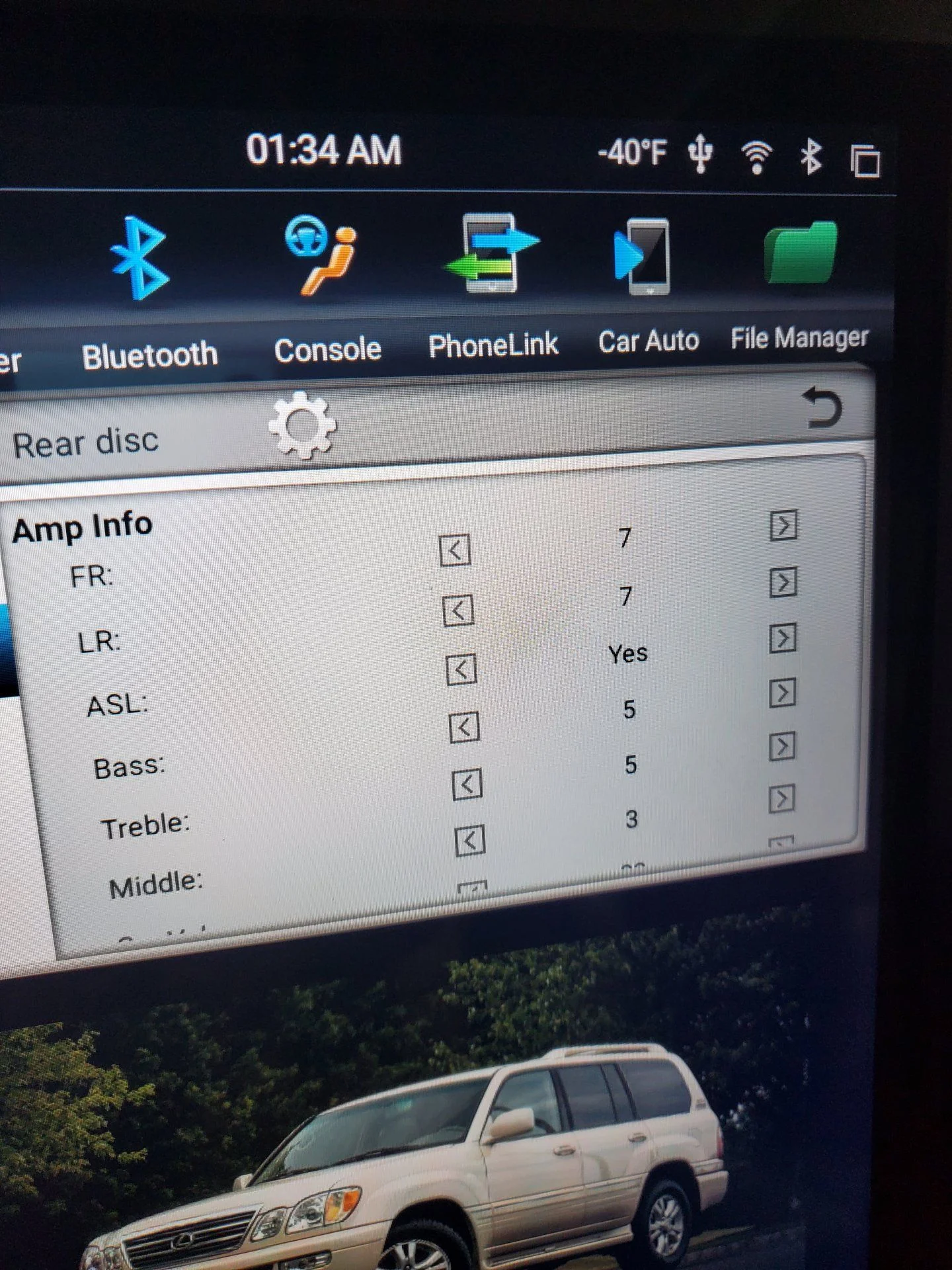

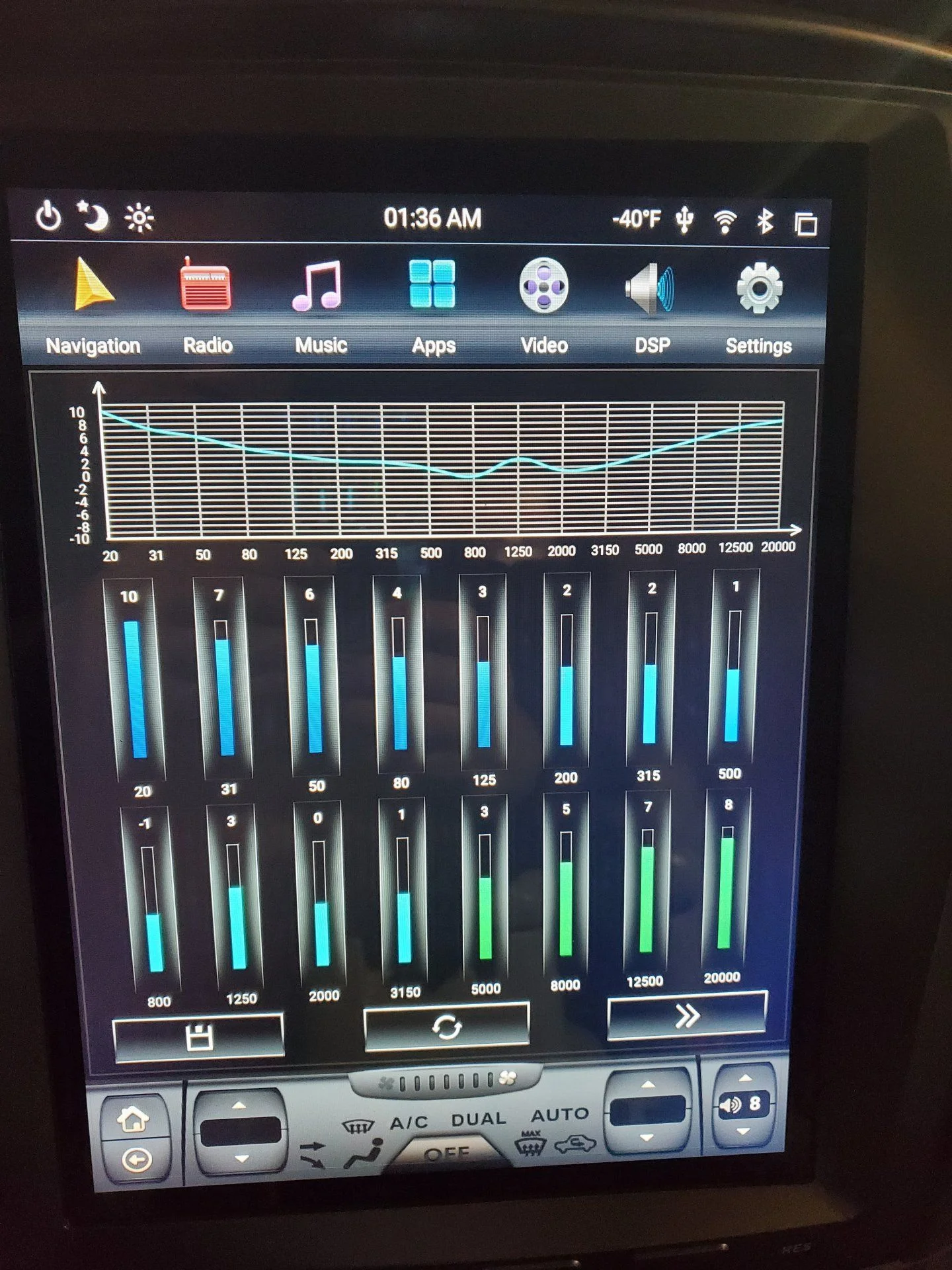

Would you be able to share those audio settings? At higher volumes mine sounds distorted
@CBeckFJ
Please take note that the numbers are not on point. I just picked random levels as long as the curve was fine and sounded fine.
I switched all 4 speakers to an aftermarket and disconnected the broken factory subwoofer. All 4 speakers sounds fine even without the sub.

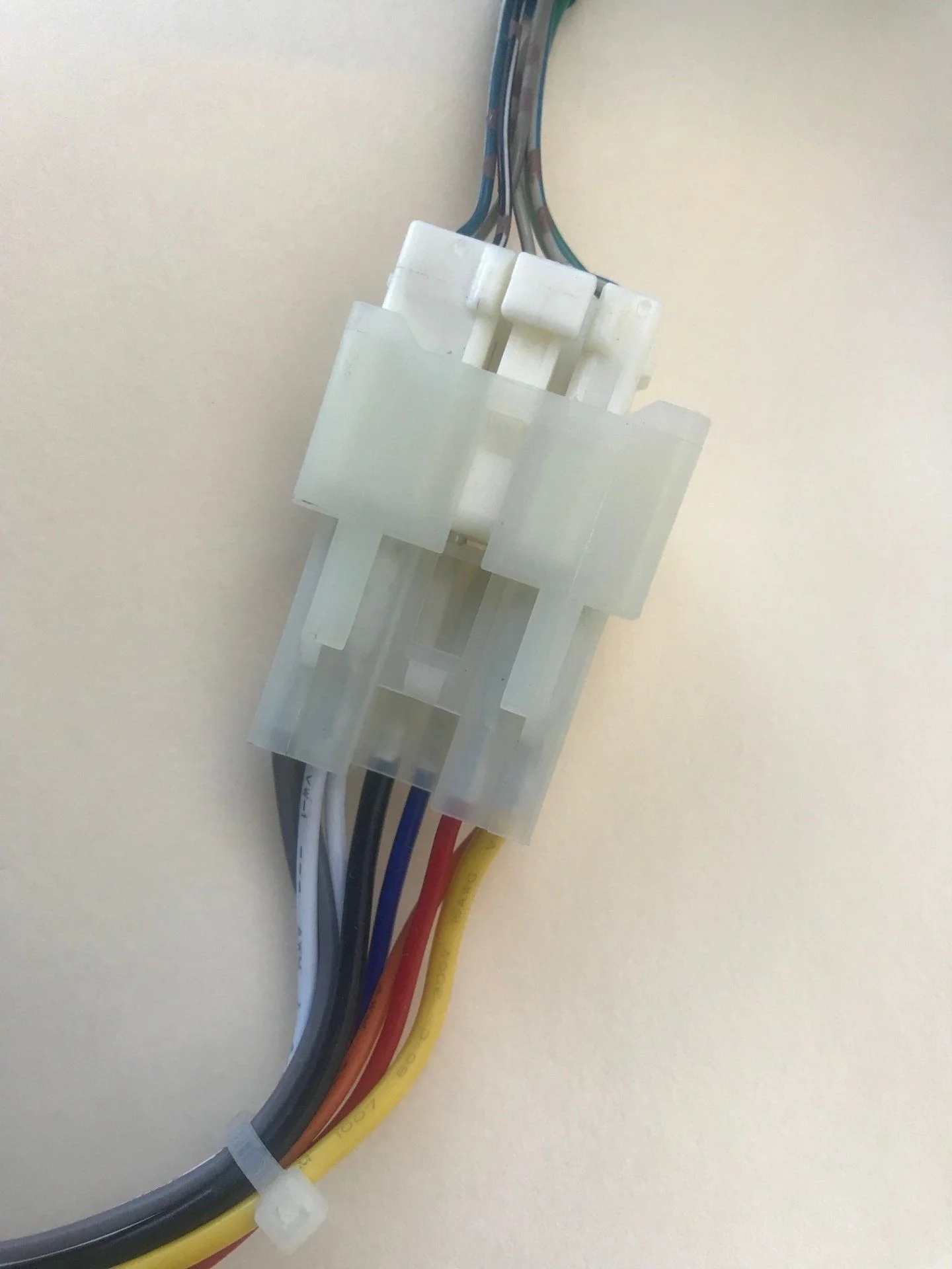

I just installed an aftermarket amp on my 03 LX with PX6. I removed the Nav ecu (At least I think thats what it is) and the ML amp under the Passenger seat.
Replaced it with a 5 channel amp.
Hooked up everything and I could not get sound from front driver. Did a little more research and saw @mistered123's post (Post # 49)
It was colored differently but same pins. After this, the front driver started receiving signal. Just FYI for anyone who might need to do this.

I installed a PX6 in my '06 UZJ100 over the weekend, this thread was very helpful. The two issues I ran into were with the amp not powering up and then the front DS speaker not working. Instead of completely bypassing the harness with the RCA audio inputs I was able to just tie in the amp power with a t-connector, my harness did not have the pink wire. I did have to splice the two speaker wires under the PS seat to make the DS front speaker work.

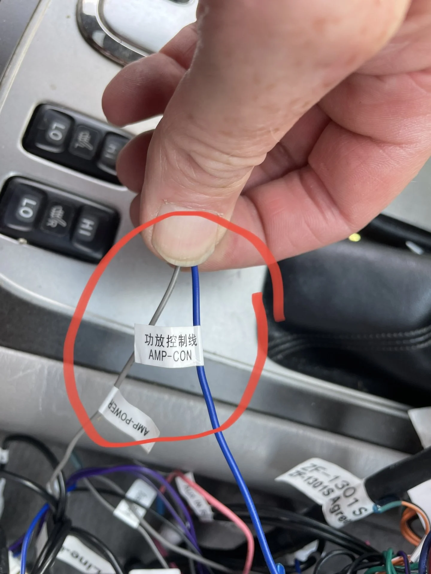

I installed my radio and seem to have the same issue with the amp not powering up. I get no sound at all, can you tell me what wires you used to power on the AMP? I have an 04, so the wiring should be pretty close.
See this post:
Tucker
I looked at the post and connected the wires (mine was blue instead of pink) blue to Grey and get a humming sound, no music. Volume control does nothing, just a constant hum. When I go to the console setting and look at the "AMP" line it shows powered off. I can change it to on, but it does nothing and reverts back to off when you close and open it back up. the radio App see channels and the antenna works like it should. I traced the wires based on the diagrams in the other post and all seem correct and the black with red stripe should be the switched 12V wire. The factory radio worked with no issues so It does not seem to be the AMP. I can plug the factory radio back in to verify the sound works.
maybe I am missing something.
