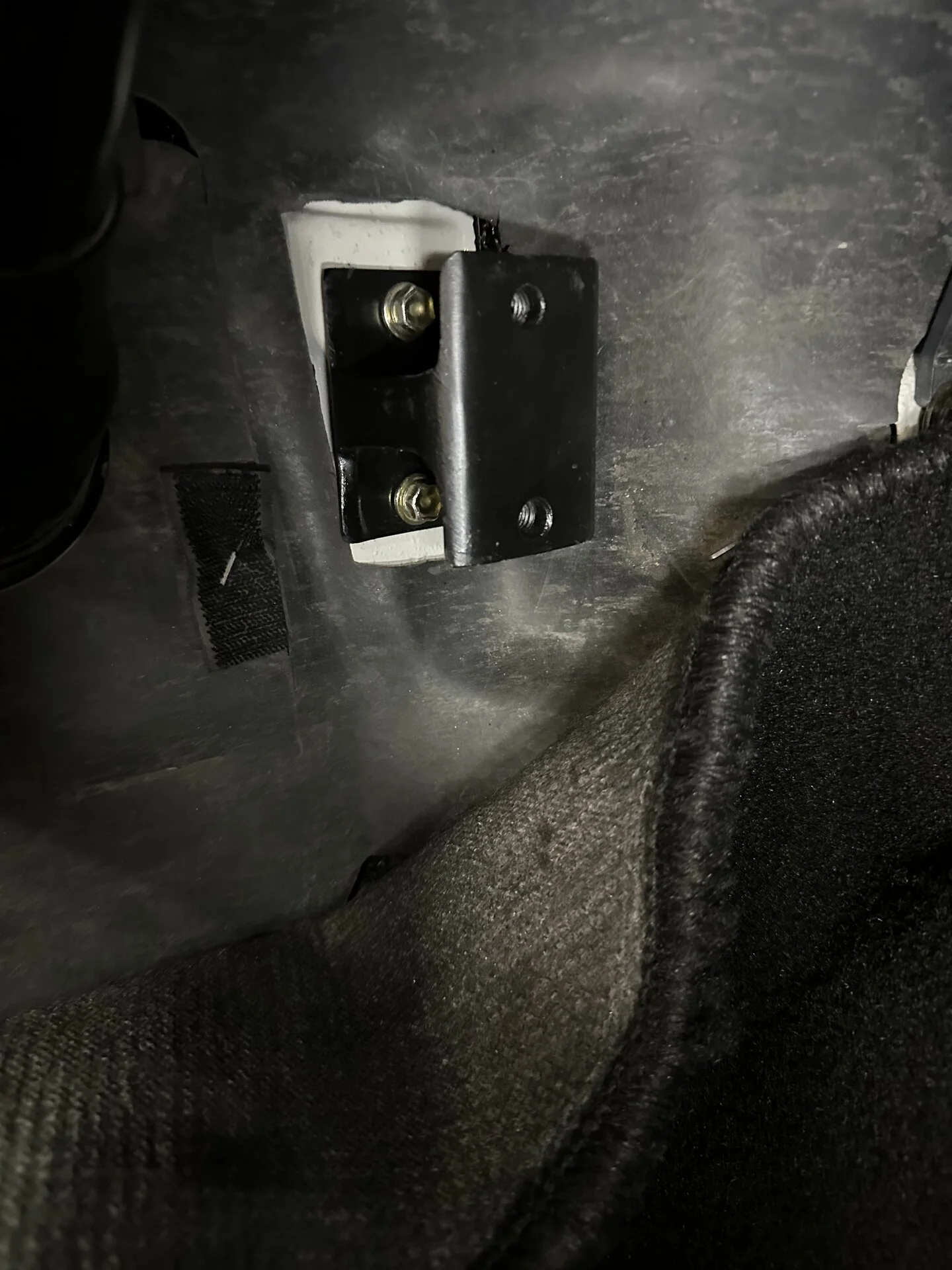

For some reason the pedal was way off almost glued to the floor this gave me luck this more no juice fab a small spacer

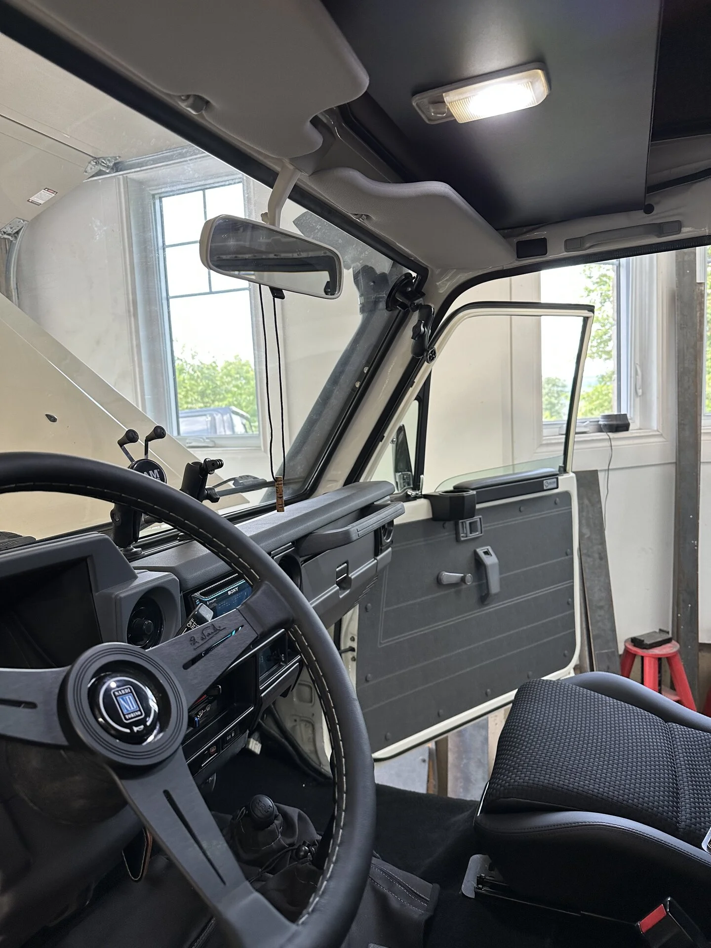

Still have no light but managed to get the dash and dome working the LED is very strong love it

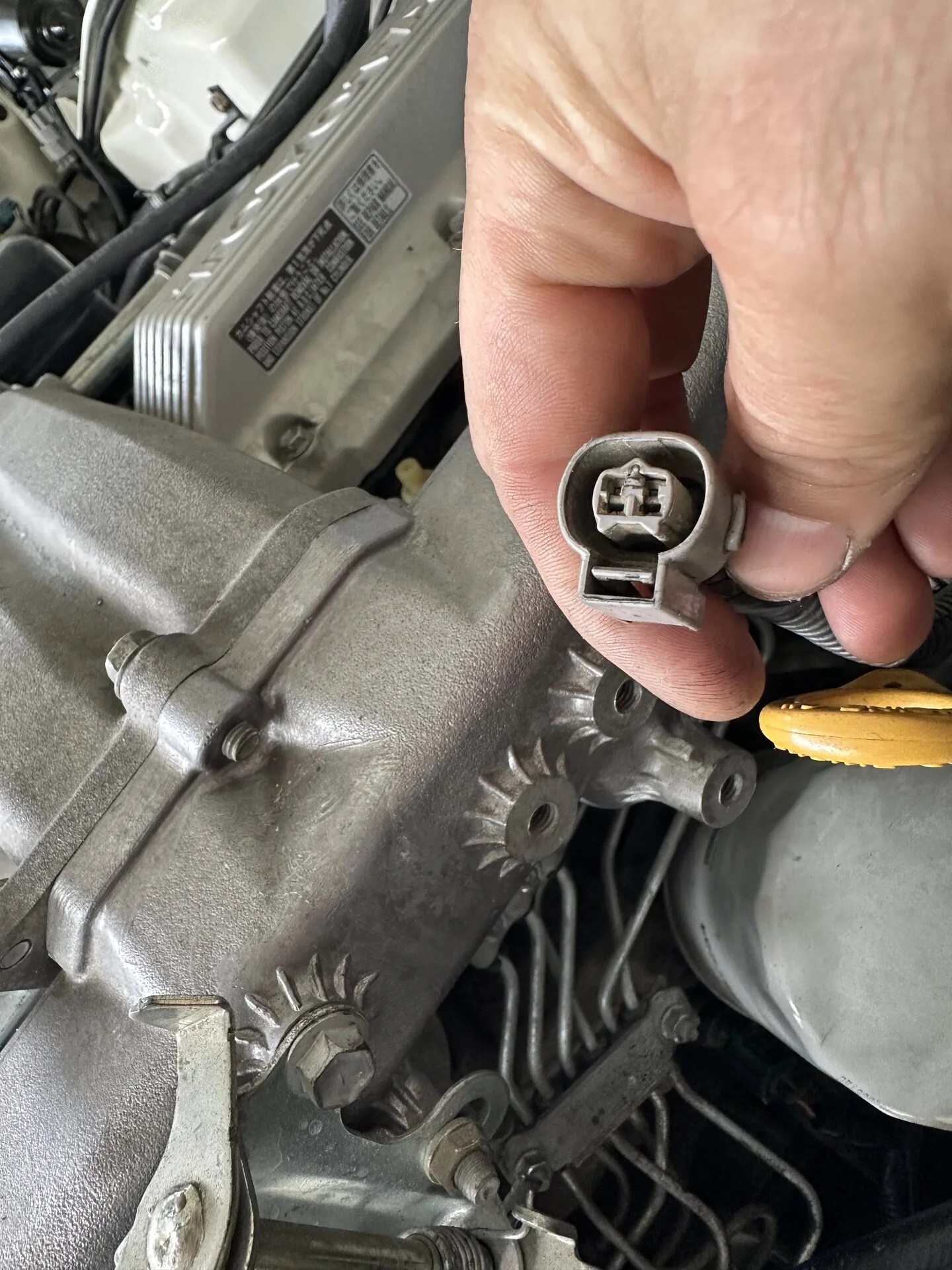

If anyone has a picture of the fusible link connector there’s 3 plug along one black and one blue I searching if any of these connector would be related

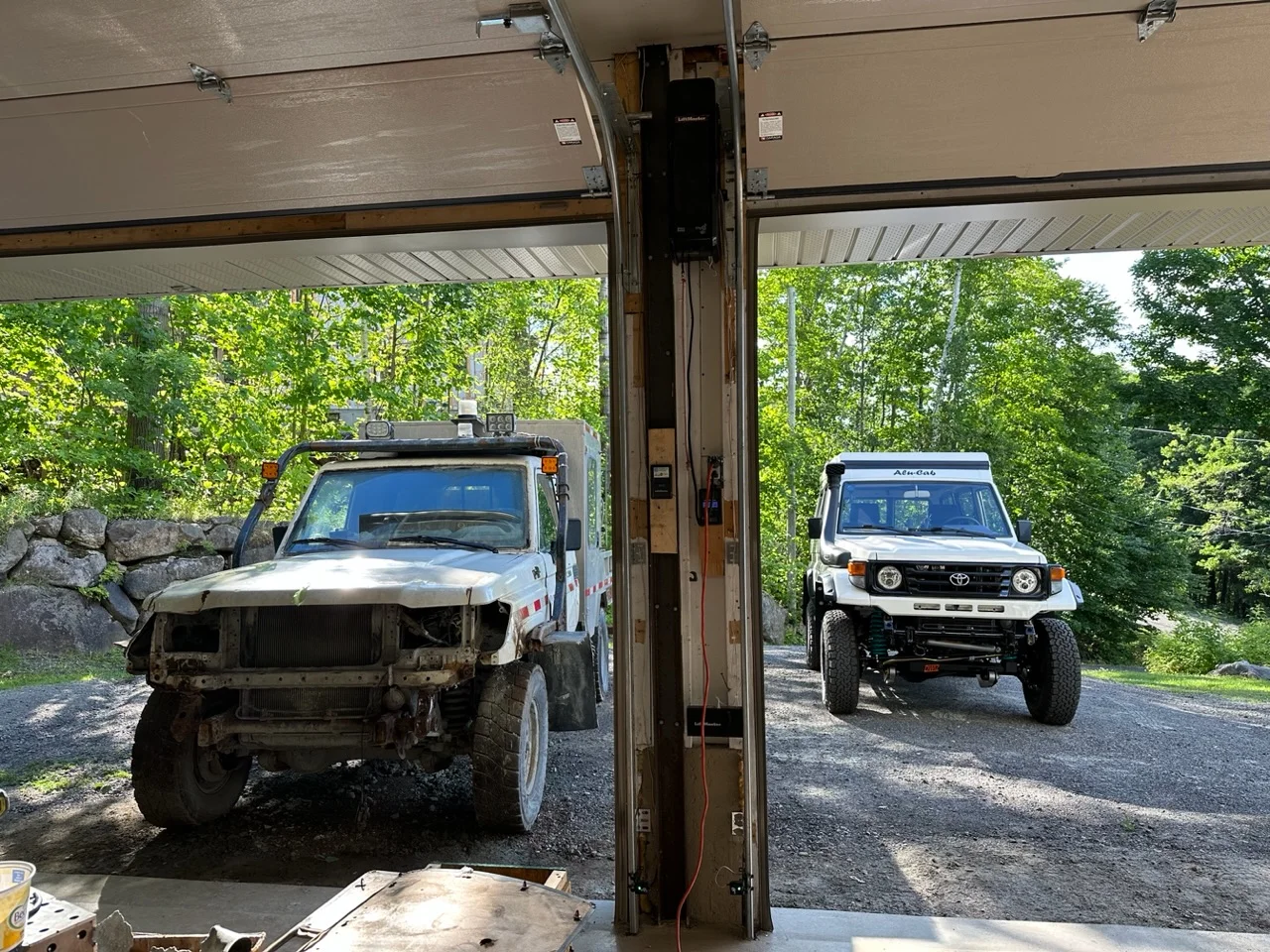

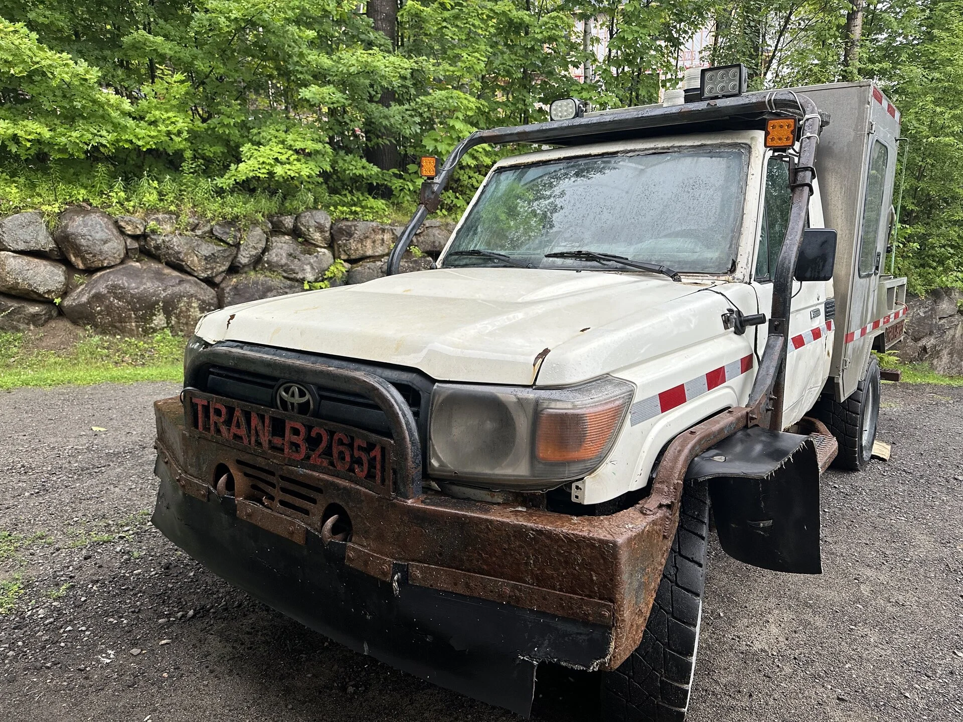

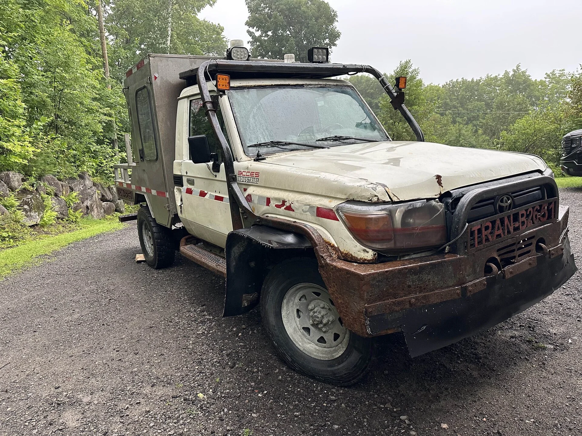

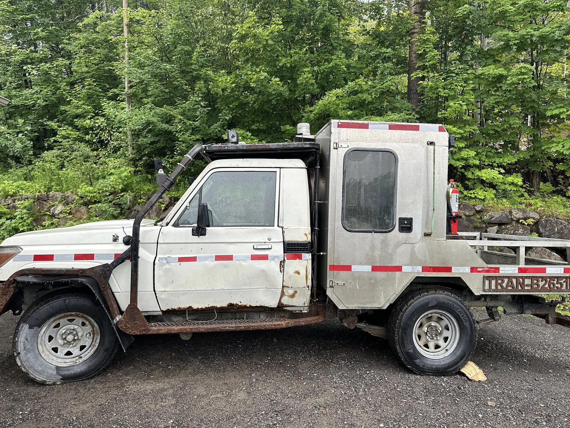

Found a donor truck for my engine project this way I will not stop using my rig for another. 32 months! I will check if the frame has damaged rust or only the surface since this is a mine truck! Good Hydraulic hand brake to salvage and heater blower in the cabinet
Today I managed to get pulling out some parts after spending probably 3/4 of the day cutting the front bumper 🤦🏻‍♂️
Millage is 110000km
Millage is 110000km

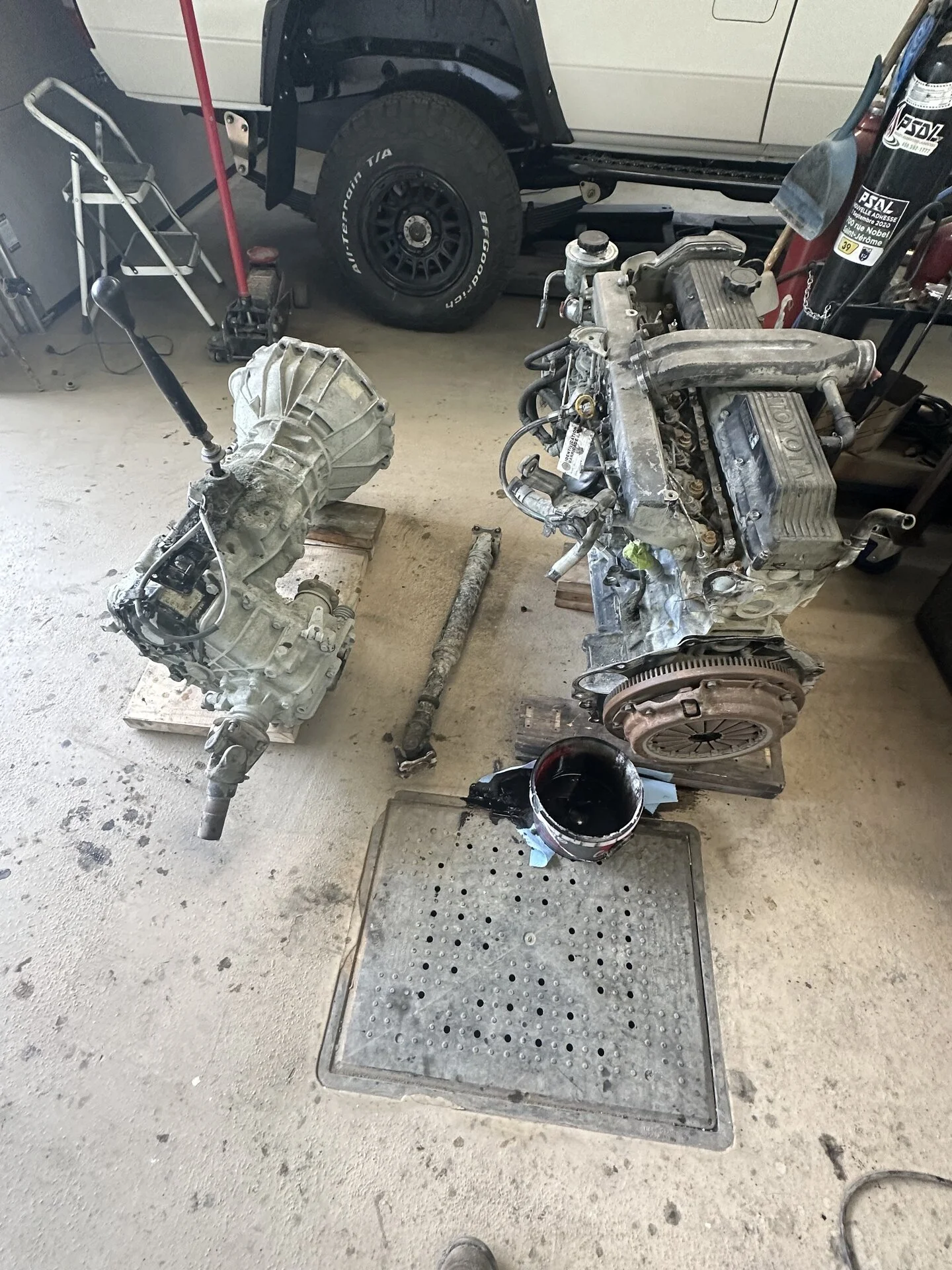

What’s the engine look like?

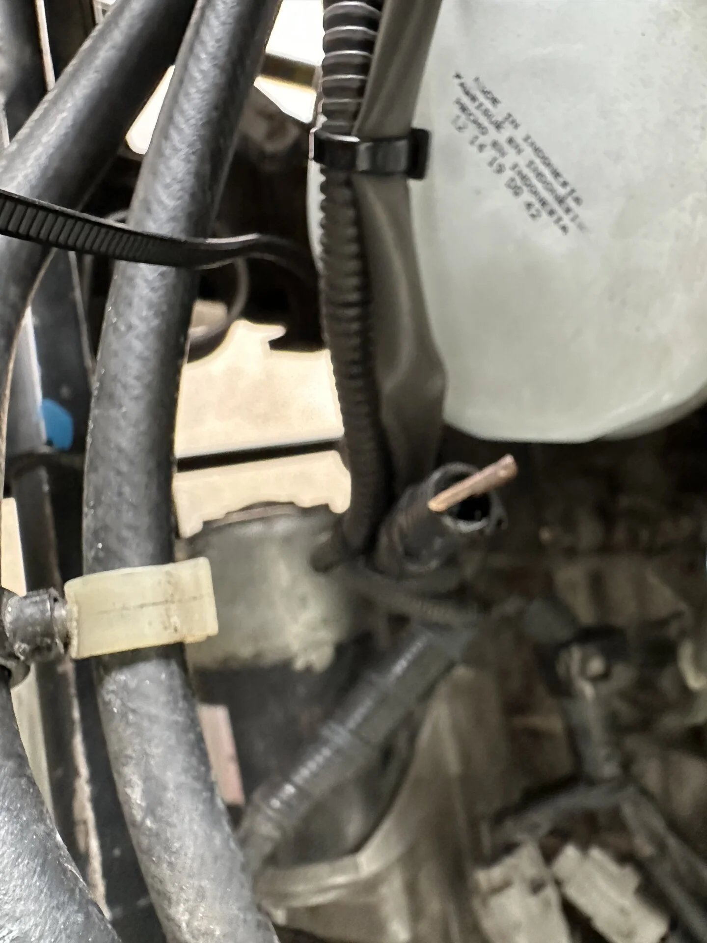

Wiper motor
Back liquid washer

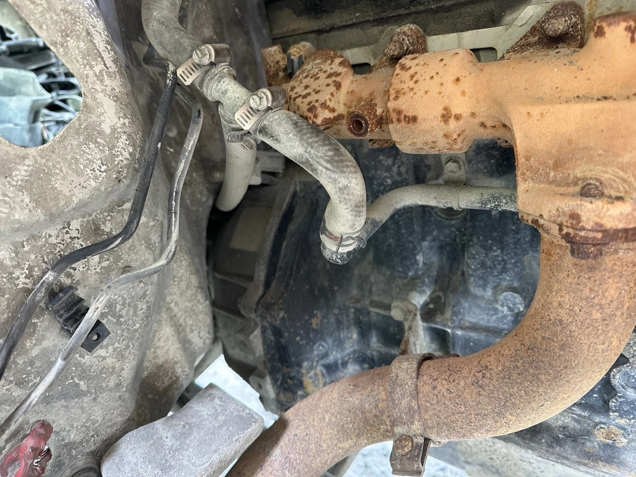

While salvaging the HZJ79 i found a coolant heater in the cabin the hook up goes like this coolant In coolant out here’s the connection

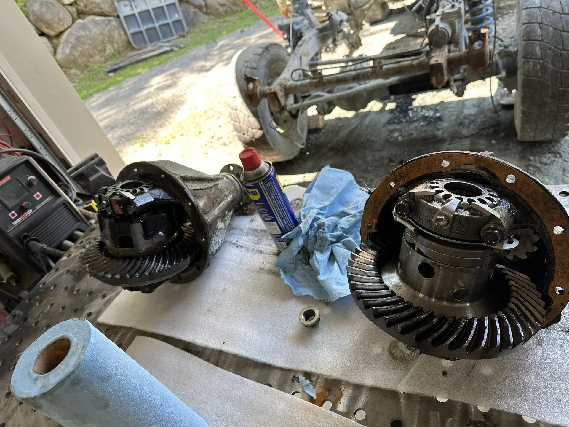

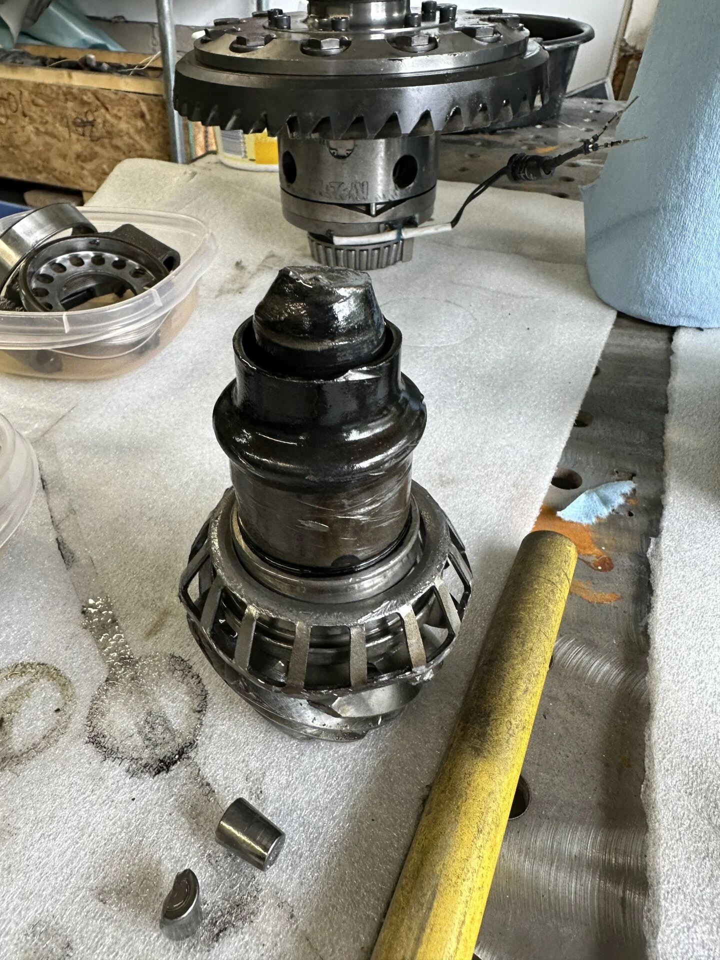

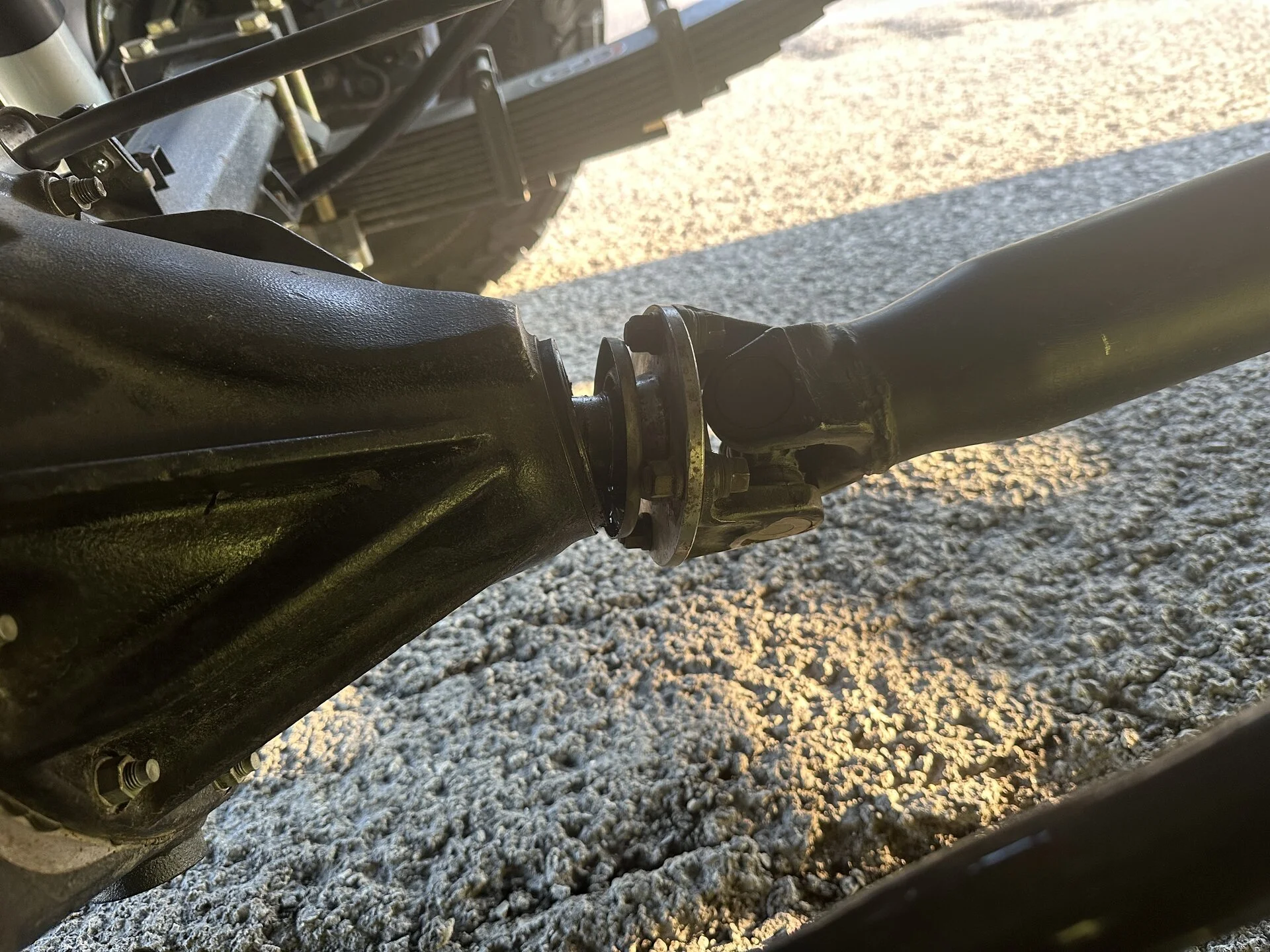

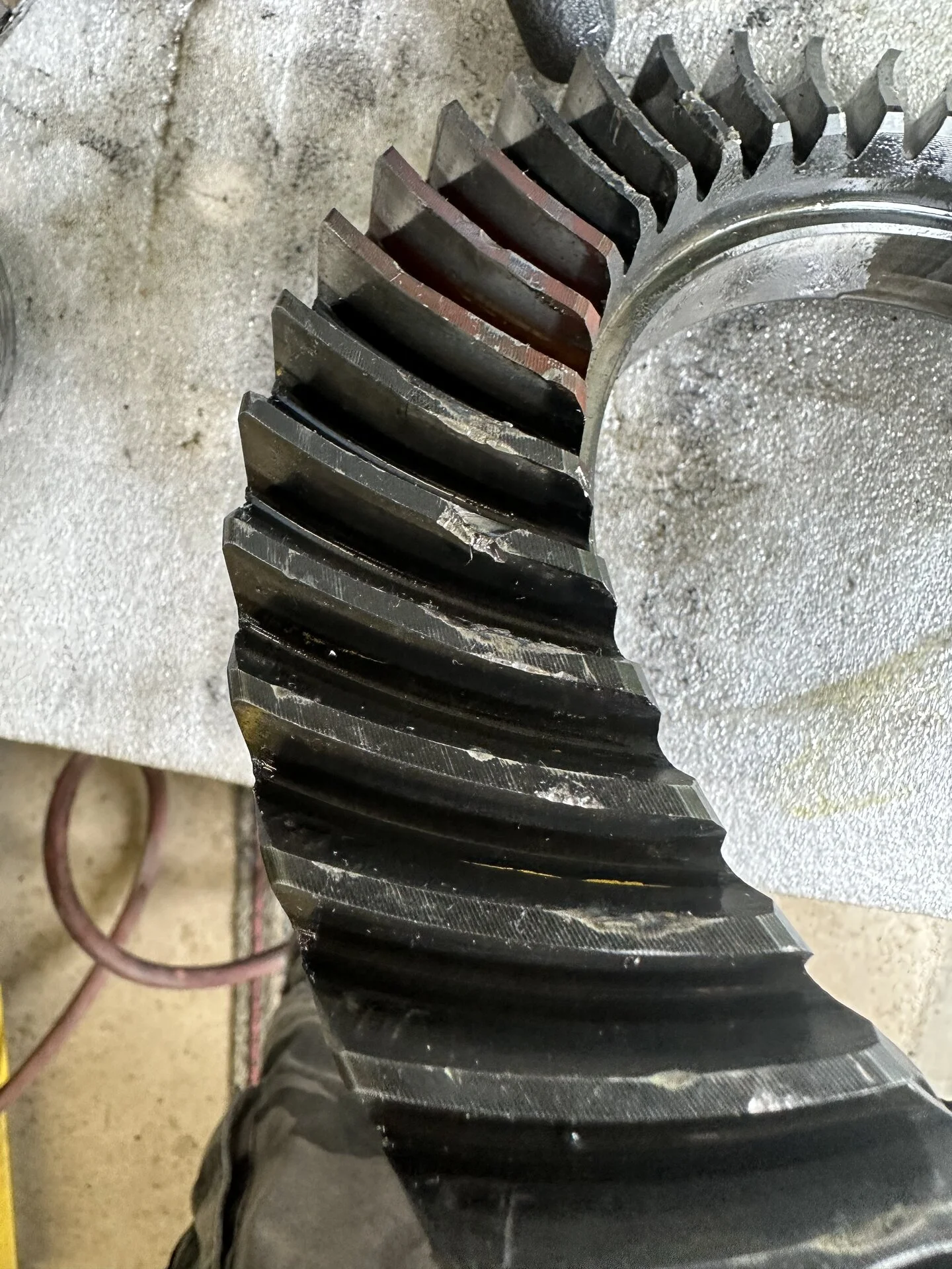

Bad week-end after doing a longer test drive ended up snapping the pignon and damaging the crown ring of the center diff after examining we had not installed the crush sleeve 🤦🏻‍♂️
Learn and live
I will be using the HzJ79 ring and pinion to reassemble I am hopeful the front is not damaged too but will have to rebuild as well
Ordered new kit for both …
Took the crown ring out with no problem 😉 comparing to the last time with see how that goes withe the doner oil bearing are fine but the other are dead 💀

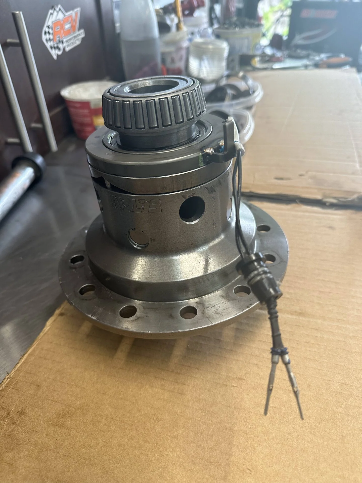

For those who want to rebuild the third member here's what I am using this way around
FSM RM0584E
Complete removal and installation from @OTRAMM I wish this guy would make more videos this is so well explained
FSM RM0584E
