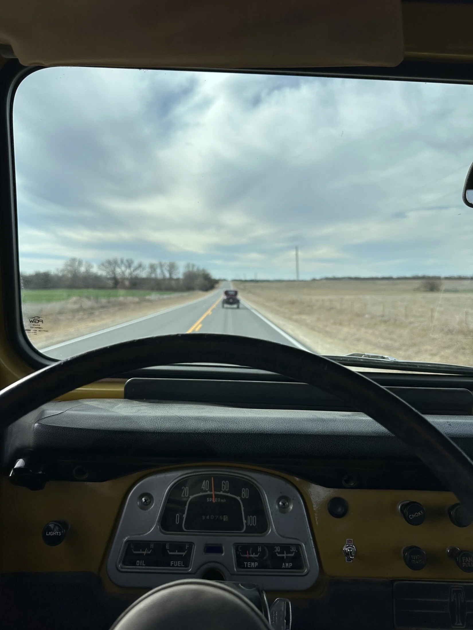

Trip meter = 0

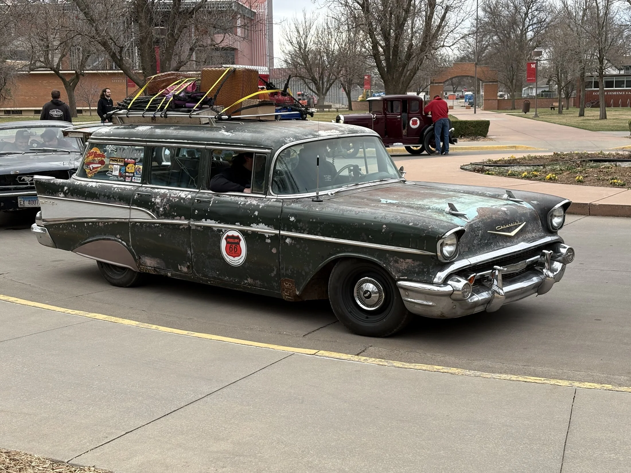

(didnt realize the Ghost Busters were going on the trip as well…. what a cool car!)
