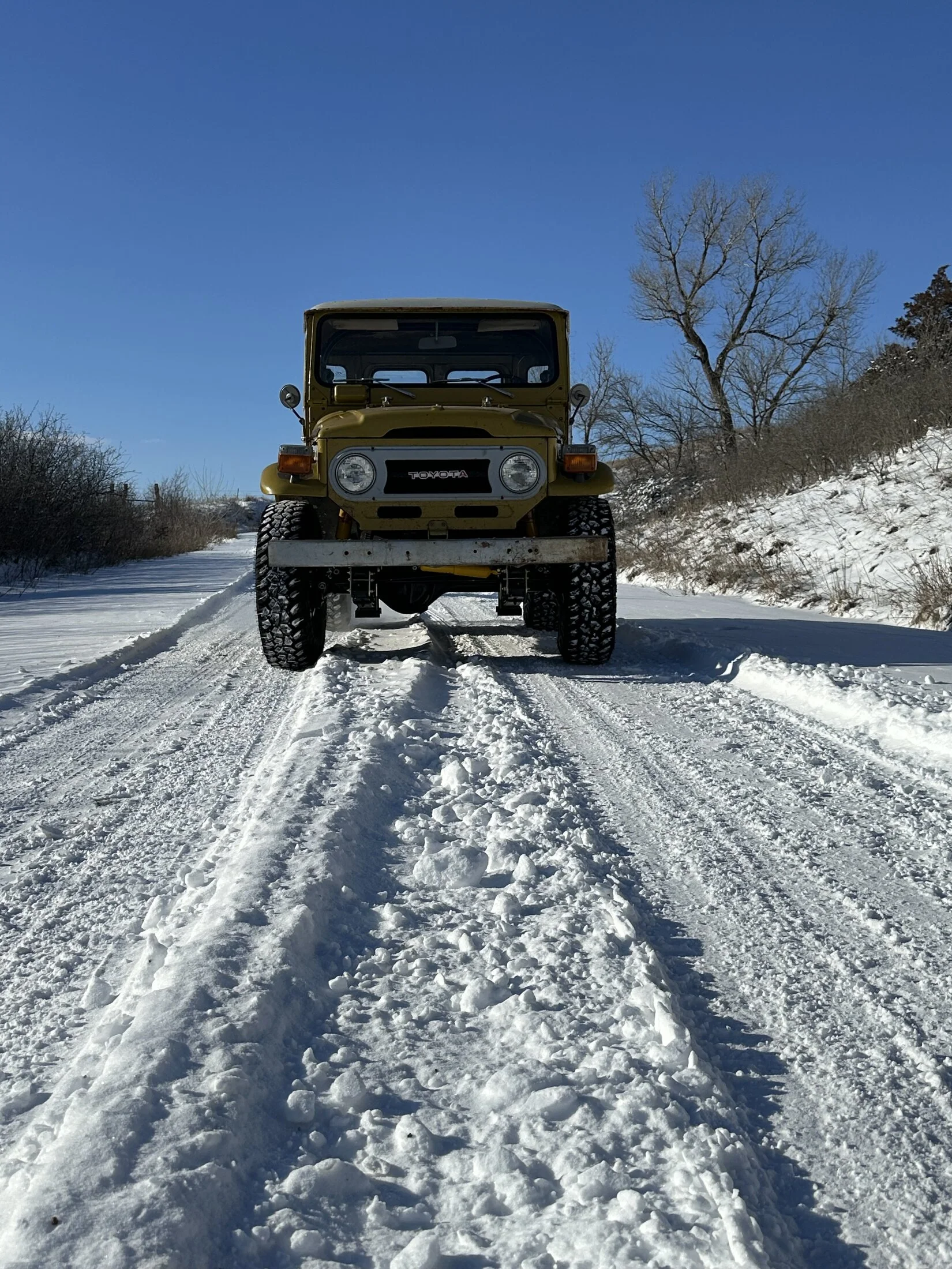

I got to try out my new suspension in the snow today. So far I have put about 70 miles on it, the caster correction shims helped out tremendously drives straight and doesn’t wander anymore.

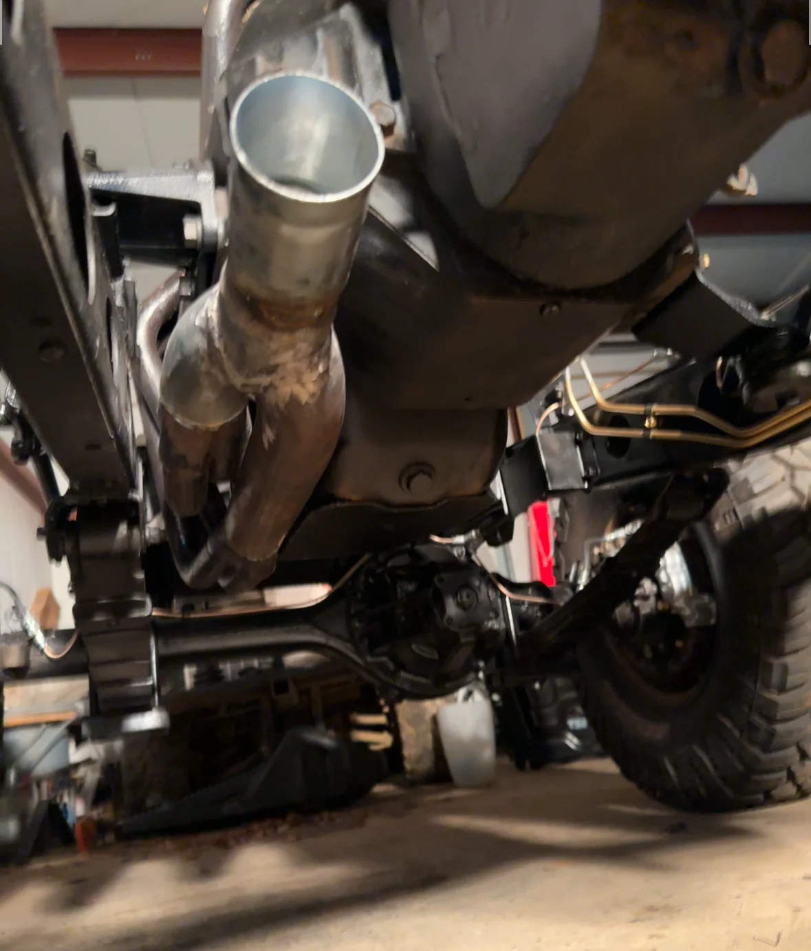

Built custom Y pipe, repaired old headers, and cut and routed 2.5 in stainless exhaust.View attachment 3810128View attachment 3810132

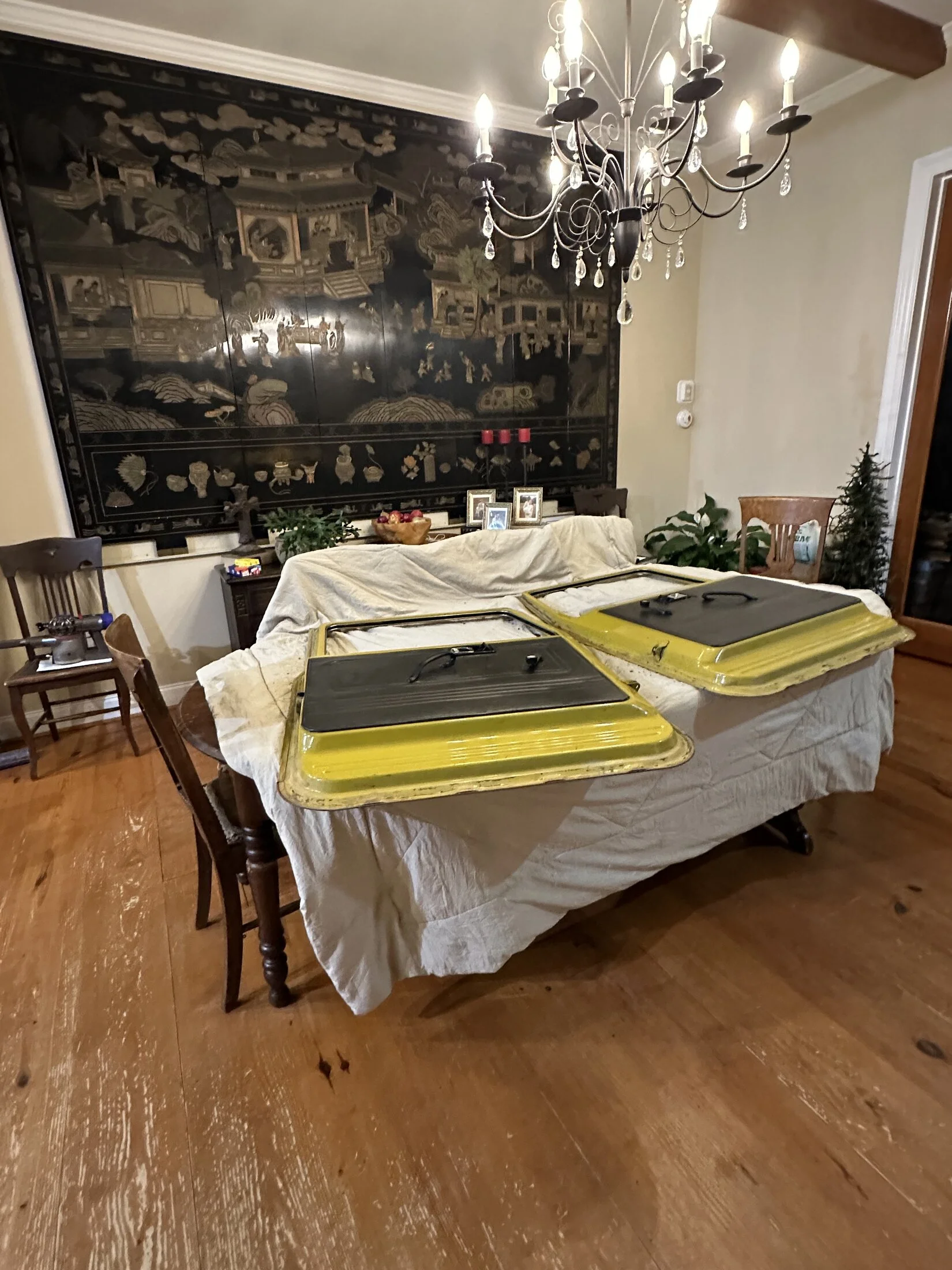

Removed old weatherstripping from doors. (Thanks mom for letting me use the dining table) I plan to POR15 around the edge of doors and re install new weatherstripping.View attachment 3810131
Mrs. Candace is a good Momma to let you use her dining room table.
