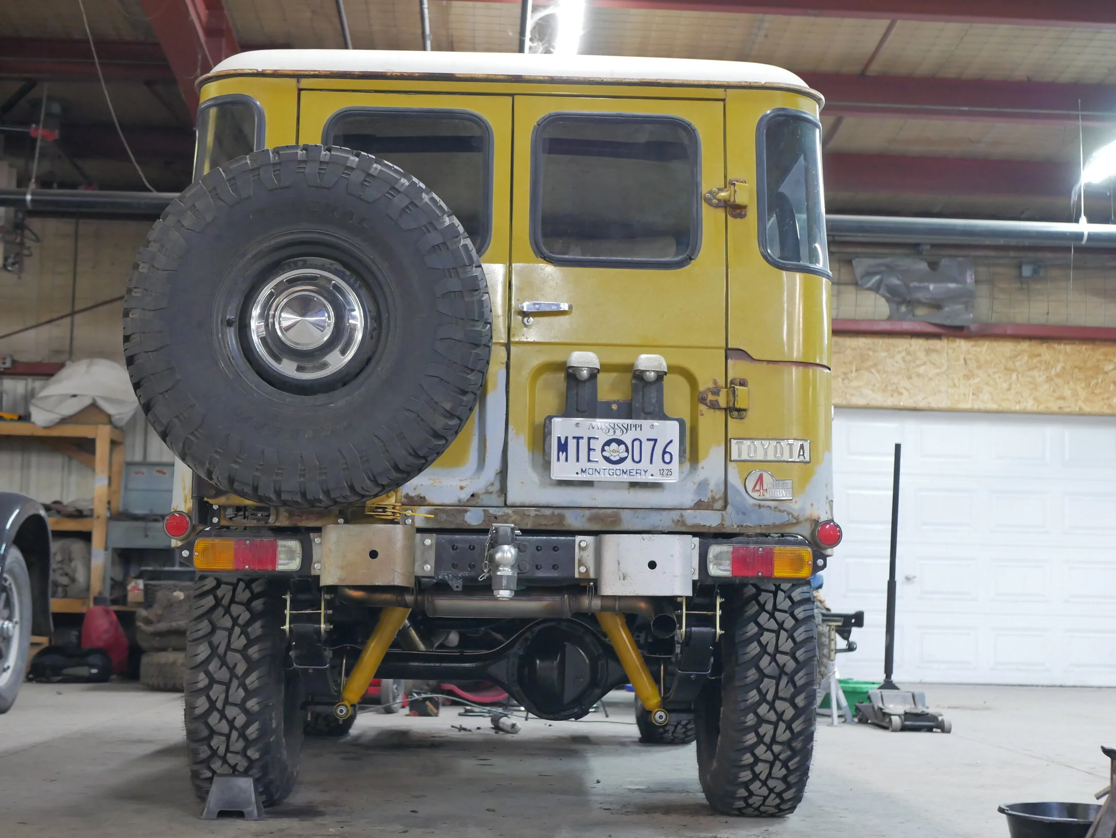

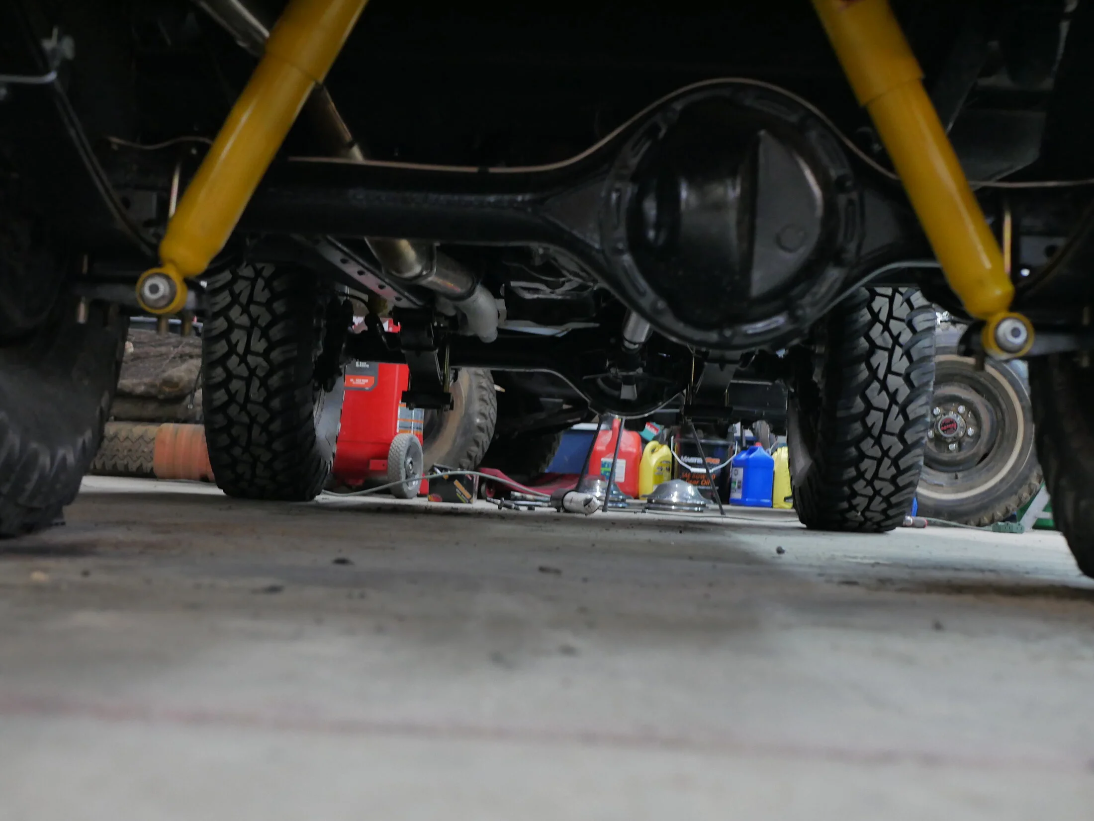

Lift is on and it looks amazing. Now going to rebuild knuckles and steering while it’s still freezing out. Will add a link to the YouTube video when it’s out and do a write up on the terrain tamer suspension after I put a few miles on it. Thanks @Flatlanderfj40 and Kansasland Tire for the lift!

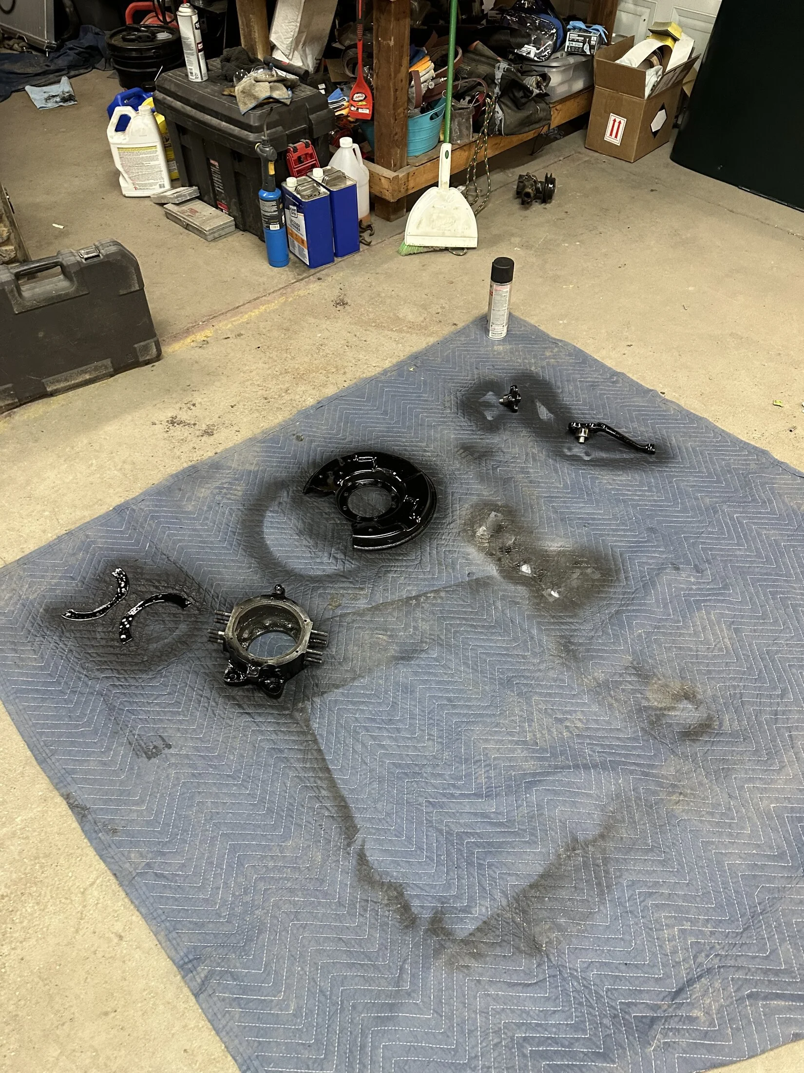

Super cool I love Clarksdale! Not yet I didn’t want to take it out when it was -10 so I started on my knuckle and steering linkage rebuild. Goal is to be all done by Monday.

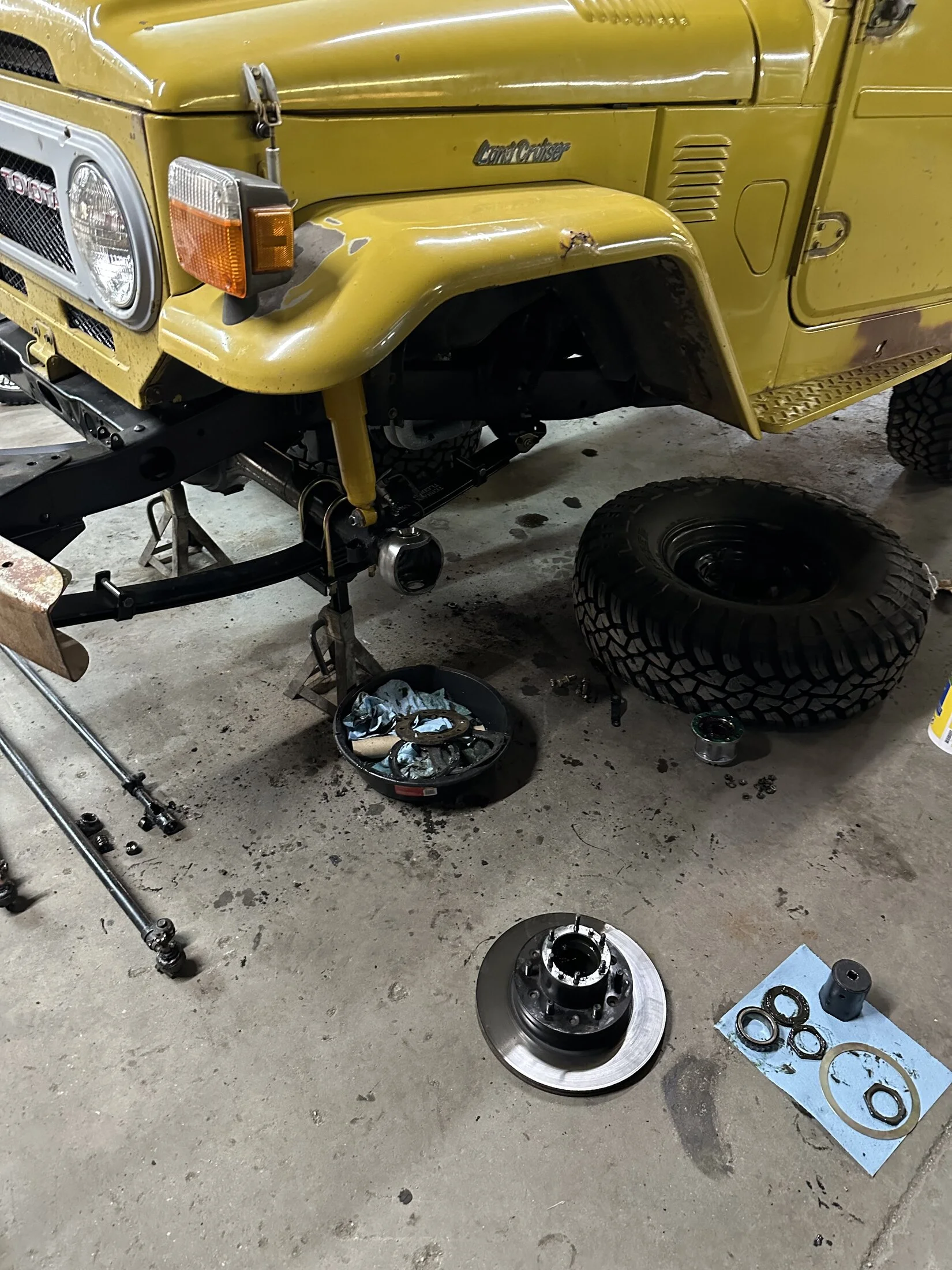

I started on the knuckle rebuild today, I love cleaning out old grease. Thankfully the axle and everything seem to be in great shape still. I went to put it back together and realized the kit that came with the fj didn’t have inner axle seals…thankfully autozone can have them tomorrow.

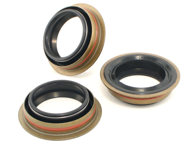

if you really want them to last, I highly recommend using the Marlin Crawler inner seals… much more heavy duty…. I can get you grease next week as well if you need it.
Thanks for the info, I think I’m going to stick with the original style seal for now so I can get it back together and move on to other projects.
