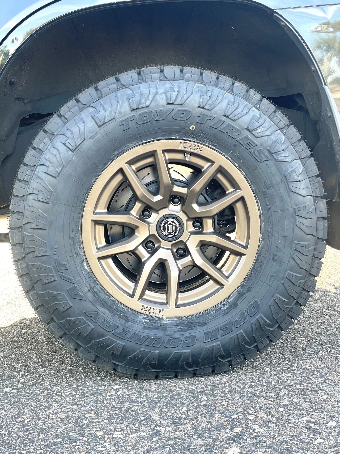

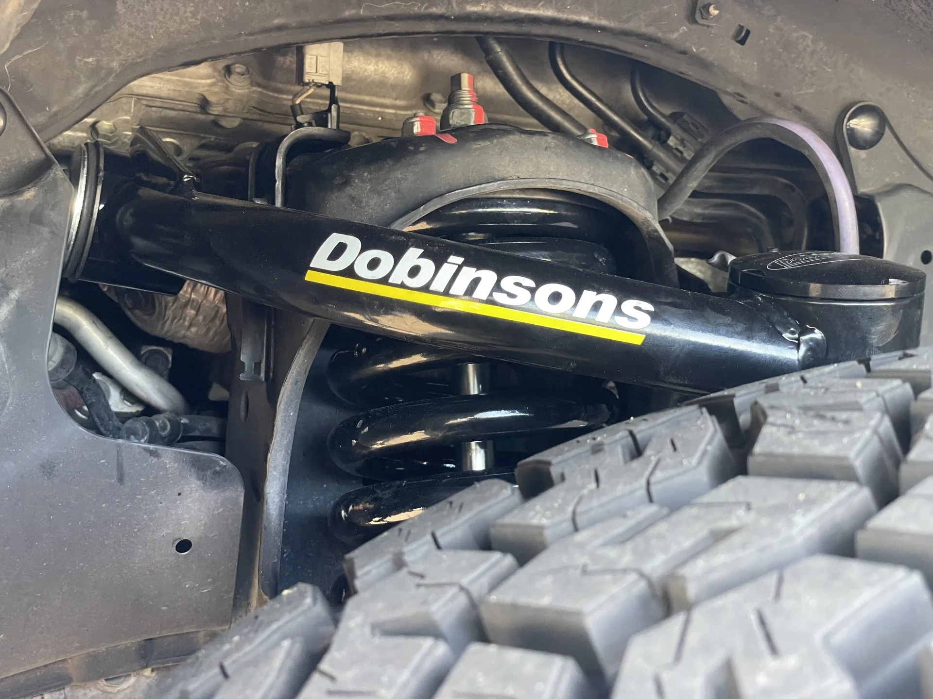

Hey all, recently purchased a 2011 200 Series to go alongside my 80 and am going to be getting some work done to it next week.
I am going to be installing a Dobinson IMS front & rear 2.0-2.5" suspension lift (with UCAs) and throwing on some 285/75/r17 wheels on a set of Icon Vector 5s in the 17" / +25mm offset flavor. This is my first modification to date on this vehicle and aside from eventually getting sliders & Dissent front bumper sometime in the future, this is all I have planned as the 80 is already fully built and my primary wheeling vehicle.
I know that the 285/75s typically rub in a few places, but is anyone running a similar set up and can offer their experience with this? I'm fine with removing mud flaps, playing with the plastic under the wheel wells, and even some minor rubbing at full lock... But as I've researched deeper it seems that I'm hearing reports of their being more than ideal rubbing on the body under normal driving conditions as the body shifts. Can anyone corroborate this one way or the other? If it's going to be too much of a hassle, I'd like to just return the 285/75s and go with the tried and true 285/70s.
Thanks in advance!

With the 25mm offset the lt285/75r17 will fit without much issue especially with an aftermarket bumper like the Dissent. I have tested both lt285/70r18 and lt285/75r17 on my 2013 LC and both fit easily with the mud flaps removed on 25mm offset wheels and a decent alignemnt.
Both these sizes measure out to approx 34" and easily cleared the KDSS at full steering lock and didn't rub during some moderate to hard trail runs. There is some variance in the manufactures actual measured sizes. Example, the KM3 in LT285/75r17 is listed as 33.7" while others can run slightly larger then 34" as with the Yoko MT G003 which is 34.1".
My biggest regret was not going to a 34" sooner. With that said I use 33" ATs for daily driving and winter use and swap to 34" MTs for trails. There is a Noticeable weight difference/penalty that can be felt between a 52 lbs 33" AT tire and a 63 lbs 34" MT.
If i were in your shoes with a dedicated trail rig/wheeler like with the 80 I would keep the 200 as civilized as possible with either lt275/70r18 or lt285/70r17.

Thats good to hear, one of the main reasons I went with the Icons was for the +25mm offset (and the looks of course). I got myself a set of the Toyo AT3's which are measured at 33.9" so close to a true 34". I got them in load range C rather than E to try and combat the weight a little bit.
The 80 is my primary for the trails but part of the reason I got the 200 was so that I had something a little bit more comfortable for a daily driver (mpg be damned) but was also capable for some of the more long distance trips I like to go on with moderate trails in between. And including modern safety features. I love my '93 to death and it wont be fully replaced as a my main trail vehicle but I do hope to get something much more comfortable and reliable for the bigger 2-3,000 mile trips I take a few times a year with the 200. The 80 always gets me home, but sometimes it's more dramatic than I'd like.
285/70s would definitely be more practical and I'm not dedicated to keeping the 285/75s on if I don't like how it feels on the road, but just for fun, I'd like to give them a go as long as they don't rub to the point of doing more harm than good for the sake of .5" ride height.
Thank you for your input, I really appreciate it!

All my worrying was for not, the 200 came out looking absolutely fantastic in my opinion after adding the Dobinson IMS 2.0-2.5" Suspension Lift, Icon Vector 5's, & 285/75/r17 Toyo AT3s
