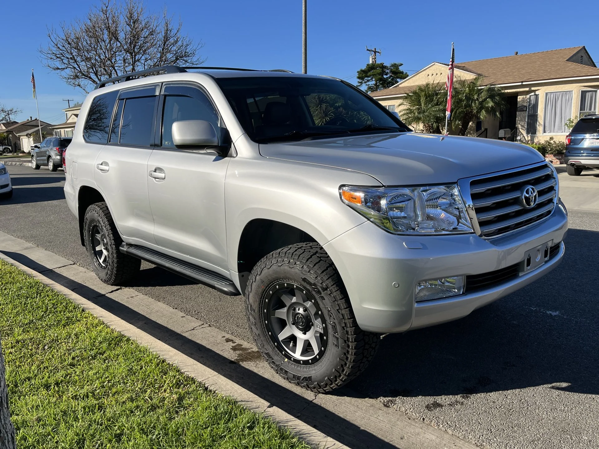

My new, used, ride got some new shoes and rims. The set up before was less than ideal on 18" TRD Pro rims with a 60mm offset and no spacers running 275/70/18. With an existing OME lift it looked quite dorky. Luckily the tires were done so I could pick my own.
Went with Icon Rebound (25mm offset) in 17's (1817855557BR) as I like the more tire look. I am partial to Toyo's and went with their R/T's in 285/75/17. Glad I did a ton of research on this forum and this thread regarding sizing as they provide plenty of lift and fit the wheel well perfectly. Zero rub with the Dissent front bumper; just had to remove the front mud flaps. The road noise is roughly the same as the prior tire; minimal. FWIW the full size spare does fit underneath in the allocated space.
How she sits now until the next mod comes about:

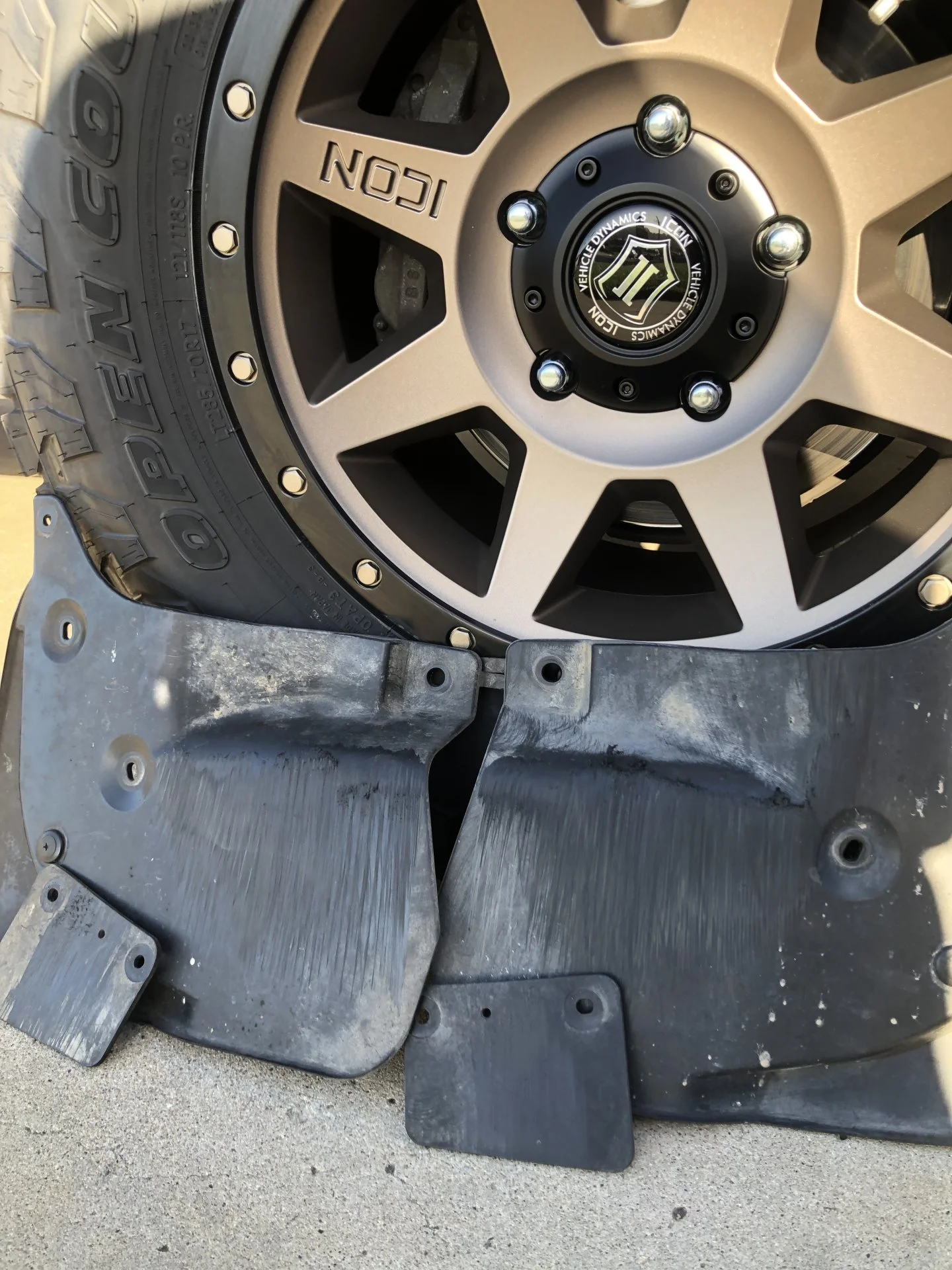

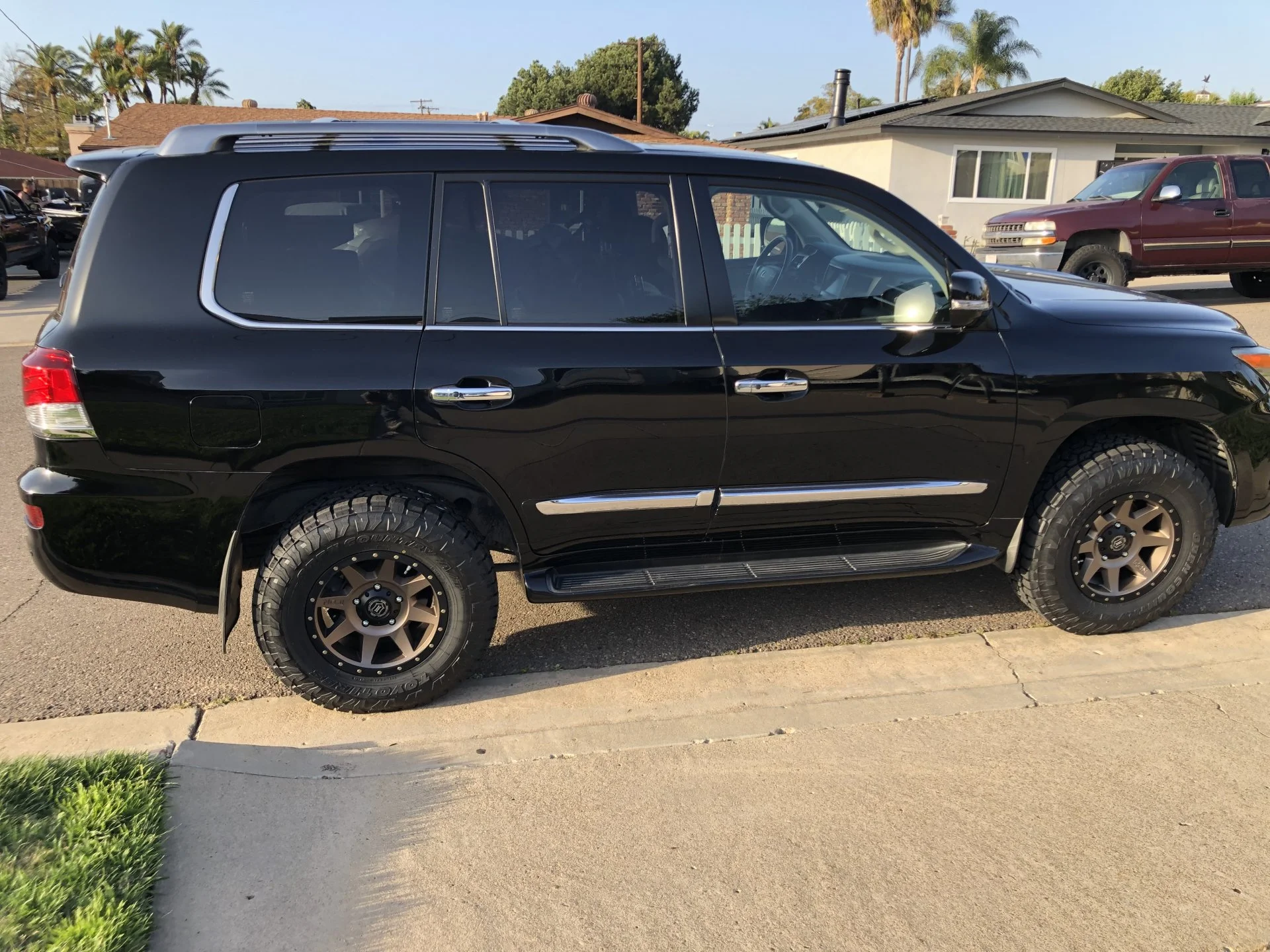

Looking good. Just put my bronze Icon Rebounds (+25) wrapped in 285/70/17 Toyo Open Country A/T IIIs. 2013 LX stock AHC height.

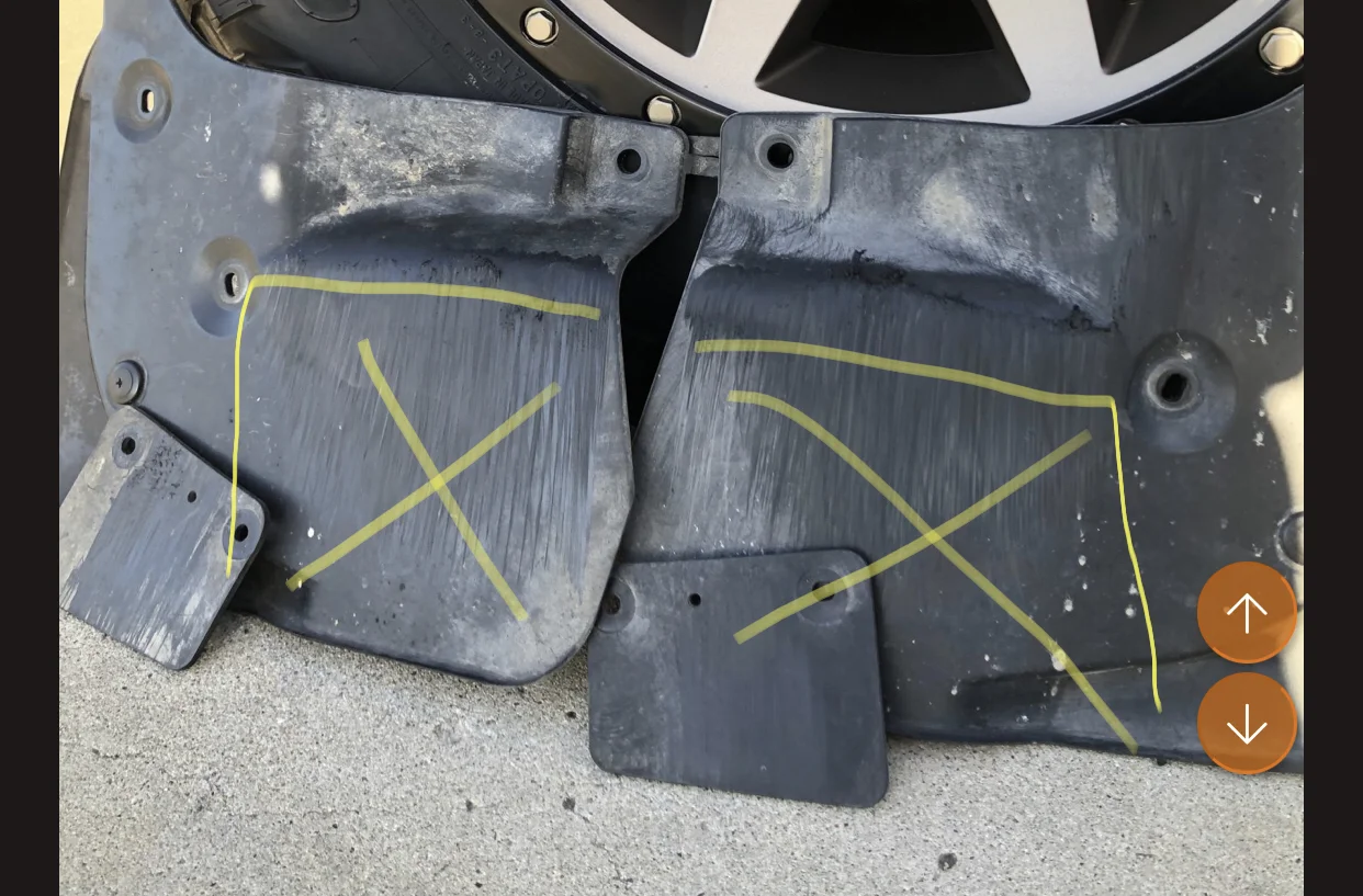

Had to remove the f/f and f/r mudflats to get rid of the rubbing.
Question for the crew, do the f/f mud flap screws hood anything else in or can they be left off?
Mud flap screws are ok to leave out, they don’t support anything else but it’s always a good idea to fill any open holes to prevent rust. I’d say just screw in the existing hardware to fill the holes. I ultimately ended up chopping up the mud flaps to remove the portion that was hitting the tires.

I reinstalled the screws on the back end as one did go into metal and the others appeared to hold the running boards and the fender plastic in place.
On the fronts, I’m going to be putting the rhino bumper on so that piece is going to be gone anyways at some point in the near future.

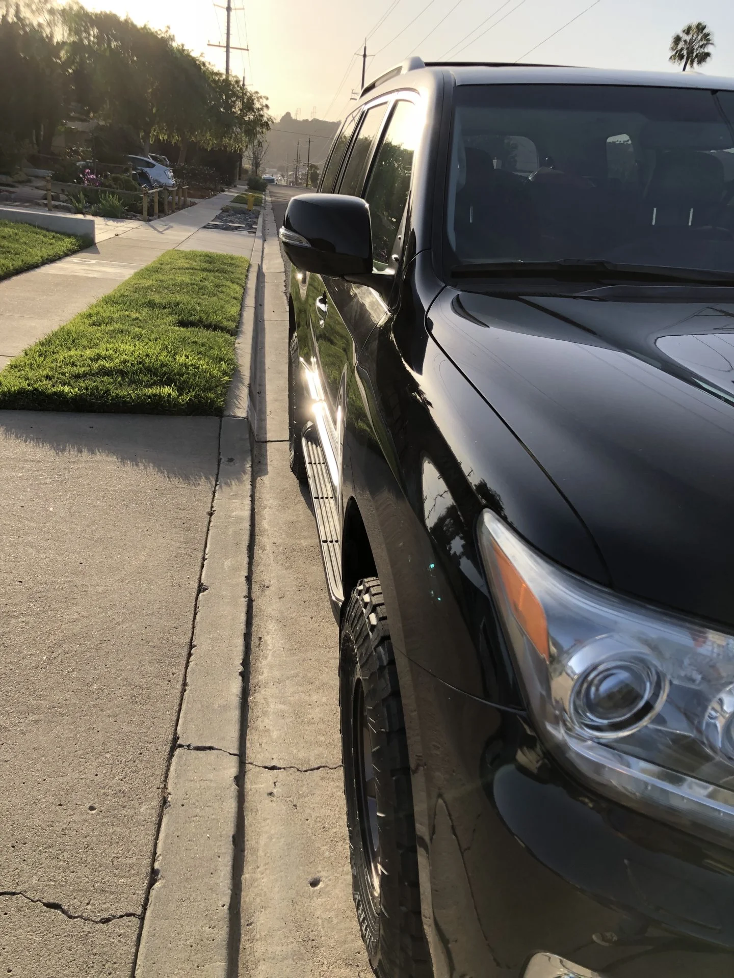

Took another mudders advice and played around with the different modes. Sport mode seems to be a good rebalance to stiffen it up a little to accommodate a little bit more roll. Absorbs the lovely San Diego potholes much better now even in sport.
Road noise is barely noticeable only if I’m driving with the radio off and windows up. Once there is any kind of ambient sound, it’s drowned out. I’ve also always had some form of AT on my rigs though so I might just be used to it. ‘99 taco ran the original bfgs for 14 years and our ‘14 4R has the 265/70/17 Toyo AT IIs on already. Liked their performance both on and off roars as well as in the snow so ran with them here too. Haven’t tested them out too heavily on the LX yet though, only 4 days and about 50 miles in on them. Need to torque the new lugs back down to ensure a proper seating before doing anything extended. Also still waiting on the spare as that one had a longer trip to get home.
