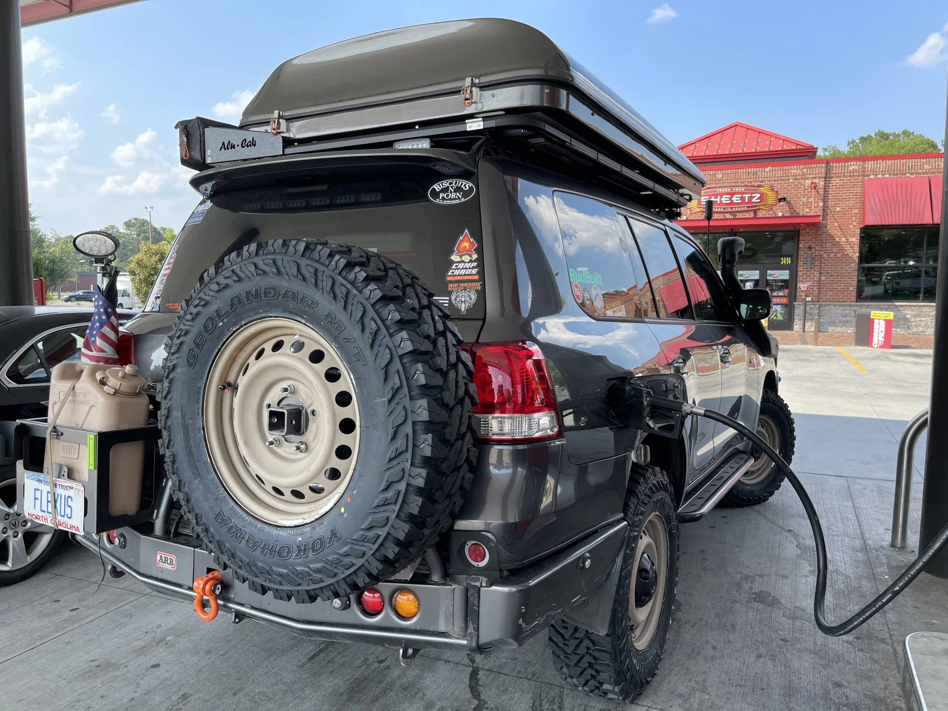

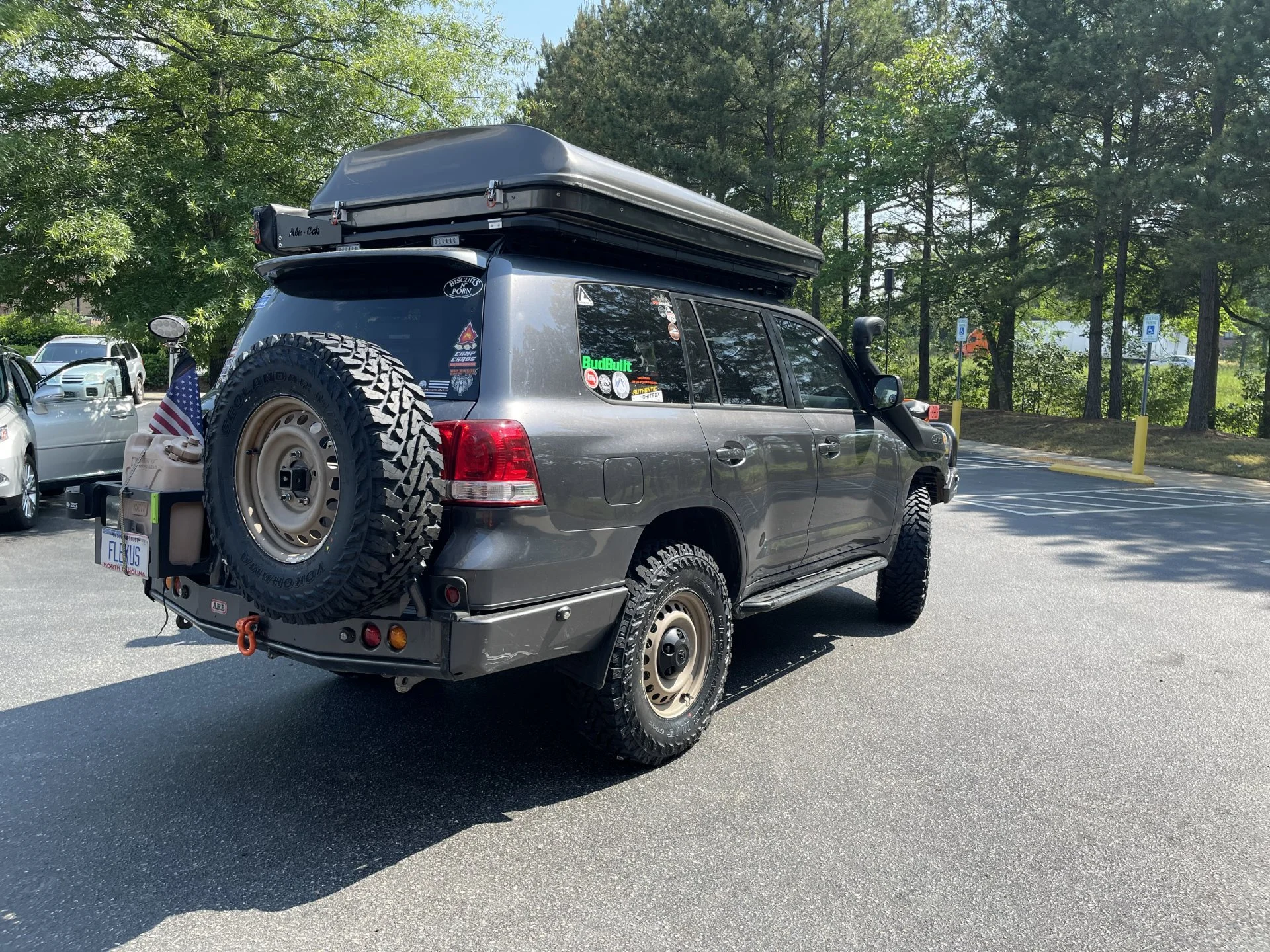

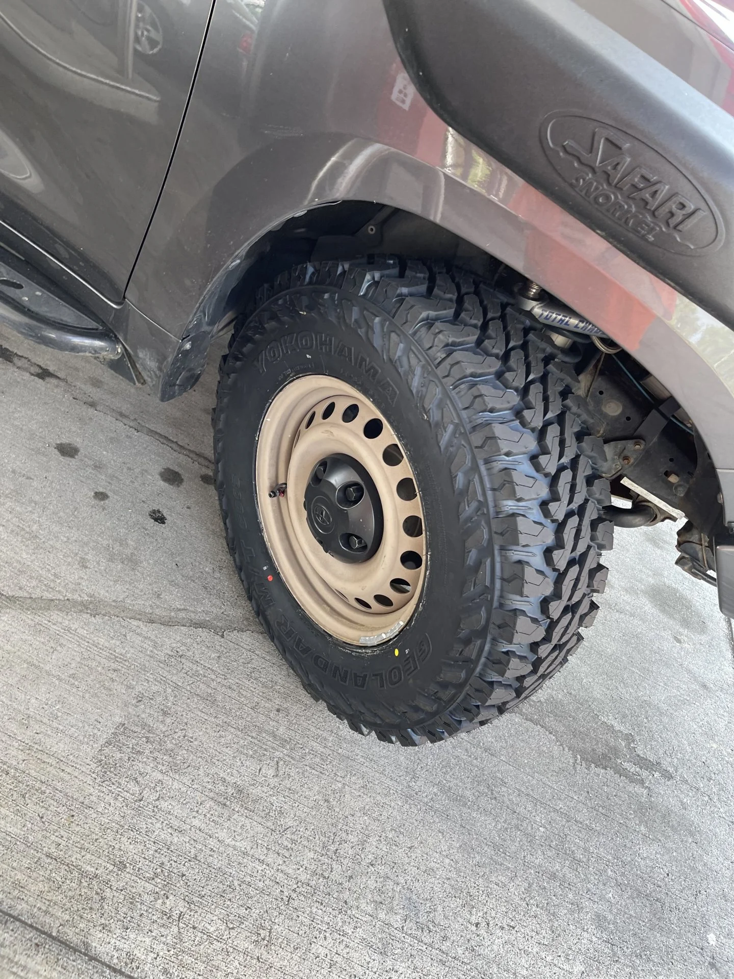

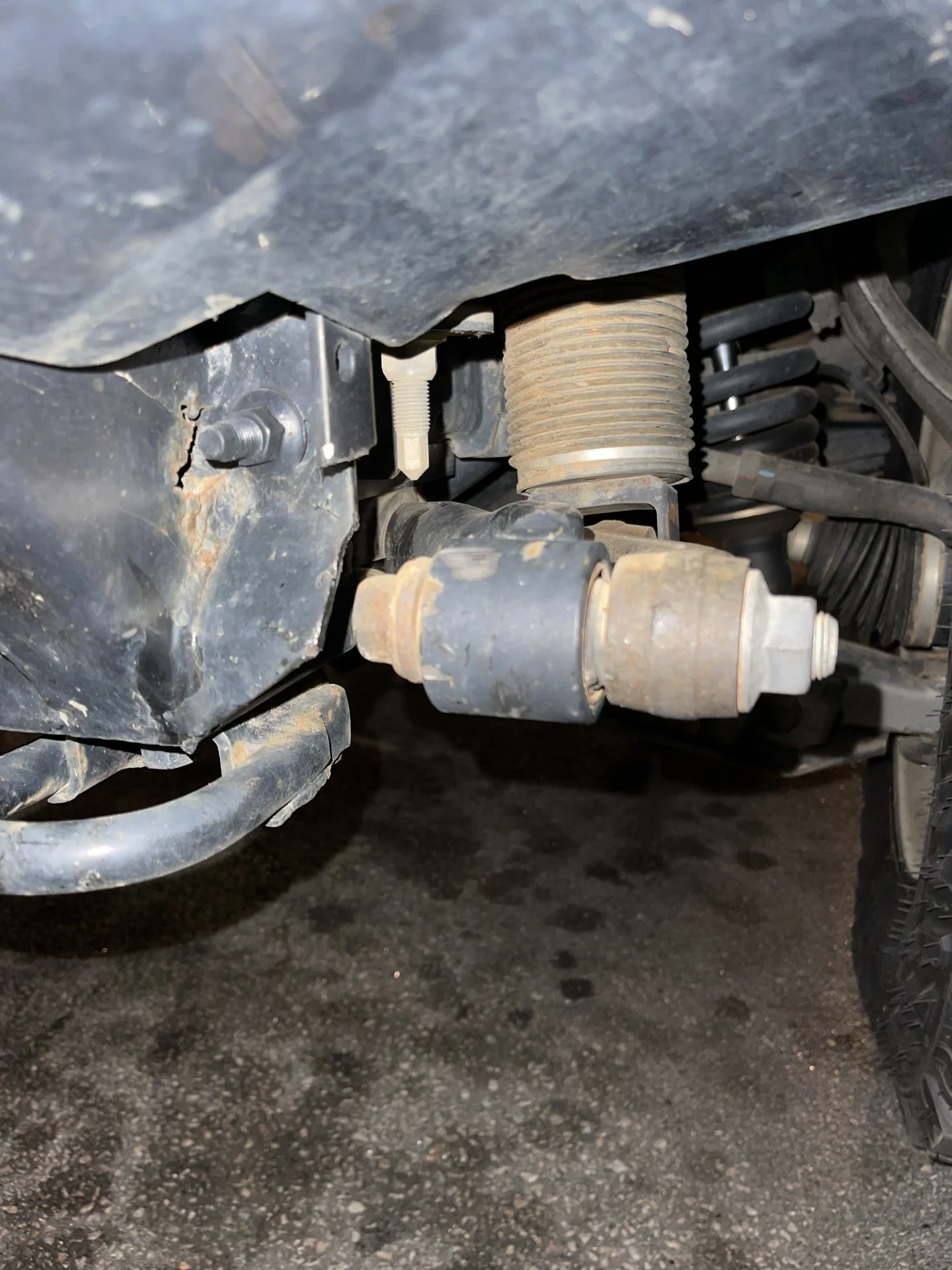

So I did some sweet talking with discount tire. And they were willing to trade for 285/75/18. Did the Yokohama Geolander G003. So much happier. Had to cut some plastics. And a metal bracket. But no body mout rubs. Added the @TRAIL TAILOR kdss relocation bracket. Also as @Taco2Cruiser said I had to cut my ARB bumper some to get it to fit the relocation kit. But me and @ncst8fan40 had it done in little over an hour. In a gravel driveway also broke two of my nice ratchet straps try to fight that swaybar in. But this also just pushed regearing to the top of the list. But I’m on 35s so I’m kinda badass. 😬😬😬

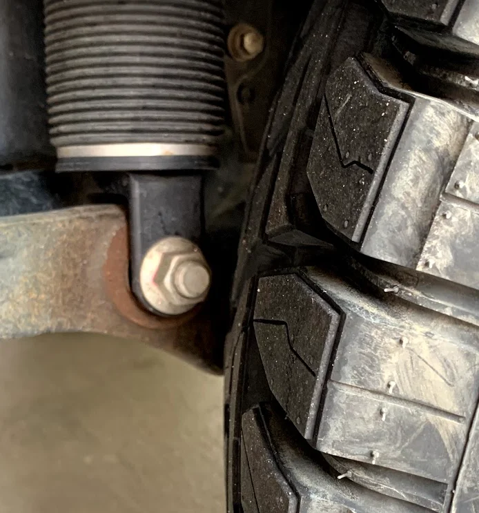

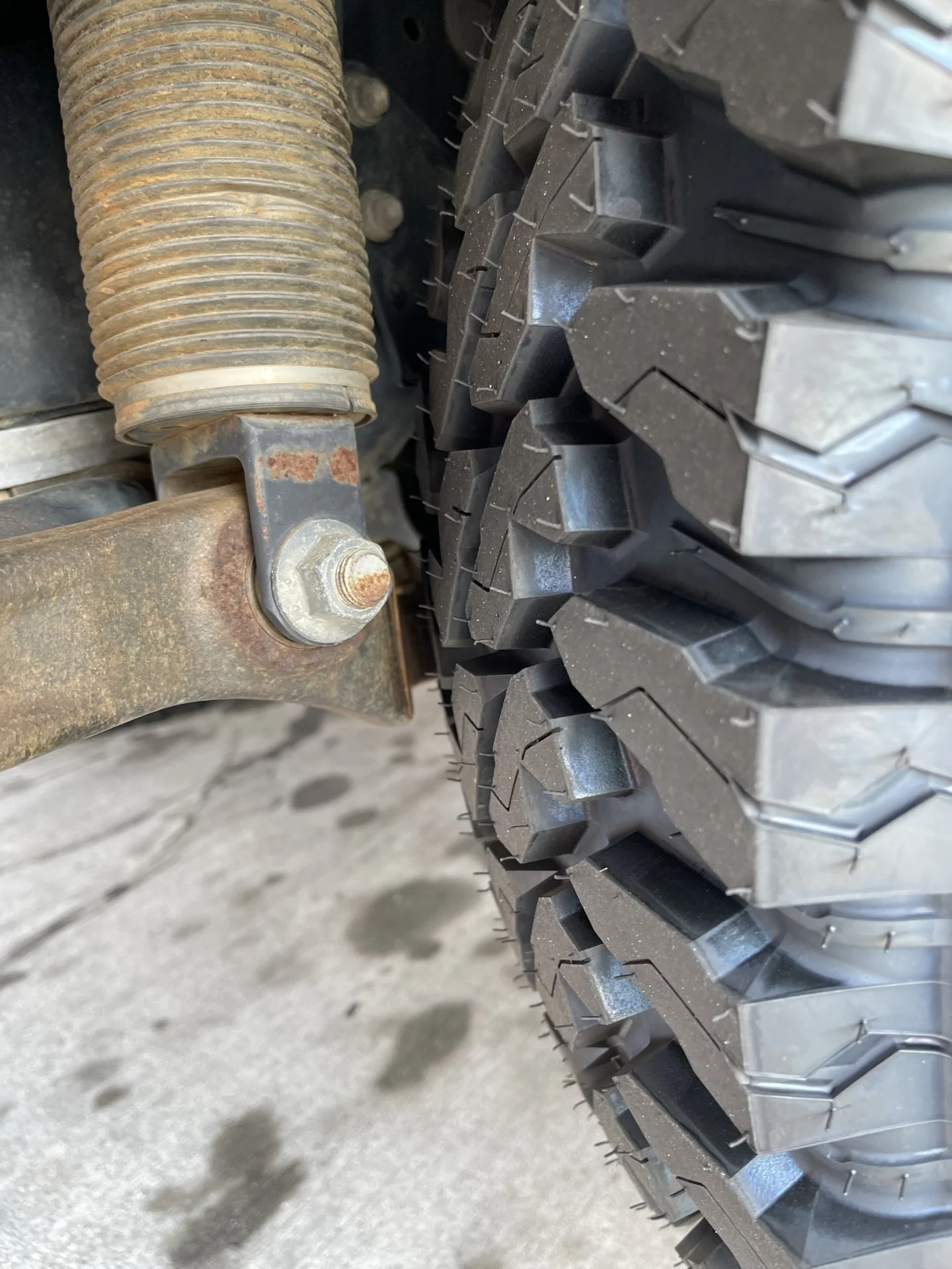

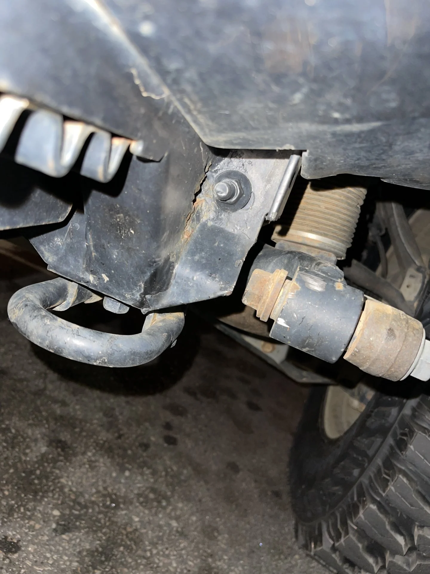

Take a picture of the very most forward bolt on the front KDSS arm where it gets close to the ARB mounting brackets
Yeah, a section of that ARB bumper mounting bracket has been cut off. That’s why the sway bar relocation fit. You said you cut a bracket, that’s what I was referring to with needing to “cut a piece off the ARB.”
For anyone with an ARB bumper and wanting to fit a relocation, you would have the cut the ARB mount about what is seen in the picture.
I still had to cut a bracket but not for the arb. Had to cut 3 different pieces to fit them.
Sorry, I’m not following you. That piece that is next to the bolt, is an ARB bumper piece, the ARB bumper’s mounting bracket, which has clearly been cut and had a section removed. What else did you cut off?
As I said, It’s not ARB related. It was a mud flap or something. That was the extra bracket.

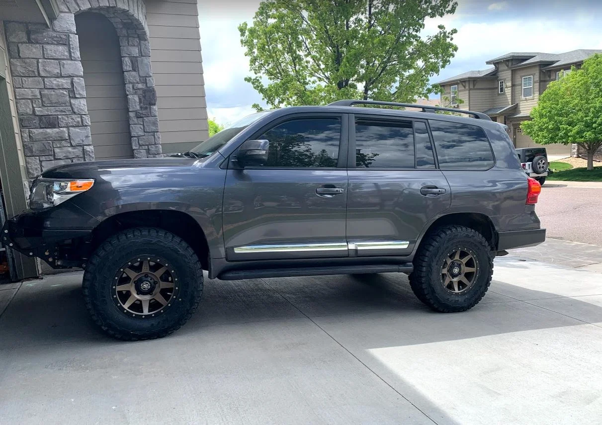

My new, used, ride got some new shoes and rims. The set up before was less than ideal on 18" TRD Pro rims with a 60mm offset and no spacers running 275/70/18. With an existing OME lift it looked quite dorky. Luckily the tires were done so I could pick my own.
Went with Icon Rebound (25mm offset) in 17's (1817855557BR) as I like the more tire look. I am partial to Toyo's and went with their R/T's in 285/75/17. Glad I did a ton of research on this forum and this thread regarding sizing as they provide plenty of lift and fit the wheel well perfectly. Zero rub with the Dissent front bumper; just had to remove the front mud flaps. The road noise is roughly the same as the prior tire; minimal. FWIW the full size spare does fit underneath in the allocated space.
How she sits now until the next mod comes about:

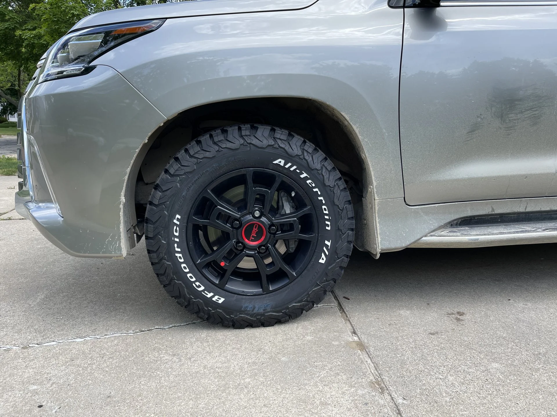

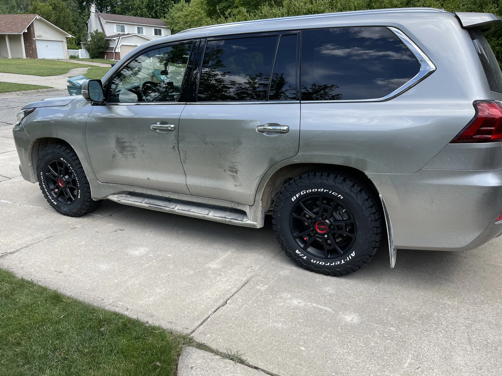

Update here: I was able to get a set of BFG K02s in 275/65/18 on some Toyota TRD Pro BBS rims (PT960-34200-02). All stock; no lift and no spacers required. Here are the images for those on this forum who are interested (photos taken with suspension on standard height). I can't stress how great these look in person. Can't wait to try them out:

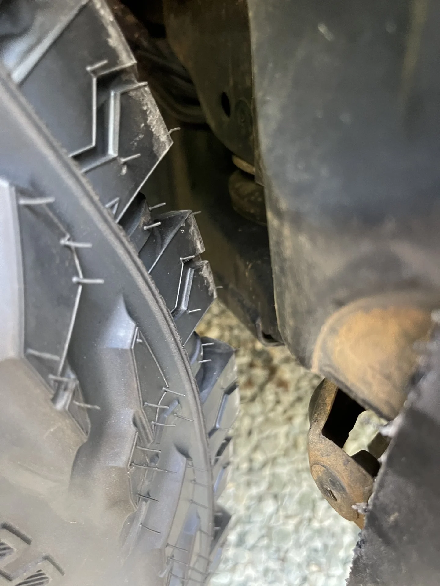

The reason why members say these are the biggest size you can go before mods need to happen. Full lock drivers side.
Very cool. Nicely done. Looks like you have a decent amount of room still. Do you know what your what your alignment specs are ? Specifically the caster.
I'm getting that done on the 11th at Toytec. I'll PM you a pic of the readout once complete 👍
Thanks! Looking forward to seeing the results. Are you running aftermarket UCAs with your lift?
Based on my minuscule level of alignment knowledge and theory I have noticed that when my caster is above 3 degrees (3.1-3.4) I can see that my driver side is super close to the KDSS sway bar, nearly touching at Full lock....but this is with 45mm offset wheels and LT275/70R18 (33.43x11.22) size tires.
