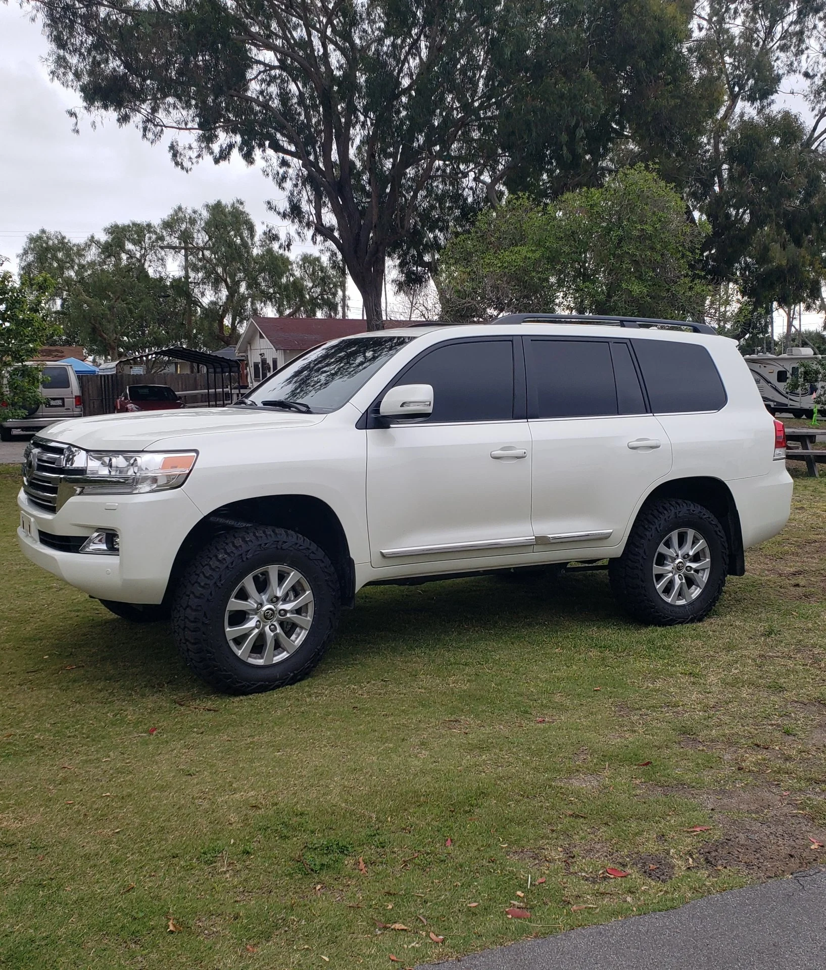

New tires today got bolted onto my first 200. The truck is at stock height. The fellow who assisted me at the local Les Schwab told me their 275/70/18 Mazama Open Range (built by Sumitomo) has a diameter of 33.4" and width of 11.1". I was pleased that they barely fit with zero rubbing at full turn angles. It appears this size is a maximum diameter/width for a stock 200 without requiring wheel well plastic trimming or mud flap removal.
Edit: Today I noticed light rubbing with wheel cranked while moving in reverse, coming from front of tire.
The light rubbing was in fact happening behind the front tires. So I removed the front mud flaps and no more rubbing. I'm really happy with these tires, including their size.

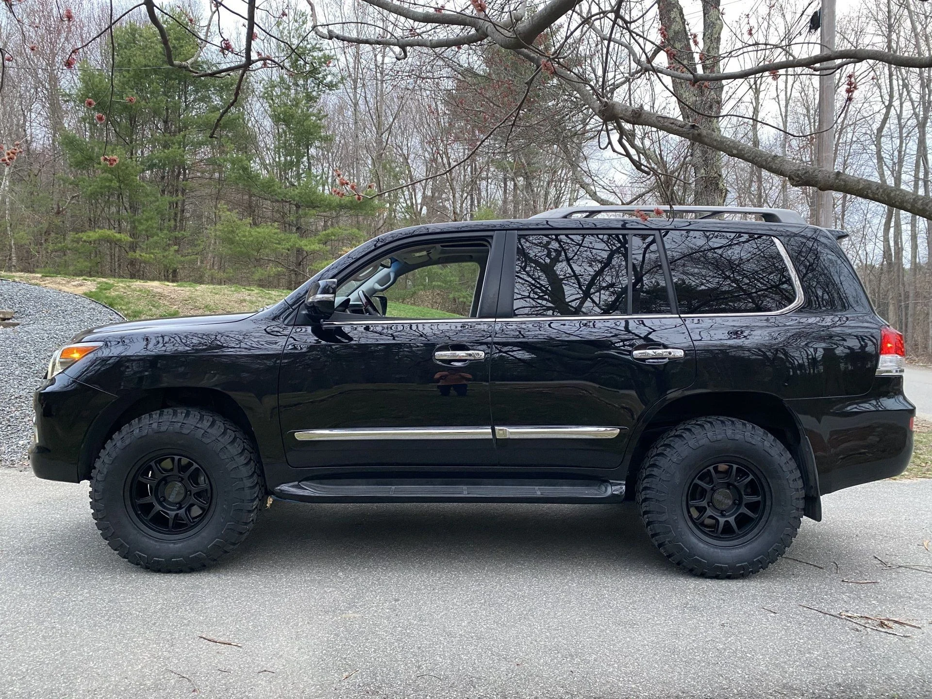

Just installed some new wheels and tires over the weekend. Went with a 295/70/17 M/T. Based on my search on here, doesn't seem to be a popular size. In fact, I think I found only 2 other people on here who are running this size.
Wheels:
Method 313 17" x 8.5"
+25mm offset
23.5lbs each
Tires:
General Grabber X3 295/70/17
Overall diameter 33.3"
Section width 11.8"
Bought this size knowing I had to do some trimming. The level of trimming was semi involved if you don't mind getting wild with a dremel tool. Doing a similar modification that I had previously done of my 5th gen 4Runner, I was able to move the front liner forward about 1.5" or so. Combined with some trimming of the inner wheel well (lower mudflap?), theres a mile of clearance up front. It get's tricky towards the back. Spent some time with the dremel and a heat gun and I have some solid clearance back there that will hopefully increase once I get realigned with some additional caster.

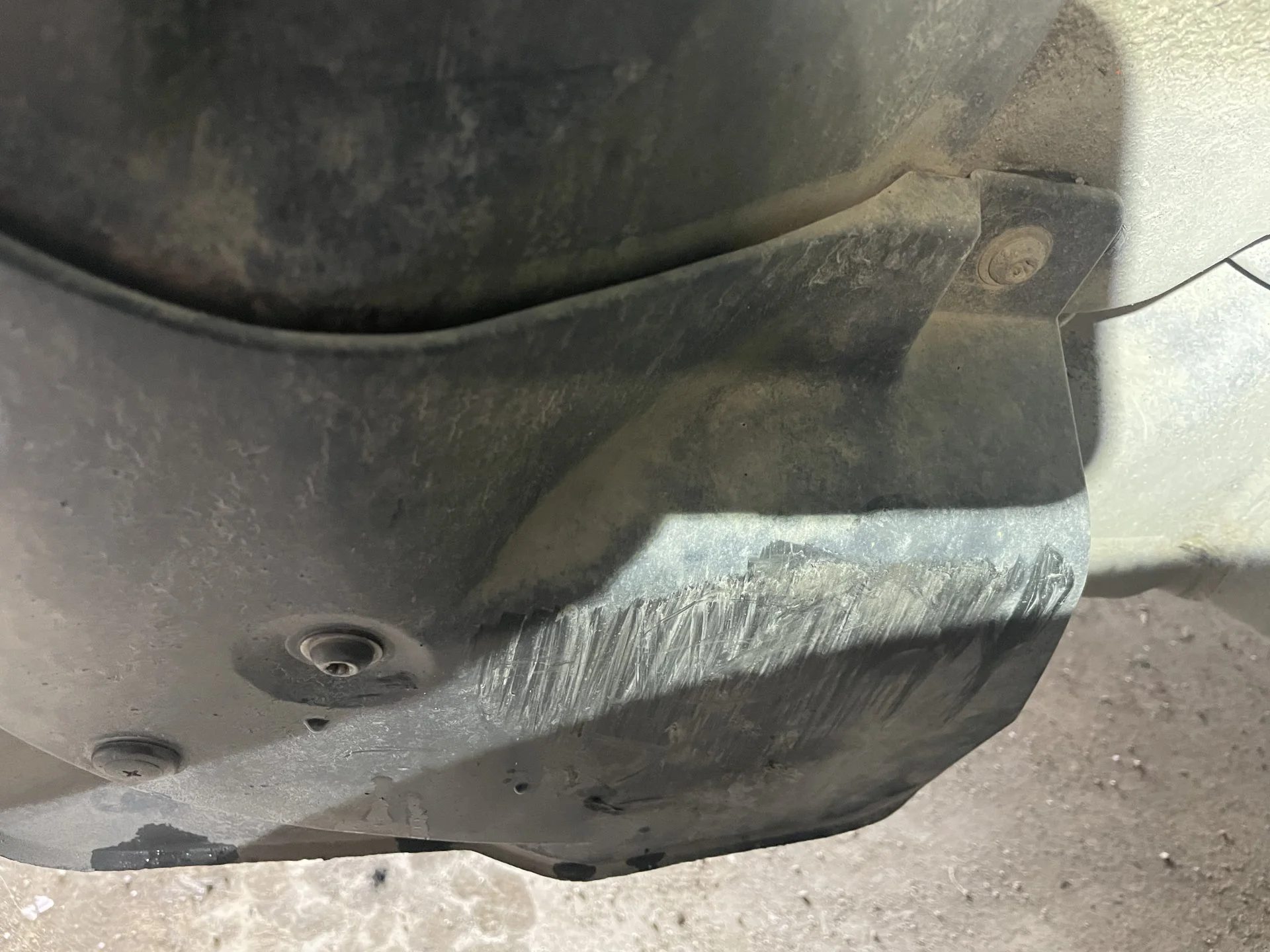

Some of the trimming involved. Sideskirt bracket was bent back, redrilled a new hole and added a longer bolt to pull in this area of the sideskirt. Liner needs to be heated and formed as well, which I performed after taking this photo.
Front fender liner modified:
Your truck looks fantastic! I have the same (LX570 2015-Black). Just purchased a set of 17" Evo's 8x17- 40ET. Question...do you think the 40ET (vs your +25mm) would reduce or increase the rubbing hot spots and required trim modifications?
I am going with ko2's ...but can't decide between 295/70 vs 285/70. 295 looks best. But blank canvas and hindsight...would you have done the 285's instead of the 295's?

A 285/70r17 would fit with probably no rubbing at all. You can do a 285/75R17 and deal with a little rubbing, but only have to adjust plastic to get it working. I suspect a 295/70R17 would be somewhere in between. I don’t think many tires come in that size, being the primary reason for why it’s not popular.

Do you mean deal with rubbing AND plastic adjustment or do you mean that after adjusting plastic, i.e. moving the liner or trimming mud flaps, you would still have some rubbing?

The dealing with rubbing is the adjusting of plastic. 34” in 285 width only needs massaging plastic to get a good fit, as long as you have a good wheel offset.

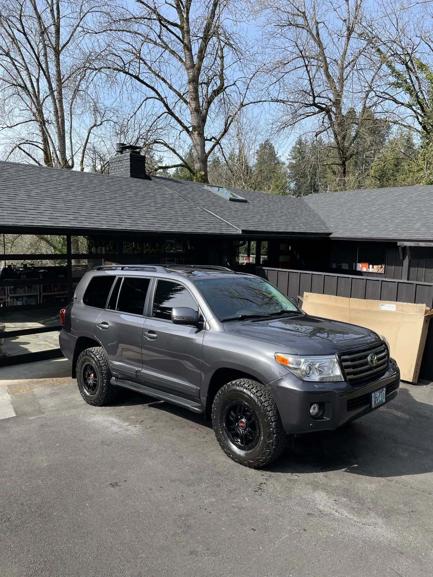

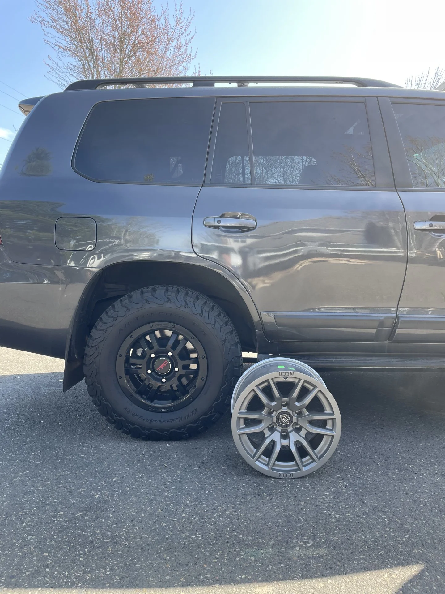

Hey friends. Need some fitment and color guidance for our 2014 Cruiser. Currently on Iron Man 2” lift with ARB 2721 springs on 285/70/17 K02’s on rock warriors (pic below).
My wife and I hate the iron man suspension and we are switching to a BP51 set-up. We haven’t decided if we are going to do the 1 inch or 2 inch lift and the 2720 or 2721 rear springs. We want to keep the tires and put them on the Icon Vector 5 17 inch wheel so we can ditch the spacers.
Will the 285/70/17 fit with a 1” lift and .5” out back (2720 rear springs) without spacers or do I need to go with the bigger lift. Currently no rubbing issues.
Second question - should we go bronze or matte black on the wheels? I brought out the titanium but didn’t love it..

Bronze all day.
Recommend you checking out the tire and wheel thread to answer your second question.

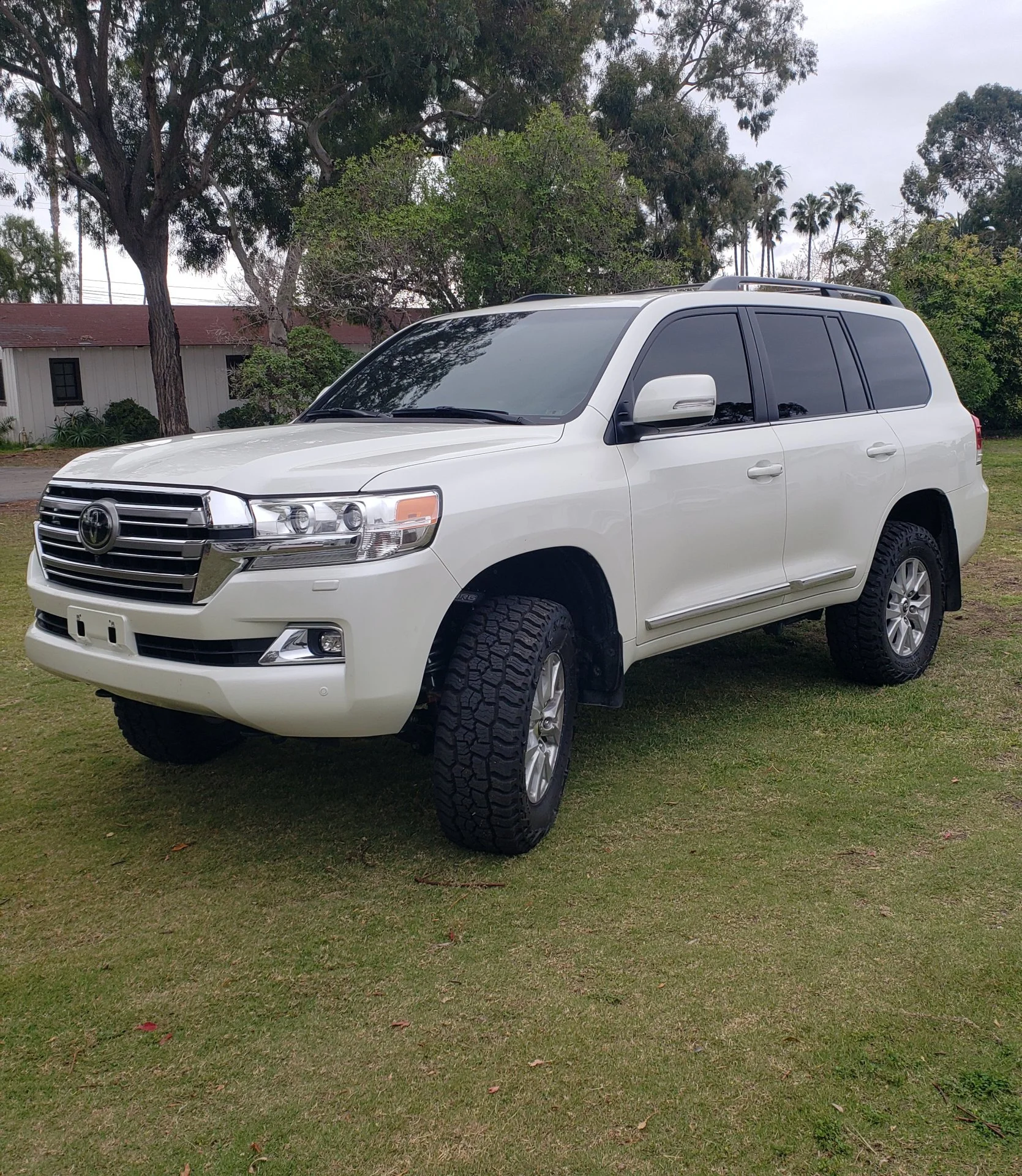

Access to the original seems to have been lost to time. We have started a new version with a survey here and results that can be filtered/sorted here. It's not encyclopedic yet, but every 200 added to the survey helps fill out the database.

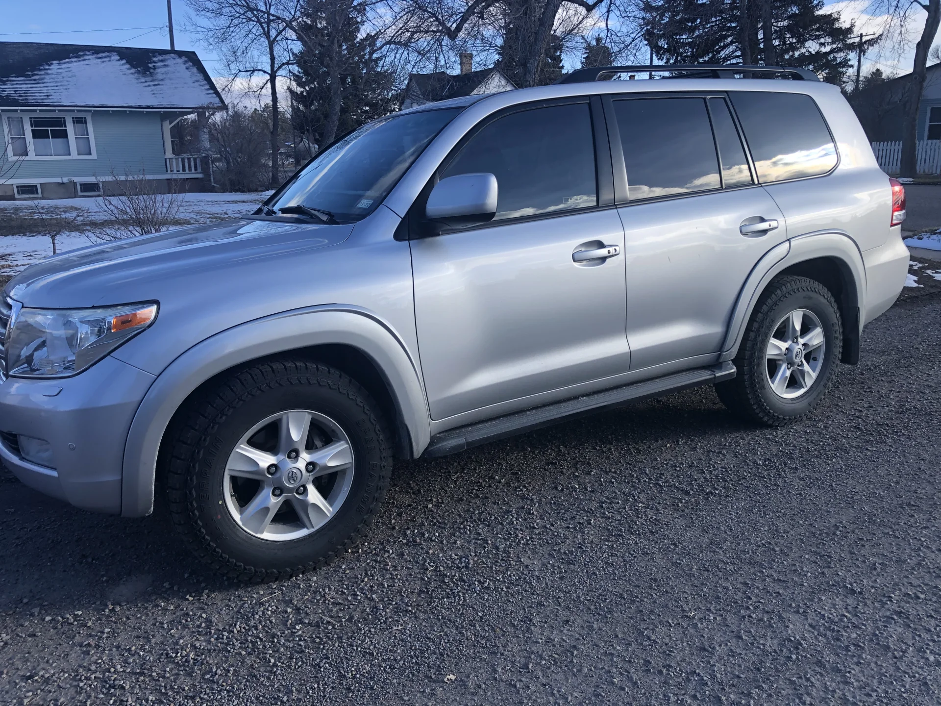

Currently rolling on Mickey Thompson Baja Boss A/T in LT275/70R18.
