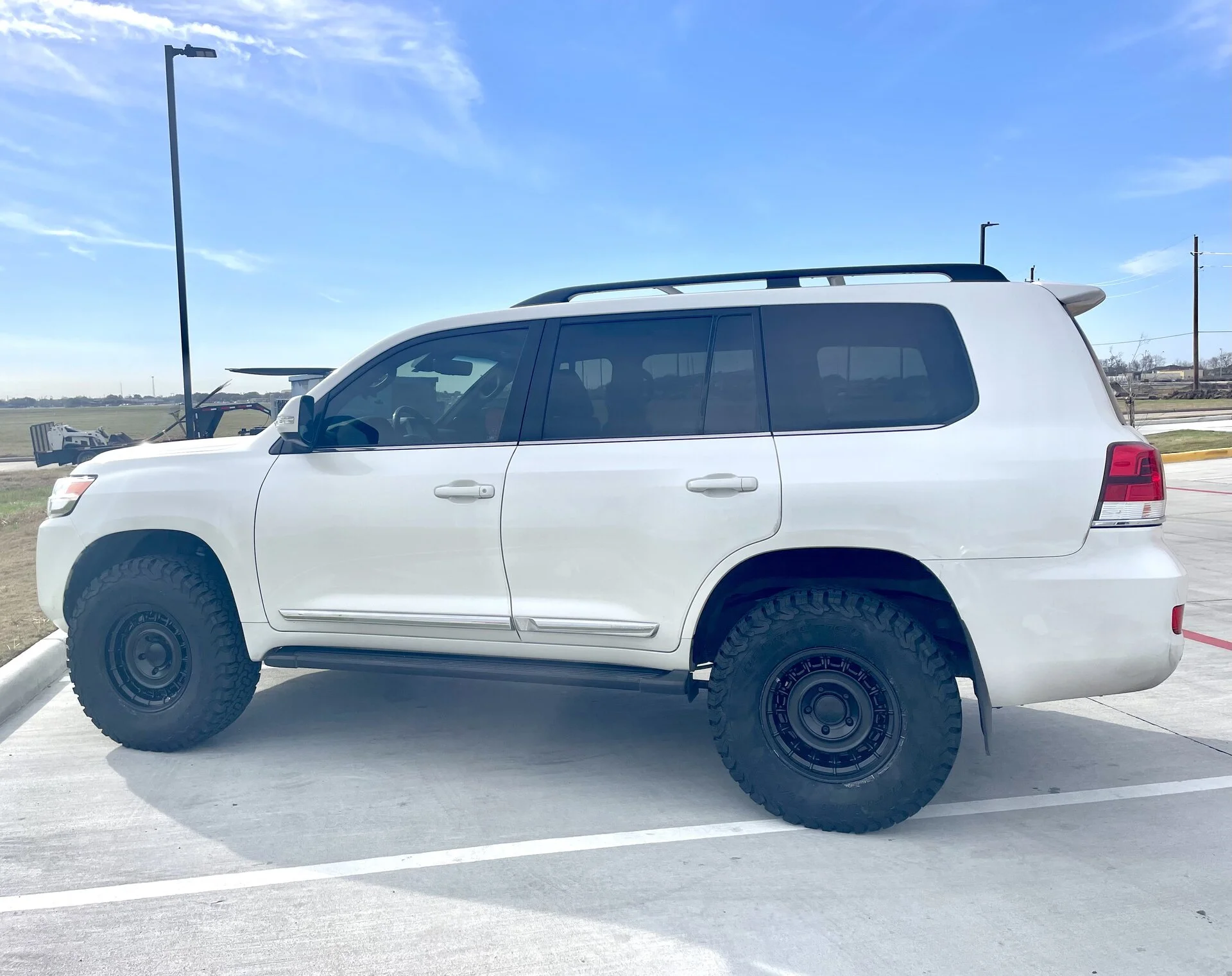

Just put a set of Cooper Discoverer ATP II in 285/70/17 (Rock Warriors) on my 2013 LX570.

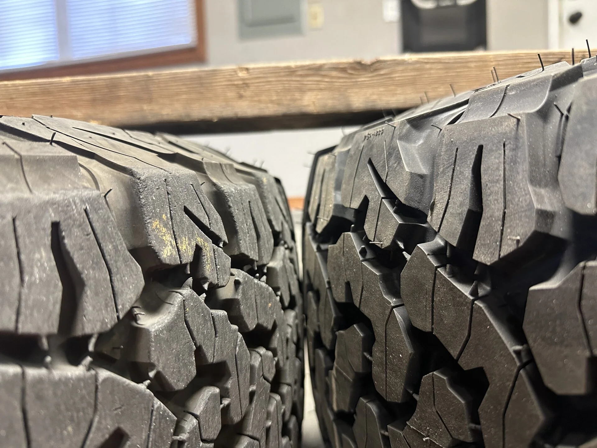

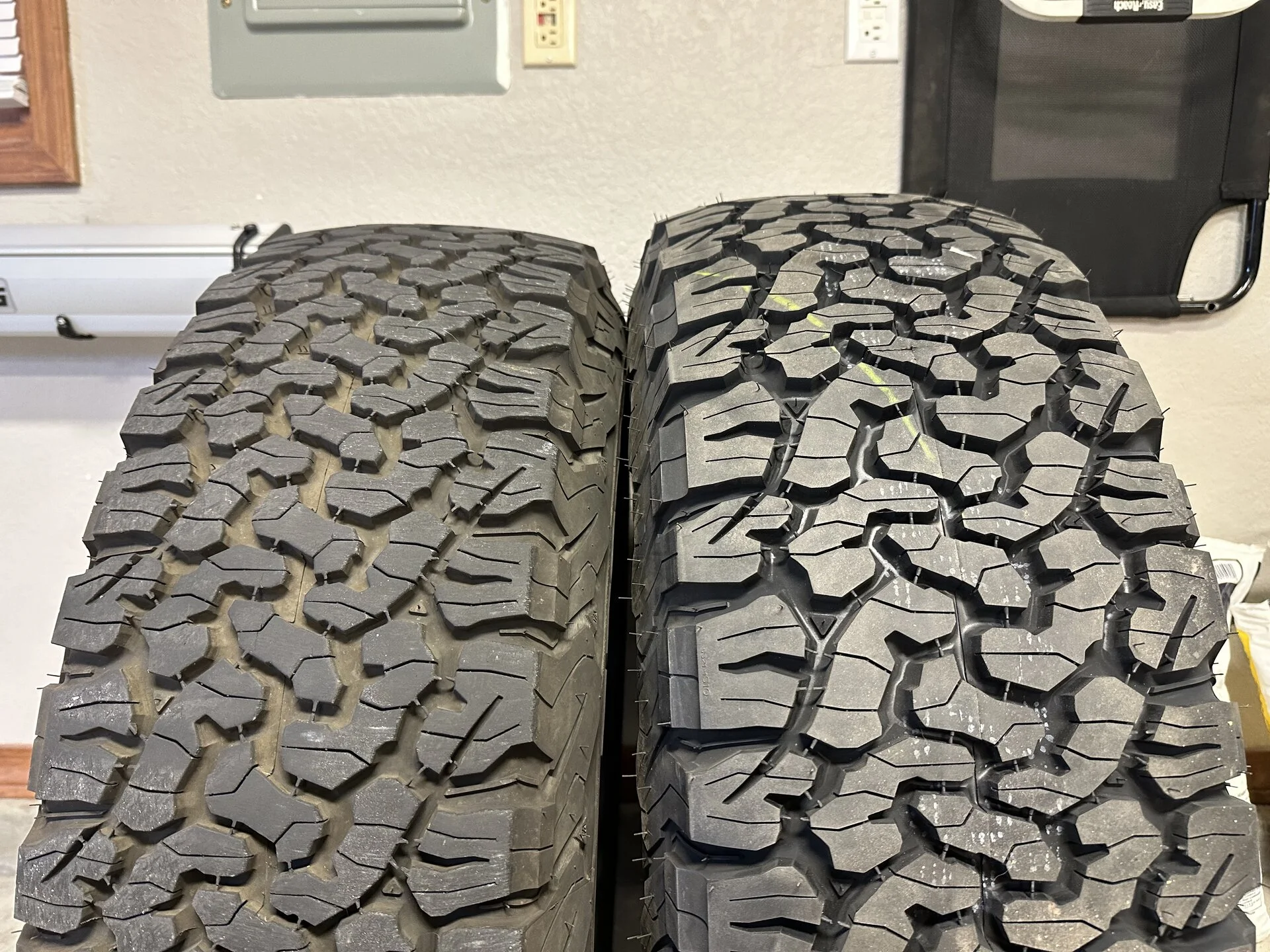

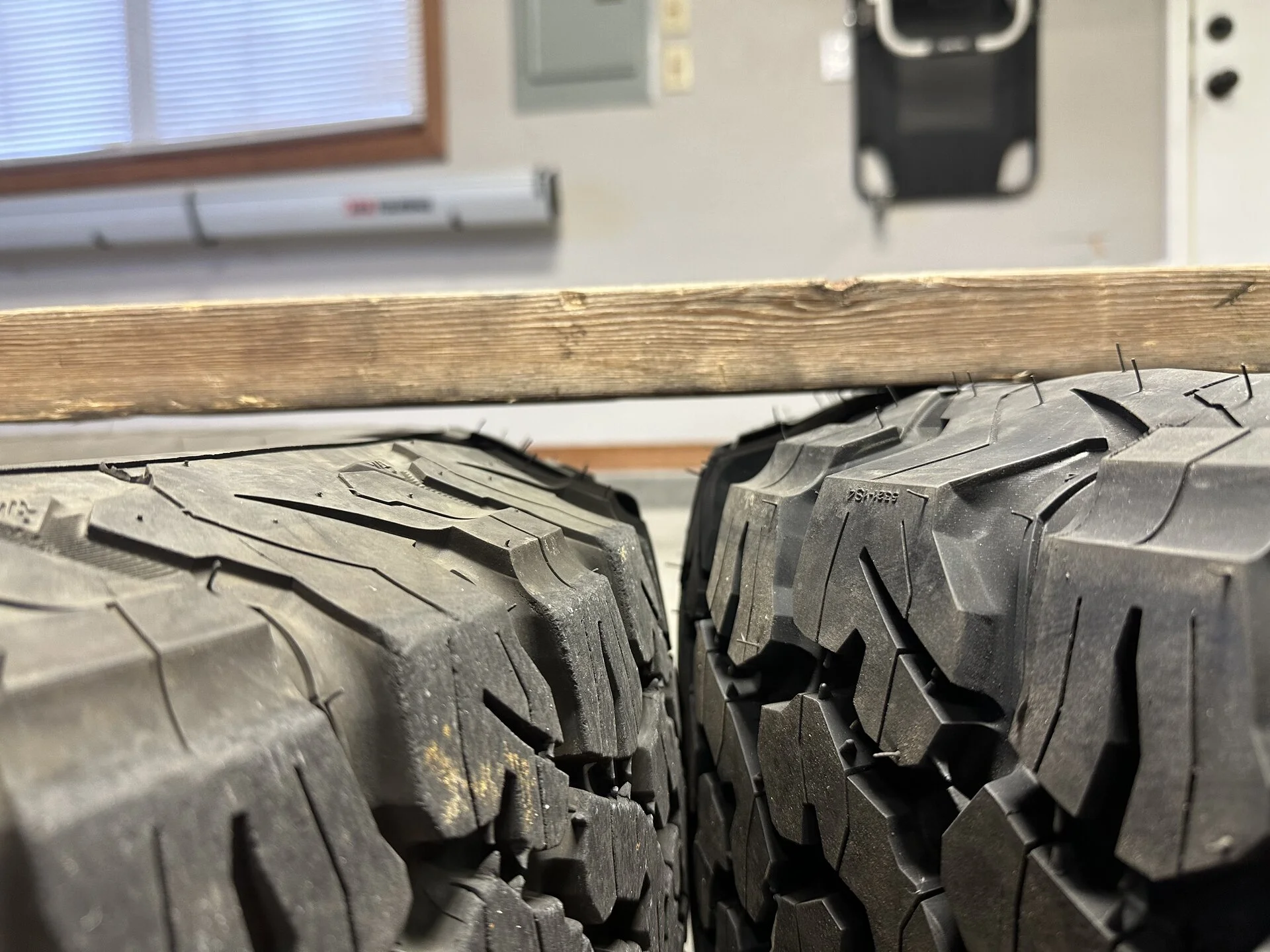

Visual comparison of KO2s in LT285/75r17 (37psi) and 35x12.5x17 (37psi). It is important to remember that the side by side photos don’t accurately reflect an “on vehicle” comparison. The hub surface is not at the same vertical or horizontal plane.

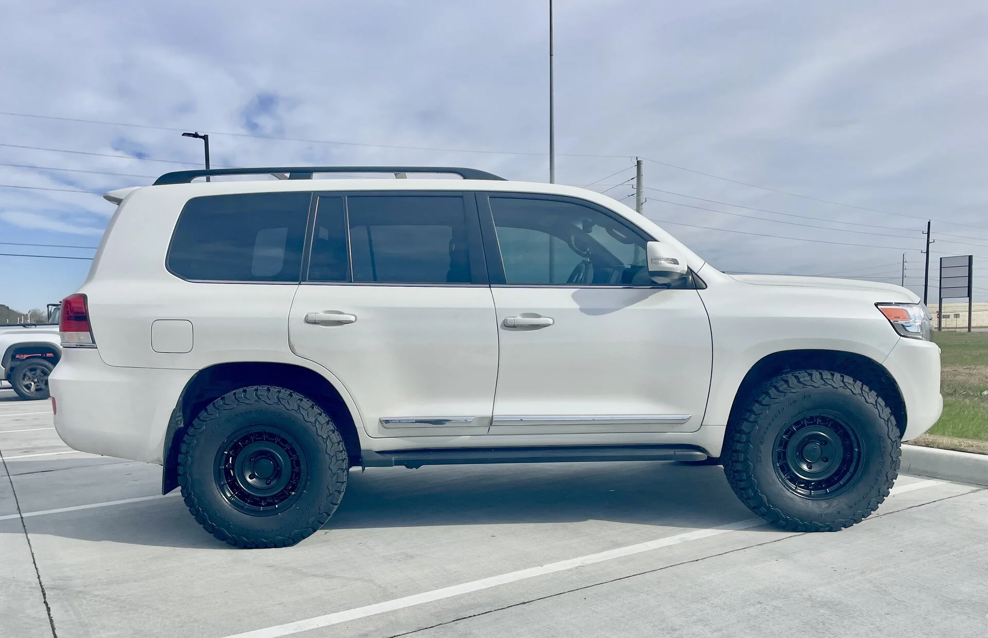

Rock warriors, no spacers. No KDSS or front sway bar.
