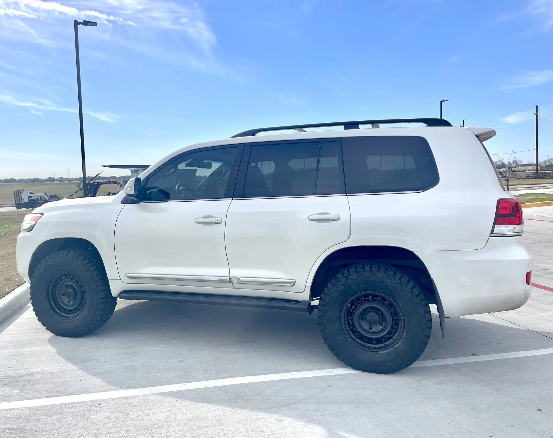

A few adjustments still need to be made but here’s a quick parking lot snap shot post wheel/tire install. OME 2” lift with 285/75/17 KO2’s on Nomad Arvo 502’s.
