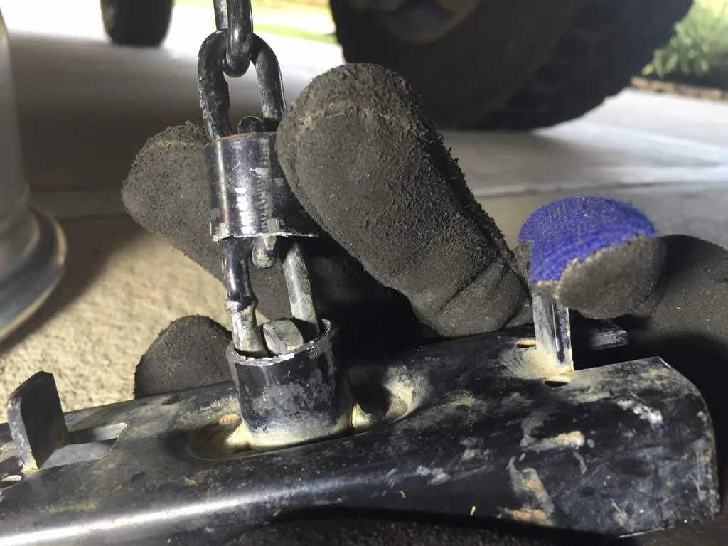

Thanks man. Much appreciate it. So let’s say I put the oem wheel and tire size back on to sell 30 years from now - does the oem wheel no longer properly secure underneath after that cut?
The later model 200s have a different hoist that is shorter. You can replace the old part number with the new part number and not have to worry about finding a spare to suit. Probably costs less than having 285/65r18 mounted and nullifies most of the “what if” scenarios.
The modification has 0 effect on hanging the OEM wheel on the hanger.
Heres a picture of what you have to do. A few of the early threads talk about removing links, none of that is necessary. Just cut the tube like this picture, then cut it perpendicular and pull the excess tube off. If you want to be real careful, it takes about 5 min to take the hoist off. If yours is a few years old, it’s a good time to lube and rust protect it anyways. Also, there is no “year cutoff” that I’m aware of, just some hoists have a longer tube and some have a shorter, so you can check yours to see if it will work anyways.
My hoist needed cleaning up, so I took it off and did the cut on my bench vice with a sawzall, but it is not thick metal, so almost any metal cutting blade will take care of it.
