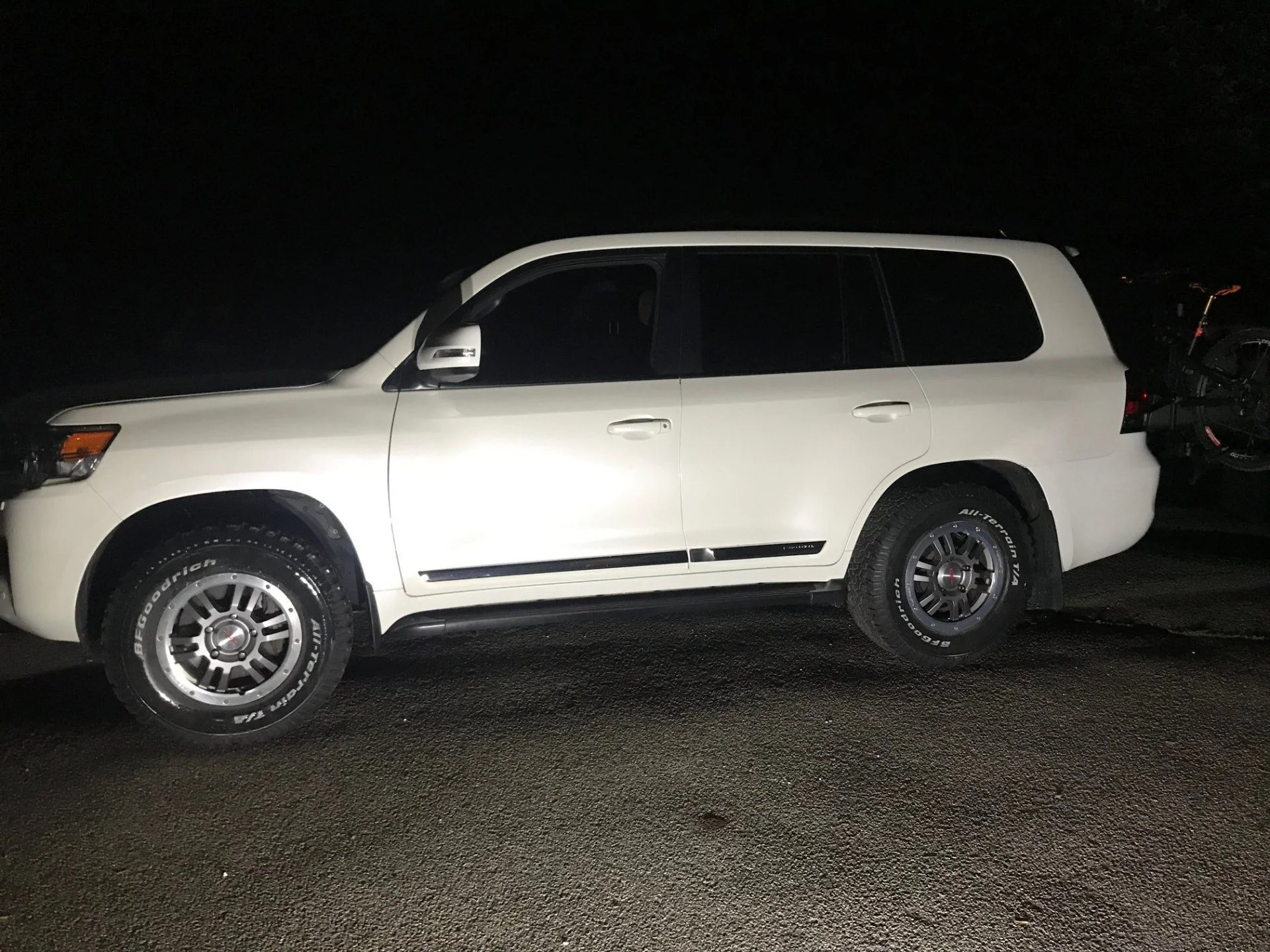

I’m running the 702s (zero offset) with the same size Toyos. With stock suspension you will need to trim and adjust some plastic up front, but it’s not a huge deal.

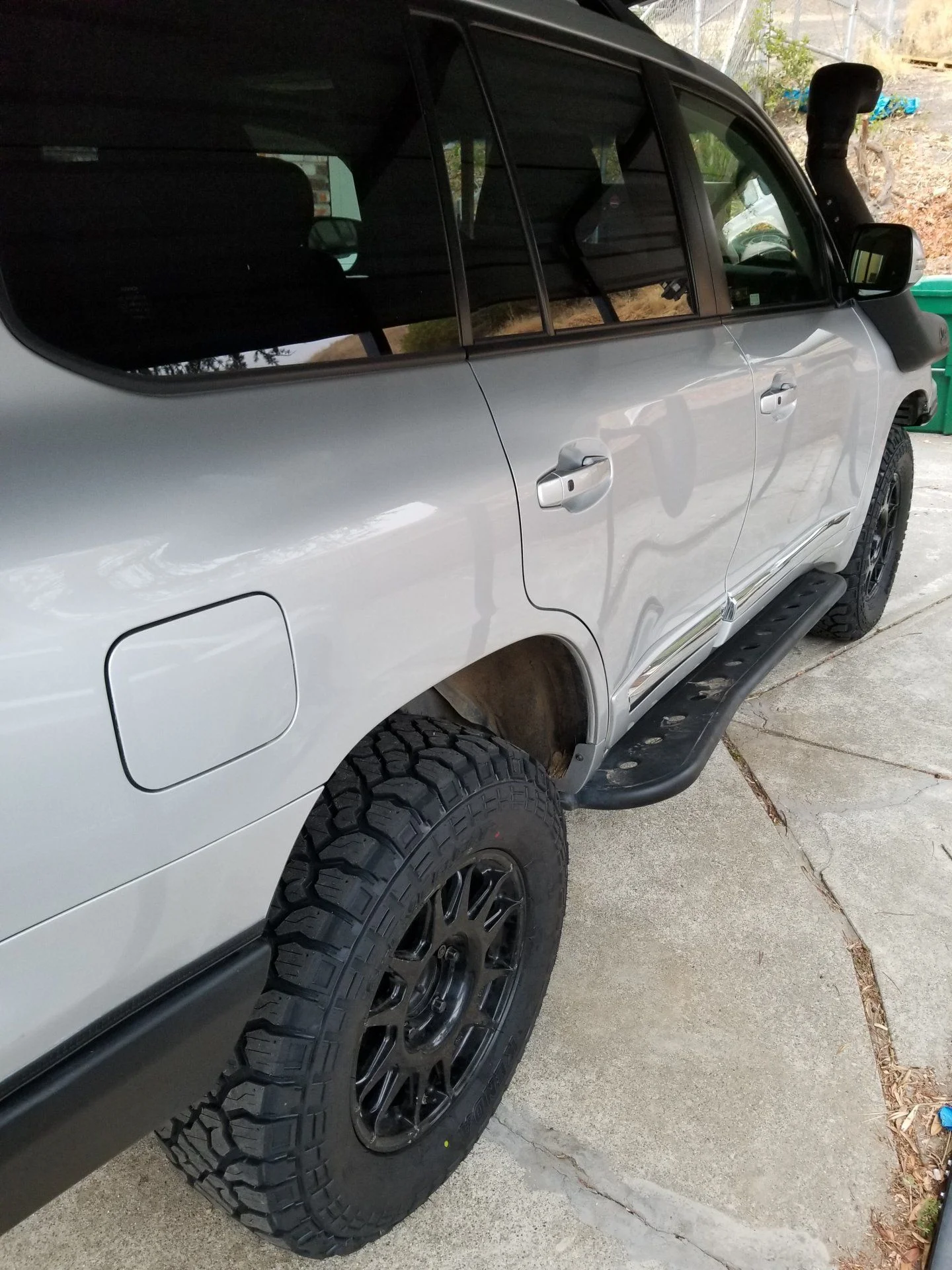

Swapped out my general grabber ATXs for the Kenda Klever RT in LT275/70r18. Haven't had a chance yet to test their offroad ability, on pavement the road noise is slightly more present (whoosh sound) then the grabbers which were barely louder then the Michelin defender ltxs that came on it when I purchased it last year. The ride feels softer with the kendas. The grabbers were a LT285/65r18.

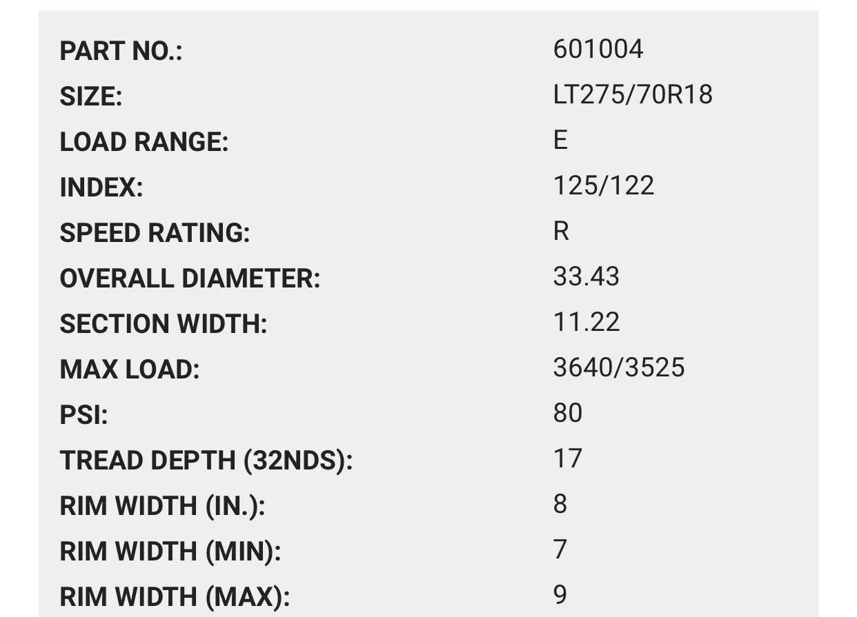

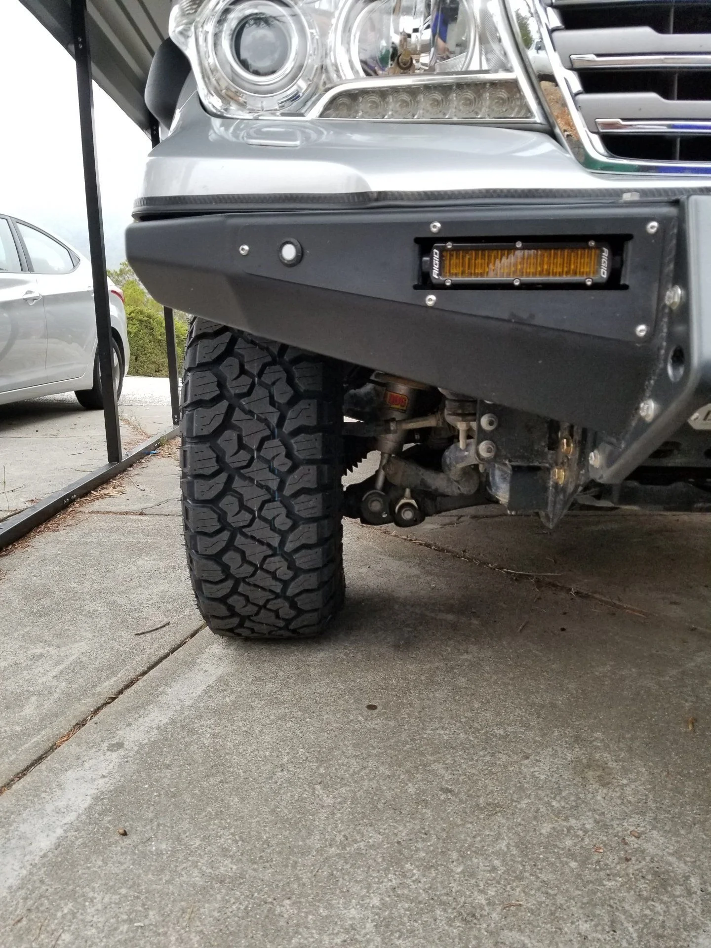

Have a slight kdss rub at full lock while moving on the passenger side sway bar. These kendas run tall and wide for LT275/70r18. They are Listed as 33.43 for height and 11.22 for width. Top to bottom I measured their mounted height as roughly 32.5".

Swapped out my general grabber ATXs for the Kenda Klever RT in 275/70r18. Haven't had a chance yet to test their offroad ability, on pavement the road noise is slightly more present (whoosh sound) then the grabbers which were barely louder then the Michelin defender ltxs that came on it when I purchased it last year. The ride feels softer with the kendas. The grabbers were a 285/65r18.
Have a slight kdss rub at full lock while moving on the passenger side sway bar. These kendas run tall and wide for 275/70r18. They are Listed as 33.43 for height and 11.22 for width. Top to bottom I measured their mounted height as roughly 32.5".

heres the spec page for the kenda r/t.

Tires are the kenda Klever rt LT275/70/r18. Apologize for the confusion, thanks for your help and info!
