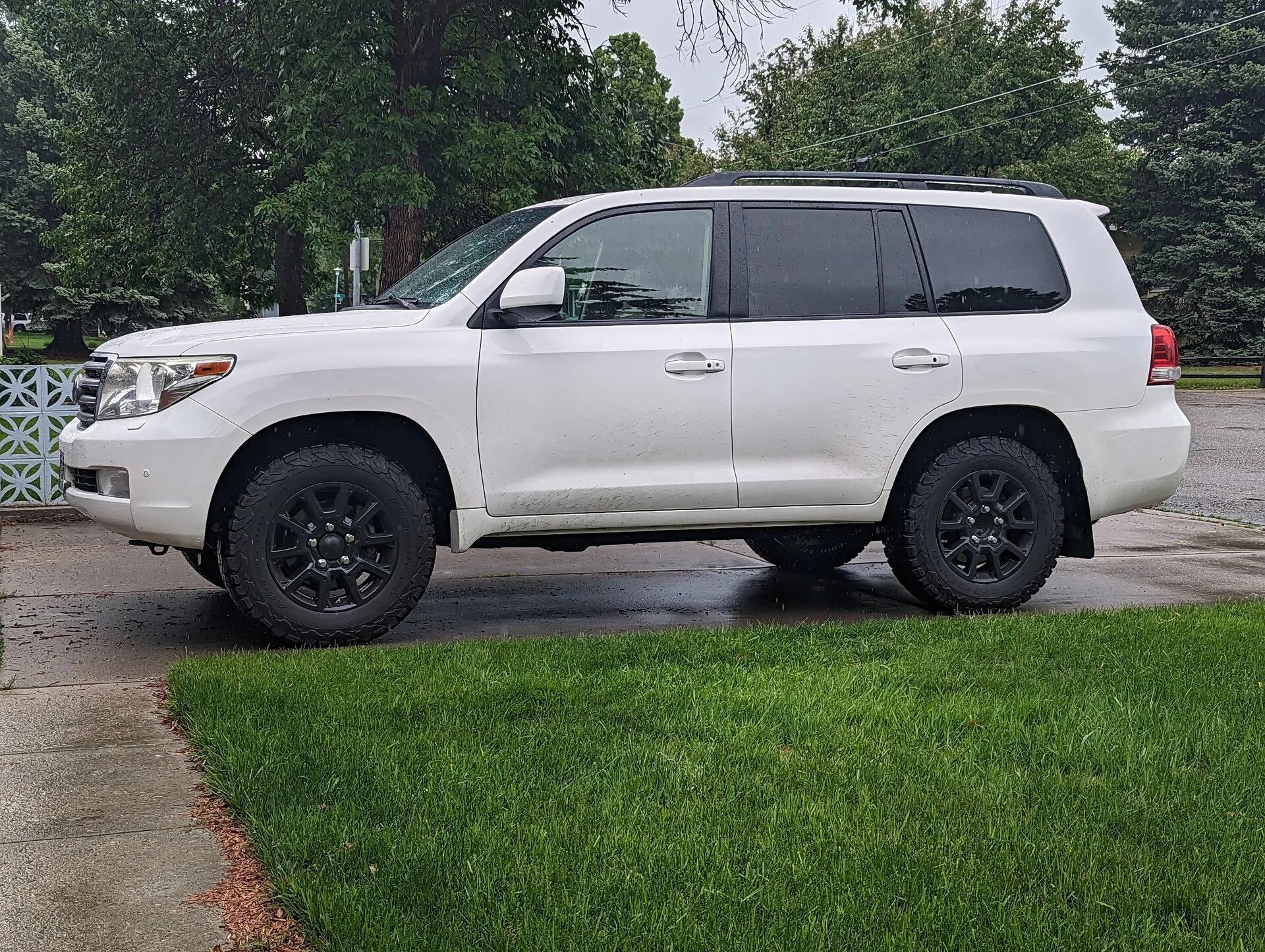

A while back I went with 275/65R18 Bfgoodrich KO2s wrapped on reproduction Tundra TRD wheels, and topped it off with the Heritage Edition spacers and some 1/2" SuperPro spacers in the back from @cruiseroutfit.
The wheels I got from wheelership.com, and they are pretty great for being repros. Finish is really solid and they balance well. Overall happy with them.
The combo actually turned out to be over an inch taller per wheel/tire, but thanks to going with the Tundra wheels, which are lighter than the Vision Turbines the truck came with, the net weight change was actually - 2lbs per tire. Thanks to that, impact on fuel ecomonmy was zilch.
Ride is identical to what it was before.
Love the look and the added clearance.
