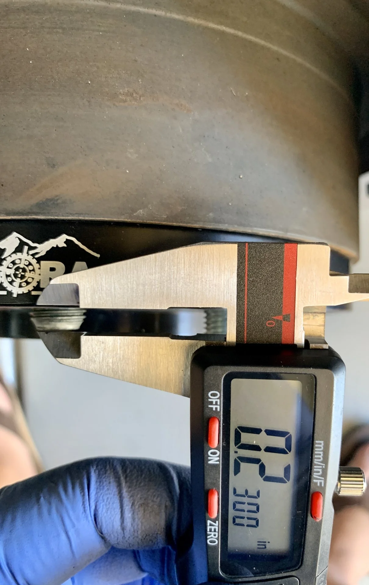

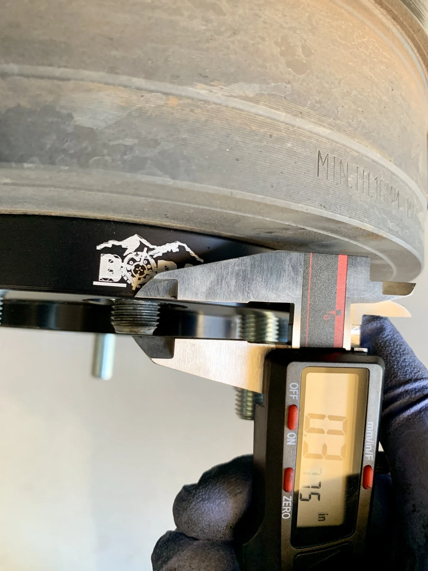

I am planning to run 0.75 inch spacers as well. On my 2018 LC the front wheel stud is 0.94 inches (the rear is 1.09 inches). This will need a minimum recess in the wheels of 0.19 inches to clear the front studs and 0.34 inches to clear the rear studs. The recess varies, but it is just under 0.19 on my OEM wheels so it will bottom out in the front and not work for the rear without some mod. What I did is drill out the recesses some more to 0.26 inches deep using a 7/8 flat bottom drill bit (made a jig to drill the right spot and depth) to have plenty of room to fit the front and with trimming the rear stud 0.1 inches should be good to go.
Hope this info helps.

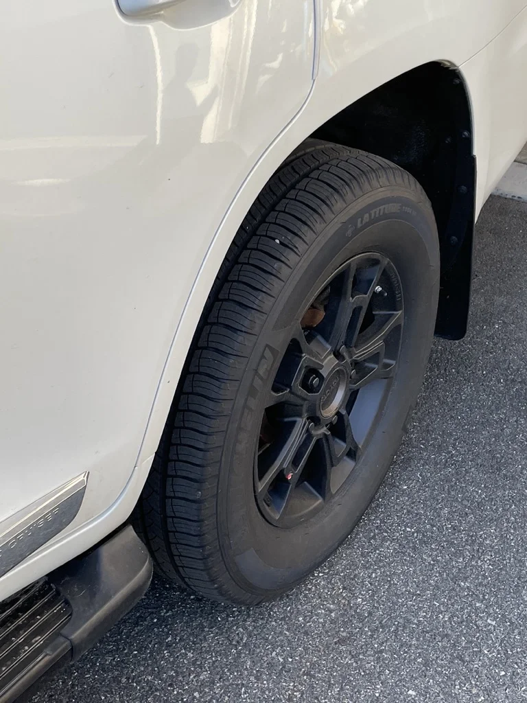

got the bora 0.75” on my 2018. mostly good, no vibrations and it all fit well.
you can see the front wheel studs sticking out after spacer install.
the rears fit fine, i just wish i had ordered the 1” since the back wheels still look sunk in

So your OEM wheels had deep enough recesses to take the 3/8s of the stud sticking out on the rear?
Looks sweet, thanks for the pics, I might go a little thicker in the rear now, maybe 0.85 inches.
I think the OEM wheels *just* had enough depth using my crude depth measuring device. I took my LC on a 10+ mile test drive and got up to 90mph. No issues, perfectly smooth.
