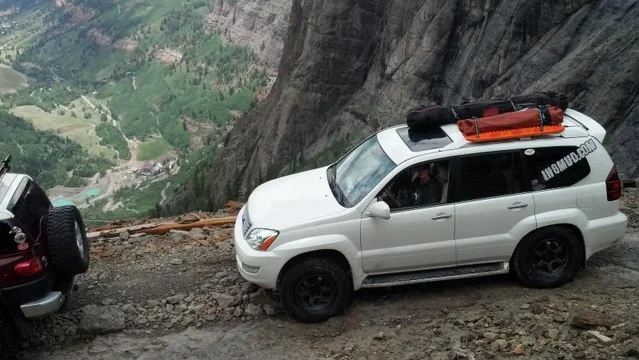

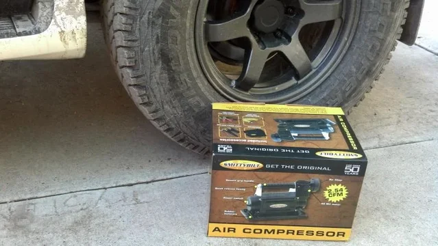

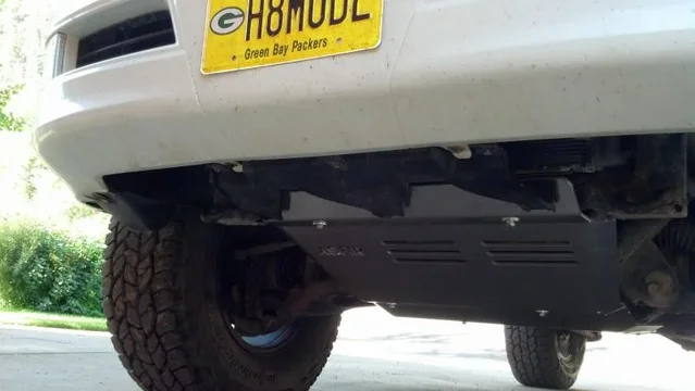

New ASFIR aluminum skids installed from AOTech...plus she won a free compressor at the Discount Tire dinner/raffle on Wednesday evening! Perfect timing for both, since SHE drove Black Bear Pass on Thursday...yes, SHE drove the entire trail!
It's not technical, but the pucker factor is REALLY high! (oddly enough, more so as a passenger...lol)
