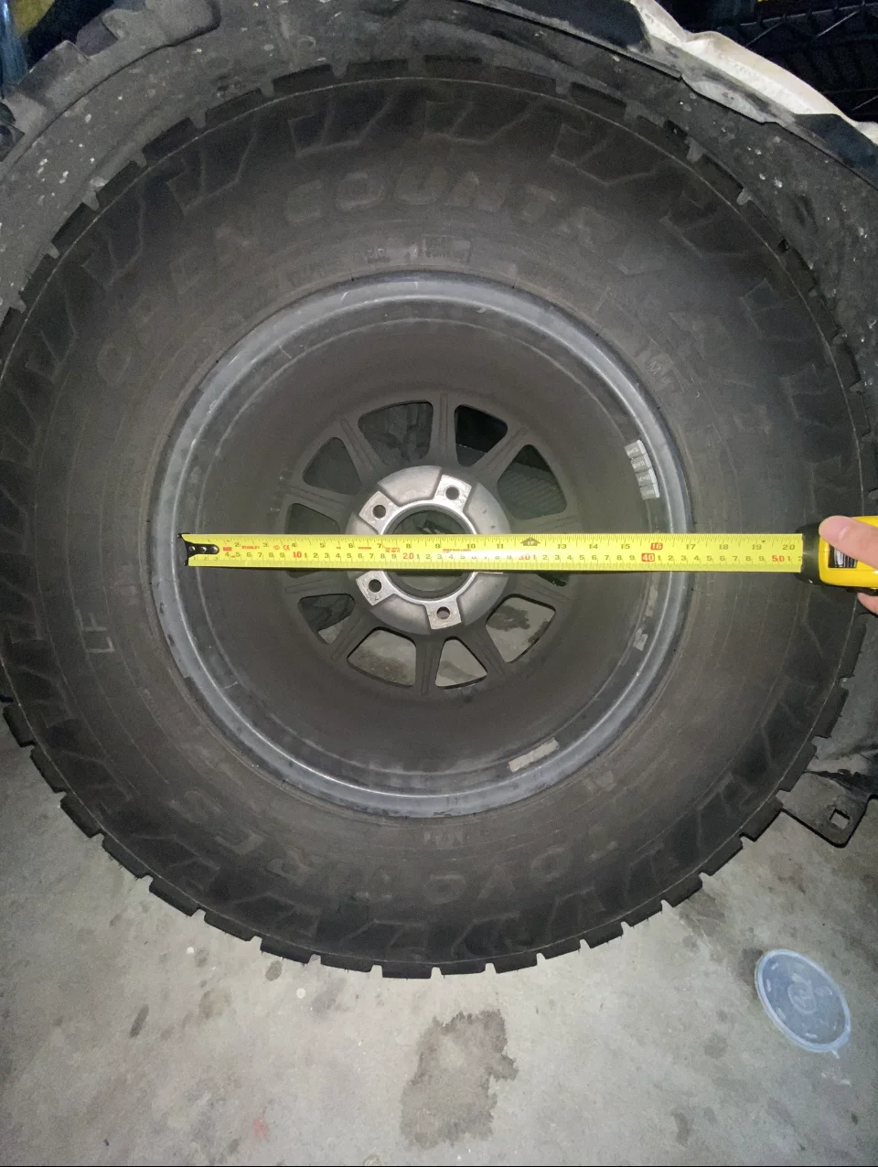

Can someone confirm a 17" +25mm wheel fits an 09 LX?
Method says yes, Tirerack says no, brakes won't clear.
Yes, anything with at least a 16.5” ID barrel will fit even with the later years tundra brakes.
Probably every single 17 on the market should fit your model year.
Thank you!
No problem, and keep in mind the barrel is slightly concave and the lips are flanged.
I didnt want to muck* up my tape measure to get the inside reading at the HUB plate where the brake assembly will live.
It could be the same, could be less than 16.5". And it still clears my larger brakes.
But barely.

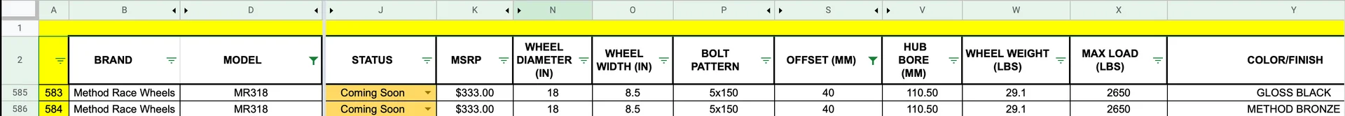

BTW for any shoppers.
New wheel alert 🚨.
Method sales had no info and no photos. But look at dem specs doe..
Booooo... hopefully nothing too funky. Spens sound promising to say the least.
I know right? This is why i Ducks with method. They are paying attention.
They did say by February it should be available.
