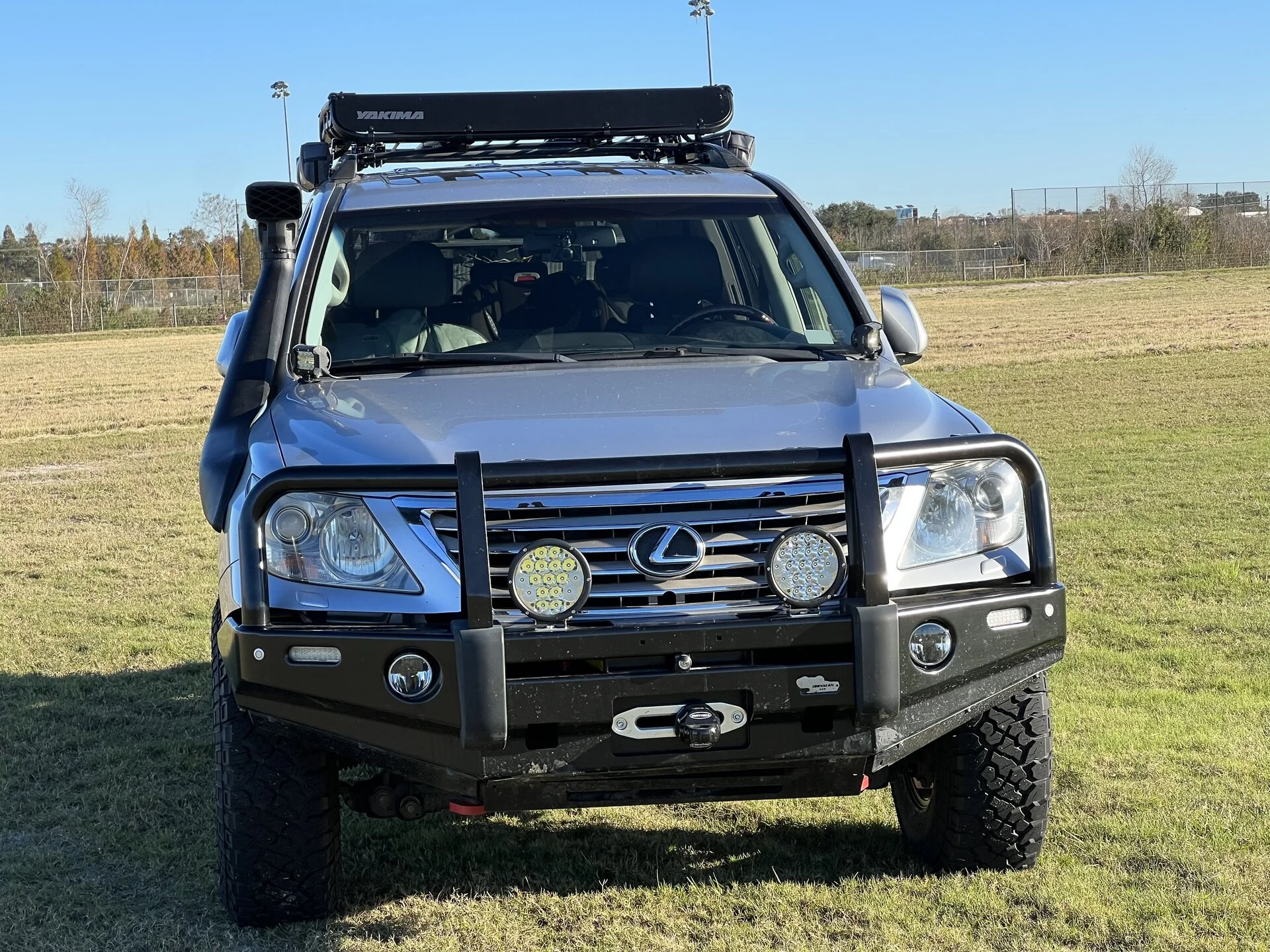

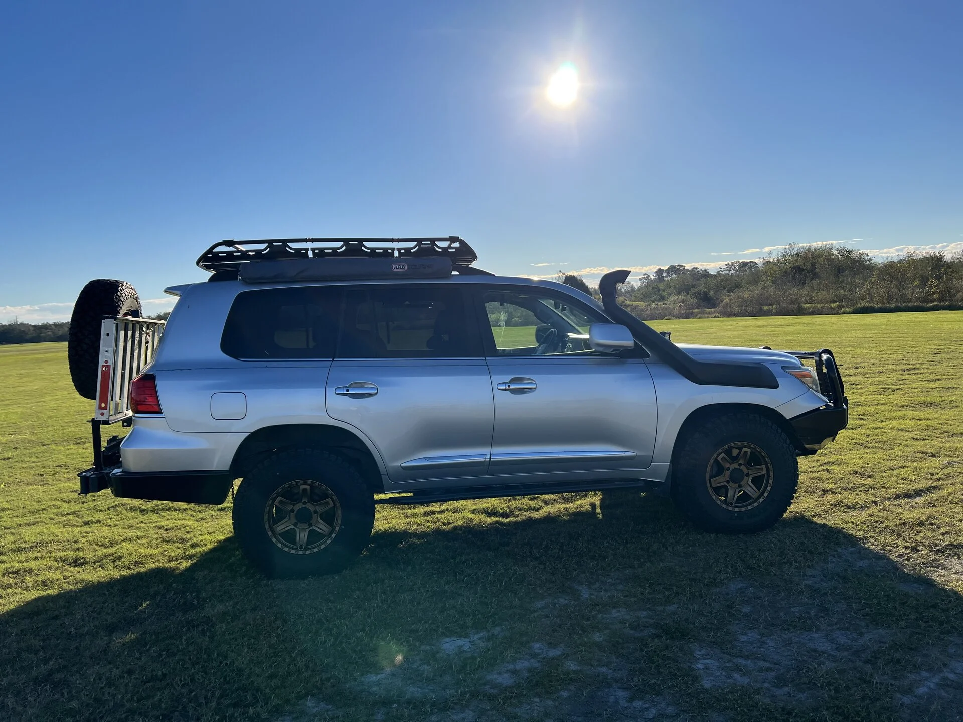

This is 15 offset and 35x10.50r17…tires narrow Enough to just, perhaps, fit under the fenders at this wide of an offset. I could probably fit 285’s (11.22”) wide tires if I rolled the fenders.
